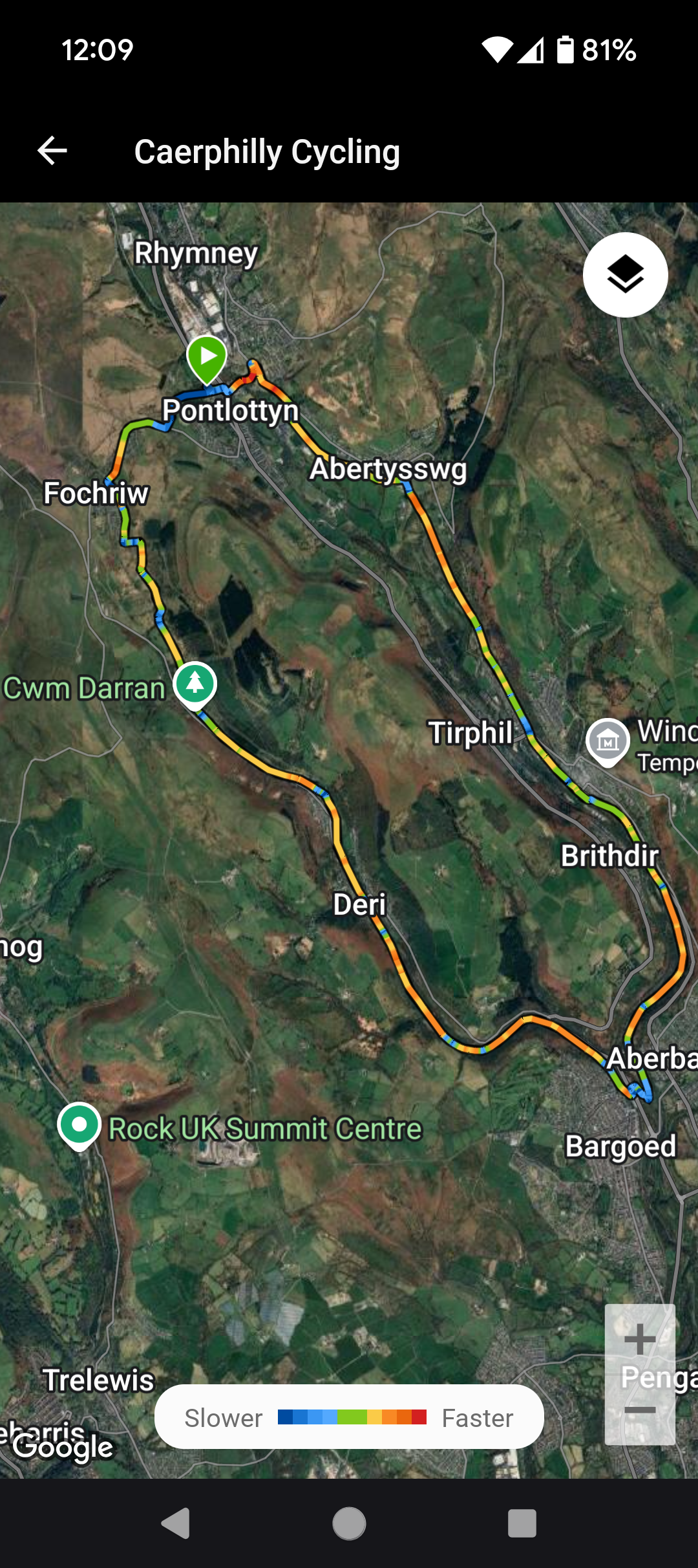

Well, I've had my 900 for just over 5 years now and it's still going strong. Think I've had my money's worth out of it. Another good ride out this morning 😁
