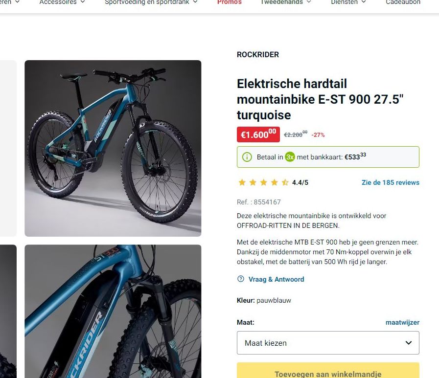

I think the Rockrider E-st900 is commercially end-of-life.
Most of the sizes are not possible to order online,
here and there still some in stock in a shop.
And then this promo : From 2200euro to 1600euro
screencapture-decathlon-be-nl-p-elektrische-hardtail-mountainbike-e-st-900-27-5-turquoise rs.jpg

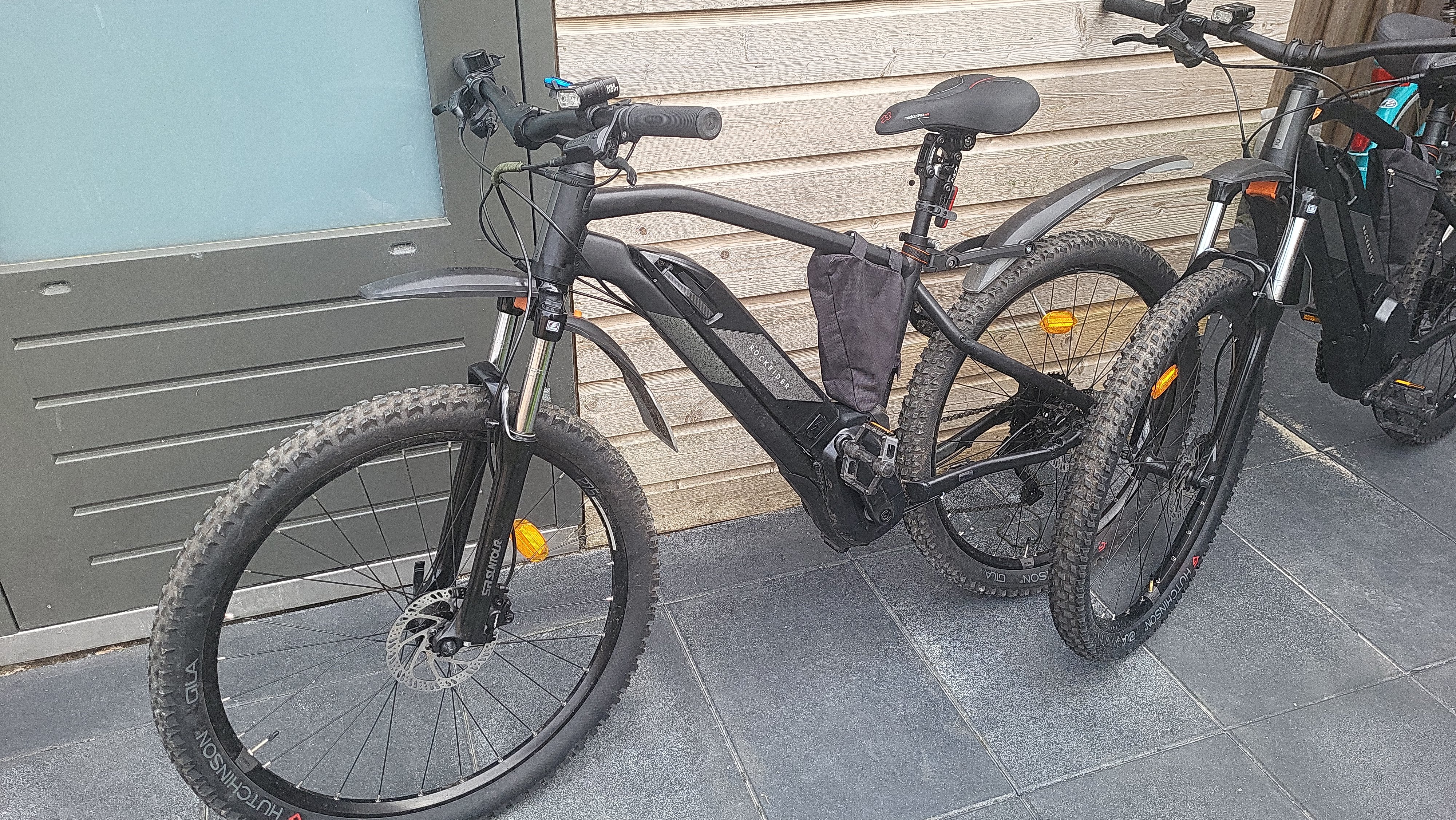

So that's what I (we) did after discovering the limitations of the D4 service.
Bought this blue M-size for the wife (also pub/spare/commute bike for me)
The black L-size is put aside for repair one day, or for parts, or...
Modifications to do will approx be the same:
* Dropper post and comfort saddle
* Mudguards
* Bike stand
* Smartphone holder
* Tools saddle bag
* Big accessoires bag for lock, keys, money, gloves,...

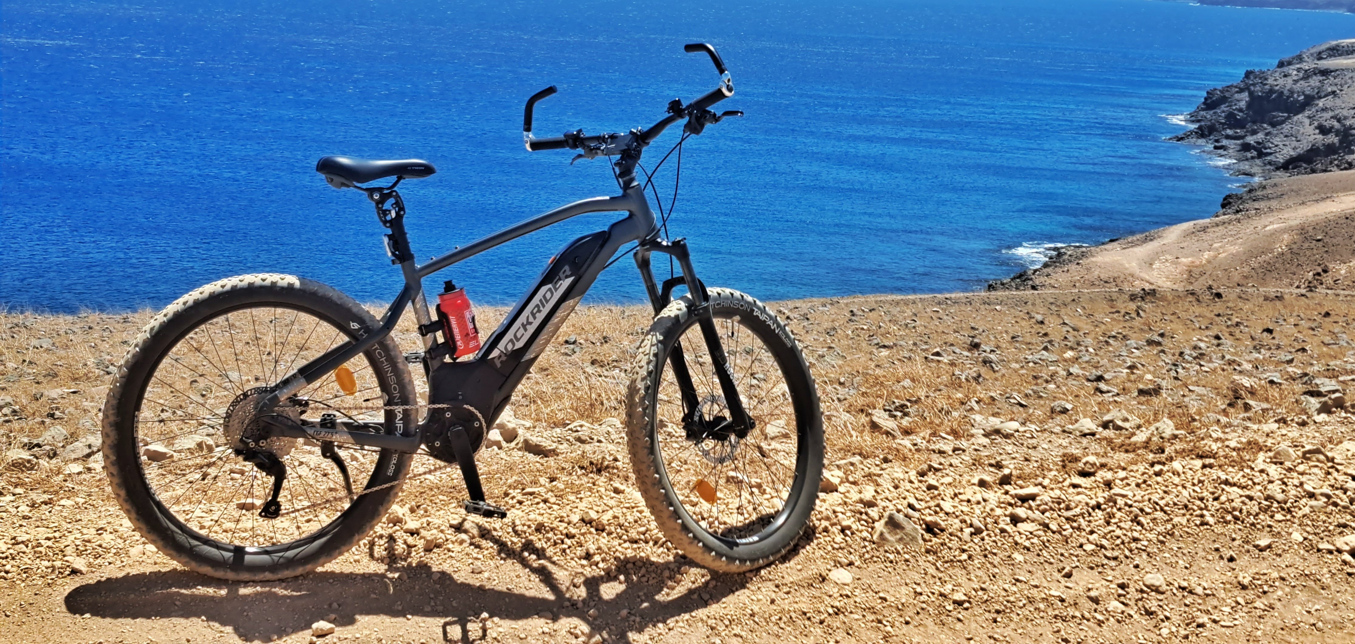

Love my EST 900
Good that you have now changed the many spelling and syntax errors !
The first version looked liked a poorly constructed AI job.
Just sayin !
Happy conversions.
Love my EST 900View attachment 142987

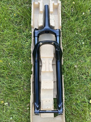

So... I did a thing...
I just ordered a Chinese fork after a lot a reviews and searching what I could expect. I know this could be a waste of money, but since i got a few coupons I couldn't resist my curiosity and went thought with it for 90 euros..
Since people only seem to complain after real abuse, I reckon I could be fine since I only do some tarmac and now and then some gravel or sand routes.
I will update my findings if it arrives 😇🙈
At least my curiosity will be statisfied, and will always have the original fork as a backup.... if all fails, I will probably end up going for a judy... but hey.. this seems to be a fun adventure 😬
I will update my findings if it arrives 😇🙈View attachment 143022

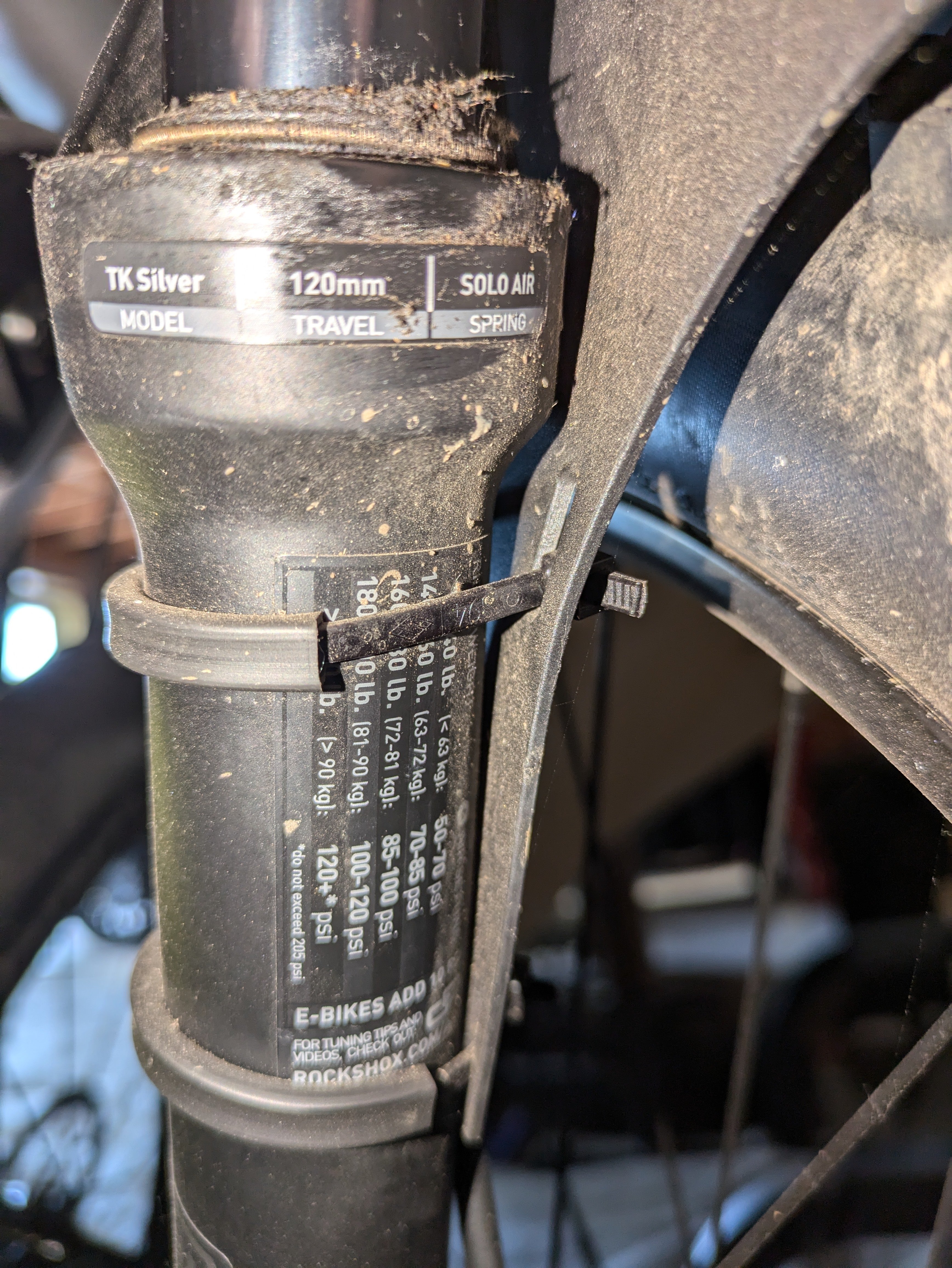

My gf has the e510 with Rockshox xc30, mine is a 900 with Rockshox judy air.
Judy is so much better.
have u consider a lower leg service? When I did it on the xc30 it was actually missing the foams, and stanchions were bone dry
cheap Chinese forks are a death trap. be careful
