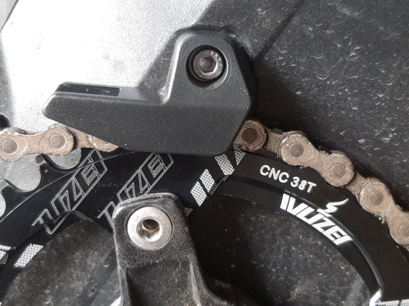

Thank you. As you said, very easy. Put some lithium grease around the axle. 38T in place. Thanks also to Bebiker for all the information about chainrings.
38T is much better suited overall to this bike. I have a seriously steep and long hill for about 200m at the start of my ride and I can still pull it in 3rd gear, as it would on the old 34T chain ring. Very good modification and thanks to @BeBiker for the heads up. :)

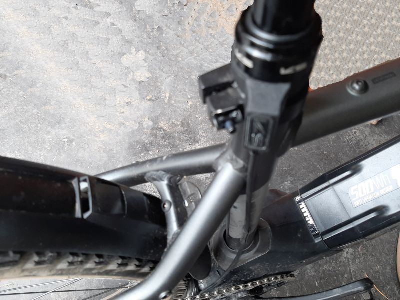

First thing, I mounted the Dropper Post KindShock E20.
I'm not completely (completely not) satisfied.
The marketing and manual say you can adjust the angle between cable attachment and saddle position.
This is not the case for that model, and they admitted it.
I wanted to pass the cable on the back,between the tubes.
This is not possible now.
But it works.

That looks similar/identical to the transx one I put on the e-st500. (Which I know is not the same bike :-) )
I ran the cable down to the cranks and back up.
I found some bike self adhesive cable clips which I just stuck to the frame. Some from bike discount and some from e-bay as I wasn't sure what they'd be like. One set had clips the others you just put a zip tie through them, so it looks fairly tidy.

If you decide to put the cable under the motor like me, order a 2100mm rear derailleur cable.

I almost went along the top tube, but the curve would have been too tight, or there would have been too much of a dropping loop.
I guess you'd need to put it on the bike, get the height correct and then see where the bottom ends up.
I take it you don't think you can get it through (or there's no exit holes) the frame and out with an internal one ?
You can get away with a reasonable curve, too much and it might end up kinking or will wear faster or just be tight to operate.
It's certainly easier installing an external one. :-)

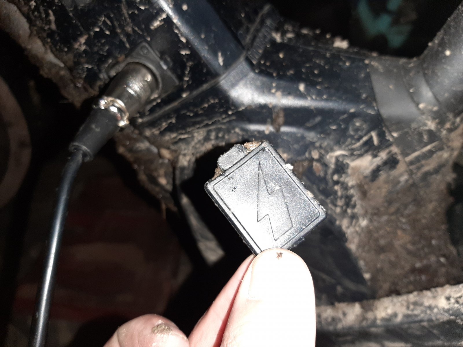

More seriously, I 'm not sure but I think I have seen this plug and his protection as spare parts on Decathlon French website
Update : sorry. I was wrong but this is the kind of parts quite easy to find and even more reliable at professional stores.
I remember to have seen this protection cap somewhere... but can't find it anymore.
At work they drive Egret electric scooters and it's the same charging connection. Maybe you can check at Egret website. Fingers crossed
this is what I found :
It's not exactly the same but maybe it could help
You could also send an email to Decathlon support. I did it once and they replied quite rapidly.
Can you tell me where you purchased the 42 and 38 chain ring ?
What do you think about a 40T.

Changing the chainring (again)
Original it comes with 34t, then I changed to 42t, here a pic with the new 38t.
The chain guide goes back on, and I have enough spare chain length now.
The guide is now at maximum height in the guide-travel into the plastic cover.
First driving impressions are good.
Compared to the 42t, I have to pedal faster to go top-speed at full electric power (don't need that often)
I have more choice in the shortest gears, useful to climb without elec assistance.

40T will also work, but 38T is the limit for using the original chain-guide.

Agree with BeBiker on going for a 38T. This fits perfectly with the chain guide and will see you pedal to about 27mph, as opposed to 22mph. The bigger chain ring has not had any negative effect for myself on climbing hills.
I got mine on Ebay:

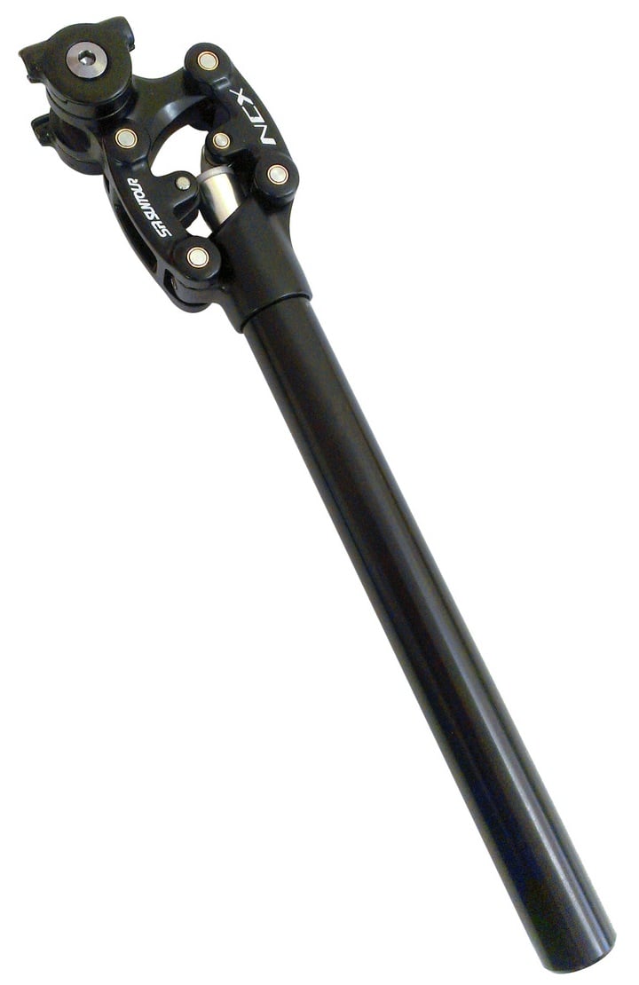

@DT36 I’m very impressed. It’s took a few rides to fine tune the damping. Which to be fair, only takes seconds to adjust. But now it makes the stock Rockrider saddle so comfortable! ?
SUNTOUR SP12 NCX MTB ROAD 31.6 x 350mm SUSPENSION SEAT POST - BRAND NEW | eBay was the cheapest I found. It comes with a ‘meduim’ spring as standard. Soft and hard springs are available for different riders weight.
Sounds really good. My kids look to be carrying a bit of weight anyway so just added that link to my basket before I go through TopCashBack :) . Thank you.

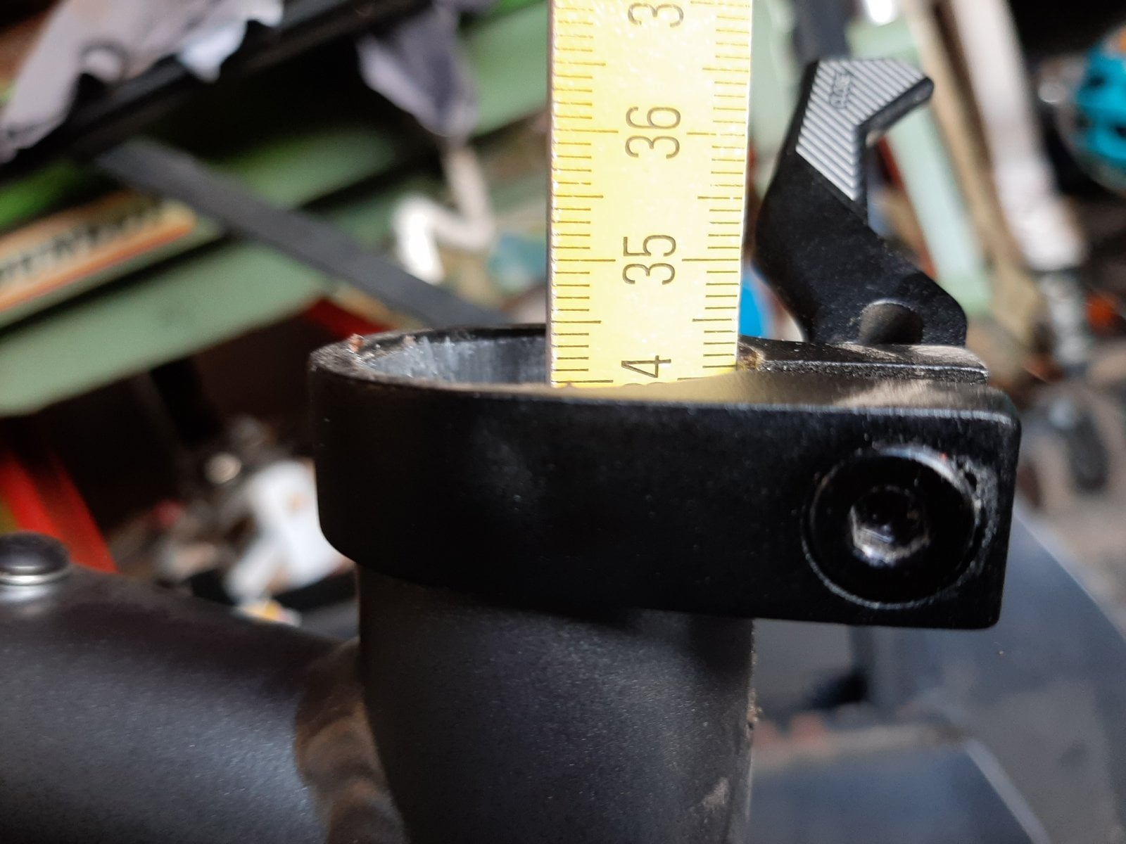

I wanted a dropping post, so had to check dimensions to see if it would fit.
The tube is 31.6, but is it deep enough ?
I ended up buying the KS E20 125mm, mid cable
