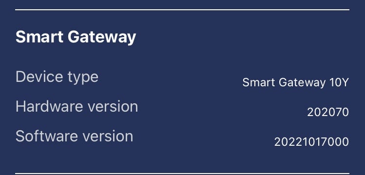

Do you have the same Smart Gateway software nr.》 20221017000 《?
And the battery the new one is 》 2317《.
Could be a different one for different regions.
All in all the bike works perfectly, motor, controls...etc.
It's just the power reading are by 100% lower then they were before the update...
Example, in todays 25km 850m d+ ride the average power readout was 8W 🤷‍♂️🤦‍♂️🤨...

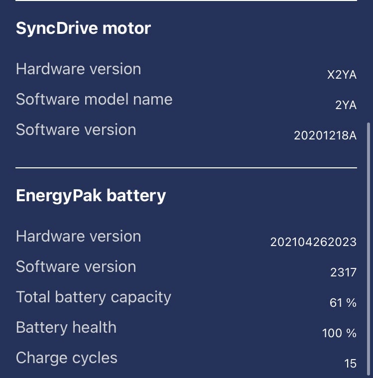

Hi,
Here’s there screengrab of my hardware/software versions.
Seems like the same version.

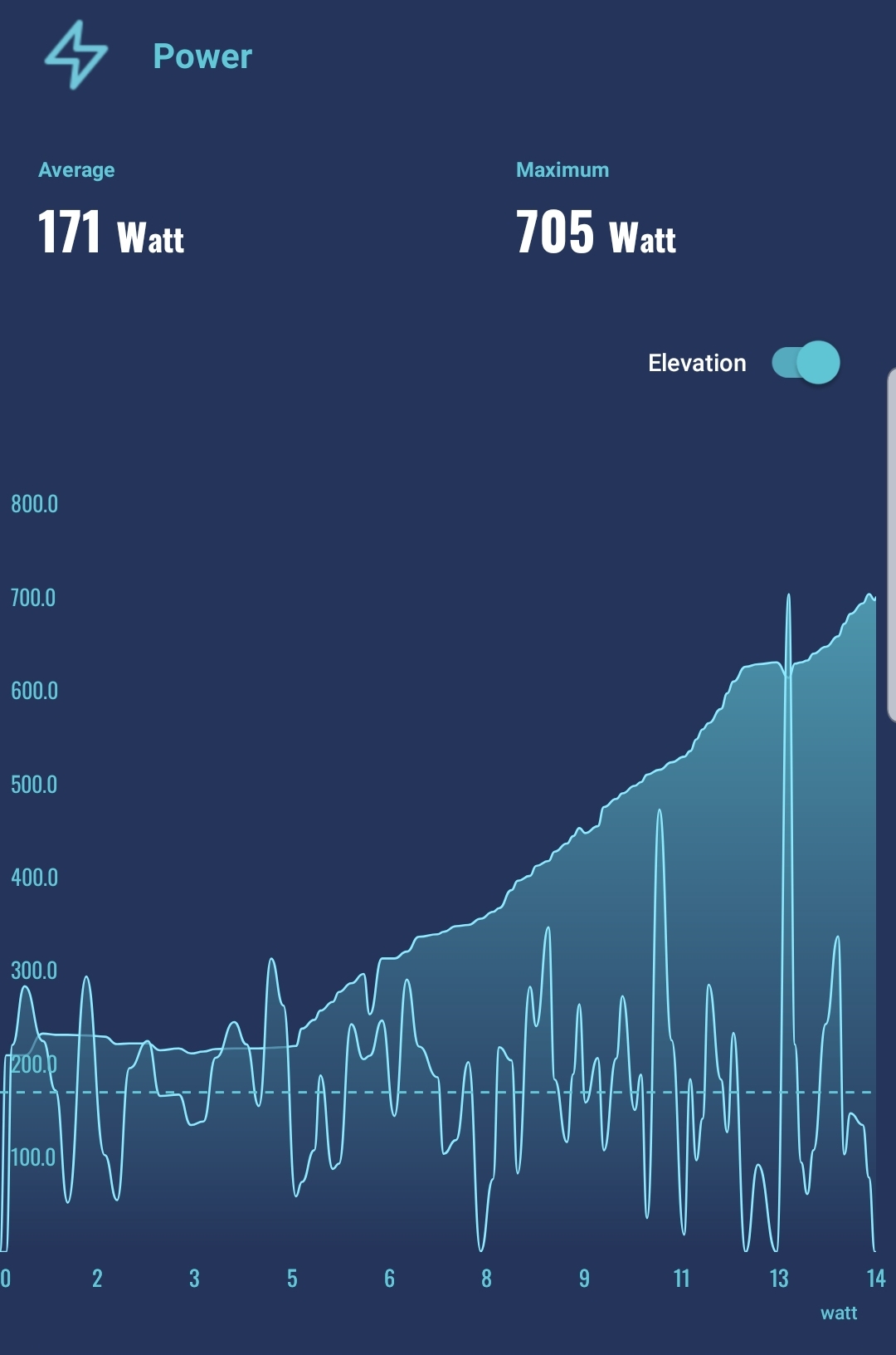

All right guys, getting back to the new software update...did a few rides with both(625 and 800) batteries to test everything out...
1. The power readout: I tried to ride with the Giant phone app connected to rule out different parts of story. So the power readout on the Giant app was surprisingly extremely accurate(it wasn't before the update-there were a lot of spikes). This time It showed 171W average and 705W maximum.
Although I don't know if this is motor power values or man power, it could be either.
If anyone has credible info on what power readings the app shows I would appreciate it, otherwise I will send an inquiry to Giant about it.
My Garmin app on the other side still showed extremely low average of 9W and a max of 189W maximum, as did the Ebike field for Garmin that I am using. Have already sent an inquiry to the developer of the field app and will also send one to Garmin.

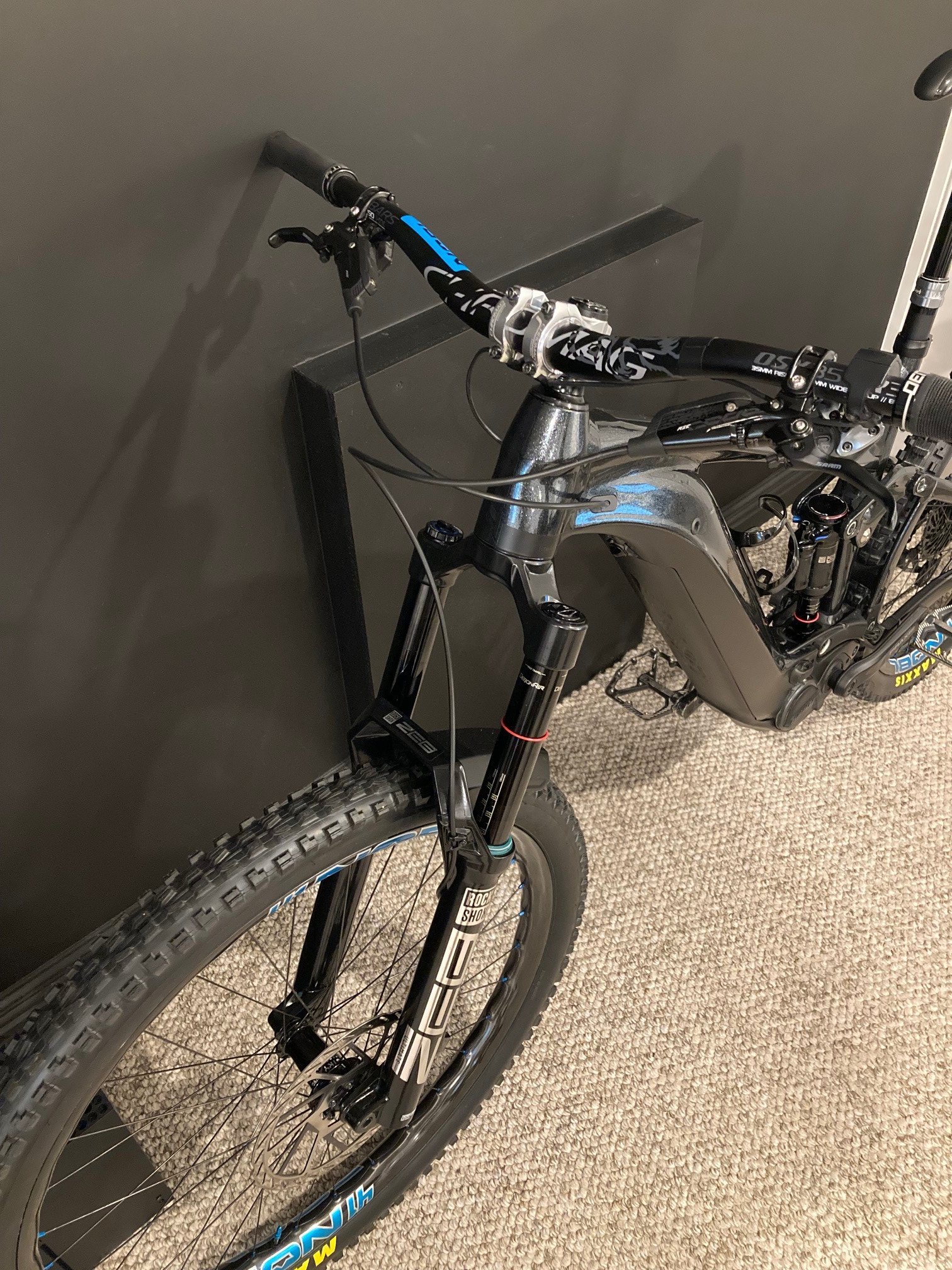

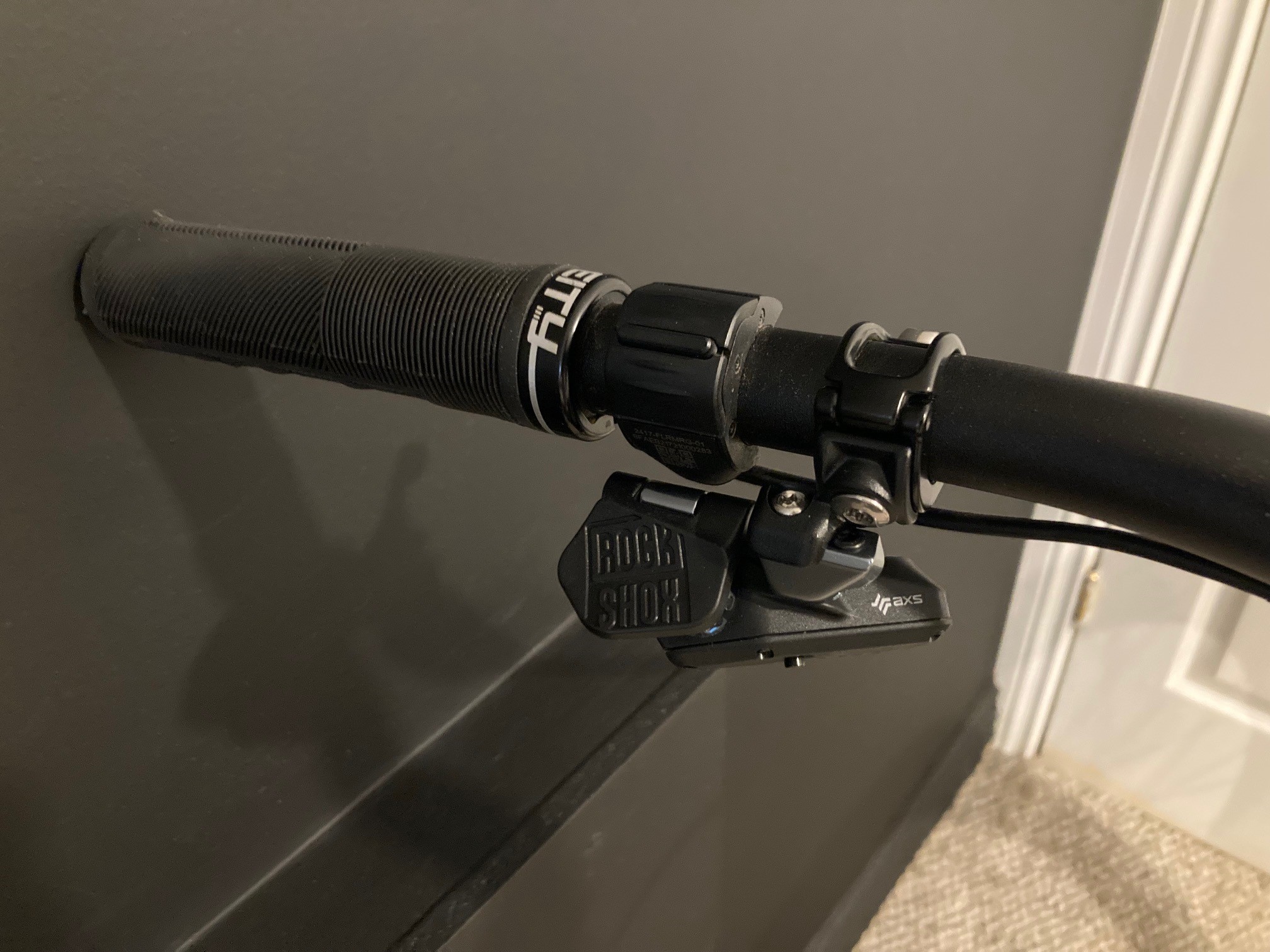

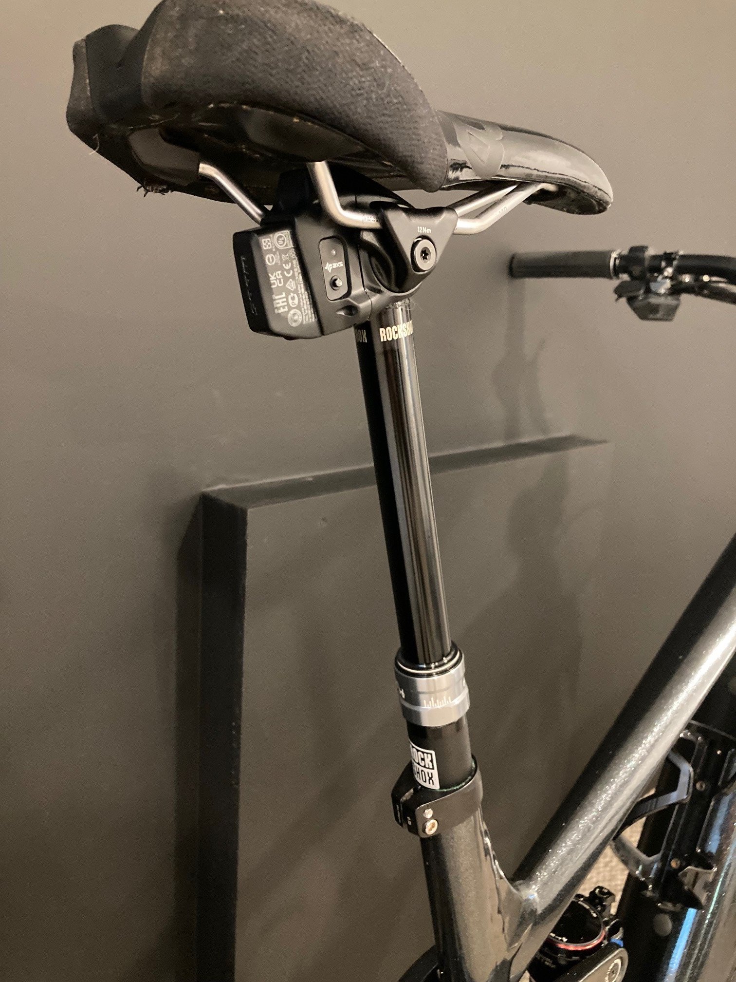

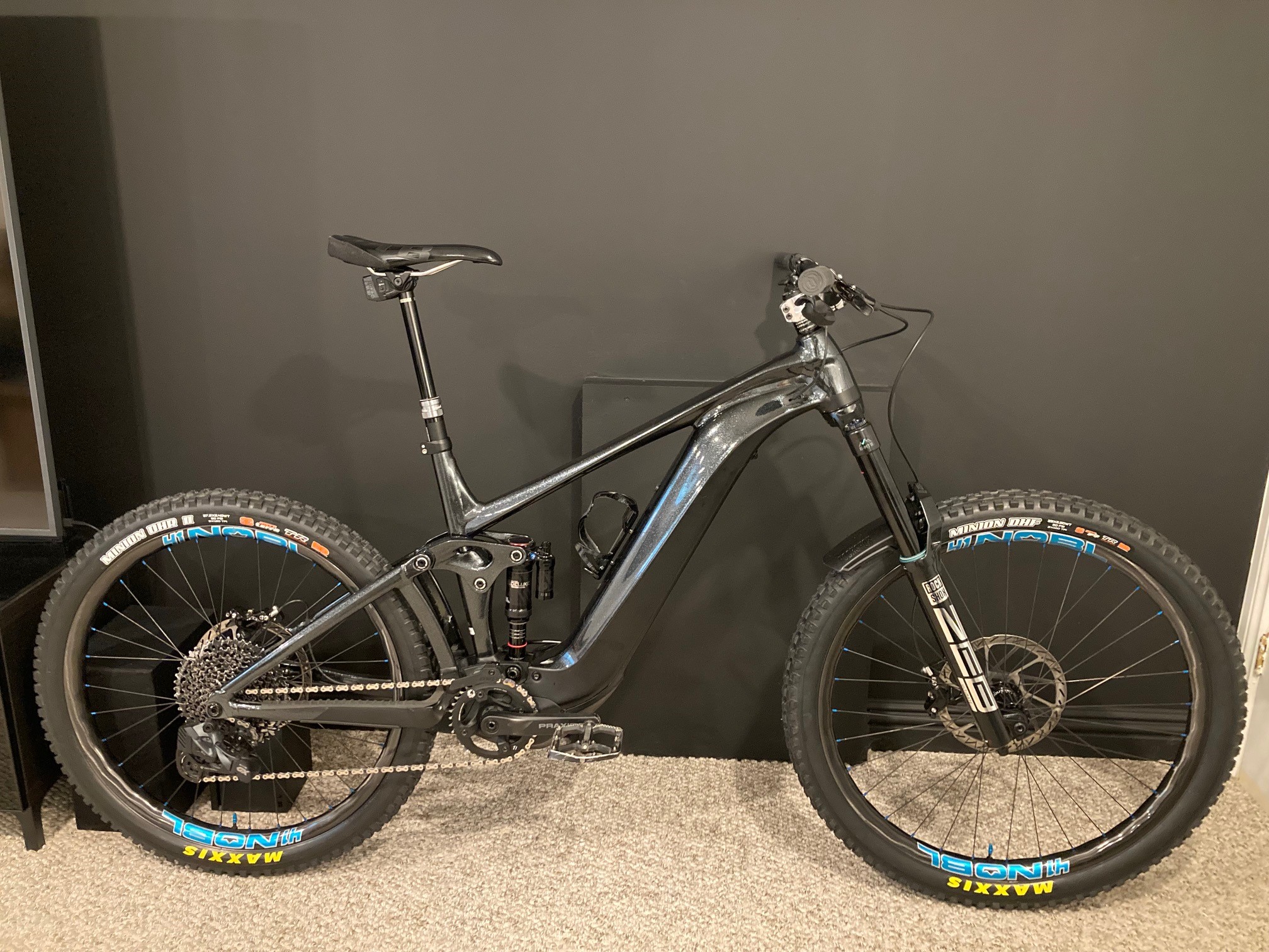

Just bought a Rockshox Reverb AXS to replace OE dropper, should pair nicely with my GX AXS RD.
Is routing the dropper cable again a mess and need to drop the motor like some other Giant eMTBs or it's fine ? I will leave a section of the cable in place if it's a mess to do as I will most likely revert the bike to OE parts if I have to sell it someday.
That's a great pre Christmas gift you got for your Reign 😜🙆‍♂️... I bet the bike likes it, good reviews about it👌✌.
For the dropper cabling, don't know how it's done, but would be good to know 👍
Reverb AXS 30.9 170mm are pretty hard to find so pulled the trigger when I finally found one online, SRAM seem to ship these to manufacturers for their end high end builds and leave pretty much nothing for aftermarket sales.
I took a first look and it looks like there's nothing to properly guide that cable, it's just dissapearing randomly on top of motor, I will assume that you need some kind of trick to get the cable routed or drop the motor to do it easily.
I'll post pics early next week when I receive it.
