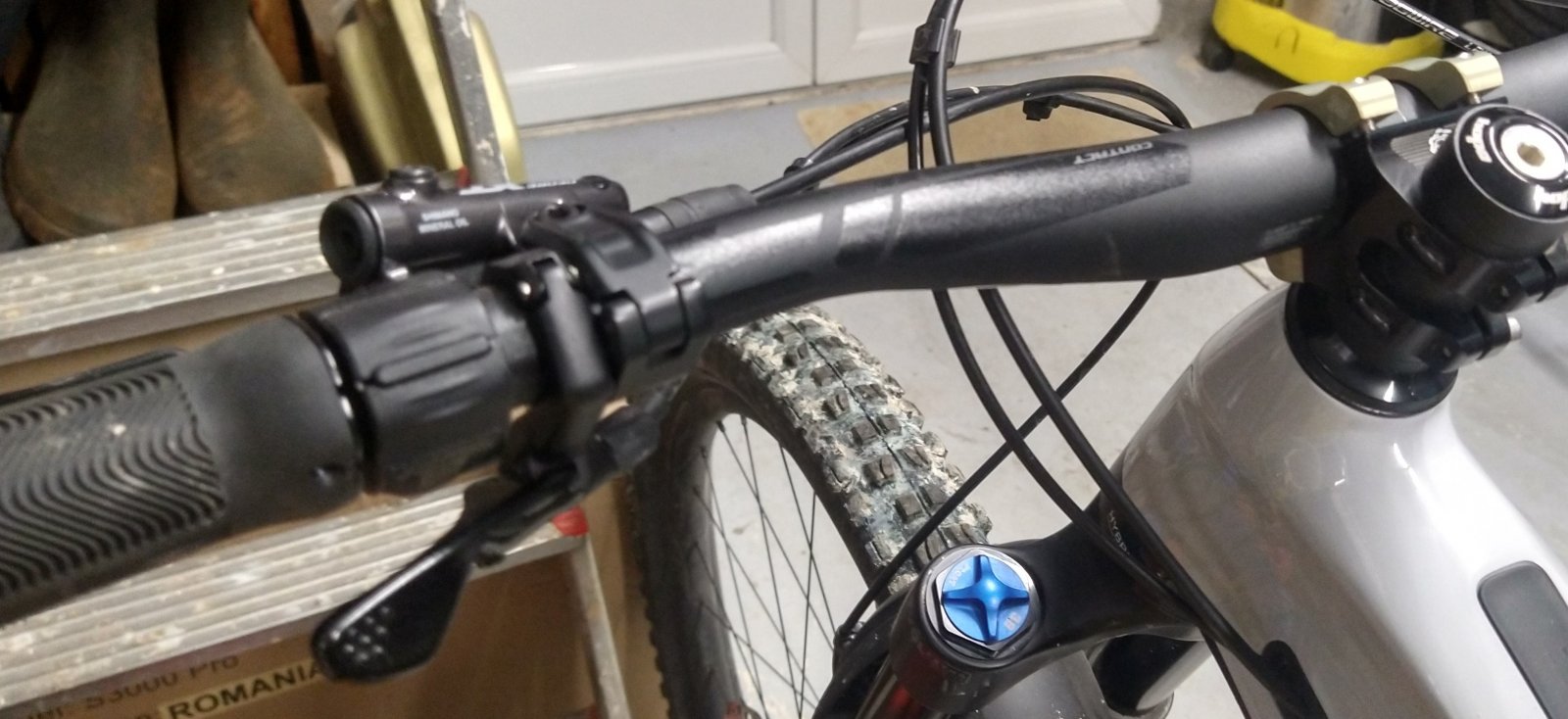

Hey everyone.
Did my second ride today.
Reign E +1 625Wh All Stock
1.49h
Average speed was 15,6km/h
95% Mode 1, 5% Mode 2
28,43 km
715m altitude gain
33% battery consumption(71% >>> 38%)
1st battery charge
Temperature 6°C
Today's ride was with a buddy that has the previous Reign with the PW-X 2 with a 500Wh battery and has a speed box(unlimited speed) in it. So he did 27,8km basically the same as me and for most of the ride used mode 1 except for the last 20min he used 3 and 4 for a fast getting home(at 44km/h). He burned 48% of the battery. The extra battery consumption is due to the speed box, otherwise it would be about the same...as he says if he pedals the same up to 25km/h the consumption is no higher.
So if we do a little calculating...theoretically with a fully charged battery in mode 1 it would be possible to do a 86km and 2166m vertical tour ride with the new Reign. Possibly a bit more in warmer temperatures. I will do more similar tests in other modes if I don't return the bike.
Also did check, did a video on motor/frame resonance noise issue I already mentioned before in this forum. After tightening the battery and cover it didn't get any better.
After constant climbing for about a half an hour it did quiet down a little bit, as if when the motor got warmer it was better.
But then again after descending and cooling it down it came back again...
It present mostly in the upper part of the cassette when pedaling/motor working. When I stop pedaling/motor stops running it goes away.
Also I noticed that the noise dimms a bit for a moment when going over curbs etc...
It doesn't affect the motor performance in any way, as the motor is really quiet, this noise makes unbearable for the ears...
Does anyone have the same issue?
What do you think should I go to Giant LBS with it?

Mine E+0 does the same sound when it decouples. If there is load on the pedals it went quiet . Also my Motor Motor became much more quiet after 500km regarding the wining noise. now it is very quiet. But this decoupling sound is a little bit annoying . Please keep us informed what your LBS says.
Hey thanks for chiming in. 👍
My motor has 55km so far(2rides).
Was your motor silent(no noise) under load from day one?
Mine has this noise when it is under load, but it stops when it decouples, so just the opposite of yours.
I can confirm though that I already did hear a significant positive difference in the second ride about the whining sound.
Will definitely keep you posted ✌
The wining sound was much louder. I do have decoupling under load but only on flat and low gear. If i give more load on the pedals it disappears
