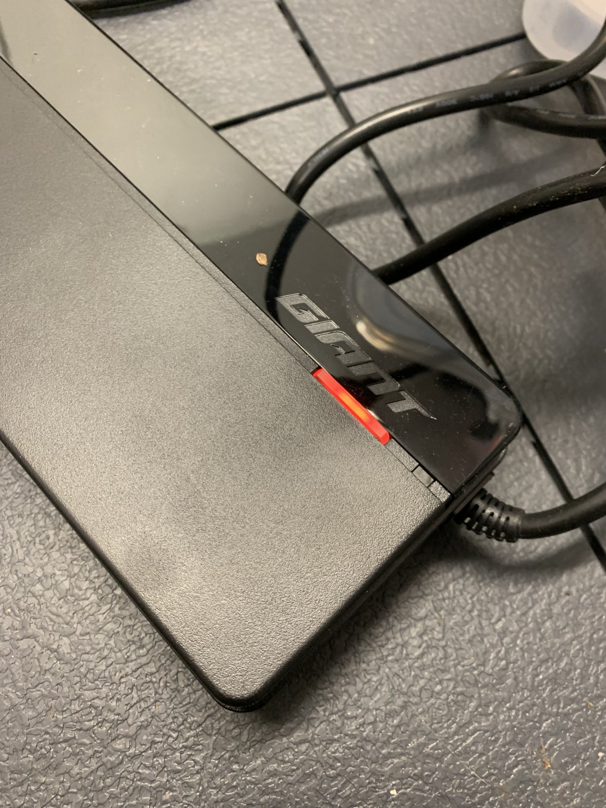

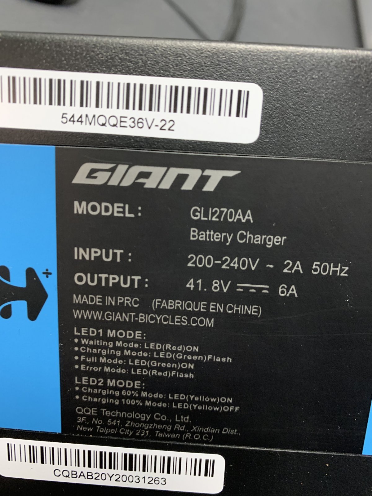

What does this mean? Is this max 60% mode? Instructions are absolute shit and led are unmarked. Red + small blinking green.

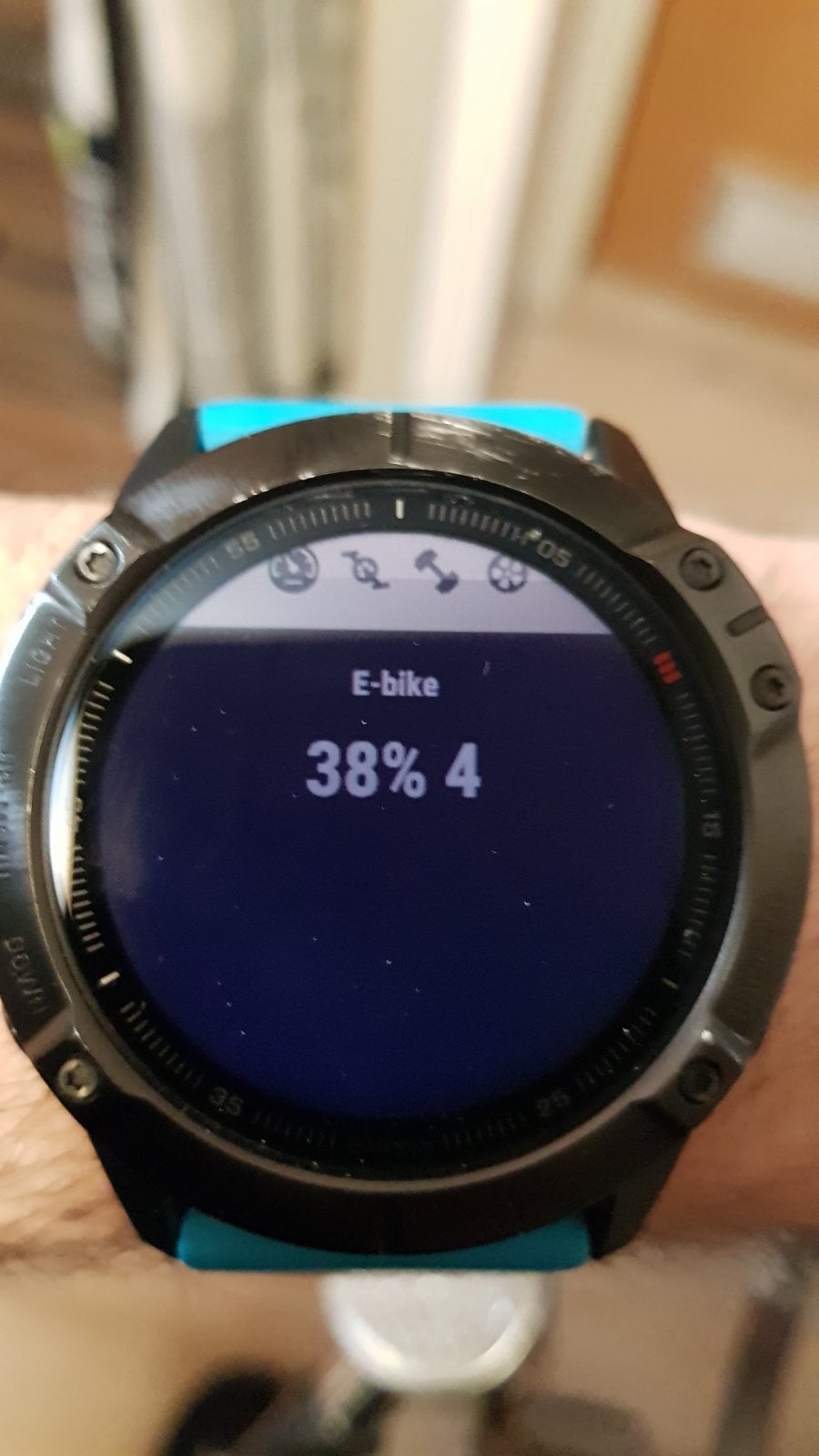

Did my second ride today.
Reign E +1 625Wh All Stock
1.49h
Average speed was 15,6km/h
95% Mode 1, 5% Mode 2
28,43 km
715m altitude gain
33% battery consumption(71% >>> 38%)
1st battery charge
Temperature 6°C

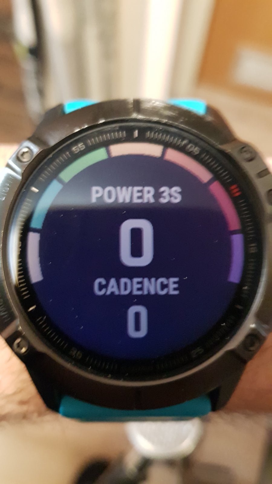

I tested the ANT+ sensors Cadence,Speed Power on my Garmin Fenix 6X. Worked beautifully.
Average input power across all the ride was 62W.
Max average input power(20min) was 118W.
Average cadence was 59 rotations/min
Max cadence was 137 rotations/min
Didn't really check the speed.
I could easily maintain 26km/h without motor assistance...there is basically very little internal drag.

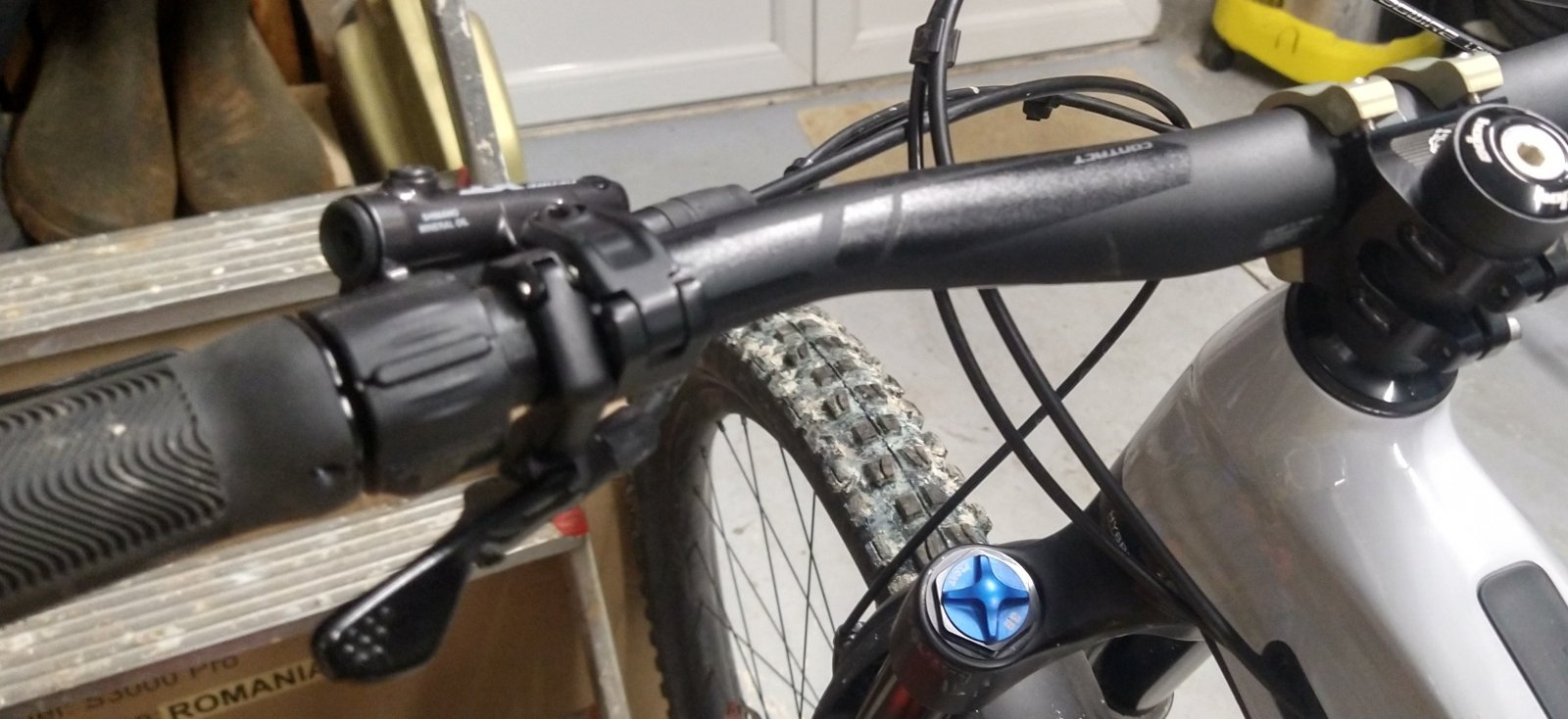

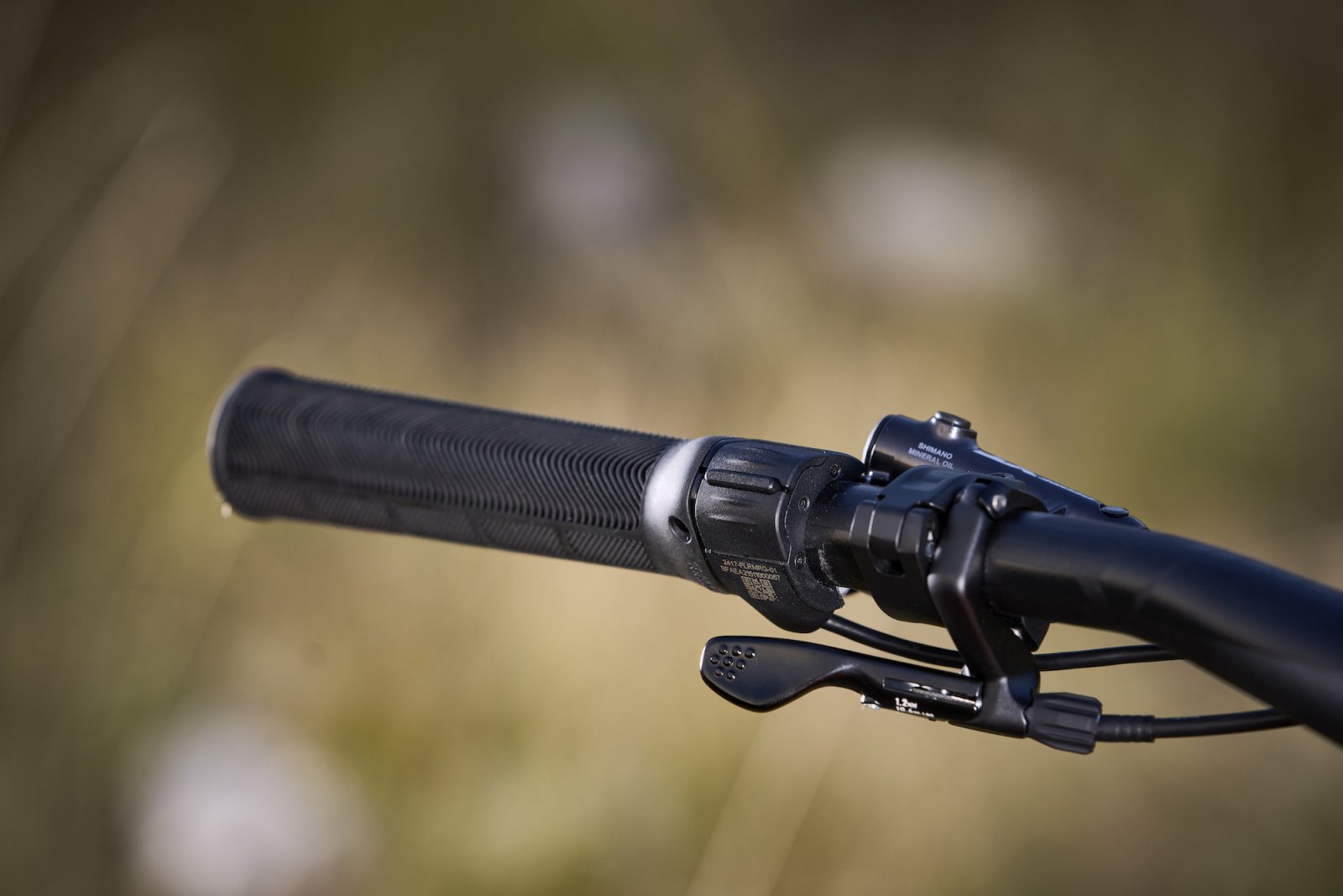

Anyone else had a problem to reach the dropper lever?
the breaks are so close to the remote as possible. They interfere on the other side. Gap between break clamp and remote is to small to have the lever clamp.
when I hold my normal grip my tum tip tuches the lever. Very bad ergonomic in other words.

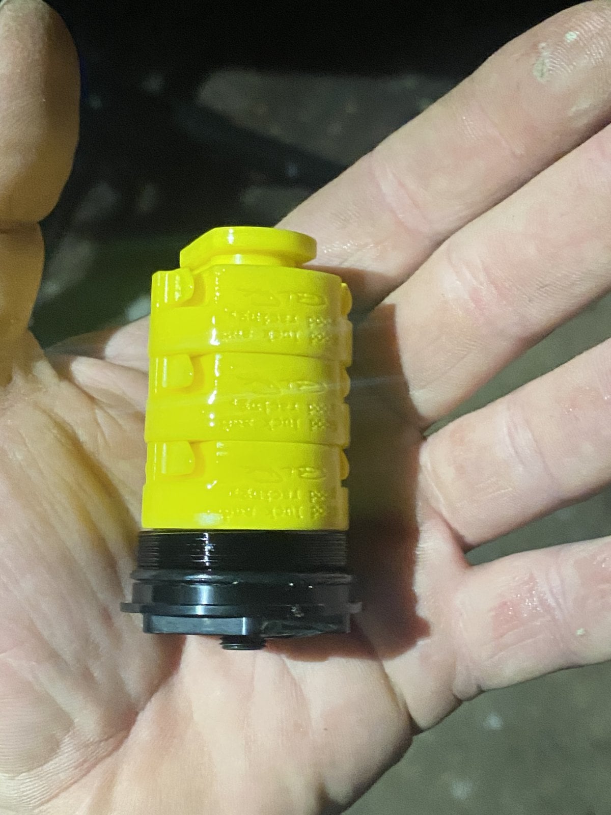

I was finding the 38s to be a bit harsh and after reading a few comments on here decided to check how many tokens are installed. And yep there was three. Riding at windhill bike a park tomorrow so going to drop to 1 token, hopefully that solves the problem. 🤞
it's unlikely you will notice a difference except on big impacts that use all travel. the 3 tokens that come stock are there to increase the progressive ramp up at the end of the stroke. sensitivity and 'harshness' are unrelated to the tokens.
😔 well I’m stumped then, when I removed them from my factory 36s on my other bike I’m sure it did help. Maybe I’m just getting old and weak 🤣
Anyone else had a problem to reach the dropper lever.
You can mount the dropper lever between the ridecontrol and brake lever for better reach and thumb contact. No need to keep the default placement.
I would agree with you, Tim. I took all four tokens out of my Fox 36s, and it was noticeably less harsh. There's a lot in between the extremes of full-travel big impact and small bump sensitivity stuff. Rider weight also makes a difference.
have you reduced high speed compression to nearly open? and the right air spring, maybe slightly lower (depending on your needs and terrain of course). sometimes even slowing down rebound a bit can help. i have large hands so i also use the biggest, softest grips which helps a tonne. either Diety Supracush, or now trying some from SQ labs. of course it might be some issue with the fork itself but often it's set up. i'm very pleased with the 38 on mine and did little trial and error after the inital set up. once trails open up and speeds increase, some adjustments might be necessary.
The progressive ramp up occurs more than just at the end of stroke. Granted, it's most pronounced at the end of stroke, but it will affect earlier and mid-stroke as well.
