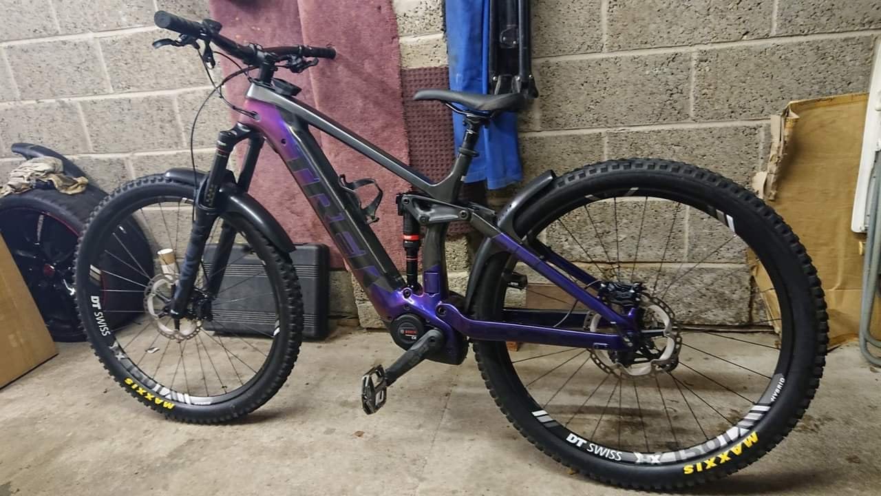

Can anyone tell me where I can buy the magnet that bolts on the disc bolts on my rail 9 .
Got a second set of wheels .
I’ve searched the net , but not sure if it’s a trek part or a bosch part

Thanks zimmer I had seen that one but it looked different I wasn’t sure if it would work
Here’s a pic of mine , not great but you can see it’s quite different
