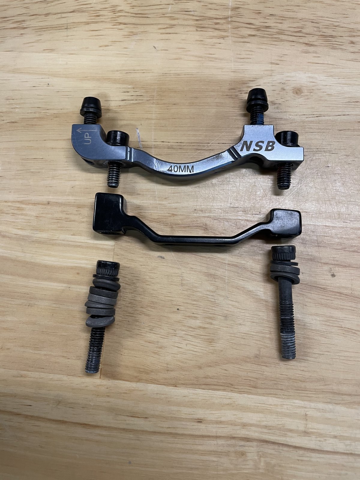

what brake mount adapter did you use for the rear 220m rotor?
Stihldog
Handheld Power Tool
Jun 10, 2020
2,937
4,149
Coquitlam, BC
The adapter for 220mm magura rotors were slightly larger/taller.
NSB, or North Shore Billet 40mm , was the adapter I used f/r for the 220mm rotor. I eventually switched the rear rotor size back to magura 203mm, therefore the original adapters worked fine. No adapters are needed for 180mm rotors.
The Magura website should have the correct sizing or model # for the combination you need. I think it’s QM45. Maybe?

Just a heads up. I broke a rear derailleur after fitting a bigger rotor. Went to replace it & found the mounting hole in the adaptor was a mm or so wider than the caliper bolt hole so the bolt would just go through on a very slight angle but be in contact with the inside of the mounting hole of the caliper. When tightened up it must have put tension on the caliper & broken the mount. I remember this issue at the time but didn't think anything of it & tightened it up.
This time I tried filing the caliper hole a bit so the bolt would move freer when tightening up if that makes sense.
