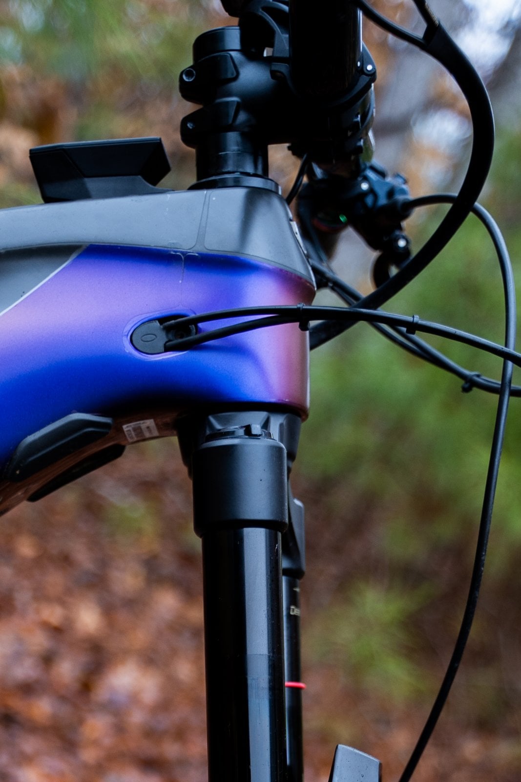

I got the 170mm RockShox ZEB mounted up on my 9.8. I can already tell from the parking lot test that the ZEB is a lot plusher up top than the Lyrik was. I am also surprised on how the crown looks. I was expecting it to be more inset to the frame since it is not the e-bike specific one. You can barely tell unless you are looking for it. I think I am going to really end up liking this setup over stock. Next up...rear shock...brakes...and possibly wheels.

Looks good from this angle. Would you mind taking a couple more photos of the crown area and posting them. I have a 170 ZEB Ultimate arriving this week for my Rail 9.8XT.
Yeah I can do that later today. It looks a lot better than I thought it was going to.
