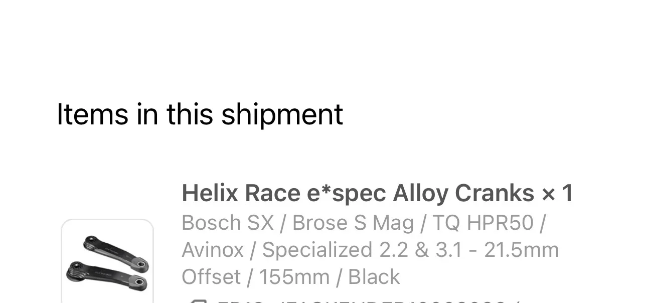

I wish cane creek would re release the ee-wings in a 155mm for the ISIS crank. They’ve said they dropped them because there are too many e bike standards right now.
That 3d printed titanium is sick looking. One of my suppressors is also titanium 3d printed and is robust as hell.
Do they not make them at all anymore? Looks like only 165mm on their site. I have 160’s on my Levo and hoping to switch them over to my Plaid when it arrives. I did some digging and it looks like they should work.
I will be using mine as well. 😎👍🏼
Nope. They said they are done with them for now until an industry standard is released. The 165 is back stock, and too long for how i want my 181 to feel. But, thats a great price for anyone that wants 165s.
They’re 165, buy they have less overhang below the pedal axle, so the overall length is actually shorter than other 165’s
