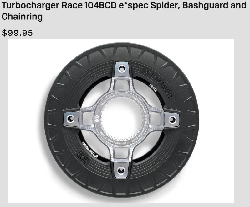

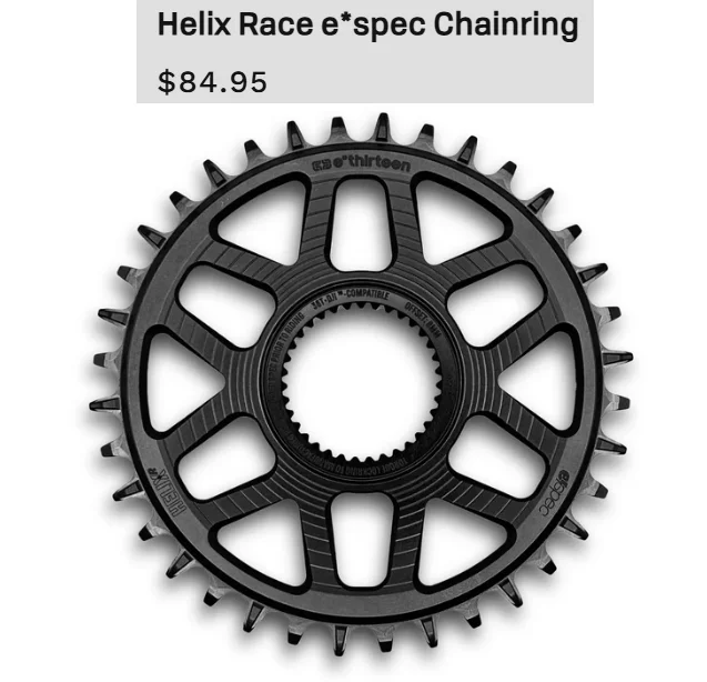

Thanks @Wah,
I have heard the same yet just took a good look at the latest Forge frame, and the 36 tooth looks very close to clearing in this pic.. is this part of the improved frame revisions I wonder?
Also the e13 bashguard I sent the link to does have the spider included, I wonder if this means e13 has a spider that may work for the Avinox, and/or which model they are using?
If they dont piece this out, you may be interested in the bashguard if you are concerned with clearance, and even though you have a chain ring the price is $99 and you get the bashguard, spider, and a chainring for the Avinox.
However if the 34 tooth clears then maybe the bashguard is not needed, so the other option I am thinking is to stick with the same style one piece e13 helix espec 34 tooth ring.
34 tooth bashguard:
34 tooth espec charinring:

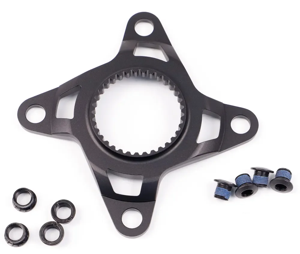

About the integrated bash guard… I don’t think I can get myself to do it. It’s like a dork disc for the front 😂
I’m sure they have a spider though… it’s probably the Bosch one but I’m too lazy to research it. Actually now that I think of it, I do have a race face direct mount chain ring for my Bosch bike somewhere in my pile of bike crap. I should look for it.
Edit: AI says Avinox uses its own spider. 🤷🏻‍♂️
Thanks again guys, going for 34 tooth for the clearance makes great sense. If you are worried about clearance , then likely the ratio works out good for this type of technical riding also.
Didnt mean for this to turn into "bashing the bashguard" rant but I will also concede the thing does nothing in the aesthetics department! :LOL:
Great feedback though overall. If the 34 is going to clear, give me some potential range (3-7% according to ai calculations?!), and improve pedaling in the steep and rough stuff I am starting to think it may be time to scour for a deal on the 34 toother.
Subjectively of course, Is there an option that can improve upon the sexy factor vs the espec I should take a gander at while were here? I have the Hope spiderless on my current, just not sure it says "Plaid raw carbon" to me..

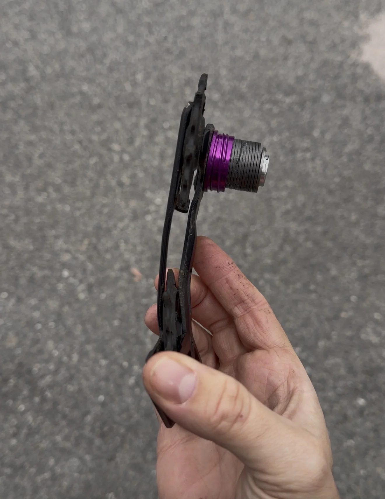

Cage from X0 after men’s DH in Finale Ligure 2 weeks ago. €99 to replace just that cage.

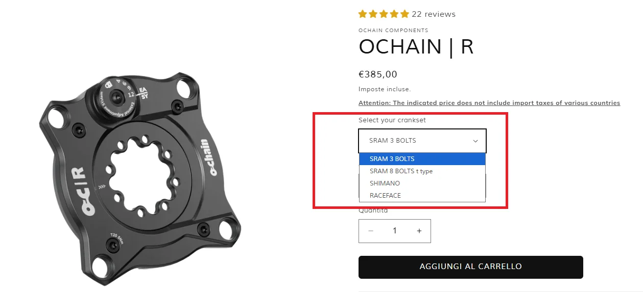

Digging a bit into pedal kickback devices now myself, and liking the sounds of extra smooth suspension action while bombing downhills!
Seems like the Ochain may be the way to go, but they dont make an Avinox version at this time.
Wondering if anyone can tell me Is it feasible if I were to scoop up an Avinox 104 bcd spider:
Would this allow to mount the 104 bcd Ochain R?
If so, what crank option would work out for the e13 cranks?
Probably wont work unless I change over cranks too, but open to suggestions and info if this would work or not even!
