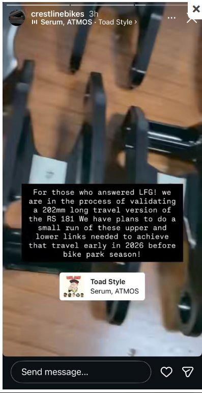

I just watched Sam’s video, he mentioned Crestline is releasing a DH e-bike. 200mm travel front/rear with a swappable bottom bracket to be able to use either the motor or swap it out for a standard crank/pedals. He said he’s already put a deposit down on it. Anyone else heard anything about it?
Wasn't this just an idea that Troydon floated on one of his interviews.... which video did Sam mention this?
AFAIK you’re correct. Troydon mentioned he had been playing with the idea on the Vital MTB podcast.

They're releasing a Cascade link for the Spectre to up travel to 200mm.
If you listen to the Vital Podcast with Troydon his plan is to use the Spctre frame, minus elctronics and add in a 200mm link and a standard BB in place of the motor so it can used to race DH. Saves him on making a new DH specific frame. Economically makes all the sense in the world and is a creative solution too. This is his instagram post:

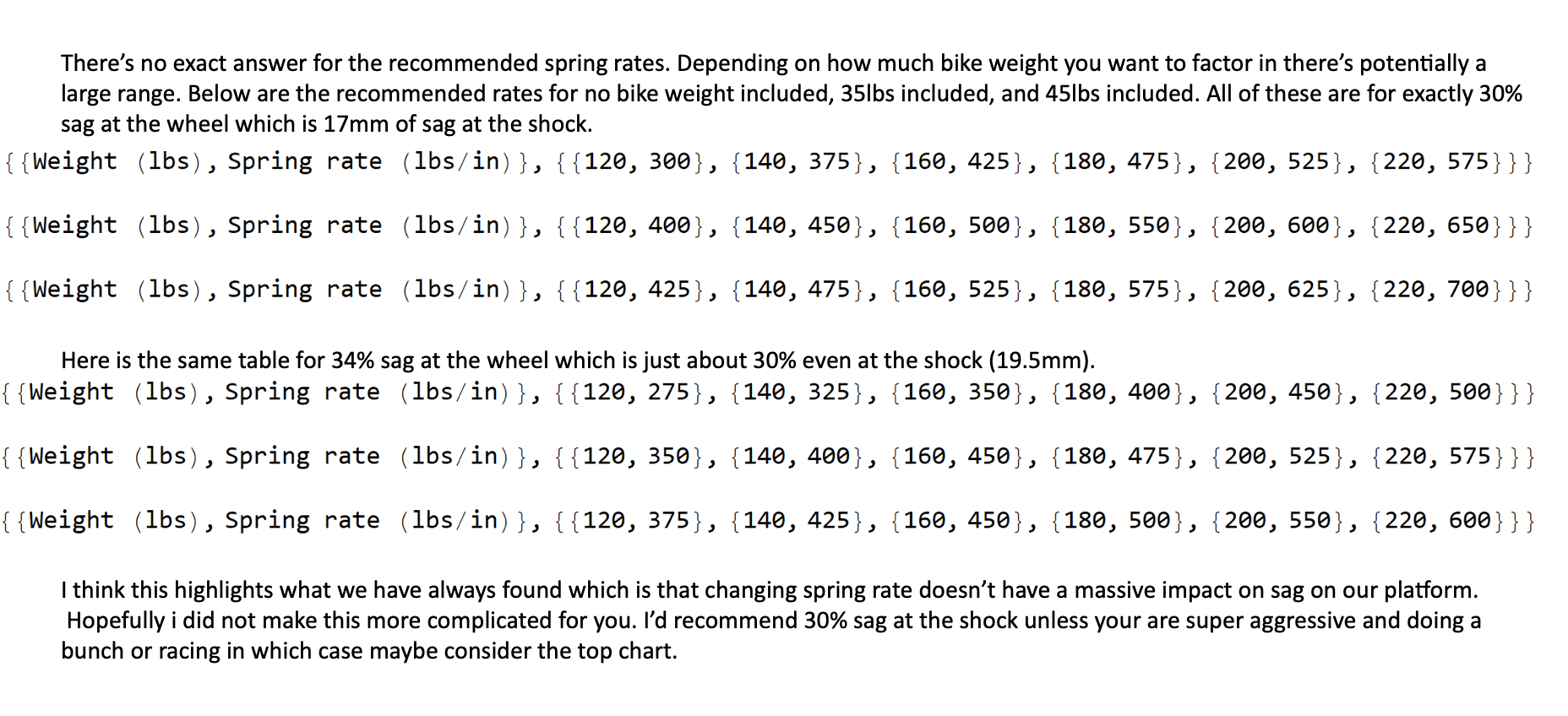

Any ideas what springs the vivid and dhx2 shocks ship with? I have nearly all the parts I need for this build, just realized that the spring will probably be too light since most coil shock bikes are spec’d for lighter weight riders.
If you contact Troydon you can request a specific spring or ask for advice based on your weight. His spring chart is pretty spot on.

So update on this... I did shoot him an email and he said RH2 will come with either a 400 or 450. But he gave me the chart to figure out the spring I'd need to get. It was $30 for the spring so no biggie.
