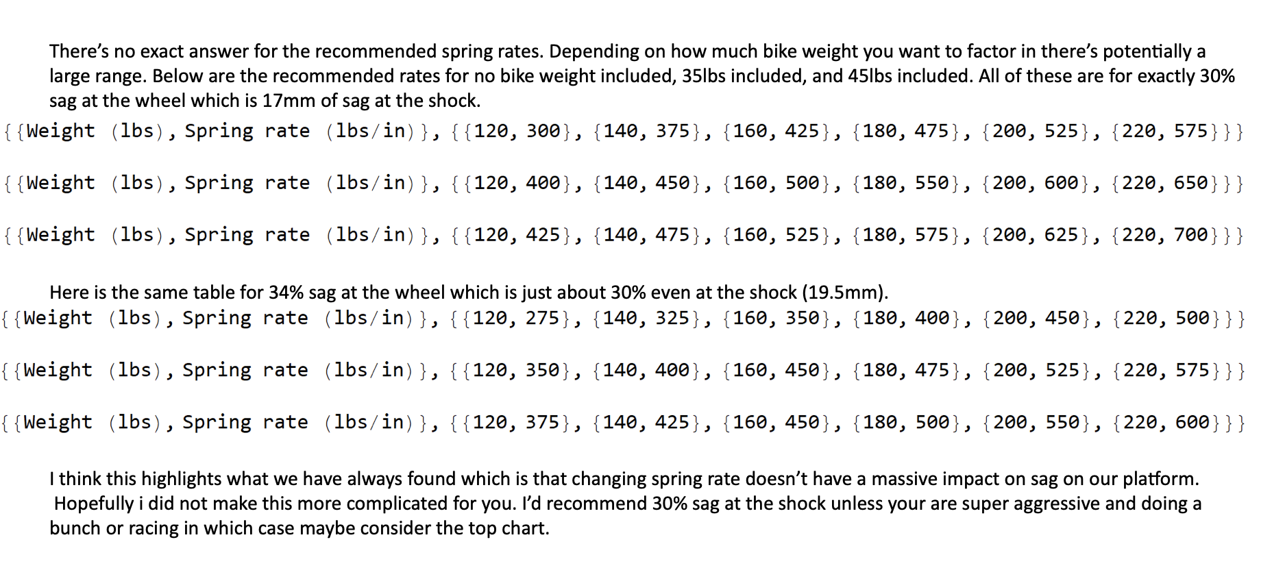

So update on this... I did shoot him an email and he said RH2 will come with either a 400 or 450. But he gave me the chart to figure out the spring I'd need to get. It was $30 for the spring so no biggie.
Ooc what people take on bike weight included factor? Should it be always the closest bike weight, 45lb in this case?
Yes 45lbs, so third line of the bottom chart for most people

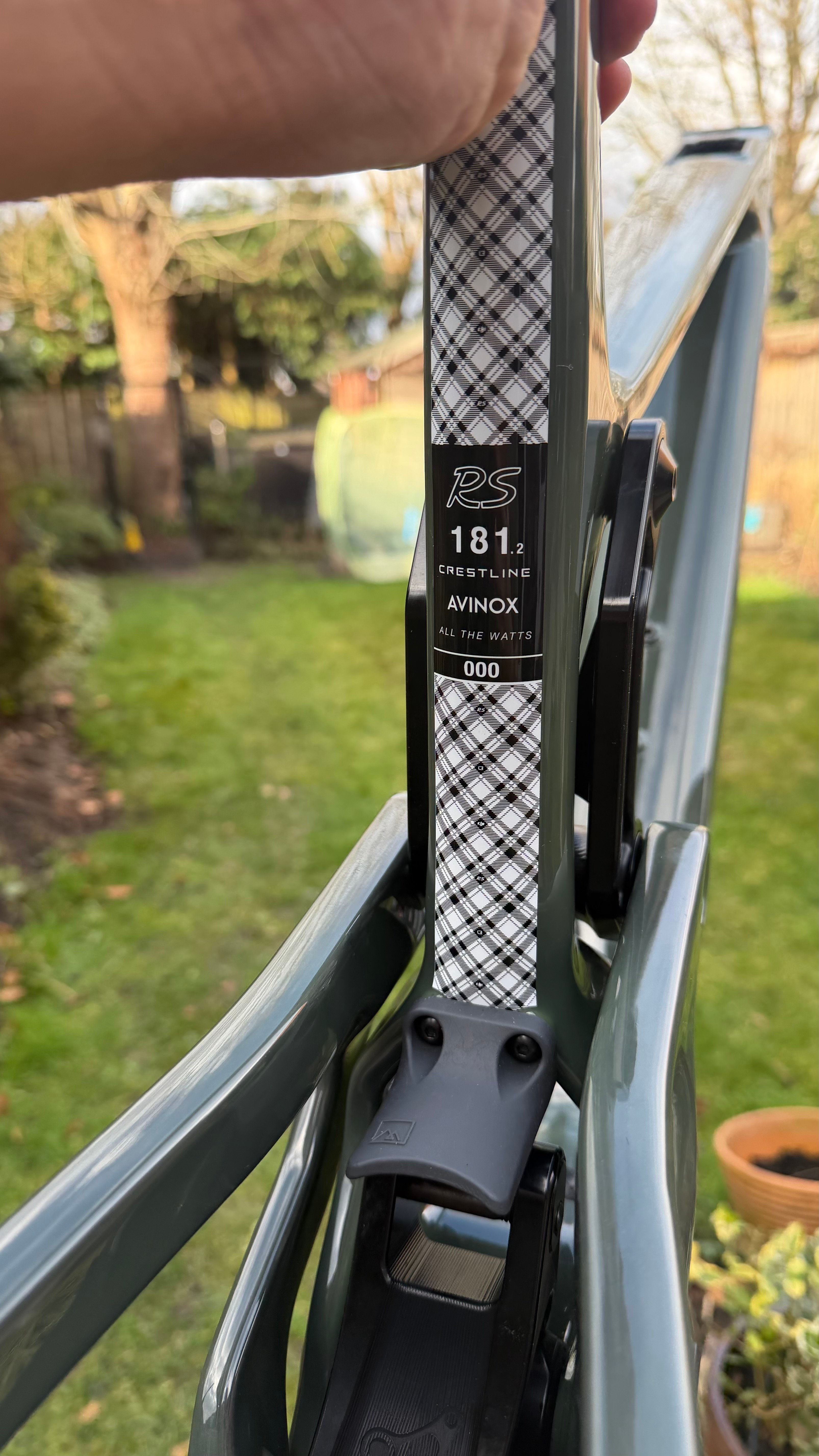

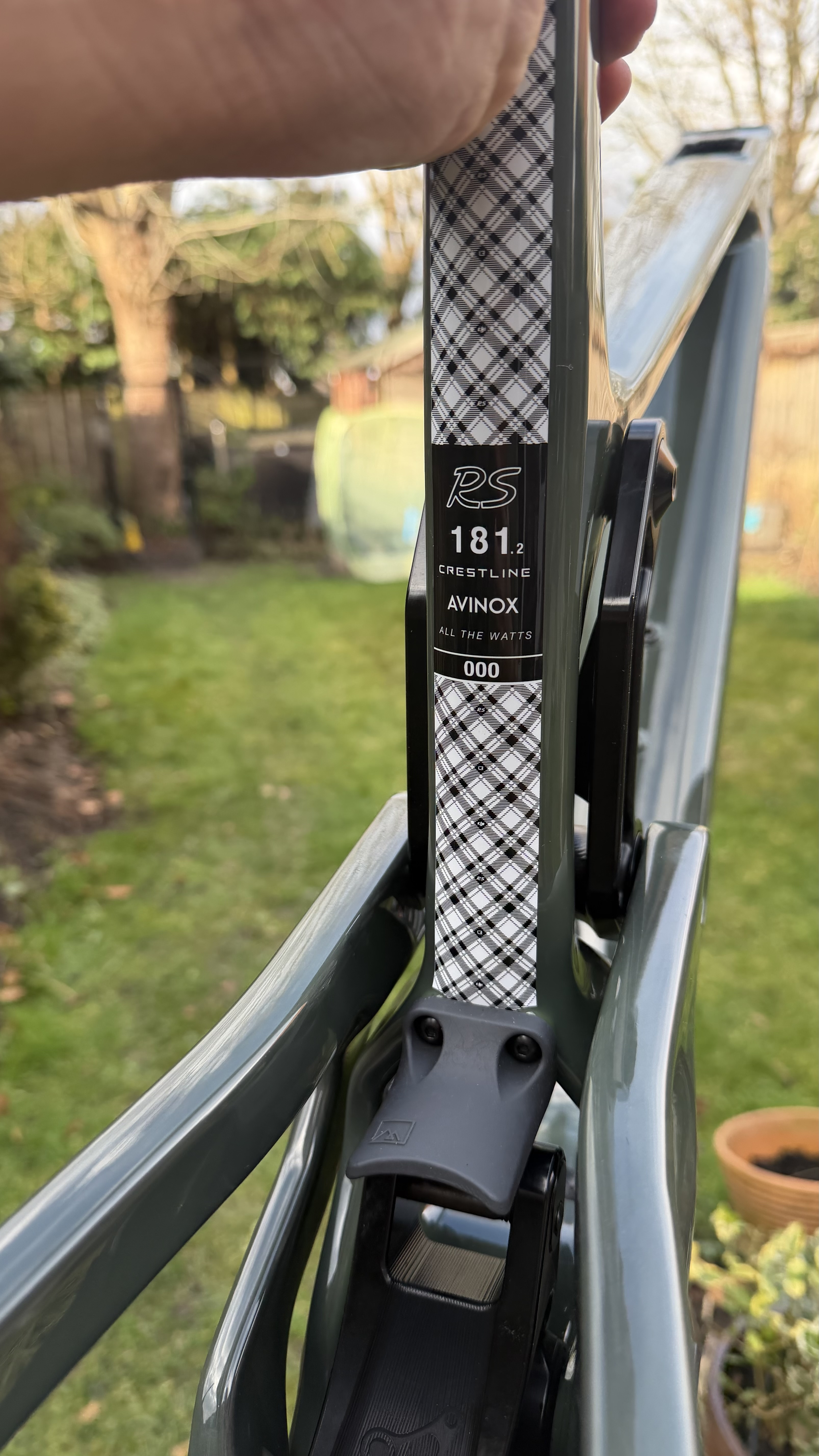

What’s the point of numbering them if they don’t number all of them? A frame number 000 literally shouldn’t exist. The first one made should be 001..
Mostly they are actually samples, to test paint, the strip on the back of the frame etc - Troydon gets several colours to test from the factory, as well as warranty frames (in some cases in different colourways).
The green is nice, but is definitely not going to be as safe as a black/white, so mass making those colours is a lot riskier compared to universally liked black and whites.
Honestly, he could have had these frames painted some horrific neon rainbow, and they would have still sold out 😂🤘🏼

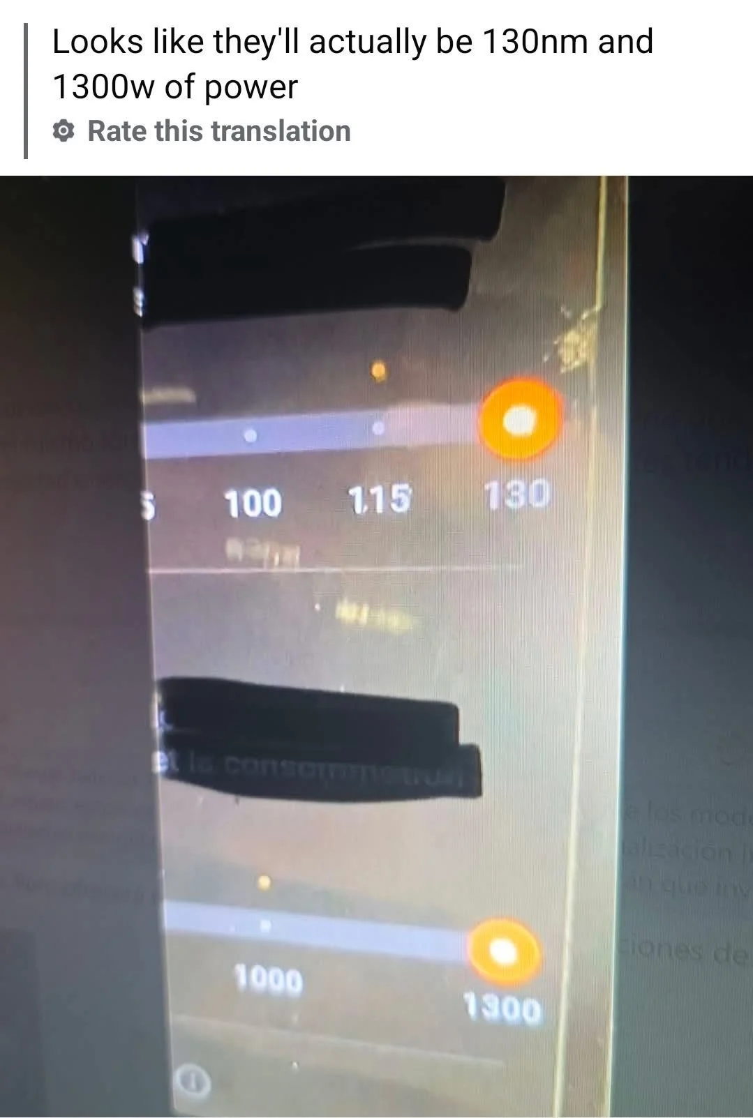

Man. Idk I guess could be cool but I truly think Avinox nailed the perfect power on their first try. I think a lot of people would have preferred same power but lighter if that was even a possibility. I’m sure this will be more power and heavier as all the rumors suggest.
