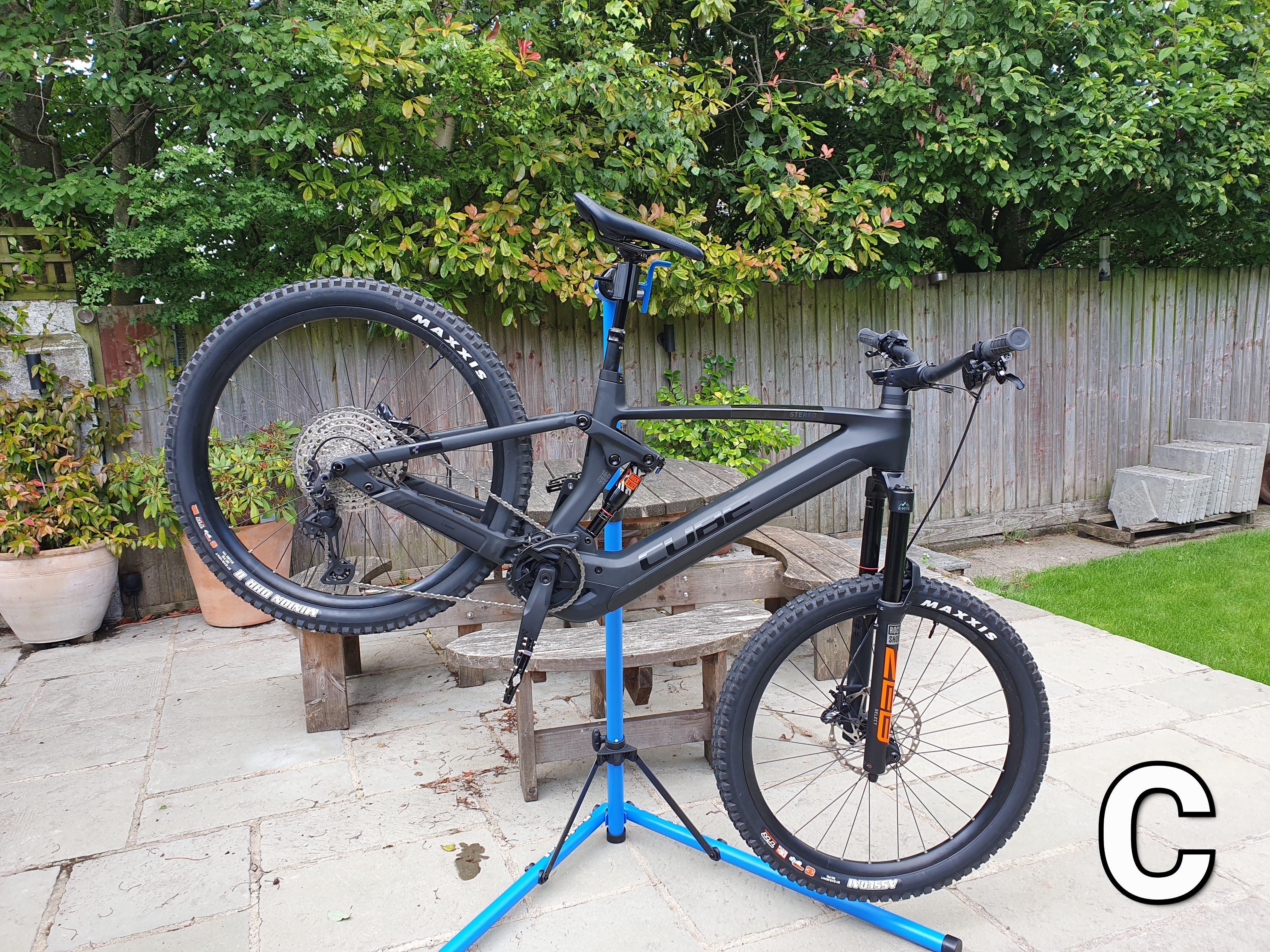

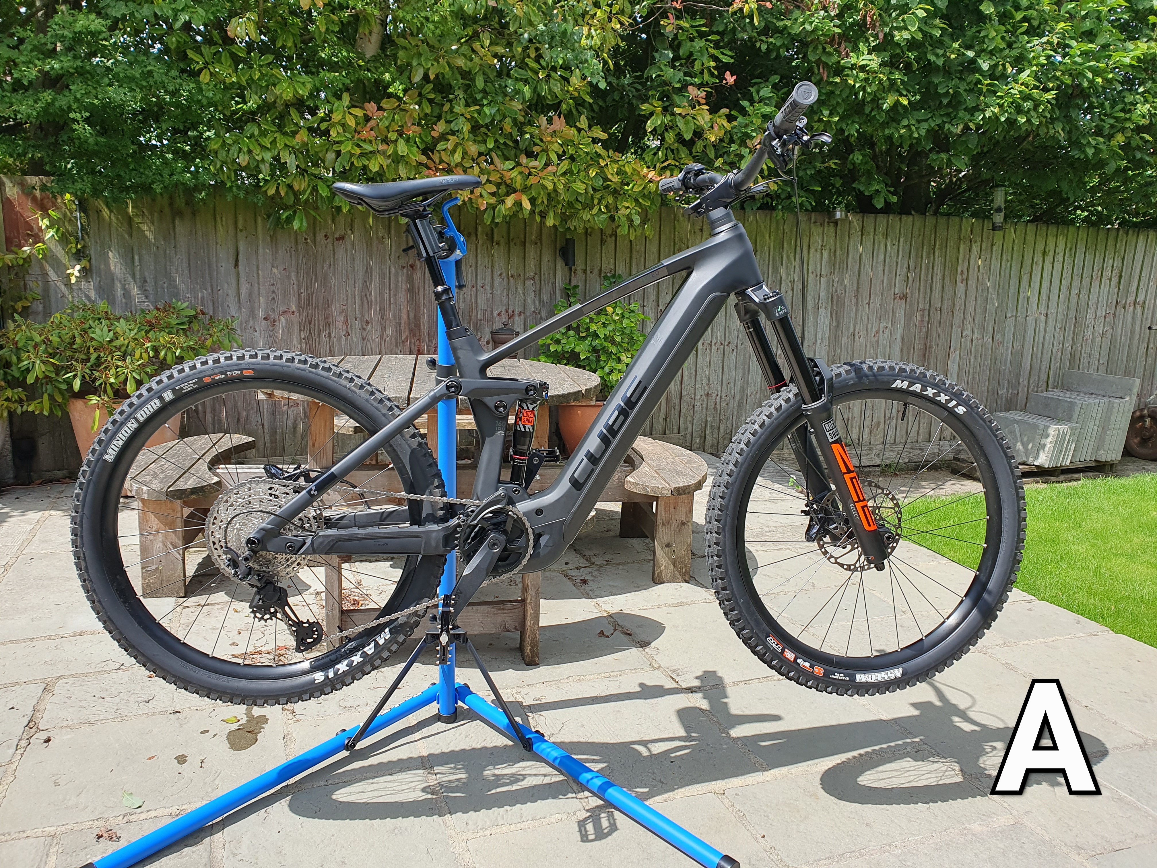

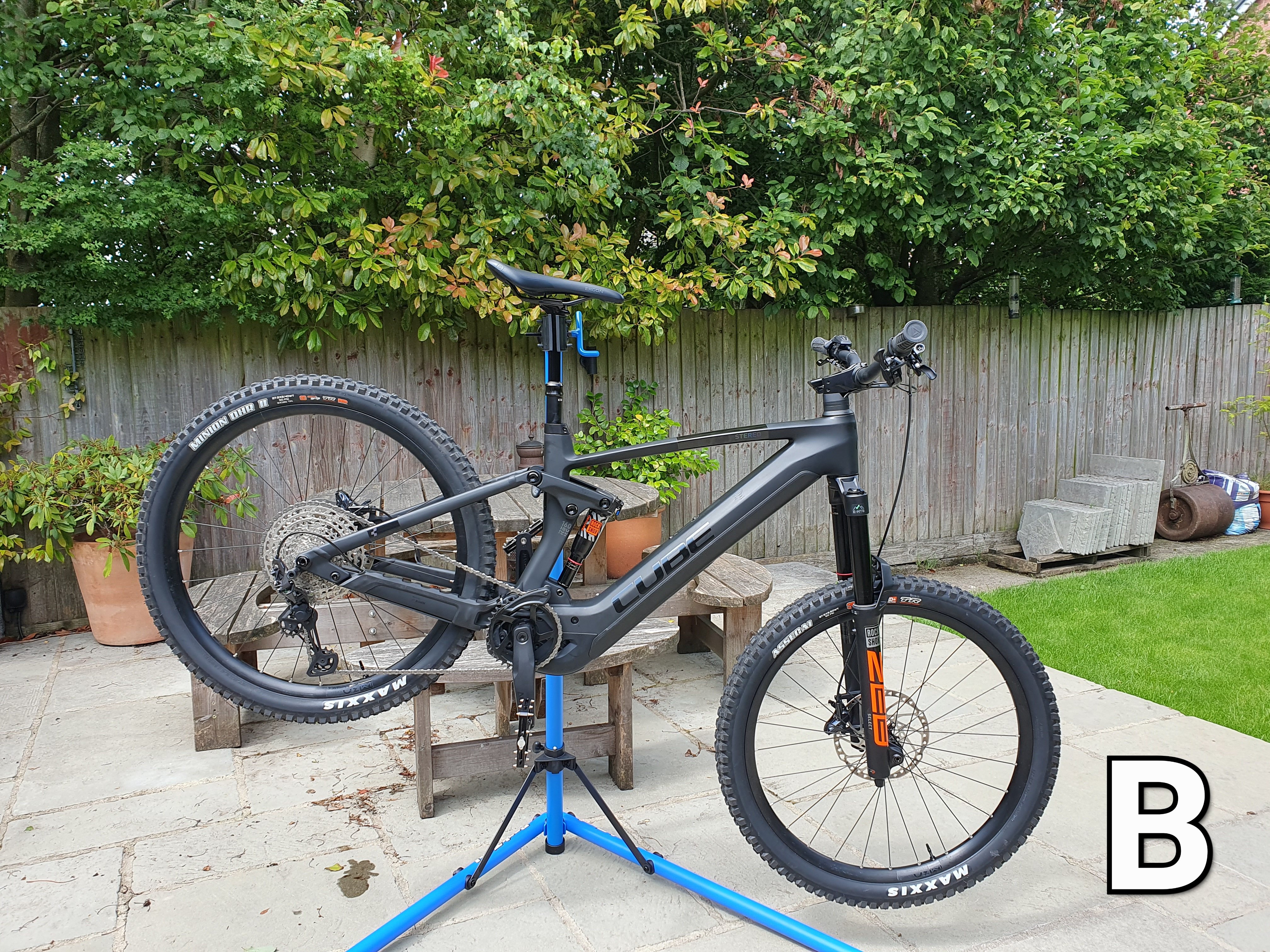

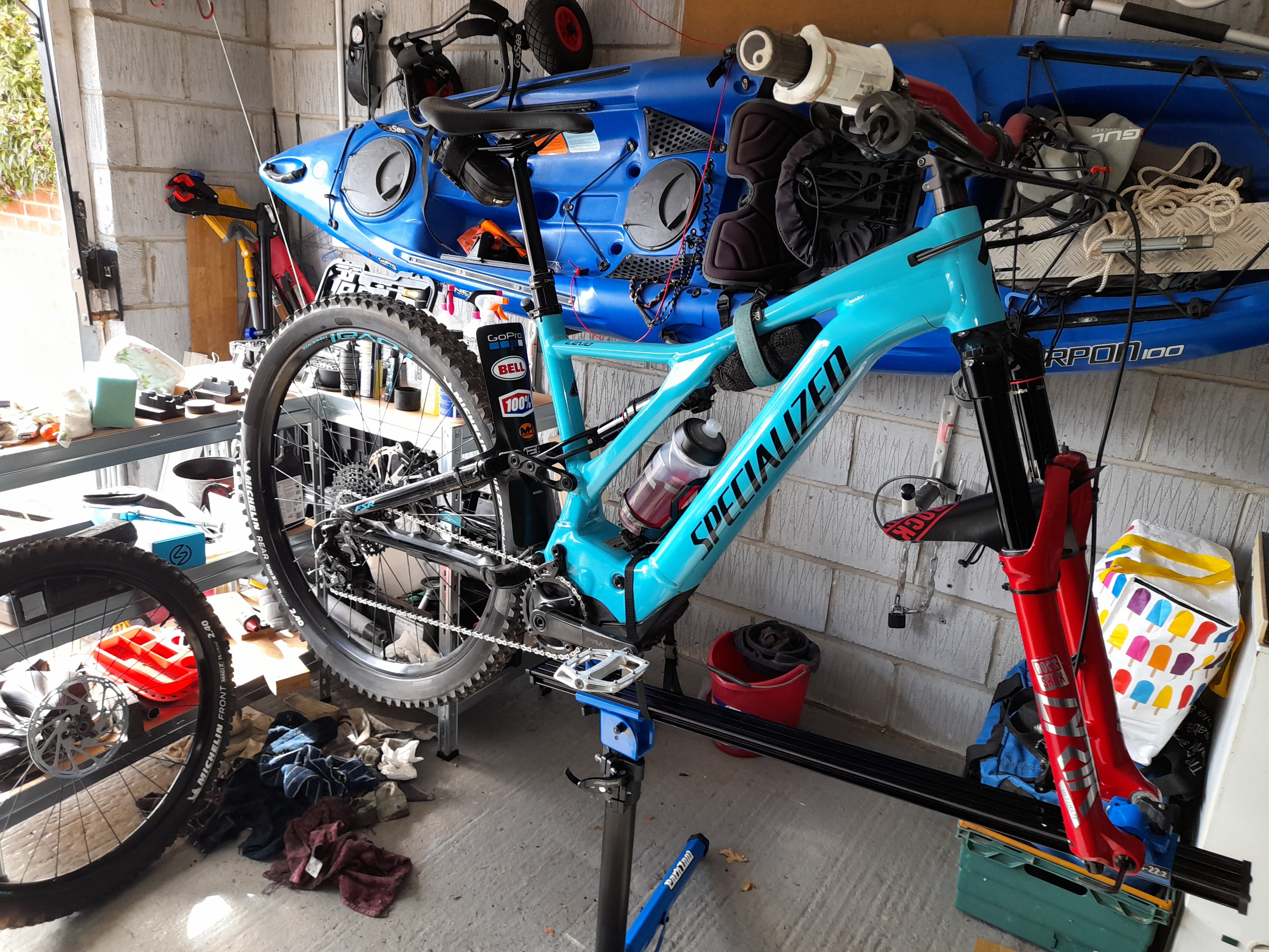

Physics says that hanging my heavy bike level from a dropper post that isn't at the centre mass of the bike is putting alot of stress on the internals of the post (I assume bushes), here:
So which way is the recommended method?
A: Bike level, dropper post at an angle.
(Easier to work on)
B: Dropper post level, bike at an angle. (Slighly less easier to work on)
C: Let the bike find it's own angle. (Even less easier to work on)

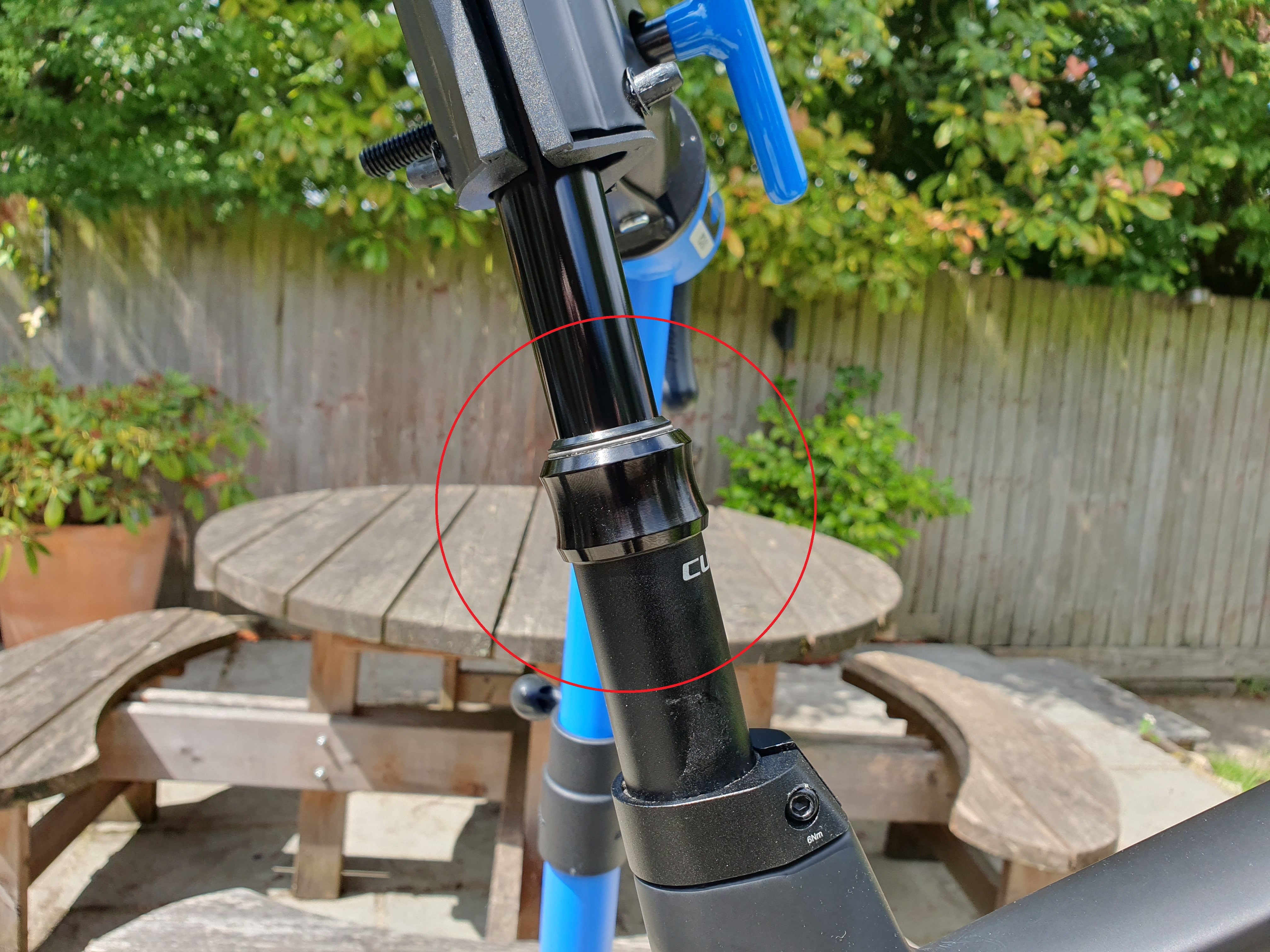

D: Don't be lazy, raise the dropper out of the frame a bit more and clamp the main body of it. (Potentially having the bike at any angle you want without stressing the dropper's internals but potentially stressing the frame where the dropper's body is mounted)(Not Pictured, too lazy 🙈)
E: None of the above (comment below)
Also curious about how others do it, some carbon frames are odd shapes like my Cube and I don't like the idea of winding a clamp down on a carbon tube anyway.

No but in that case you'd likely have both wheels off which would make things easier. I clamp by frame in that case. As long as you're careful I think it's incredibly unlikely you'd damage the frame.
ohhhhhhh, you are sure? I'm at 5 months of battle with cube about that very point. top tube cracked on the sides. Warranty denied based on their certaianty I crushed the tube (I didn't).
I use the dropper stanchion, but leave the front wheel on the ground. If I need to work on the front wheel, I drape the bike over the work stand top bar. The work stand top bar is at the top of the down tube, underneath the head tube. I am not averse to putting the bike upside down on the floor if I need to do some large torque work, like removing the cassette or any work on the BB.
If I was going to suspend the bike on the dropper, I would pull it out a bit and use the dropper body. But I know where the dropper cable is and can do what is required not to jam it up when reverting to normal (unlike my now closed LBS who bent the cable and ruined it!)
The dropper body is fine for me never had any problems
I hang mine from the garage ceiling via garage door rail under the saddle nose, and or (depending what needs doing) via hooks under the handle bars

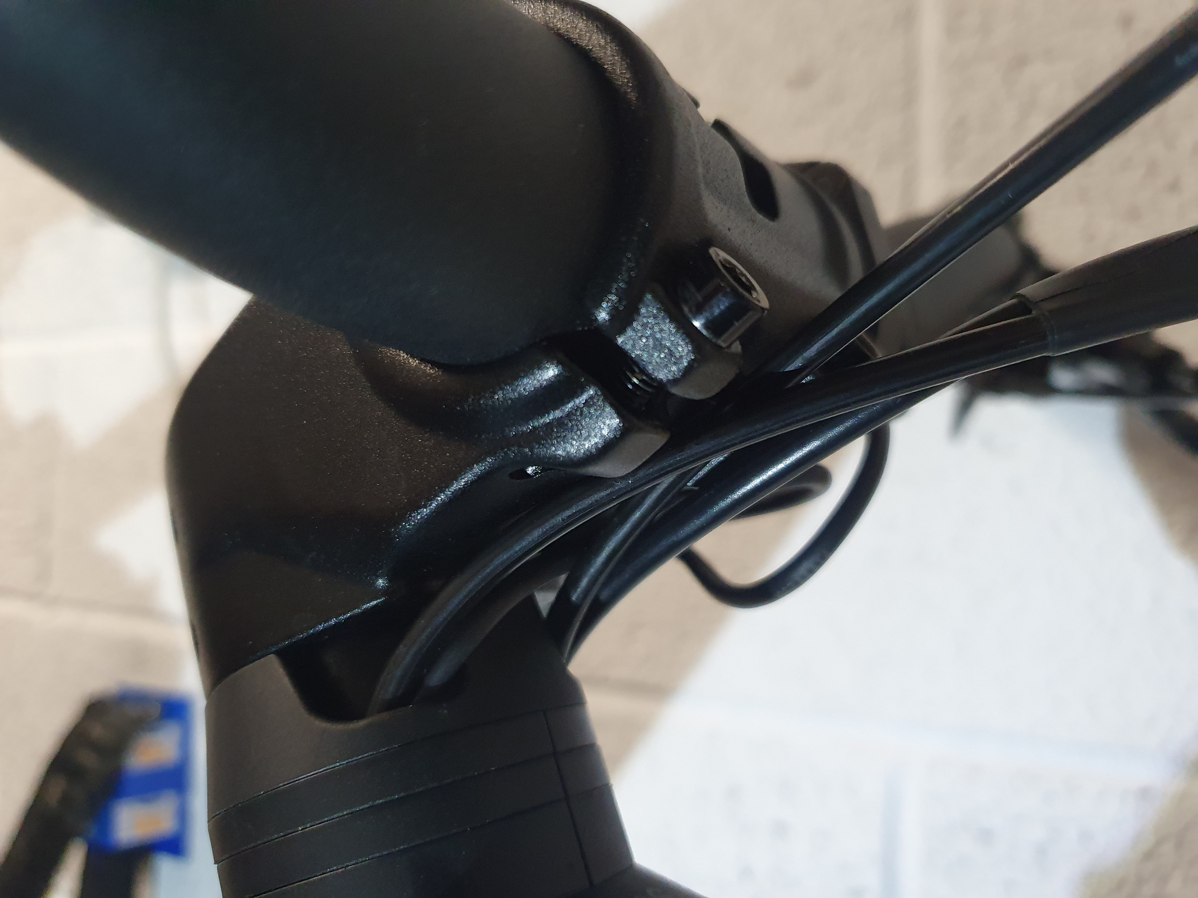

I take it these bike beam/false crossbars are resting up under the stem? Just had a look at my bike and I'm pretty sure it would be squashing the cables if I tried using one?
