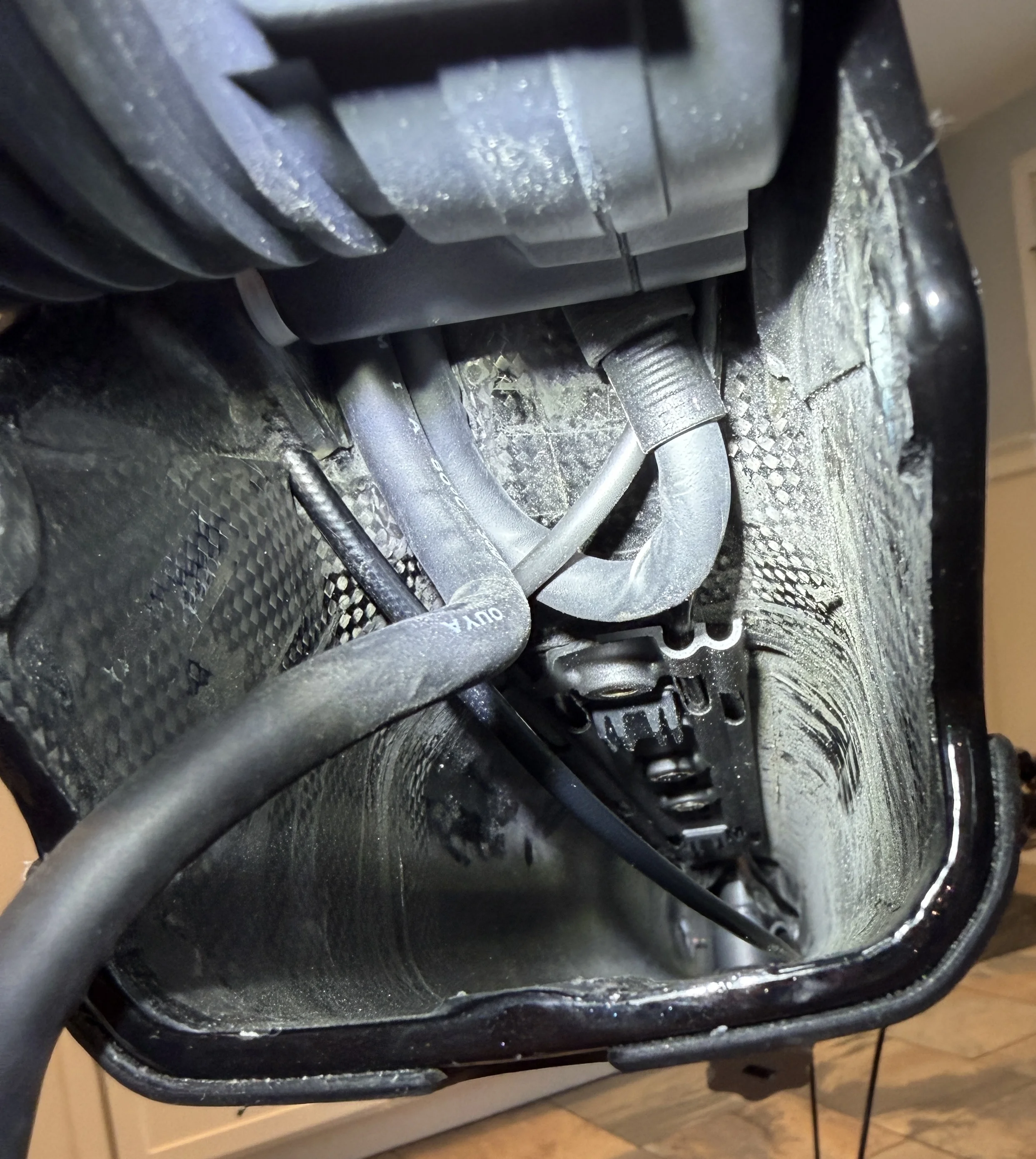

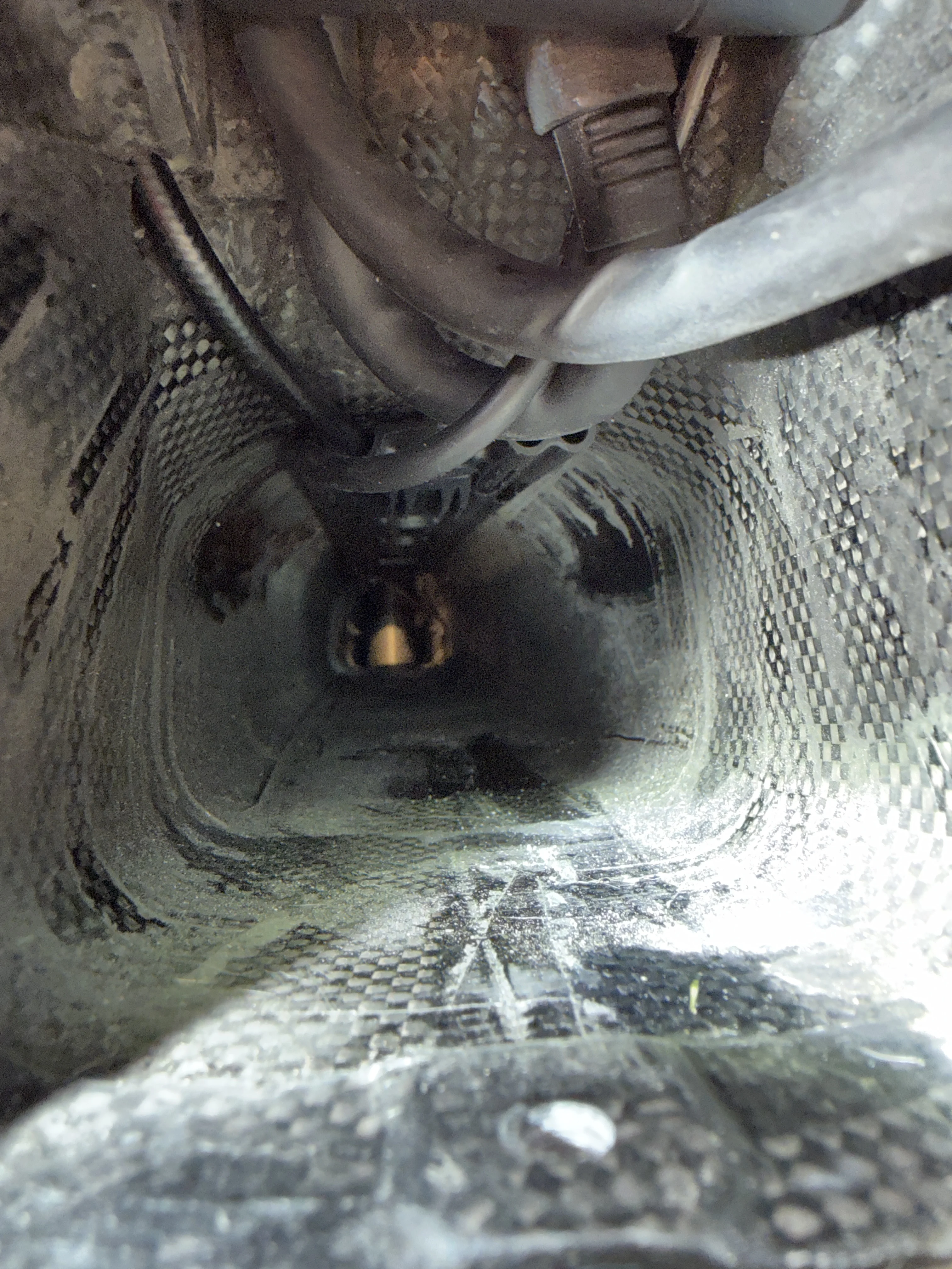

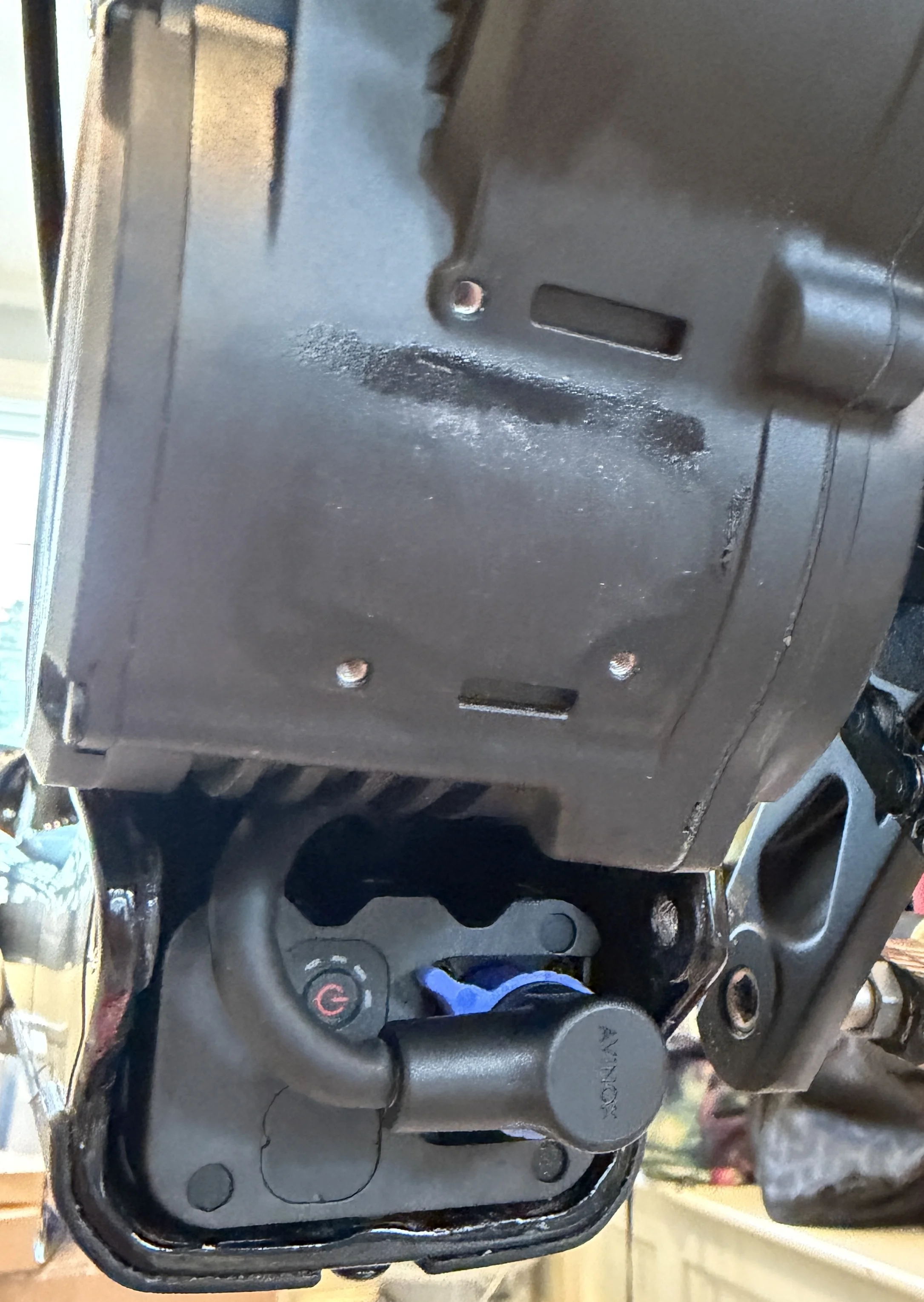

I can confirm that the battery easily comes out when you remove the heat sink on the motor (just three more screws after you remove the cover). I swapped in a better set of brakes and pulling the battery revealed that there is a nice cable management system inside the tube. One tip for those on the same path, loosen the three mounts/screw (two for the bottle cage 6mm and the third below it). This loosens the cable management bracket so you can slide in the new cable easily. Very nice system. This is my second Pivot. They always get the small details right.

View attachment 185162View attachment 185163View attachment 185164
Interesting. So just the motor bash plate then the heatsink screws, and 2x battery screws? That’s a 5 min job if that?

So it seems you must remove the battery to run a new brake line? Unlike the turbo levo where you can just push it through all the way and you don’t even need to remove the port cover! (That was brilliant!)
You can still push it through without removing the battery. That’s what I did initially. It just likely won’t make it through the cable guide, so it could potentially rattle.
I wanted to add some soft tubing and it wouldn’t slide in so I removed the battery and I found the cable guide. It holds the cable tight and does not rattle, no need for tubing.
Honesty, it’s so easy to remove the battery I would not recommend skipping that part.
