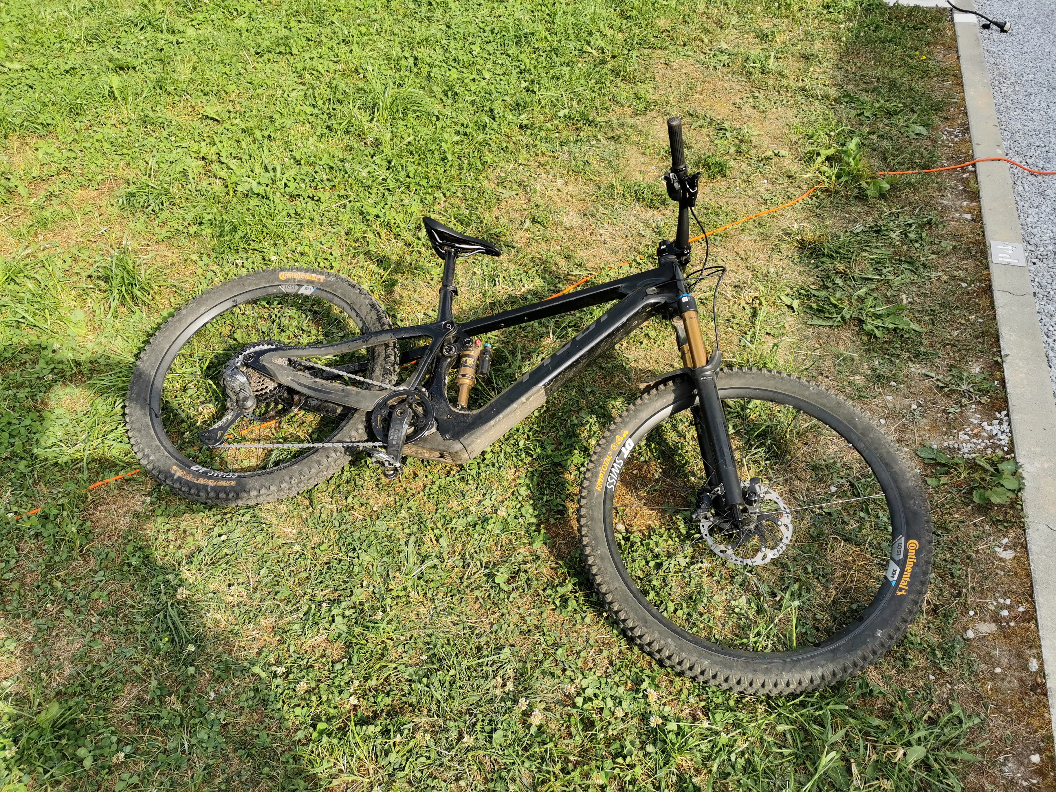

Today I finally had opportunity to properly demoed the bike, luckily I do not regret ordering one at all, the bike it's a 🚀 The motor is significantly more powerful and quieter than Brose 2.2 in my Levo, at higher loads it only delivers high pitch whining noise which is not distracting, no rattle noticed and I do believe this demo bikes have quite some mileage on them, I forgot to check though ... Motor support is very powerful and quite natural, a bit less than Brose but I guess all extra power should take away some natural feeling by design, I was also riding 95% in turbo ... Power is well delivered on the ground, bike in turbo/boost was not like a wild horse on a steep ascents. When I had to stop on a steep ascent, it was a bit tricky to resume riding, like the bike wont give me enough power to start again comfortably, I had to push it quite hard to start and I was in turbo ... Before Ampd I also demoed Shuttle AM and once you try Ampd, there is really no way back ... One thing I noticed, although the bike had the same 210mm dropper post I currently have on a Levo, when I dropped it all the way down, I still felt like it was a bit too high to my liking ... I can't understand why, but maybe it has something to do with different geometry, maybe because of a steep top tube angle ... So I might have to replace it for 240mm travel ... Anyone done that in size Large? How much down were you able so slam it? As you see on my photo below the dropper post when adjusted to my height, sits quite high from the seat tube clamp, almost around 15cm ...
Pivot Demo fleet also comes with Shimano XT brakes and electric drivetrain, which is not my first preference, so I really hope Sram drivetrain and brakes will make me feel like home.
I just checked this by myself: Large frame has 340mm max. insertion depth, OneUp V3 240mm dropper has also max insertion (total lenght-stack height =) 340mm , which means it can be slammed all the way down into the seat tube ... For my height it should be several cm's higher which helps with cable not being kinked too much, which is perfect ... so 240mm dropper shall be 🤣

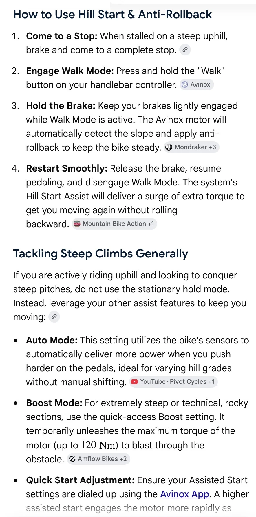

@salko - I’m a bit surprised by your difficulty starting on a steep uphill. I don’t know the factory settings (or whether your demo bike had been changed), but you can adjust “Assisted Start” to five different
response rates for each assist level. A fast response in Turbo should be enough if you’re in a low enough gear. Did you try “Auto Hold” from the Walk Mode? It will provide an extra boost.

Thanks for the input. Yes, probably factory settings didn't have those features set up properly ... I didn't have time to play with any settings, because I just wanted to maximize my ride time ...
