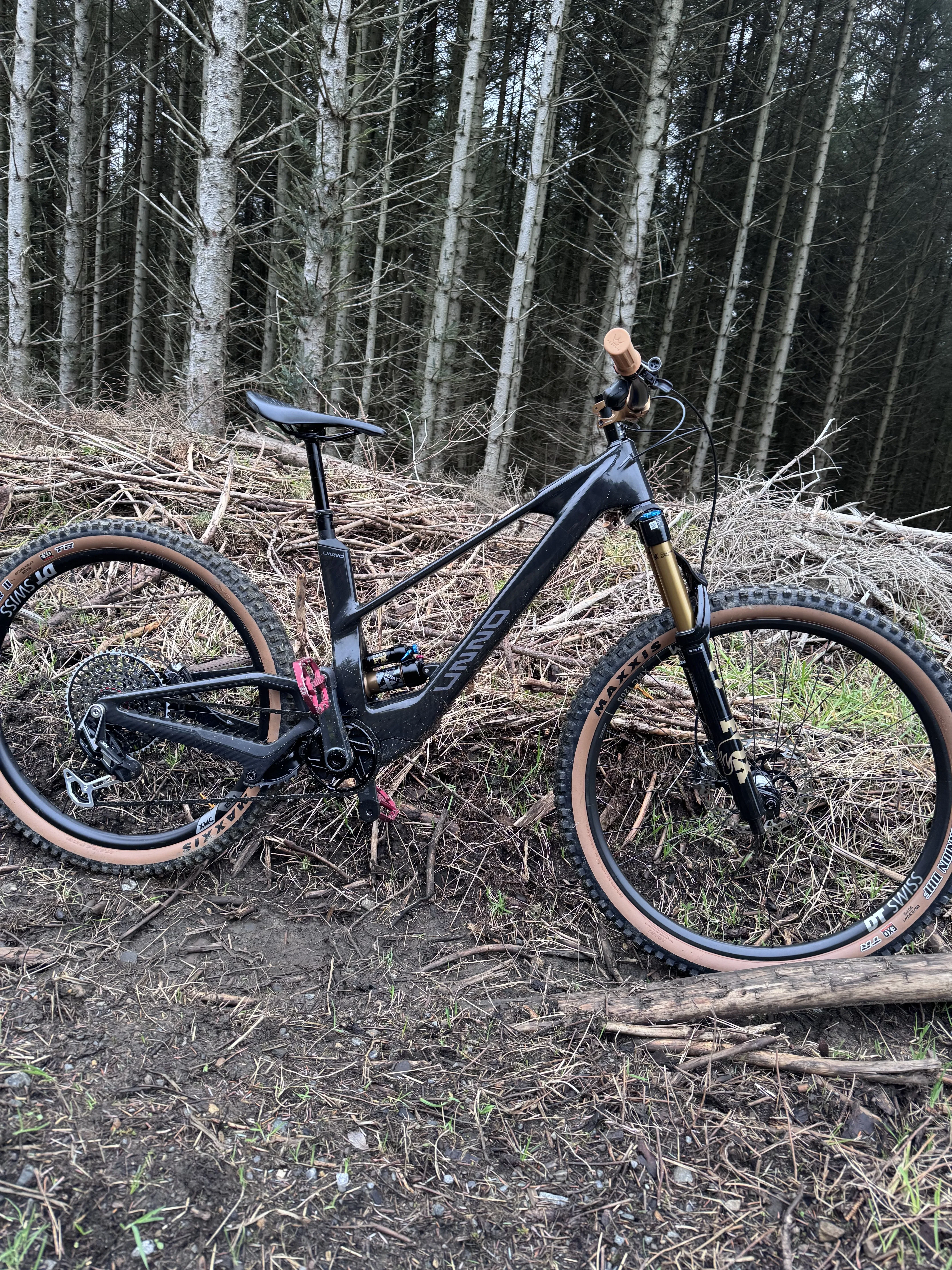

I just bought a 600whr battery for more of a trail build on Unno Mith and it weighs circa 19.4kg I could scrape a bit more off with lighter pedals & saddle. A 600whr battery lasts me fine for circa 35miles as ride in Ecco & auto and I don’t do > 35miles in a ride.

I just bought a 600whr battery for more of a trail build on Unno Mith and it weighs circa 19.4kg I could scrap a bit more off with lighter pedals & saddle. A 600whr battery lasts me fine for circa 35miles as ride in Ecco & auto and I don’t do > 35miles in a ride.
It's decidedly a trail build but wow the weight! I'm not seeing much chub on her, but with the right drive train you could drop another 300 grams or so.
But yes, it proves my point, with a high-end trail build and a 600wh battery, any of these non-HP CF e-bikes can be quite lightweight.
