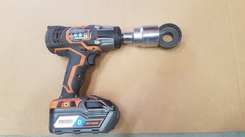

Only thing I can think off is to create a notch on the old chainring material still stuck on the motor with a Dremel. Use a screw driver or something on the notch to prevent it from rotating, then try to remove the locking (making sure one is trying to remove the lock clockwise) using an impact wrench. Locking is only supposed to be tightened to 35 to 45 nm. If somebody tried to remove lock ring counter clock wise, probably over tightened it.

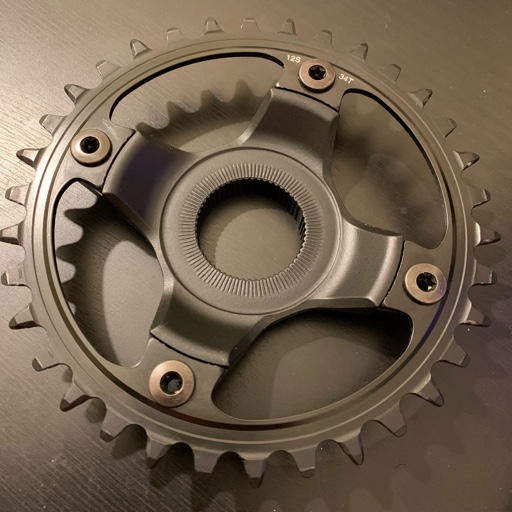

With this piece breaking, probably a be a good idea to proactively replace it with the Shimano Spider and Chainring (34T) compatible with the 12 speed Shimano chains - SM-CRE80-12-B as it would be quite an ordeal to remove that lock ring without being able to lock the chainring in place during removal (with the chain, or a chain whip tool).

Shimano Spider for 53mm chainline: Y1VY00020

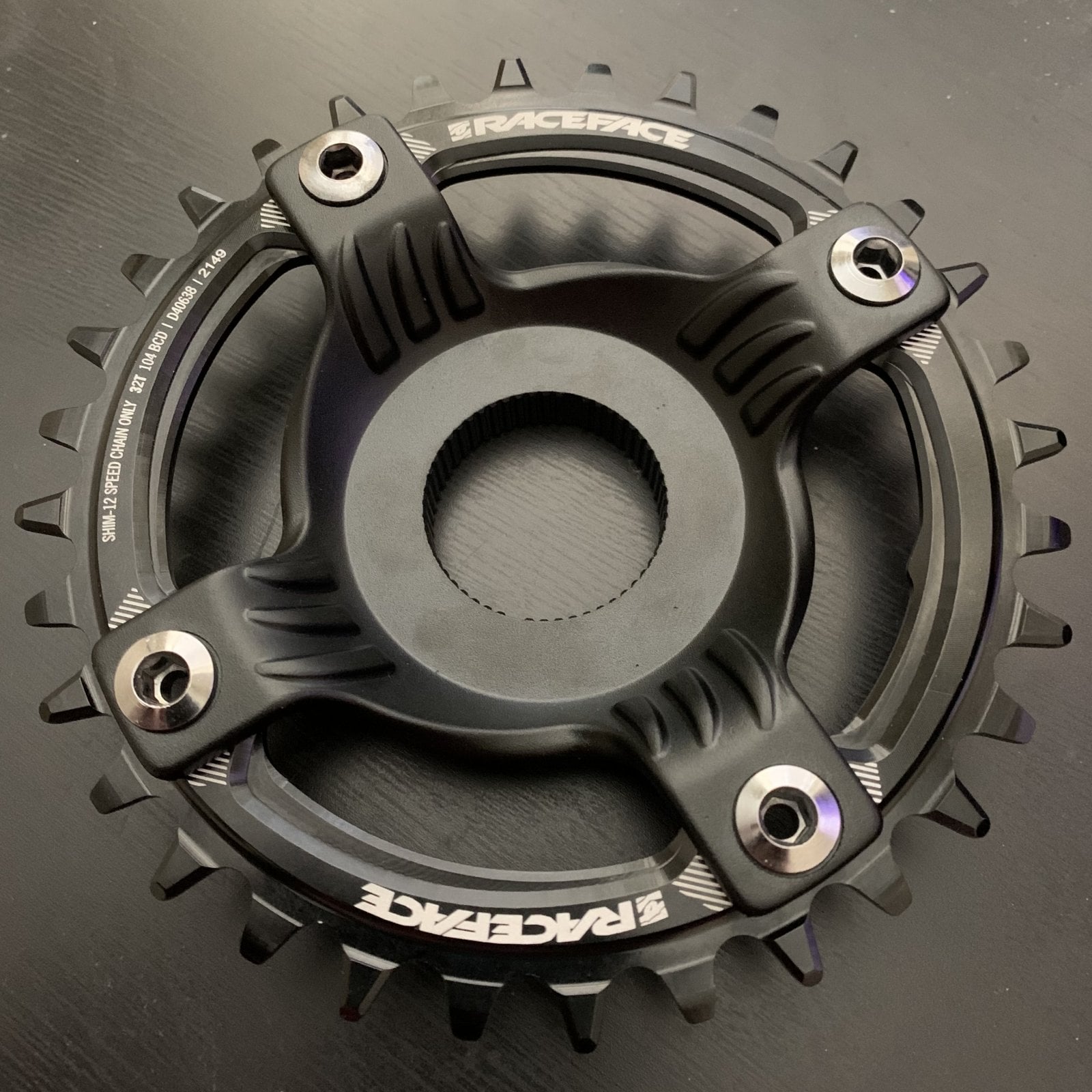

FSA Spider for 53mm chainline: CR1770 (Manufacturer Part # 380-0455000050)
as for chainrings
Wolftooth sells 104BCD , 32 T, Drop-Stop ST (forShimano12 speed)
RaceFace sells 104BCD, 32T for Shimano 12 speed

Either these two work.

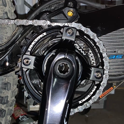

My H39 came with the full power firmware, first thing I did when I got the bike was replace the chainring with the FSA spider and the 32T RaceFace Shimano 12s chainring
FSA spider with RF 32T installed on my bike
Below is the Shimano 34T for Shimano 12s with Shimano Spider (53mm CL)
Here’s the FSA Spider ( 53mm CL ) with the RF 32T Shimano 12s chainring
