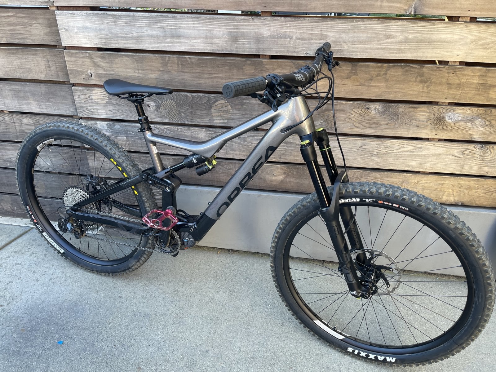

New member here and wanted to share some information on my new Rise H30 upgrades and feel. See below:
-handlebars, RaceFace SixC Carbon 35mm
-160mm DVO onyx front fork (36mm stanchions).
-DVO Topaz rear shock
-Moved the Maxxis Dissector tire to the rear.
- Maxxis Assegai tire in the front.
-Shimano SLX 4pistons (metallic) front and rear.
-203mm Shimano rotors SRT 86
-RaceFace Atlas pedals.
-IBIS S35 29er wheels.
CHALLENGE
The whole process was fairly straightforward, other than the rear brake hose replacement. This is Needed as the stock hose is a SH59 vs SH90 for “real” brakes. Internal diameter of these are different so you should change these.
I tried feeding the new hose by attaching it to the old hose with a small threaded screw (with a cut off head), as suggested by another member. Unfortunately the old hose managed to break off…
Was left with the option off routing it solo.
Had to drop the motor and battery, which was
Time consuming and also required a couple of new tools to remove the chain ring (LRT2-PARK) and a tool to remove the connectors. Struggled with reinstalling the battery as the cables/hoses needed to be specifically aligned.

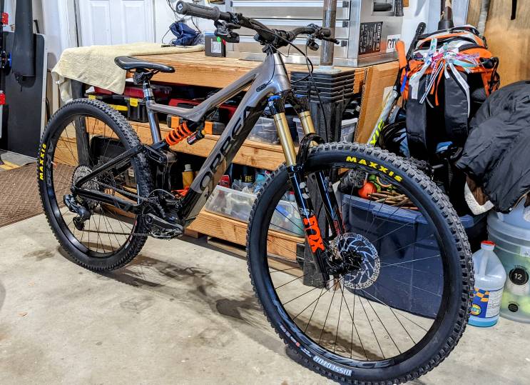

Here's my upgraded H30 so far.
Fox 36 factory at 160
Marzocchi Bomber CR (SLS spring)
AXS XX1
AXS Reverb dropper
OneUp bars
Will be moving over my i9 1/1 Enduro wheels over once I get my new tires. Schwalbe magic Mary and big Betty. View attachment 80708
Forgot about brakes. Got a set of Deore 4 pots and 203mm rotors on the way. Going to use the existing brake hose. I have been super happy with the Deore brakes on my Ripmo AF. Best bang for buck breaks out there I think.

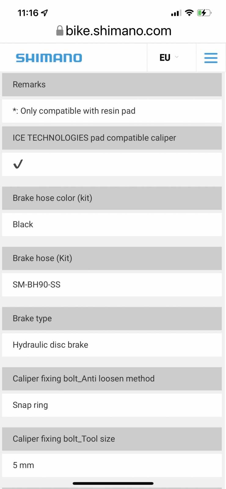

Hey. Interesting build. Those thin brake hoses you spoke of. Are those due to the 2 pot calipers or the budget brakes. Are the hoses in the 6100 brakes suitable for a 4 pot caliper upgrade? I never heard of anyone complain about them before. Thanks.
They are a result of the super low end brakes that came with the bike, MT410. Those hoses are SH59, but if you have 6100, those brakes come with SH90, (see pic from shimano website)so you can easily swap the caliper and lever and keep the hose…. It makes life way easier!!!!

Nice set up! Is your shock stock length and travel, 210mmx55mm?
I’m also coming from a Ripmo and was waiting for an ibis ebike, but just ran out of patience.
What is your take on Ripmo vs Rise with respect to handling?
You likely won’t be able to use the same hoses with your 4 piston Deore brakes unless you find the right banjo fitting/adapter. Even with that, I’ve read that you will get different brake pressure. Please share if you manage!
kotto25
Oct 27, 2021
36
24
New Jersey
Thanks. I absolutely love my Ripmo AF. I actually haven't even ridden the Rise yet (other than up and down the street) due to the weather. I love MTB but have zero interest in riding in the snow. If the Rise rides 80% as well as the Ripmo I'll be happy.
Sucks to hear about the brake hoses being different. I was under the impression I could use the existing hoses. The 6120s don't use banjo connections. It's not the end of the world I'll just have to drop the motor again to run the new hose. Or maybe I'll get lucky and be able to pull the new hose through using the old hose.
