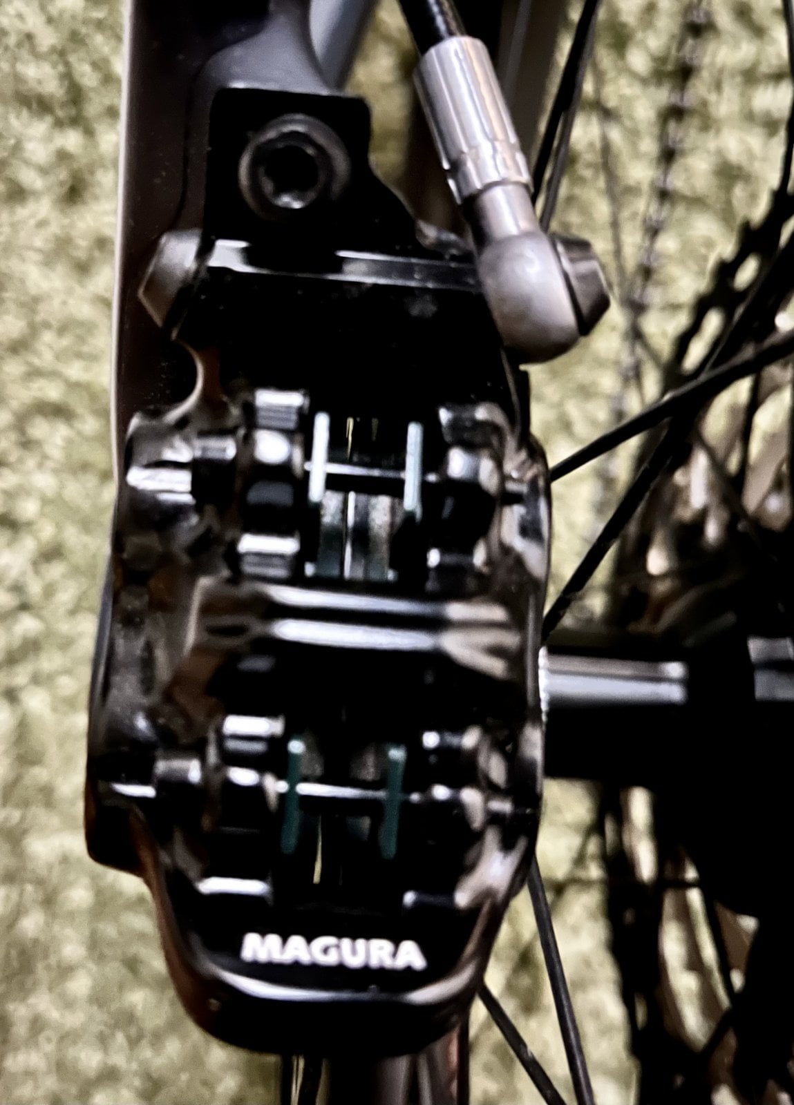

Glad you're happy with it. Have to wonder though - are you one finger braking with it?
To be honest I'm not really sure, I've been biking for so long I have no conscious thought about it when I'm braking on the MTB :D If I had to make a statement in court I'd say probably 2 when I'm on a descent - just as I did when motorbiking or descending on the drops on the road/cross bike.
The EX does look really nice.

These are probably the sort of bikes where I don't really need 3 fingers on the grip all that much I if I'm honest; but it's what I'm used to now, and I guess it's why I like properly powerful brakes. Hadn't really thought about it until now.
