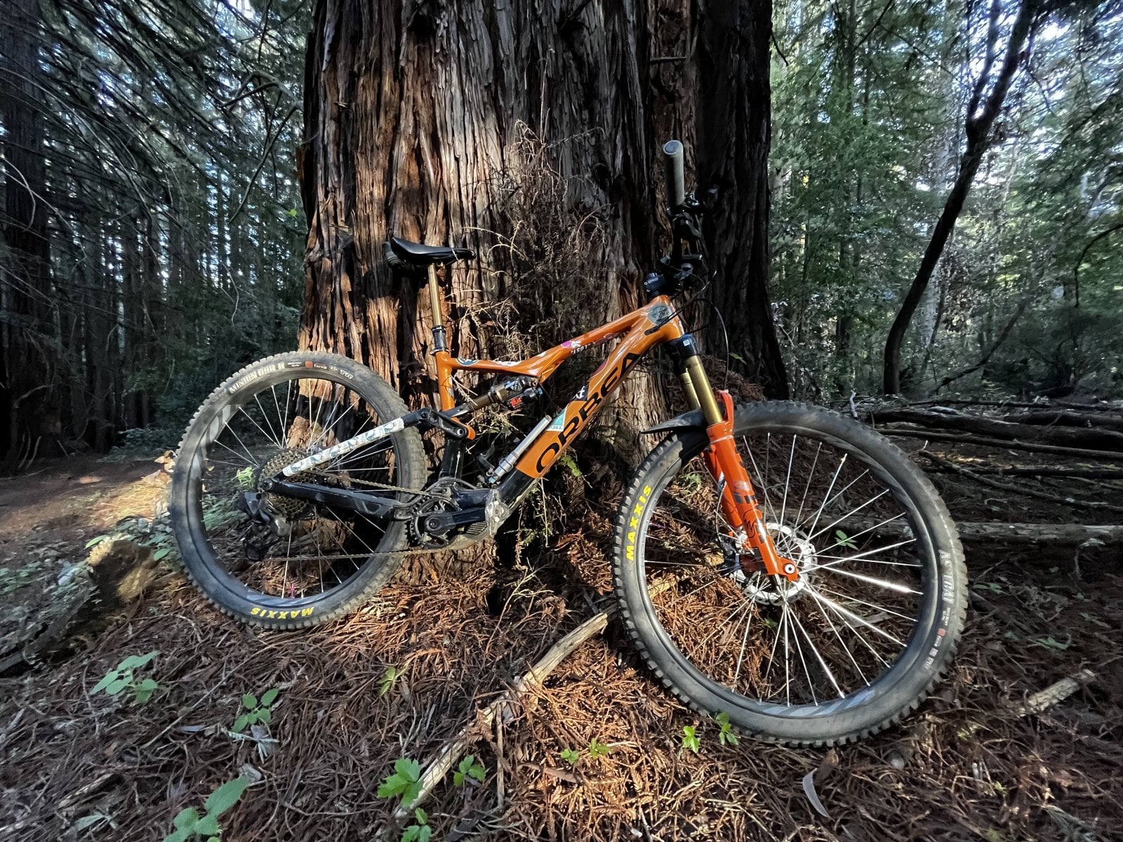

So the first round of upgrades are complete. At this point the only other things left are to add GX AXS at some point, a Transfer 175 and some carbon wheels when available.
I find my M20 pretty much perfect as is. Just needs a display and some good carbon bars which I bought but have yet to install.

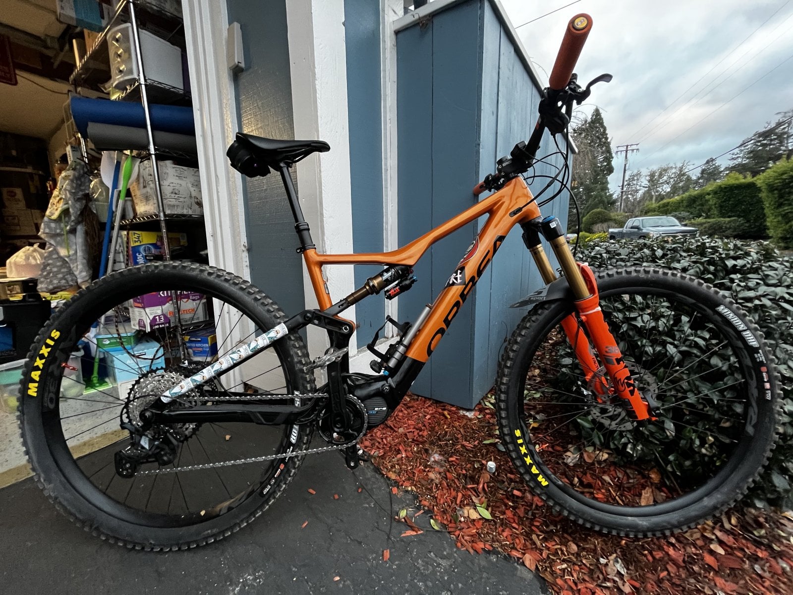

So, the H15 is now actually delayed until summer as well. I ended up finding an 2022 M20 in stock, with a discount. It’s the white/green color way and as someone who always wears black/had black bikes, this will be a nice change haha!
I’ll upgrade parts as I need it but first going to see what the stock parts are about. My Levo was all stock (besides a Fox 36 upgrade), and I loved that bikes. I’m stoked!

Did you keep the travel or did you change it? Also, what length dropper is that , 170?
Thanks. Went to 160 on the fork. Dropper is 170mm. I'm 5'10'' and on the size large I have to have it completely slammed. Seat tube is pretty high on the Rise.

Did you leave rear travel as 140?
also, do you reckon oneup 210 dropper will fit ( slammed ) , thx in advance
sweet, yh I'll do the same on my h15 when I get it ...
Left the rear at 140 for now. Sorry, not sure about a 210 fitting.

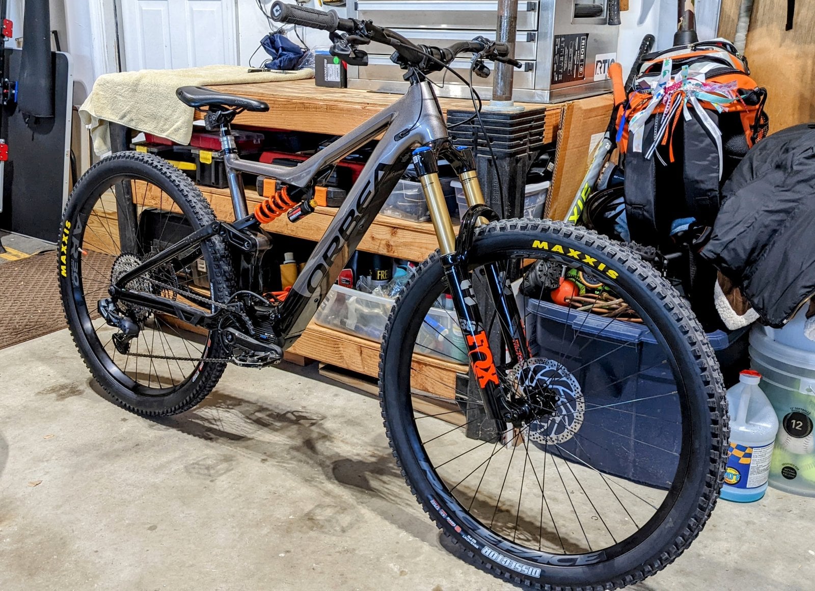

So I am finally all done with the upgrades to my large H30. Everything changed out except the cranks. Started at 46.4 lbs without pedals, ended at 45.8 and a much more capable bike. I have had a few notable issues with the bike so far. The seatpost took a shit within a month and was replaced with a NOS post that I will shelf until time to sell. Next up I have had the motor cut out at ( mostly ) slow speeds and throwing a W101 error which is a loss of the speed sensor magnet, working through this issue with my dealer, worst case it could lead to a new motor. Lastly is charger issues, a majority of the time the bike will charge to 86% or so and stop as verified by a Garmin. Every now and then it will go through to 100%. I figured out a work around to unplug the charger, cycle the power on and off and plug it back in. Unless you have an app or Garmin synced you may not even know you have an issue. Orbea is sending out new chargers to myself and my two buddies that picked them up in the first batch to the US via Mikes.
