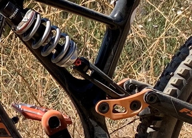

Offset bushing "pushes" the shock back 3mm or so at the eyelet. Obviously, that's not 1x1 distance wise, but once you are at full compression the shock yoke (black thing that connects your shock to the CC or stock link) is pretty much in line with the seatstay bridge. The CC link changes the position of where your shock yoke is mounted (some of how they get their effect on the leverage curve).
Flipping the chip to high does the opposite of what an offset bushing effect is - so you would not see what I am talking about and should have great clearance. It only happens when you have Lo +_ Offset bushing + CC link (a rare combo). Keep in mind, that i am close, but not touching with stock bushing, +flip chip in "Lo" + CC link.
My solution right now is no offset bushing (though I have a 50% offset bushing in route). It will put me at 64.25 deg HTA with the 170mm fork as well. I may add a small spacer to the EXT shock shaft to limit travel slightly as well. Again - I am probably in the minority with pretty drastically changing my levarage rate + geometry.

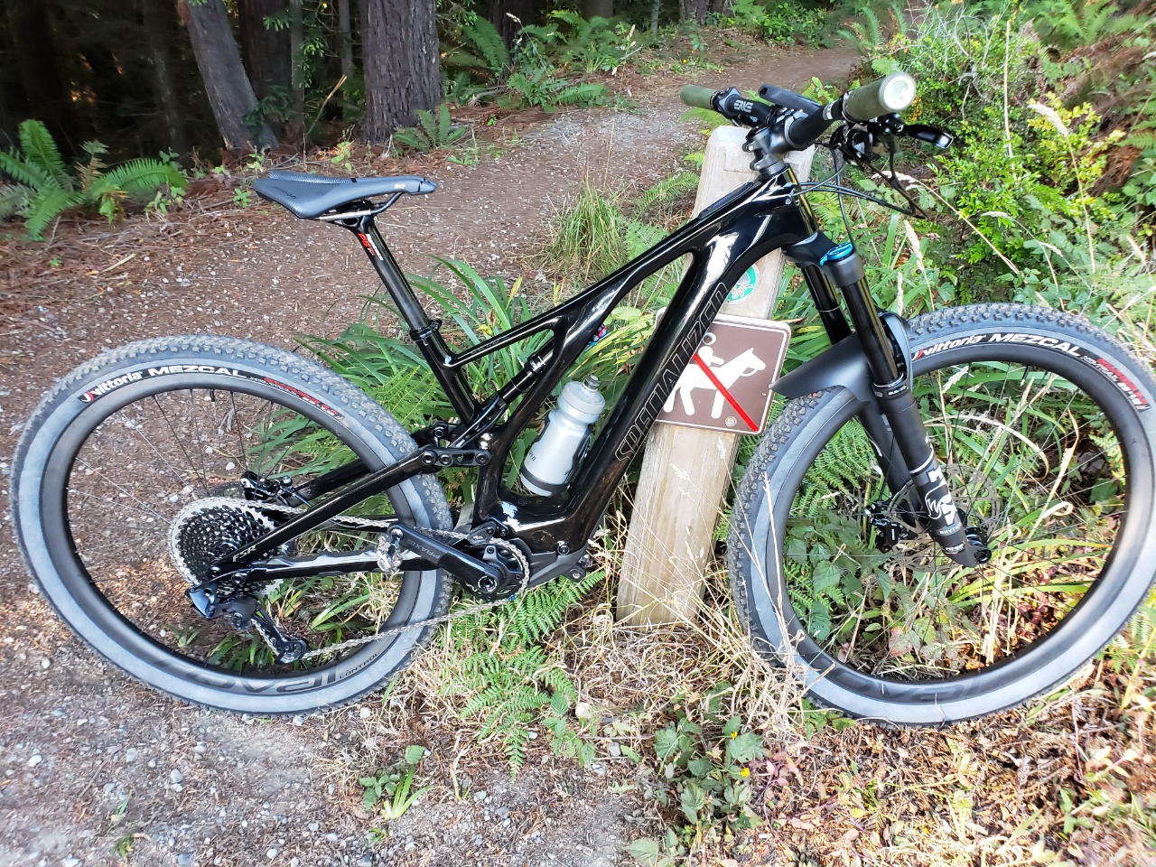

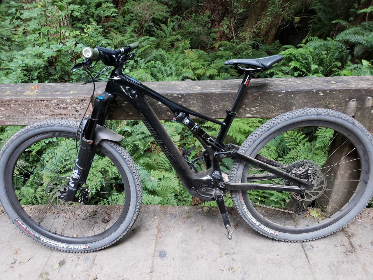

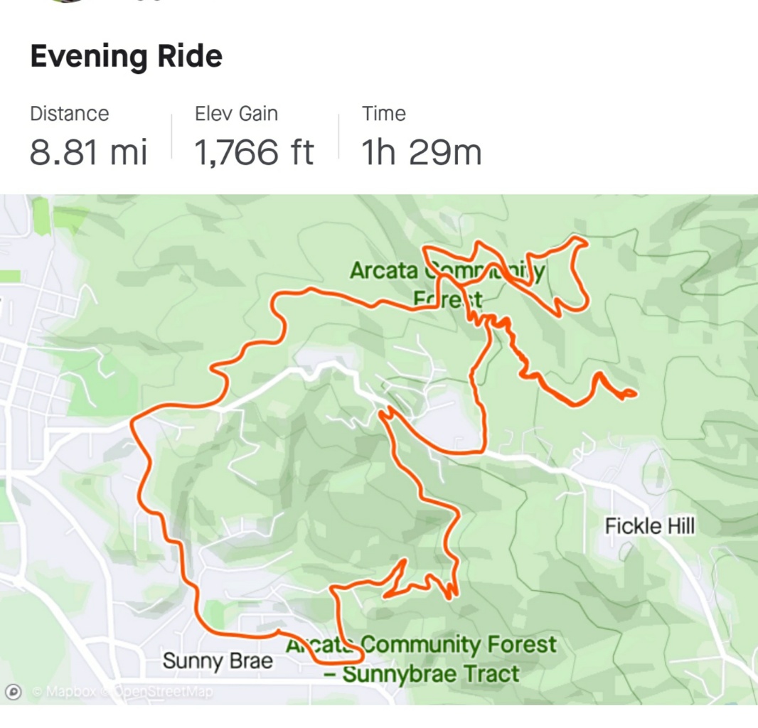

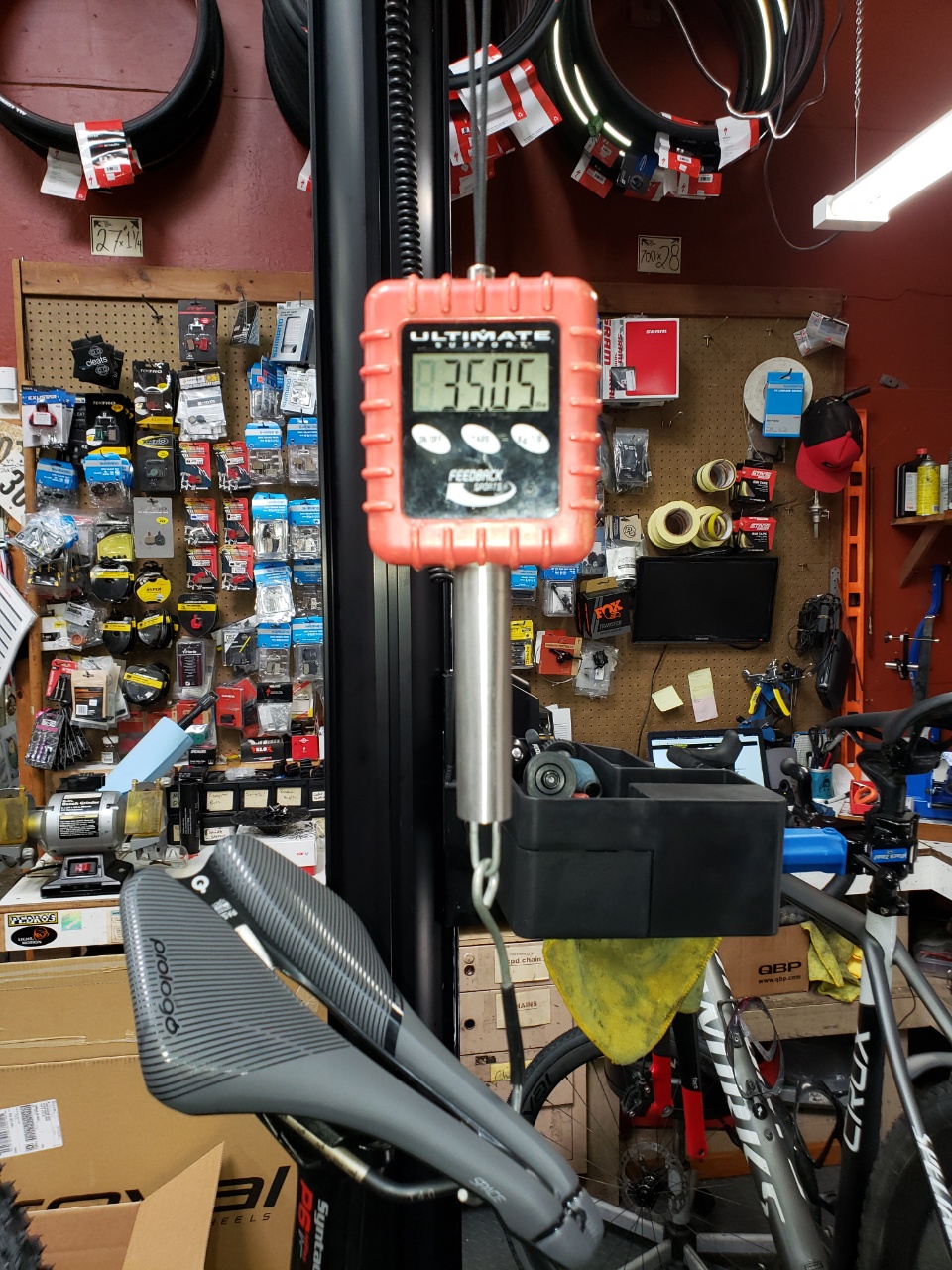

Today was my big day! First ride on my new 2021 SL Carbon Comp! I'm 156 lbs., 5'8", 29" inseam and the Medium fit me just right. Since my days of hard core-riding and fast descents are over (several surgeries to show for it) I decided to weight-weenie my bike. Brought it down to 35.05 pounds (without pedals). I did about half of my ride unassisted. The rest in Eco mode, set at 30-45%. I only used 15% of the battery. Here is what I changed:
Roval Control Carbon wheelset
Vittoria Mescal 2.35 tires
Tubless (Stan's sealant)
Sram X01 Cassette
Sram X01 chain
Sram Eagle GX 520% derailleur
X01 Shifter
Prologo saddle
Ergon GE1 grips
Syntace carbon seatpost and Cane Creek adapter (yes, I removed the dropper)
Eve M6 carbon handlebars
The bike shifted flawlessly and the new Guide RE brakes performed well.
