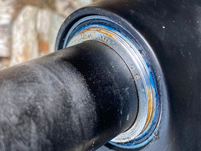

Hey guys, I'm thinking about upgrading the bars on my 2020 Expert Carbon to carbon bars.... who else has done this and what do you think about your choice.
Mine had developed a nasty clicking sound from the headset when I pushed going up hill (I have the bike unpowered 95% of the time) so took the bars off and looked at the top of the headset. It was as dry as Bin Laden’s flip flops and already beginning to rust. Obv all greased up and back together noise sorted.

If you haven’t had your front wheel spindle out yet I would check that too. Had bit of a job on getting mine out the other day and had to resort to tap with round bar from behind. Quite a bit of rust from bearings but oddly they feel smooth as smoth with no play. I’ll be taking the outer seals off ASAP and re packing with grease.

Same here, the headsets on specialized bikes are a joke. Specialized really, really cuts corners on the small details. Share holders must run their business model.
Stripped my headset out today expecting the worst (over 1600 miles, 98%dry miles mind you)
and pleasantly surprised how well greased everything was, including copper slip on the thread for tensioning the headset!
ya, I'm always surprised how little grease is put on pivots, headset etc by manufacturers. same true with suspension forms. often I find little to no lube in new forms.
seems weird to have to pull a new bike apart and regrease everything but u almost have to.
found my SL pretty well greased when I installed the CC link. setset not so well greased.

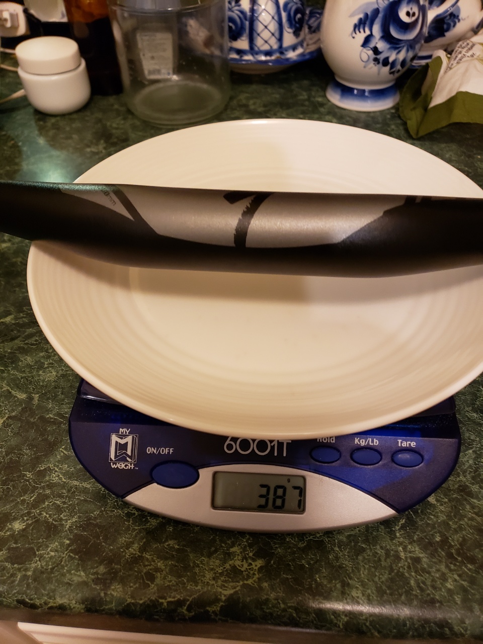

Does anyone know the stock handlebar weight from memory when you’ve swapped them out?

Regarding the stock handlebar weight...

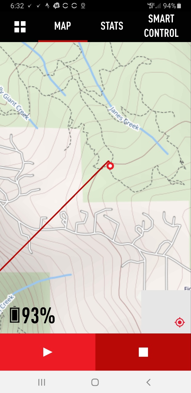

So mission control is connected and working fine except the "Let's Ride" function. It disconnects from my bike shortly after I press "start" and this is what I get. My phone is an Android (Samsung Galaxy 9). Any suggestions?
I had the same problem. Check your phone is allowing Mission Control access to GPS while the app is in the background.

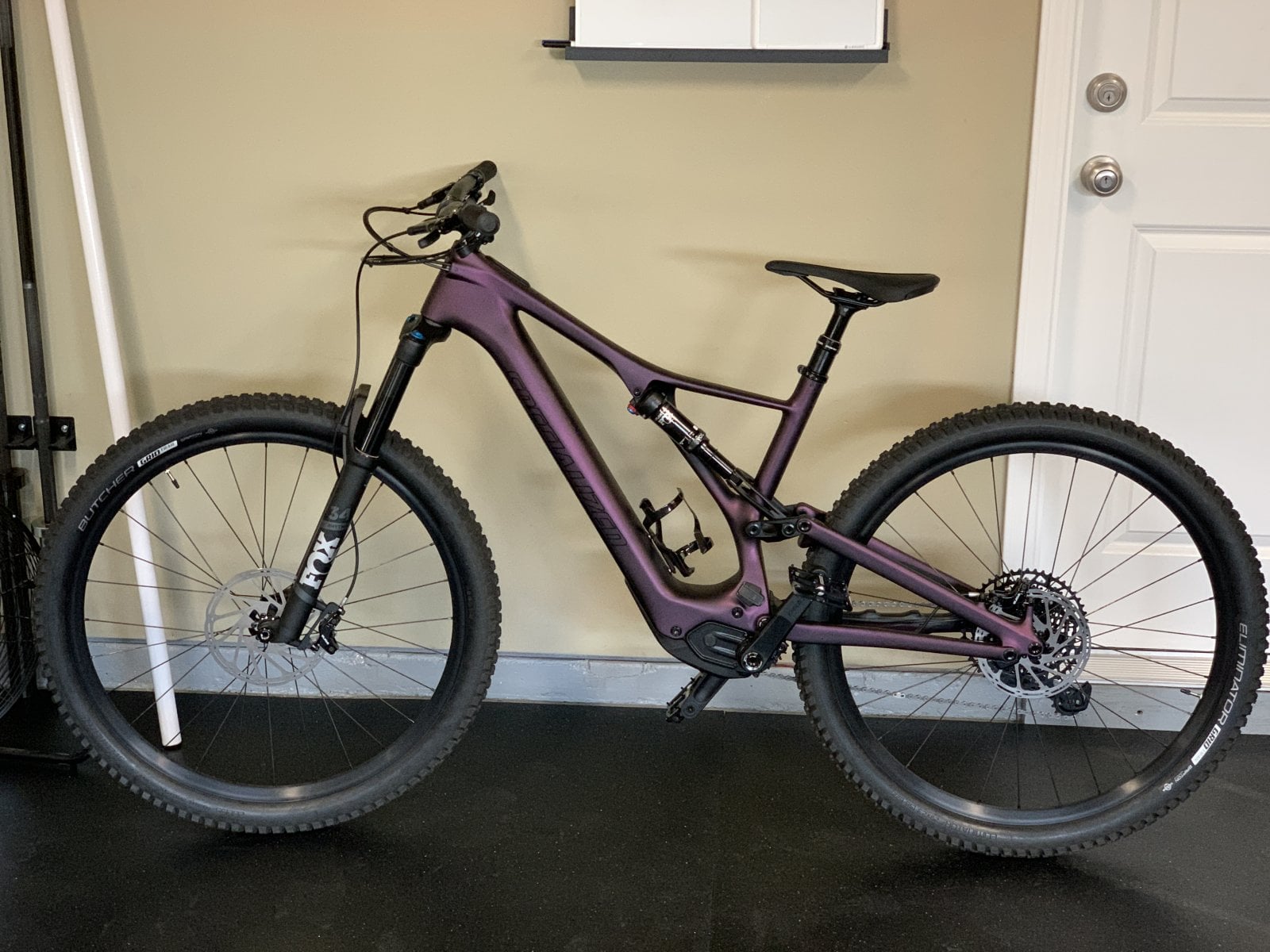

New SL Comp Carbon owner here! First e-bike. Came from a Bronson CC X01 V2, so this will be a completely different animal all together.
Not a big fan of the purple, but couldn't beat the deal (in-stock versus ordering a black). It's growing on me, and removing every decal I could helped quite a bit. Hopefully I can find some wrap or something to reduce a bit of the purple overload and have the wife stop laughing at me for buying a girl bike :(
Read this entire thread! Wow you guys sure do value a few grams here and there! I definitely notice the weaker brakes compared to my Guide RSC, and the shifting not as crisp as the X01, but I can live with this for a while and ride it until I find out what it really needs.
Also concluded that despite tons of research, there is no way to find the right support/peak settings until I just do a bunch of rides and just compare/adjust. Even then it may differ with different rides. So many ways to achieve similar support/range performance. This stuff is built to confuse us. I guess I'll just start with defaults and tweak from there.
I'm in the CA South Bay Area (near Saratoga) so TONS of trails around, but I find myself at Demo most often since its only 35min away. I'm really looking to multiple loops on flow trail now! I value the workout so I plan to go motor off as much as possible.
Any first must-do's? Weighed in at 41.4 with heavy peddles, but tubless will be done in the next day or so, along with swapping to my fav Ti rail seat.
