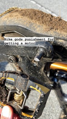

It was the rear shock pivot. I had removed the shock at one point to add a volume spacer so it must have been then. Even though properly torqued.
