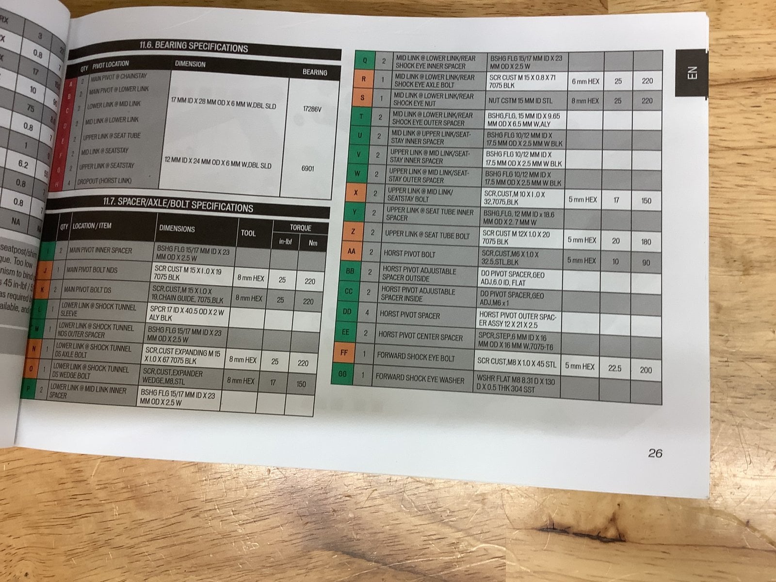

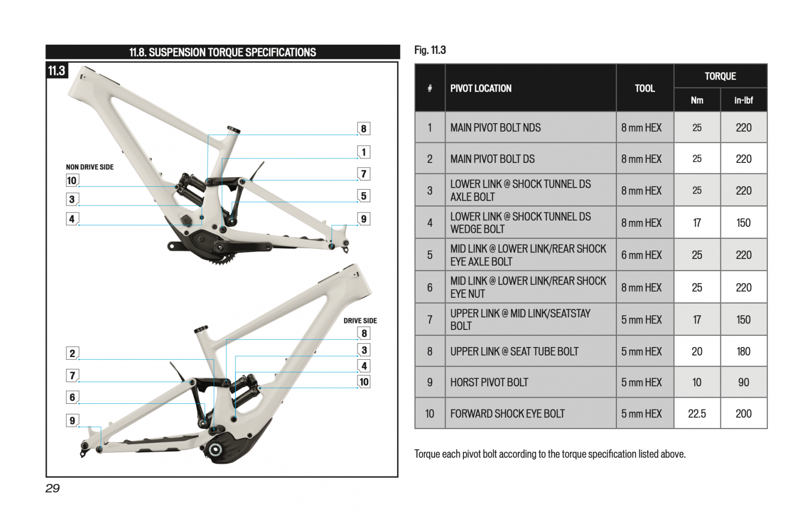

I think this has been discussed before, but not sure. I’m replacing the shock on my Expert build with a custom tuned Float X2. The manual says the lower shock bolt torque is 220 Nm, and the upper shock bolt is 200 Nm. This can’t be correct. I think you would crack the frame at those numbers and the bolt would break for sure. Does anyone know what the correct torque values should be?

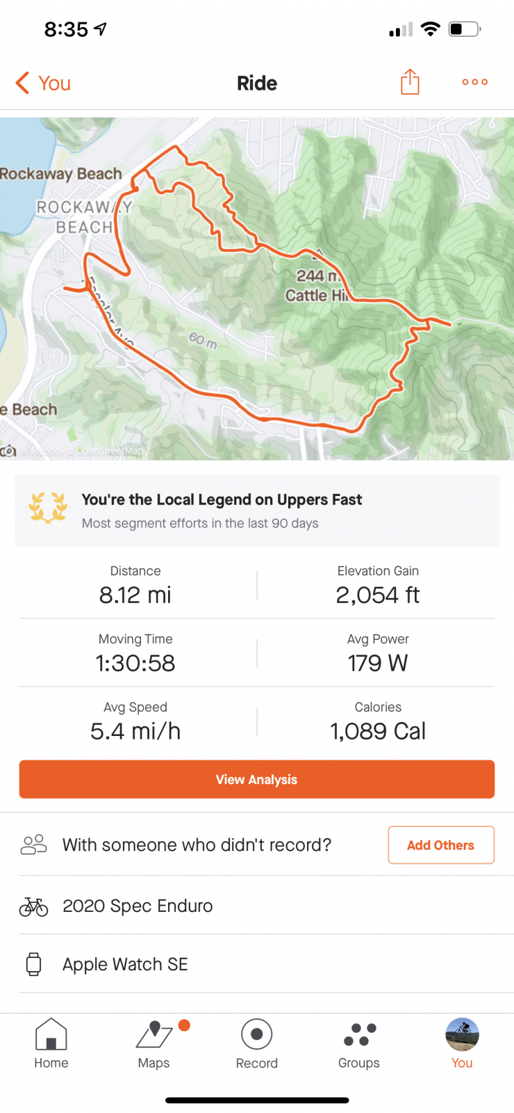

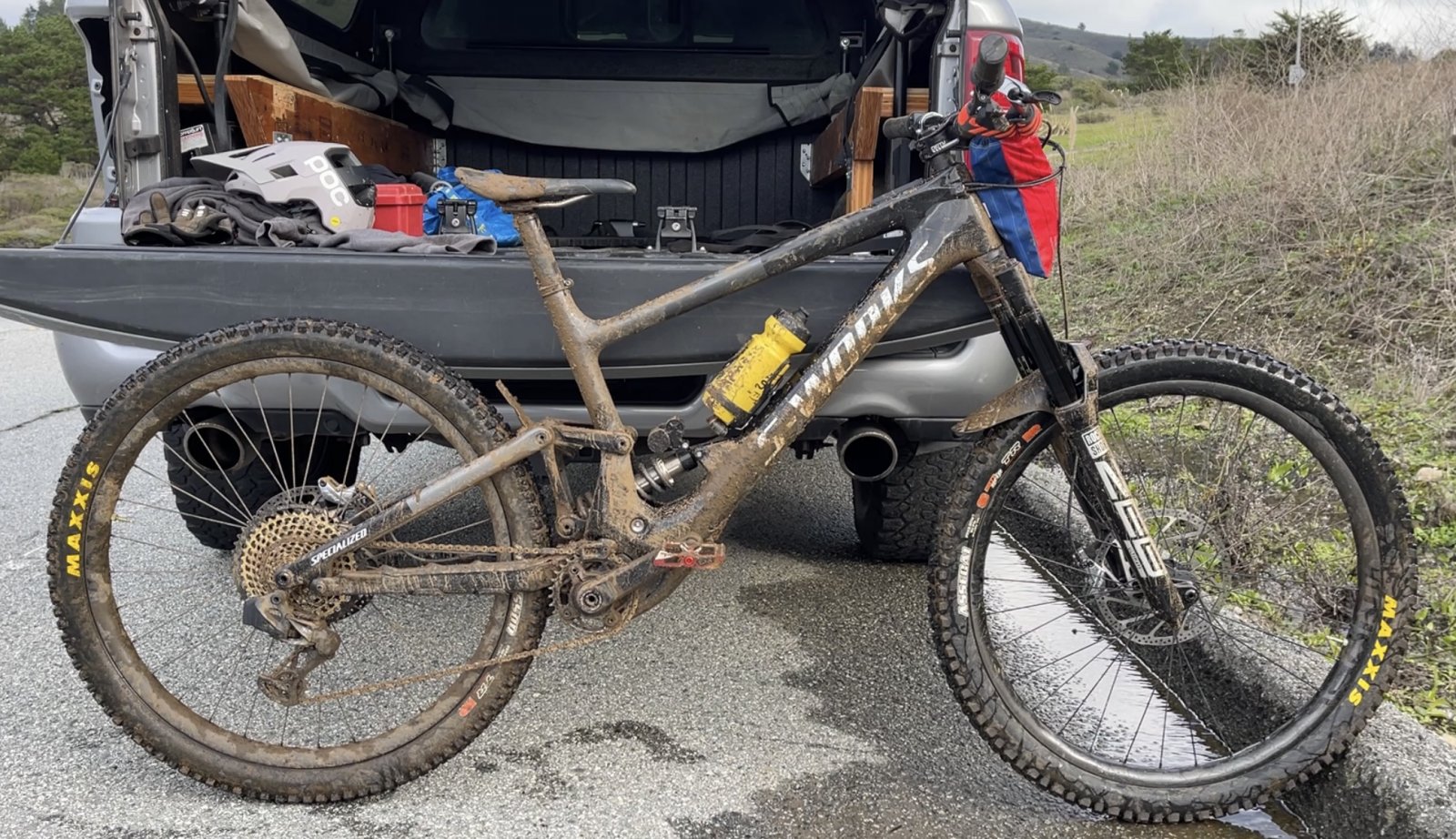

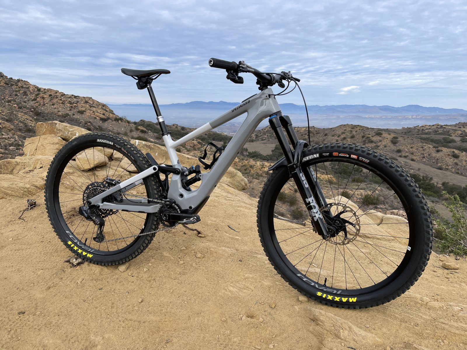

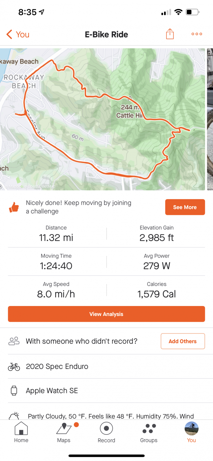

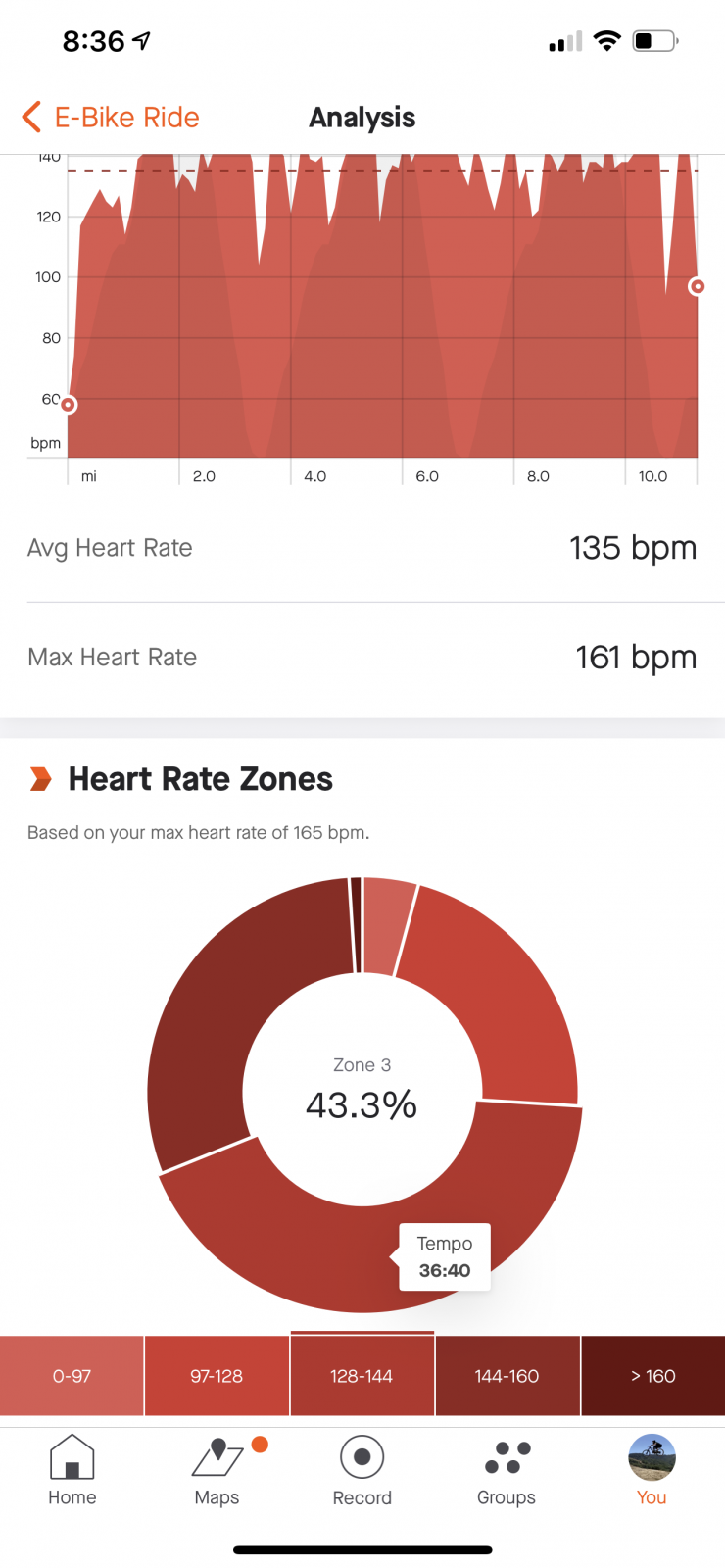

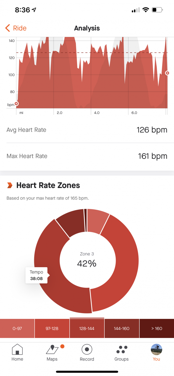

Quick Strava (I love / hate Strava) comparison of my 90min daily on the KSL vs. Enduro below.
Couple notes:
-I’m 45 and my max HR is ridiculously low (165) based on weird genetics
-3 laps on KSL vs. 2 laps on Enduro
-HIGHER avg HR on the KSL (+9 BPM)
-KSL feels 90% the SAME as the Enduro with the differences (IMO) being: very slightly less poppy, noticeably smoother through chunky sections, slightly better cornering.
-Avg. power 279w KSL vs. 179w Enduro. This ride was 100% turbo, and that equates to the KSL actually being 1.6x “me”. Not quite the “2x you” that spesh advertise, but I’m guessing my size (6’4” x 230lbs) waters down the ratio a bit (?).
-Stoked on this bike. Basically my Enduro plus an extra lap or two per ride. That’s HUGE.
KENEVO SL:
ENDURO:
NO ! Upper is 12,7 Nm, lower as in the manual 25 Nm. Member "Chefkoch" had some posts here regarding this. And please check the units Nm vs. in-lbf !
Thank you for providing the correct torque values.
This is what my manual shows. FF is the top shock mount bolt. Fortunately I’ve done my own bike work for many years so I knew that 200 Nm was way off. Unfortunately, a newer rider may not know and would create some serious damage following this manual. I’ve owned a number of Specialized bikes over the years and the manuals have been very good. This manual is not good.
I never trust the manual that comes with the bike. I always check online to see if it has been updated.
Here's from downloaded manual.
I got an addendum when I bought it. I manually edited the manual to match this information in all languages.

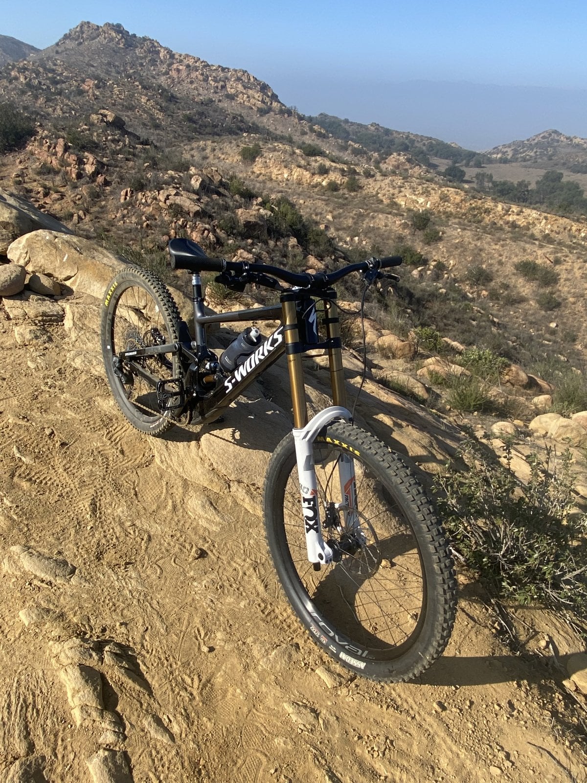

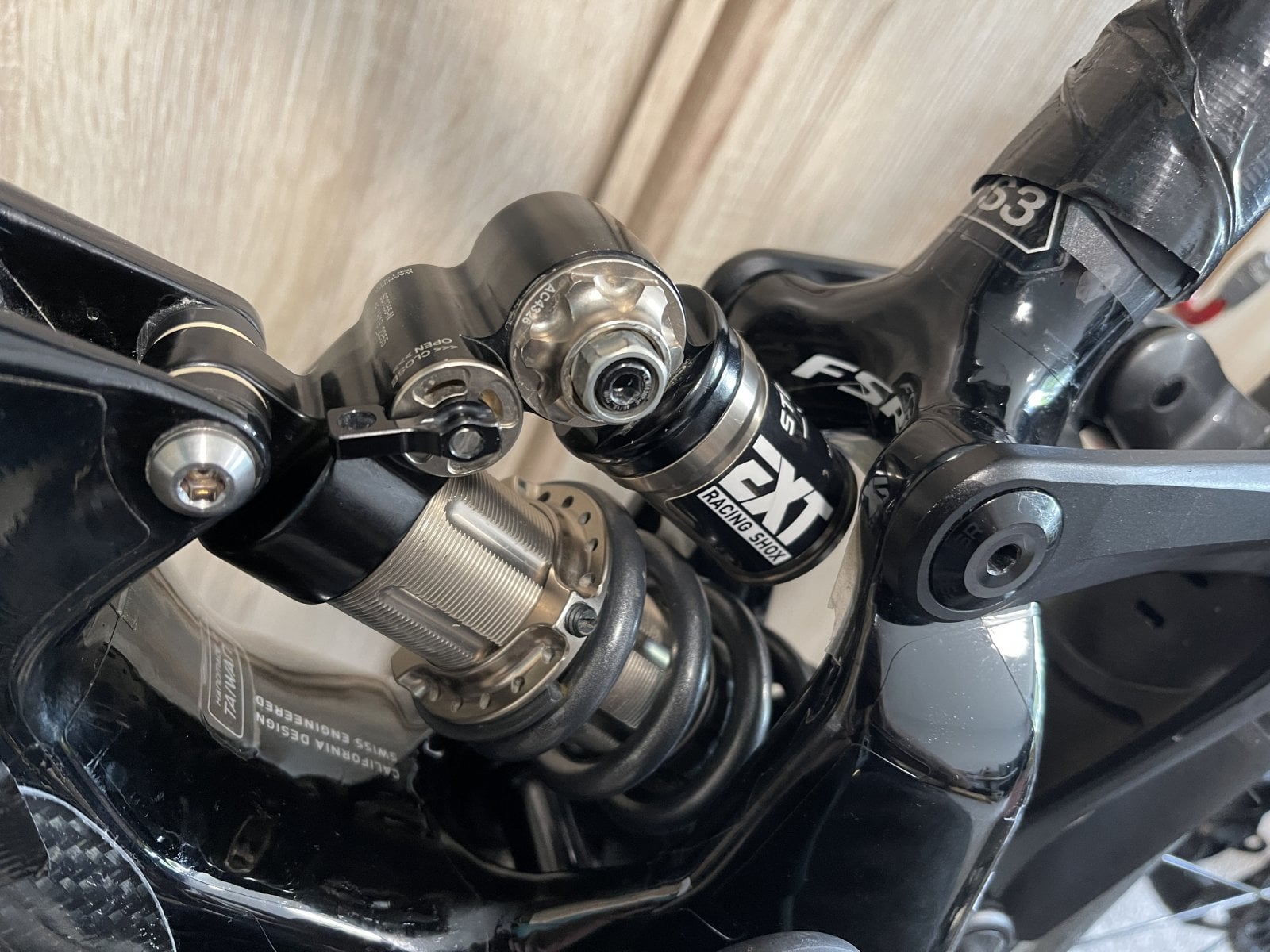

Does anyone run EXT Storia Lok V3(not E-Storia) on the Kenevo SL size S3?
I’d like to know if there is a clearance issue when shock is fully compressed, the Peggy back reservoir looked noticeably longer the Fox X2 comes with the Sworks model.
Any info would be appreciated.
I have in S4. It’s fine.
For future reference, no clearance issue when use EXT storia lok v3 on KSL Sworks S3 frame, however it just missed the frame for 1-2mm when at middle stroke.
