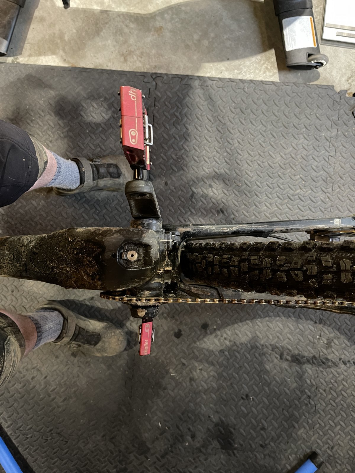

Finally hit some decent size jumps and the cranks immediately bent (jump #3). Glad I swapped out the carbon for alum but still, WTF. Does anyone make better cranks for this bike than Praxis?
Between the cracked carbon version on PB and my 3-jump alum specials I’m going out on a limb and saying praxis is BS.
I’m wondering the same thing. There is enough bad press on Praxis cranks that I don’t really trust them. I would like to try some 155mm cranks as well if anyone knows if you they are available to fit the Brose motor.

Hatching a plan to have a buddy weld a plate inside the concave bit on the backside. At only $70 a pair it might be worth a shot.
