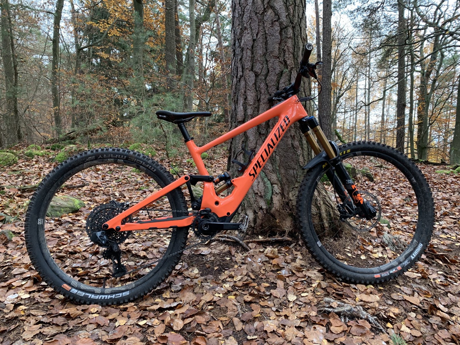

My sled in it‘s current evolution state. Just to put some picture in this place.
S4 Comp frame blaze/black
180 38 front
230x65 X2 shock
E13 Trs race carbon wheels
Maxxis Shorty Gen 2 2.4“ DD MaxxGrip front tubeless
Magic Mary SuperTrail Soft 2.4“ rear tubeless
DMR Vault pedals
OneUp 180 dropper
OneUp carbon bar 800 mm 35 mm rise
Truvativ Descendant stem 40 mm
Code RSC brakes 220/200 disc
AXS XX1 Derailleur with og Eagle GX cassette and NX chain
Total weight 19.75 kg
Still not sure if I like air on this bike. DHX with a 550 coil is waiting. The color is polarizing but looks pretty dope in dark autumn woods.
