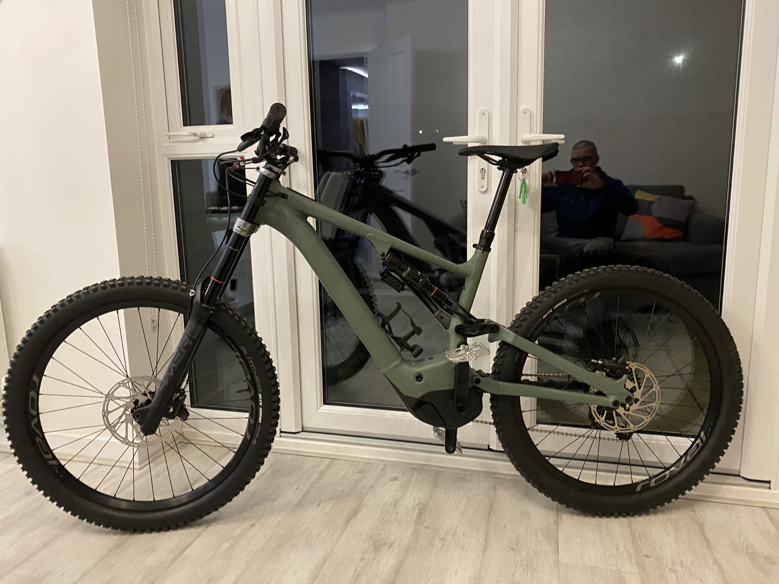

Bought my 2021 Kenevo expert last December at WatzUp.bike in Oberhausen Germany and they still had some new ones in stock. I bought a green S5 and they still had some 2021 black models in stock.
I believe they still have a lot of different brands EMTB bikes in stock.
Mine came with a Rock Shox Deluxe air shock that I replaced with a Fox X2 air shock.

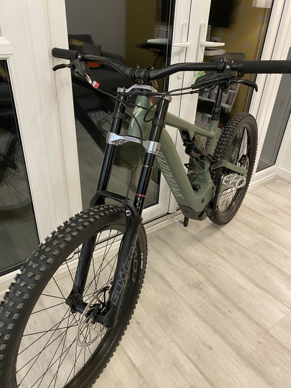

Tomorrow it will also sport a Fox 49 so I have a mullet set up.

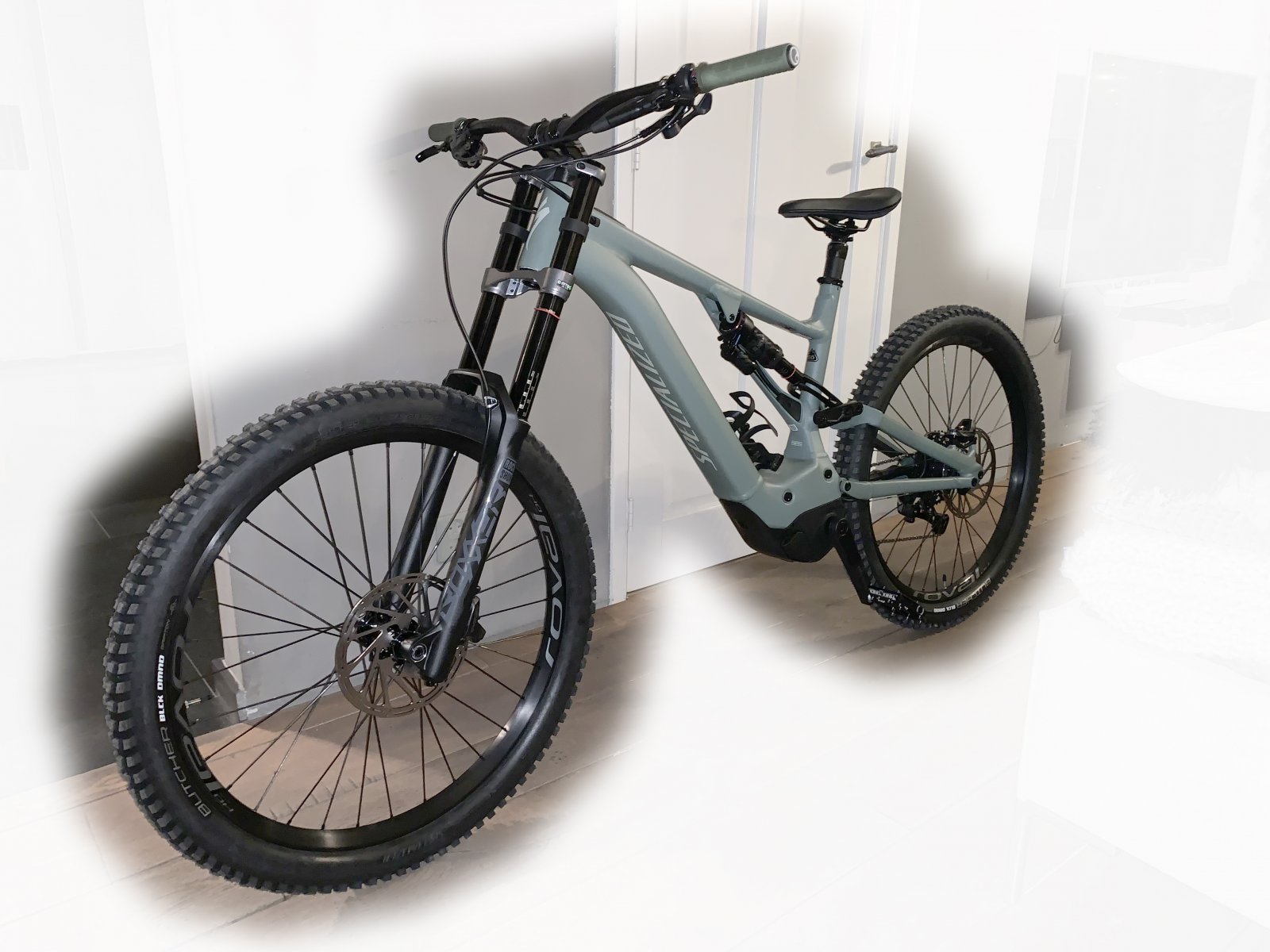

Got my bike back yesterday with the new Fox 49 installed. Now waiting for my 29er frontwheel. I have it made at a bike wheel specialist.

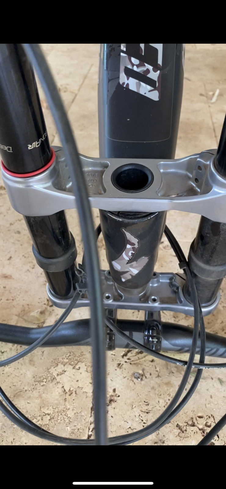

Tried my fork for the first time and it works great. I went from 180 travel to 203. Some say it is better to lower the travel in the fork to 180 so I keep more or less the same geometry, but I have to say it performs much better now. Also the bottom bracket is a little higher now and it keeps my pedals from hitting the ground. Get's even better when I put the 29er in. Can't wait to get the 29er front wheel...

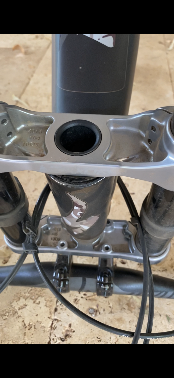

I am planning on making the switch to a mullet setup on my 2020 Kenevo with the same fork you have used. Will I need to change the steer tube bearings when switching from a Boxxer triple crown to a Fox 38 which I assume has a tapered steer tube?

you will just need the correct crown race for the 38. same crown race used on levo, enduro, etc.
you can use the same headset as the one used for the dual crown fork

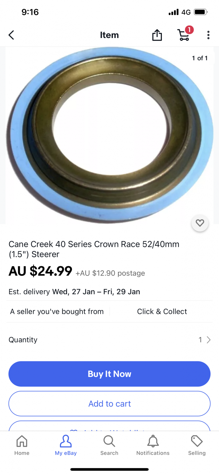

Thanks for your help! I don't suppose if you happen to know the part number for the crown race as I went to my LBS and they started asking me if my Boxxer (2020 Kenevo Expert) had a 1 1/8" or 1.5" tapered steer tube and if the lower bearing has a 36 or 45 degree angle. I personally don't mind supporting my LBS for things I can't or don't want to do (rebuilt forks and shocks) but if all I need to do is swap out a bearing, I can do that. According to the LBS, the Specialized Service manual is a little vague on which bearing is actually in the headset and they would have to take a look at it as there are at least two possibilities. Am I wrong for not wanting to spend $50-100 for them to re and re and bearing and "install" a fork and swap over the bars?
I don’t know the part number. I just had an extra taken from a levo SL
You just need a 1.5” crown race for the lower bearing mentioned below
it was a split ring crown race
Headset Uses a 1-1/8" (41.8mm x 30.5 x 8mm, 45x45°) Campagnolo Standard compatible upper bearing and a 1.5" (52mm x 40 x 7mm, 45x45°) lower bearing
Basically you need the 1.5” version of what you have on the boxxer fork now. 45°
a specialized dealer should have them. It’s used in several models with the fsa headset

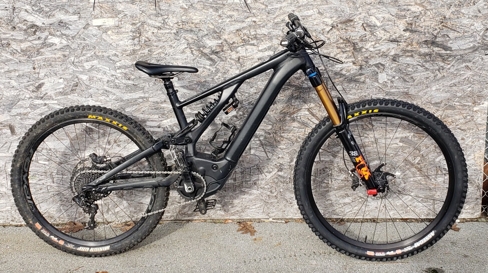

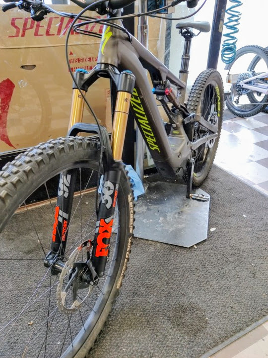

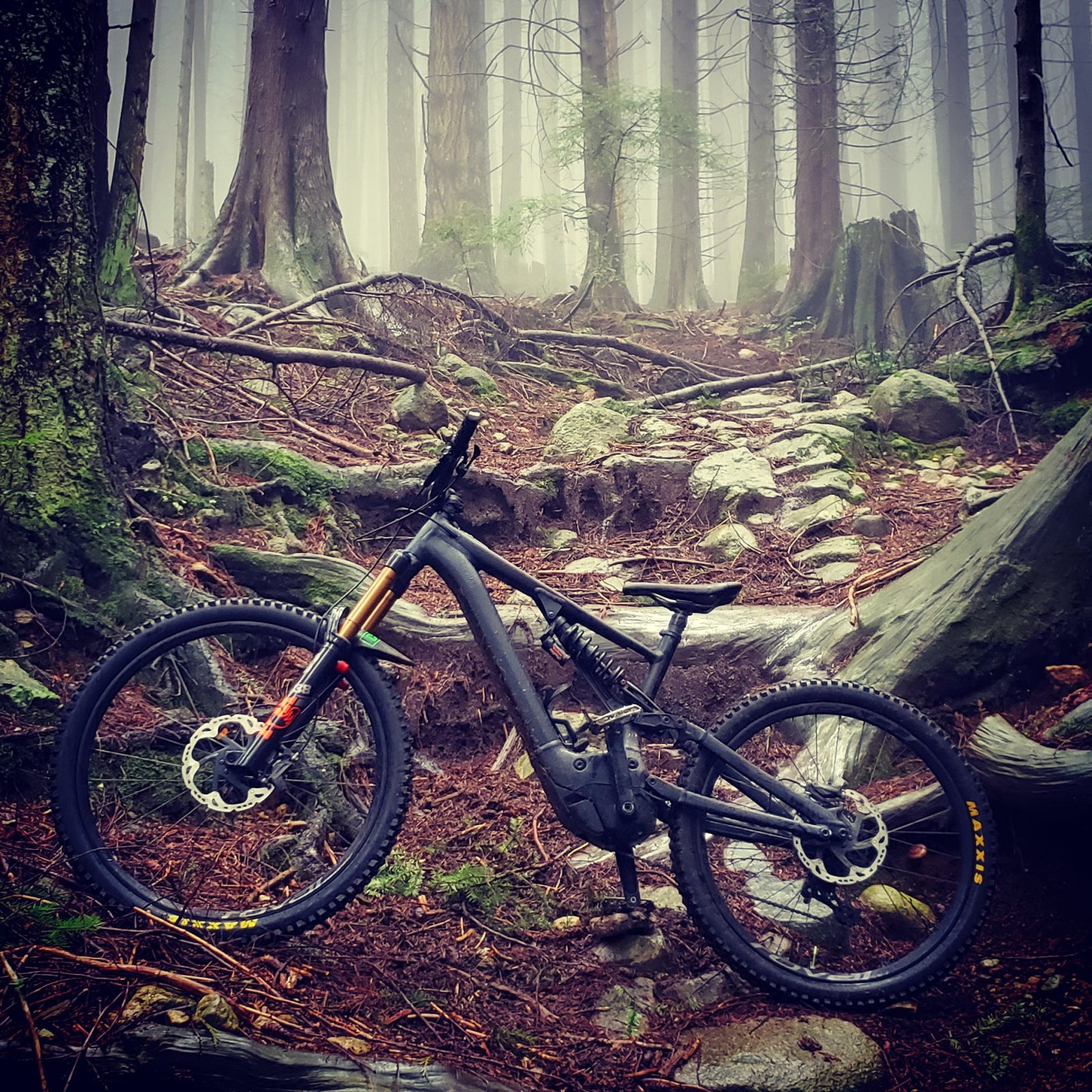

I have ridden the Kenevo S3 for almost a year now with the obligatory month off while I had the motor replaced. The original Boxxer fork was upgraded with an Avalanche damper cartridge which made it very nice. I rode my wife's Levo SL as a mullet for awhile and liked it but I am not sure if it was because of the geometry or the weight for the mostly steep and techy trails in my area. The Mullet setup is complete for now. I hope it rides as well as it did with a little better performance on the steep woodwork and rocky chutes.
Upgrades:
Fox 38 Factory 180mm
Rockshox Super Delux Coil 500 lb with Vorsprung damper
RaceFace SixC bars
ODI Rogue grips
OneUp 35mm stem
Code RSC levers
Ergon saddle
Shimano Ice-Tech 200mm front
Shimano Ice-Tech 180mm front
Maxxis Assegai 3C DD front tire
Maxxis DHF 3C rear tire with custom HD insert

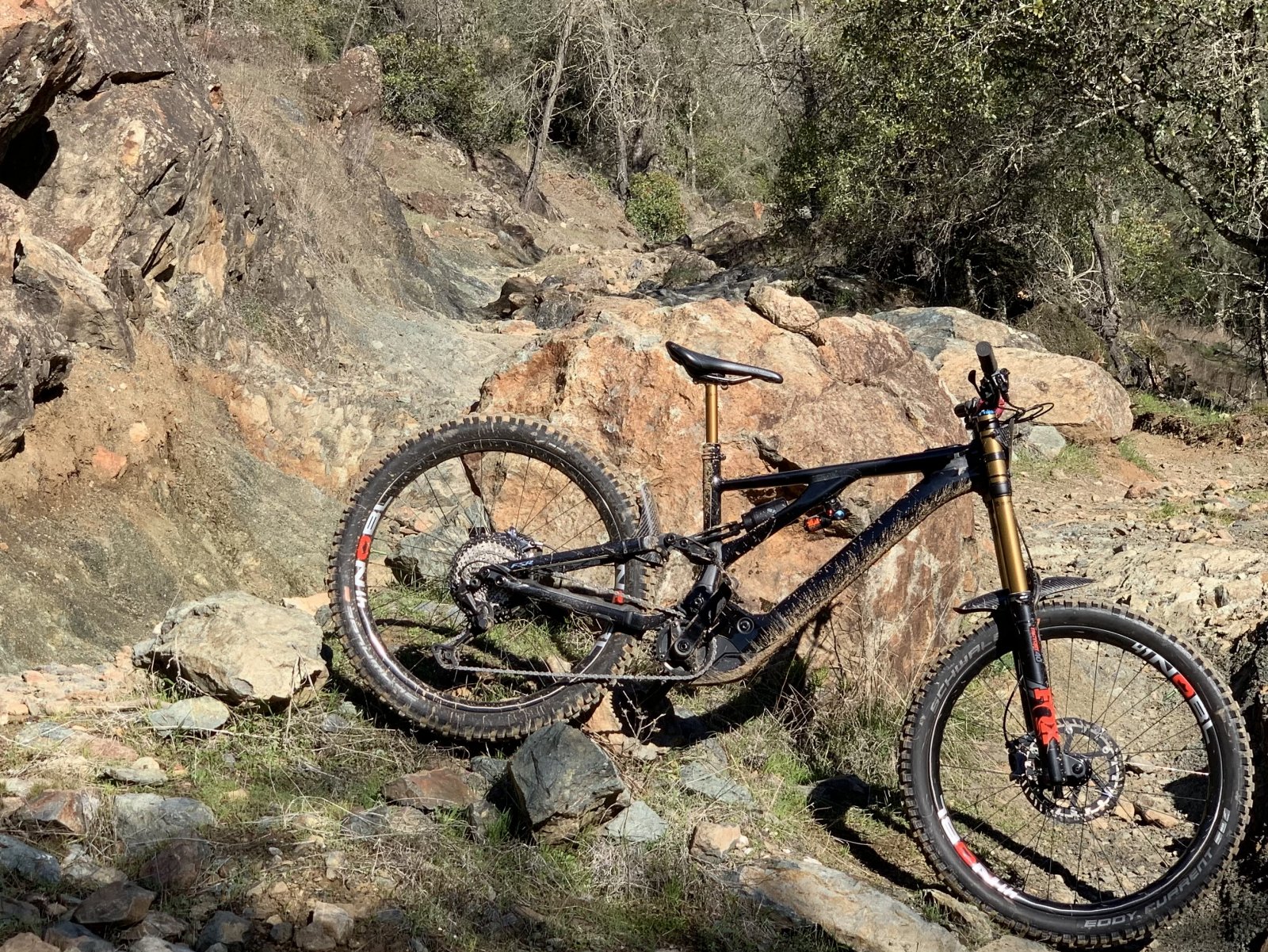

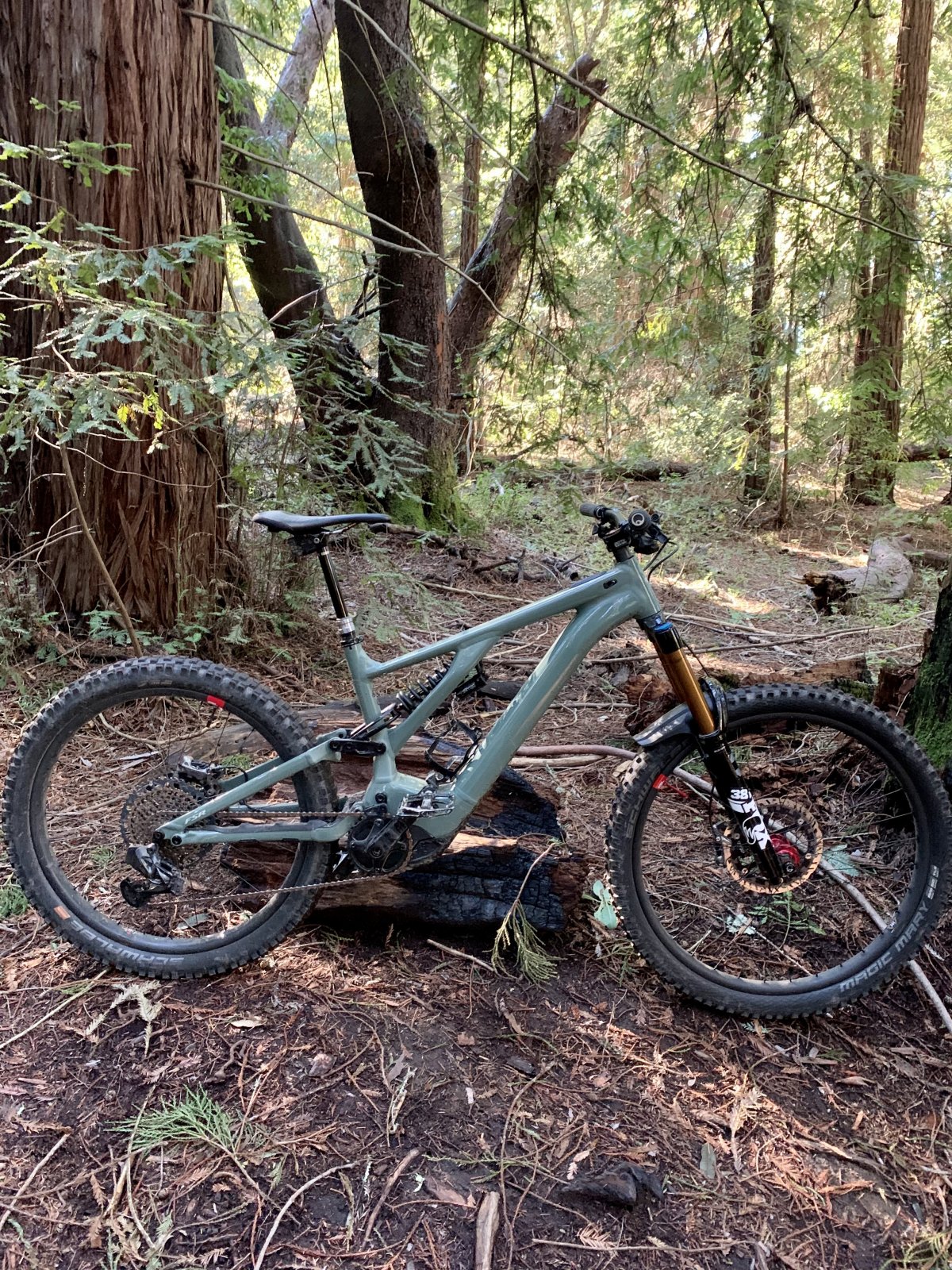

Beautiful BC in the winter. 8 degrees with a touch of moisture today. The Fox 38 is running well and the Assegai on the front is gripping the wet roots and rocks like its supposed to.

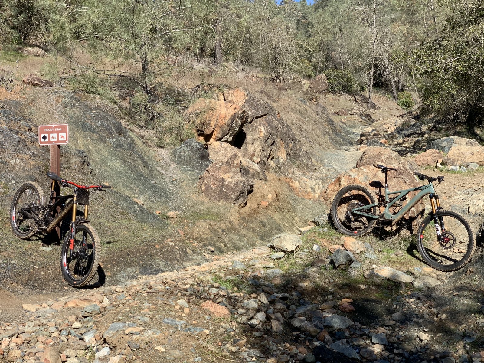

Yup super rare. The black one was my first Kenevo then i sold it to my friend. I’ve seen less than 5 out in the trails since they first came out over a year ago.

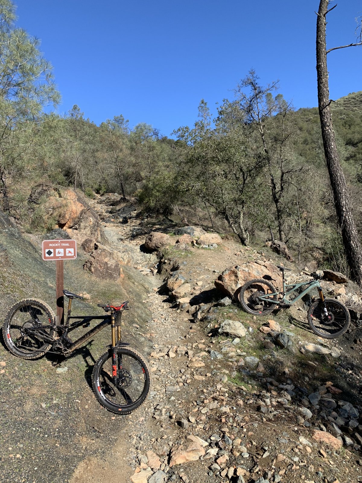

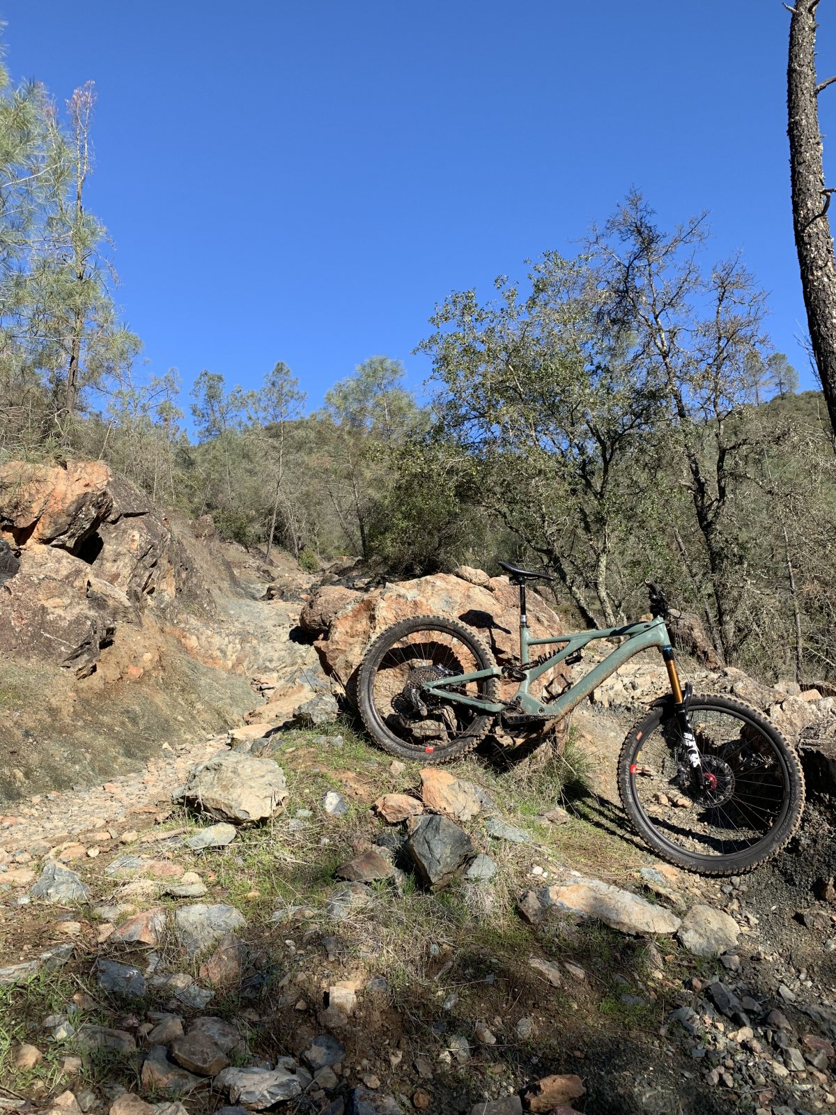

I'm running mullet mode with Fox Factory fork and shock. 36/170/44 and shock DPX2 216x65
Didn't go to normal 180 because 29" is much higher. Axle to crown Marzocchi Z1 27,5" 180: 562 and Fox 36 29" 170: 577
Moved some spacer under the stem to the top of the stem. Flipchip high
Haven't tried 29" on the rear yet, but will try next summer. My LBS said that it can fit Specialized 2.6 tire, but I prefer more Maxxis 2.5 or Schwalbe
And here's the picture

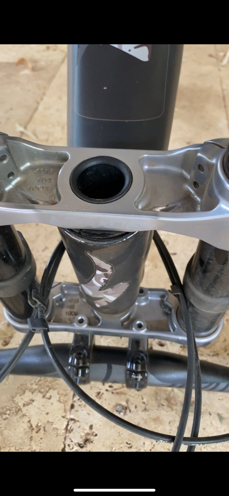

Hi all...new to this forum but I’ve run into an issue with my Kenevo Expert. I bought it last year in Australia.....so still under manufacturers warranty. On a ride yesterday, I landed a jump and heard a huge crack, steering locked up and I managed to hold on and not eat bush. My mate thought it was a gunshot it was so loud. Moving on....it looks as thought the factory crown case and lower bearings blew out. This has caused the frame to have suffered some damage that the shop is telling me....will not be covered under warranty!! I’m confused as to how this is not covered. The bike is less than a year old, had regular services with the shop where I bought it and has had no modifications to the front shocks.
Photos don’t really show the amount of movement but what are your thoughts on this?
Thanks.??
If no changes have been made to the original, should be a warranty issue. Just call to Specialized.
Thanks.??
Frame should be under a 2 year warranty for second owner from date if purchase. Per Global Warranty | Specialized.com
