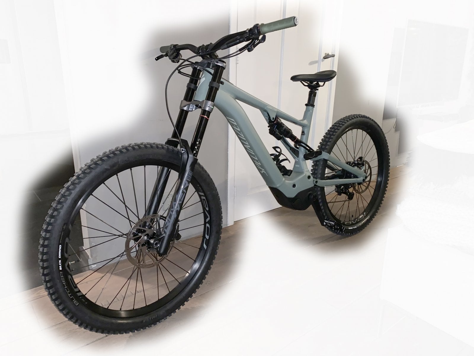

Bought my 2021 Kenevo expert last December at WatzUp.bike in Oberhausen Germany and they still had some new ones in stock. I bought a green S5 and they still had some 2021 black models in stock.
I believe they still have a lot of different brands EMTB bikes in stock.
Mine came with a Rock Shox Deluxe air shock that I replaced with a Fox X2 air shock.
Tomorrow it will also sport a Fox 49 so I have a mullet set up.

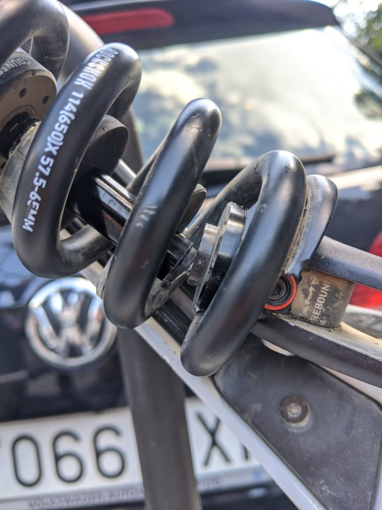

Some riders are absolutely clueless. You only have to look at the some of the questions asked on facebook groups or on here. Not having ridden for decades or coming from an mx backgroup it seems. This lack of knowledge in setting up a coil shock is obviously causing spesh a lot of money in warranty claims. Which is now being passed down to us with the massive price hikes this year.
Its harder for an enduser to mess up with an airshock.
The clueless one here is you unfortunately. Else you would see alone from the label on the spring that its not default.
Thats my bike in the picture btw and it shows the 3rd shock broken within 8 months. All operated with custom springs matching my weight and therefore minimal preload according to manufacturer recommendation.
