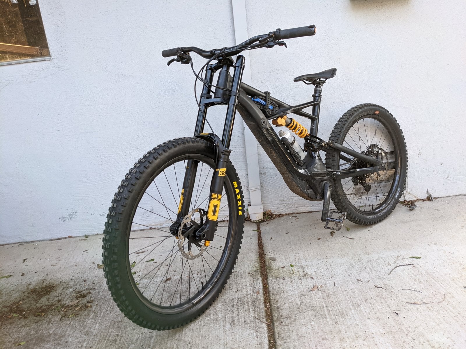

Here is my Kenevo setup with 29 wheels, 700 wHr battery, Fox X2 Factory/170 Lyrik etc. The only thing left stock is the frame/motor

My biggest hope is for a true 29 setup on the Kenevo, but other than that, IMO there is not much to improve. Honestly this bike rides so well with the 29 wheels that there is really no reason for me to upgrade to a new bike once it is released, although I will get it anyway.

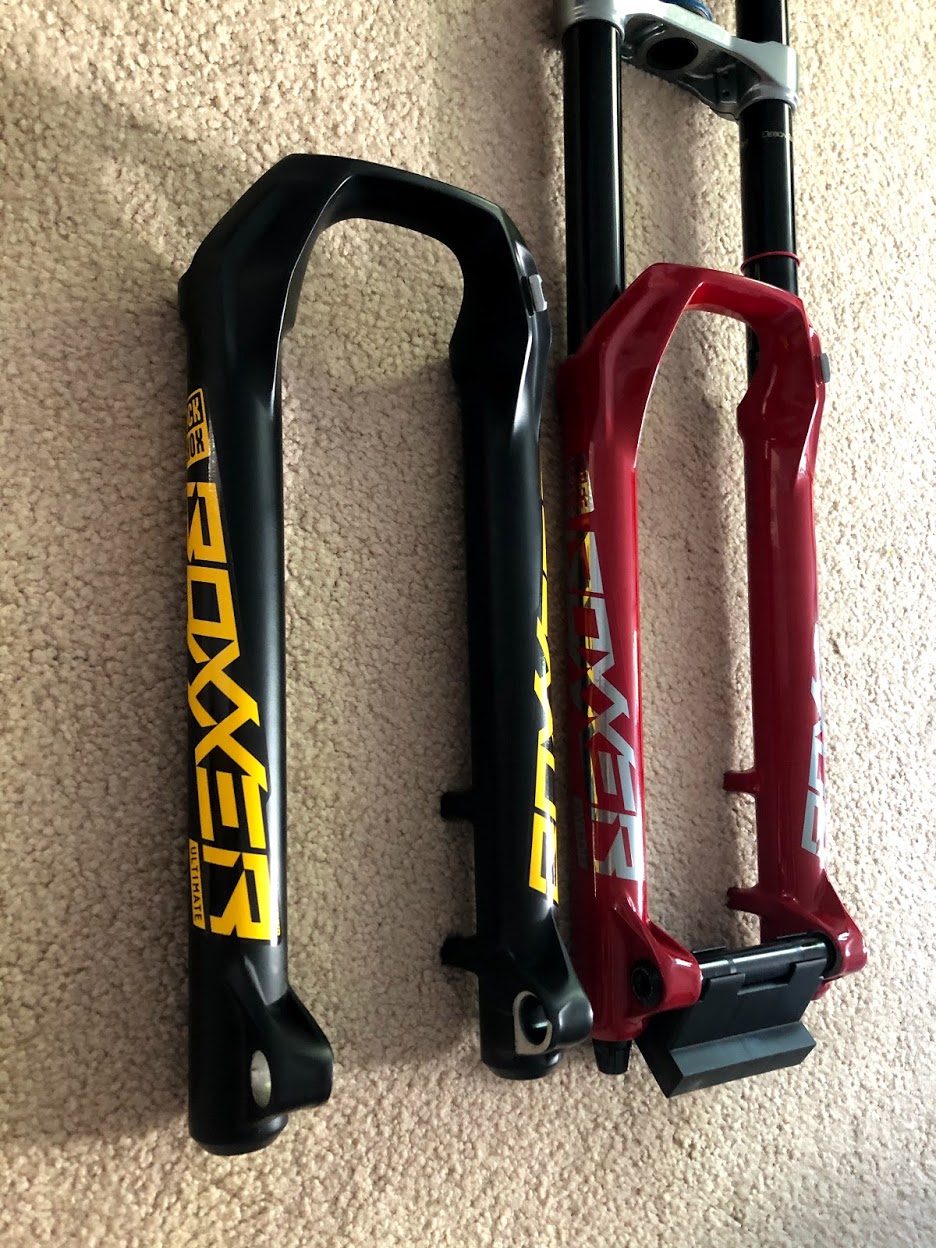

BTW, I’ve got Boxxer Select 200mm on my kenevo now. I don’t know exactly why but I am not fond of the boxxer fork.
I’m thinking of upgrading to fox 38 factory with 190mm travel and 29s on my kenevo. The only thing holding me back from that decision is the “creaking” issue I’ve read with the 38s.
Thoughts on this ?
Also, I’ve thought of going to Lyric Ultimate on 29s instead.
Any advice/opinion on this decision.
How about upgrading the internals of the Boxxer? Cheapest way of improving the front end
The boxxer has the charger damper and 200mm of travel. It performs well on the trail (has great small bump compliance ) but the boxxer creaks. Annoys the hell out of me. I have two Yari forks that don’t. I realize I’m riding my Yari forked bikes more because of the damn creaking on my boxxer equipt bike.
I don’t think it’s just the creaking. The boxxer feels heavier on the trail. My riding style doesn’t necessarily require a double crown fork.

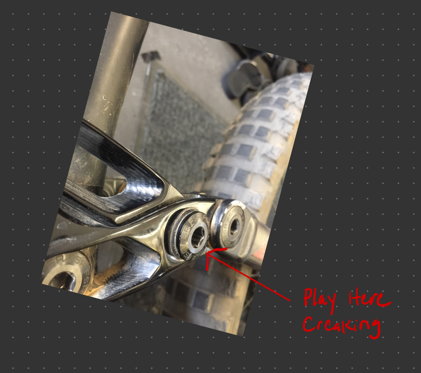

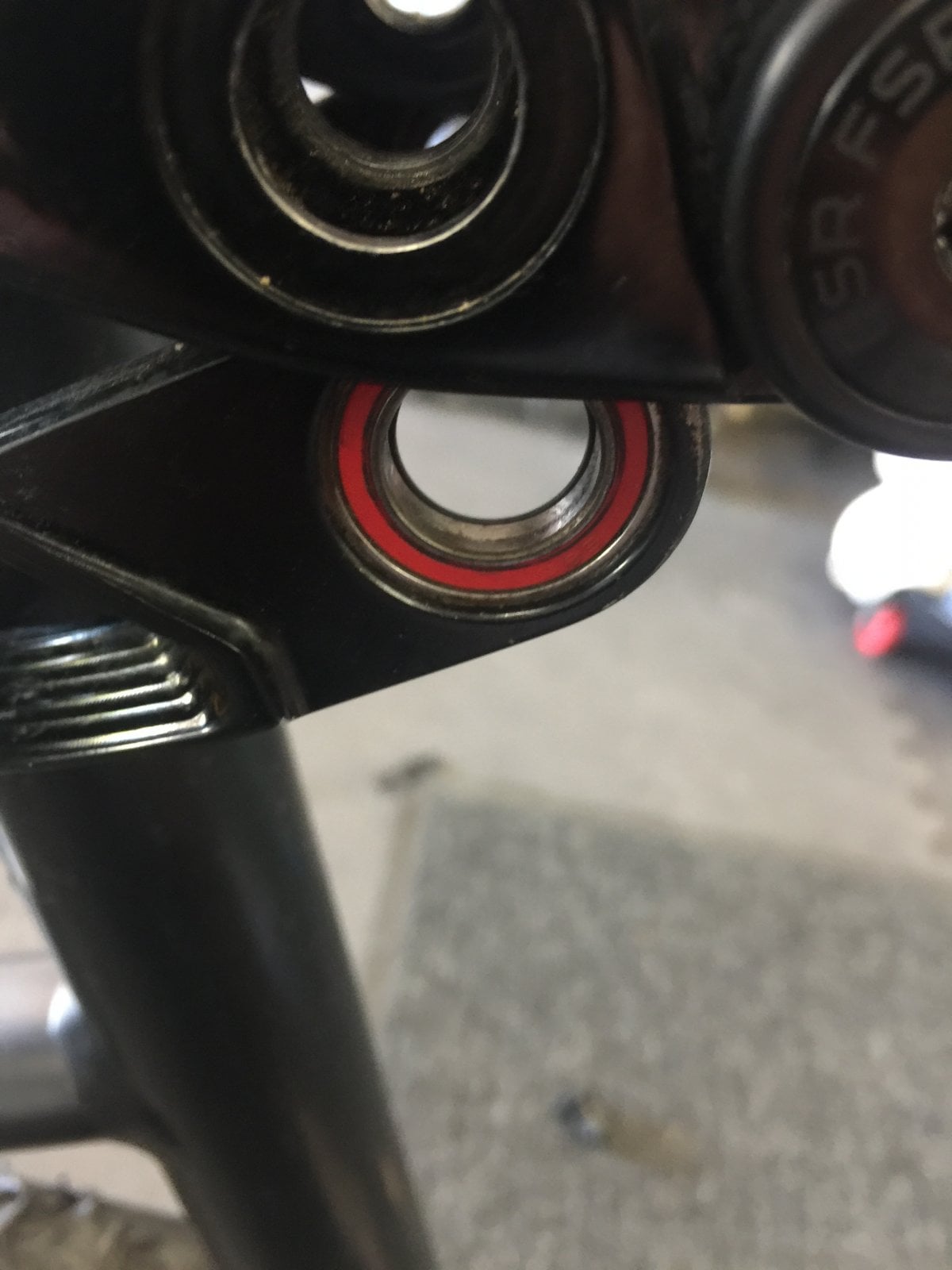

Does anyone know the bearing size for the rear shock bike yoke? Creaking and play here and repacking didn’t work this time like 2000 miles ago so needs replacement. All others are smooth and no play.
Enduro MAX 6802 Sealed Cartridge Bearing?
Ordered a pair and will see if they fit.
Success. Bearings fit and it solved the problem. The old bearings felt smooth but there seemed to be wear on the inner race where it contacts the bolt and maybe some sideways play. With the rear shock off, the rest of the bearings seemed very smooth and no play. Pretty beefy setup and impressive for 5000+ miles. Dusty but dry So Cal conditions.

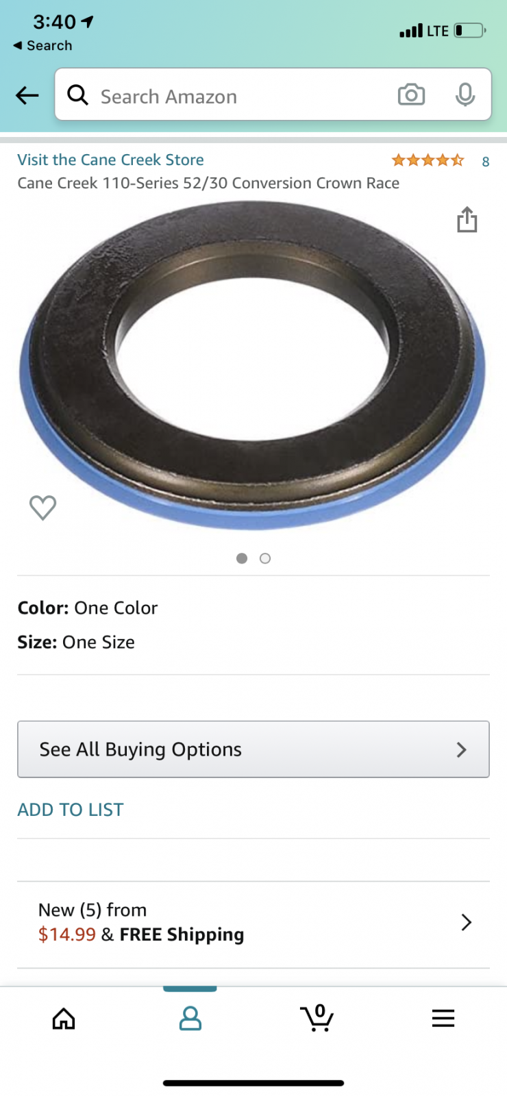

anyone know what headset i need to put a dh38 on a '19 kenevo? and do i need a crown race? it's a straight steer tube and the lyrik i'm taking off is tapered so I gotta pick up a new set of bearings with a reducer I'm guessing. thanks for any info.
Bought this for my ‘19 Kenevo to fit my straight 1 1/8” steerer tube on my Boxxer fork.

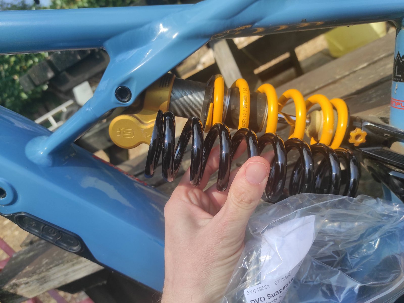

Found some 63mm DVO springs quite cheaply - €18 !
EDIT ! Well - they don't fit !! :-)

Well my 450 "cheapo" spring arrived ! :-)
Looks like I need to buy a new bike to make it fit :-) And a forklift to fit it - it weighs a tonne !
As this is an experiment and I don't want to just end up with boxes of springs I'll never use .. does anyone know where you can get cheap 450ish springs which will fit ? Even better, lovely little titanium ones ! :)
Oh and if anyone wants a nice new DVO 450 63mm spring for postage, let me know.
