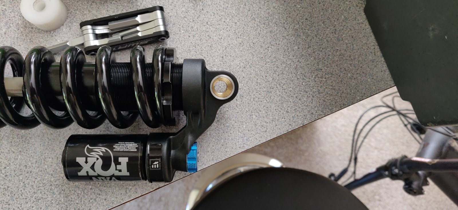

Anyway I thought I would fit an offset bush I had bought in readiness.
Reduced ha from 65 to 64.5 degrees. BB is supposed to be 350mm but mine measured 342mm before and 335mm after the bush was fitted. Lucky I have short cranks :LOL: (i expect this is due to 2.6 tyres rather than the balloon 2.8 stock ones)

Anyway I thought I would fit an offset bush I had bought in readiness.View attachment 31619
Reduced ha from 66 to 65.5 degrees. BB is supposed to be 350mm but mine measured 342mm before and 335mm after the bush was fitted. Lucky I have short cranks :LOL: (i expect this is due to 2.6 tyres rather than the balloon 2.8 stock ones)
Now lockdown is semi lifted in the UK I can't wait to ride, not been out properly since last October as im a summer rider only & have already missed out on about 9 weeks of amazing weather.
Bb is with flip chip set to high I’m pretty sure.
Also isn’t that bush meant to be 20mm wide? Unless your running that shock upside down. If it runs in the top mount you will find it will probably spin around.

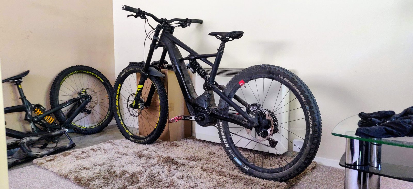

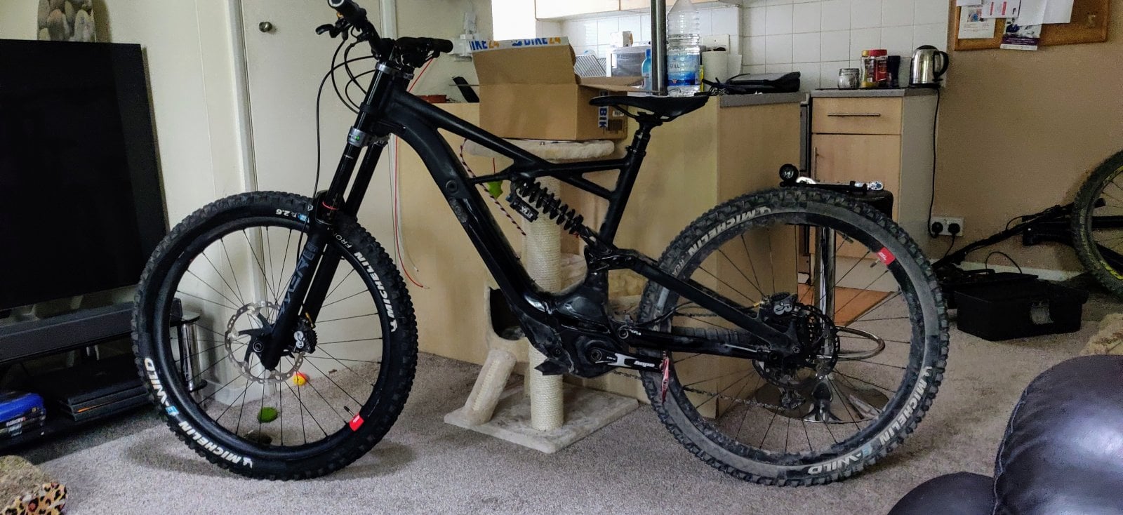

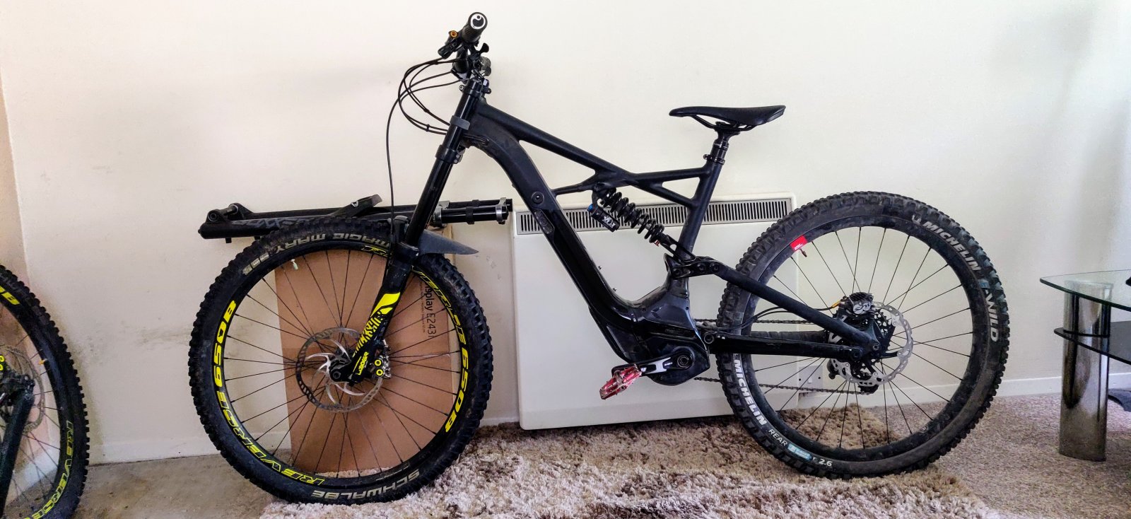

Hurrah the crown adaptor arrived today so 20 mins later I had whacked the boxxers & wheel from my dh bike onto the kenevo.
Ive kind of gone down the rabbit hole with this project, It was originally just a test with a £6 adaptor, but then some brand new 180mm boxxers came up for sale near me on monday at a very good price, so I just had to buy them. (lurking back of picture).
Which means I also needed to order a 20mm boost 28hole hub to re-lace my santacruz wheel & also direct mount stem. Hopefully this will arrive next week :)
And yes I do live alone hence doing all this in the lounge.

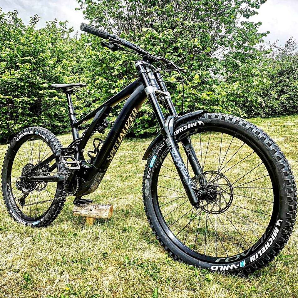

How are you liking the Michelin E-Wilds? Mine just arrived, can't wait to slap them on

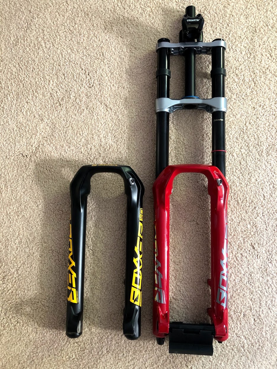

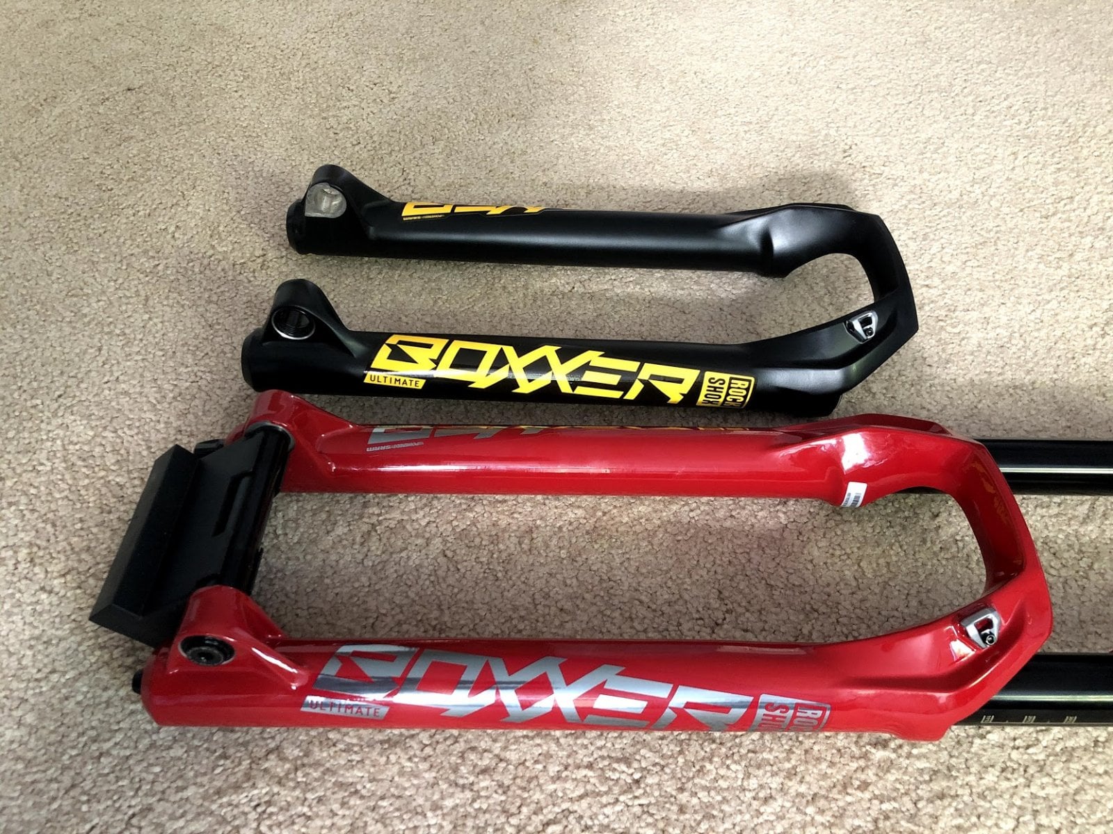

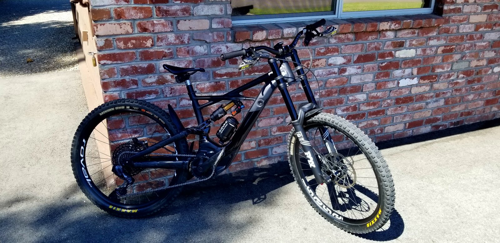

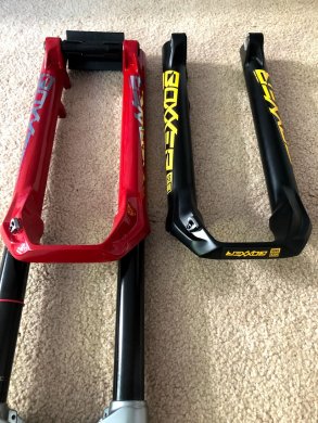

I'm a bit late to the "Dual Crown 2019 Kenevo" party, but still trying to decide what to do while i wait for my LBS appointment to get my front wheel re-hubbed (went for a Hope Pro4 28h 15mm Boost , then can easily change to 20mm boost with the HUB494 endcaps).
But anyway, on my black 2019 with the Ohlins yellow shock.

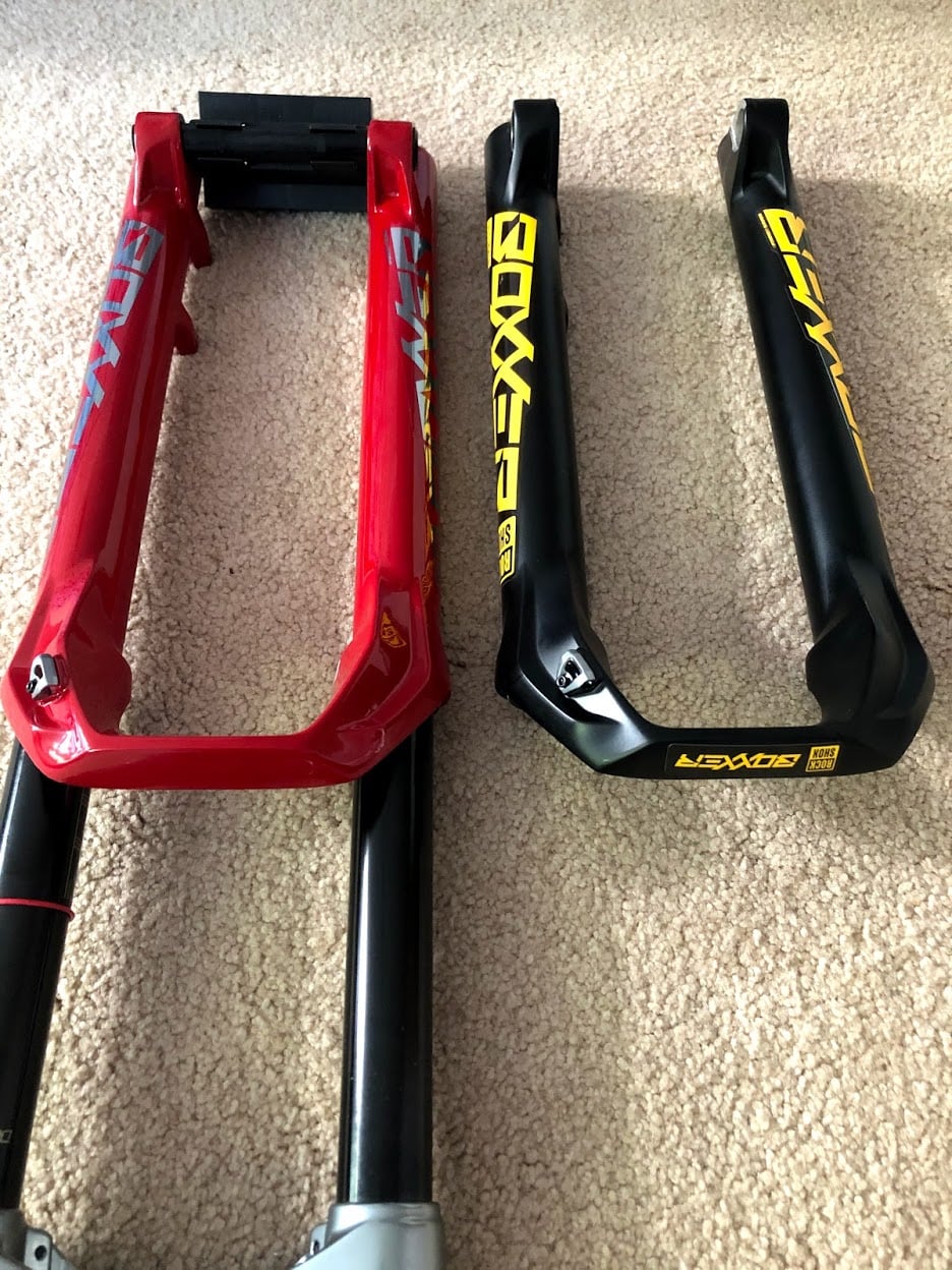

Run the Boxxer Ultimate as is, or switch the lowers to black with the custom Slik graphics decals in Ohlins yellow??
Seeing them together now i'm kinda torn what to do...
As she sits now, basically stock apart from Zee brakes/XT rotors, Minions and a comfy saddle

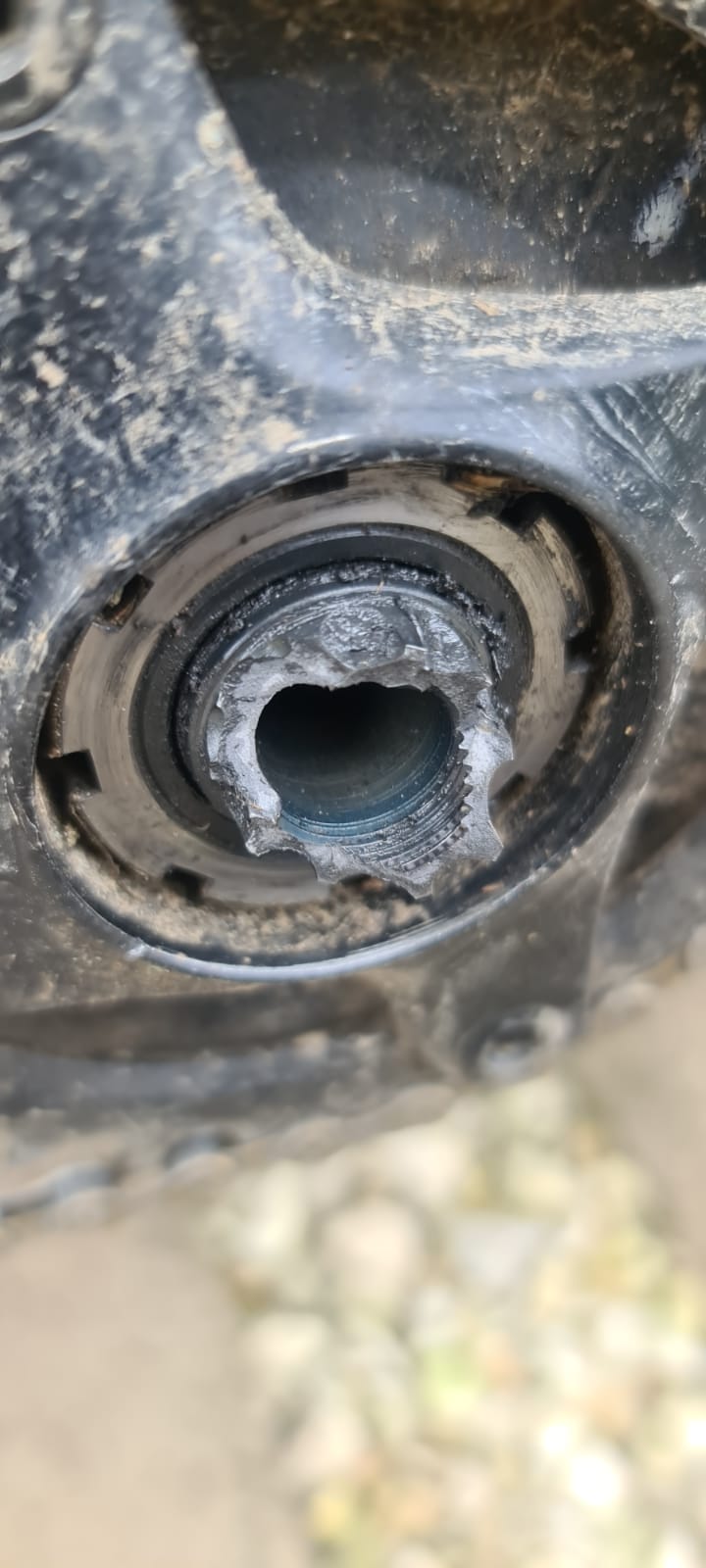

Anyone have their crank axle snap ? mates snapped yesterday on a ride in the Lake District (fortunately at fairly slow speed) it's a 6 months old motor with not many miles on it
No but ive seen a few posts regarding this, either on here or Facebook.
I wonder if over or under tightened crank bolts could be a factor?
I must say a catastrophic failure like this is the stuff of nightmares if it happened when landing a big jump.
I did wonder about the over/under tightening of the bolts,he was very lucky to have it happen on a very small drop

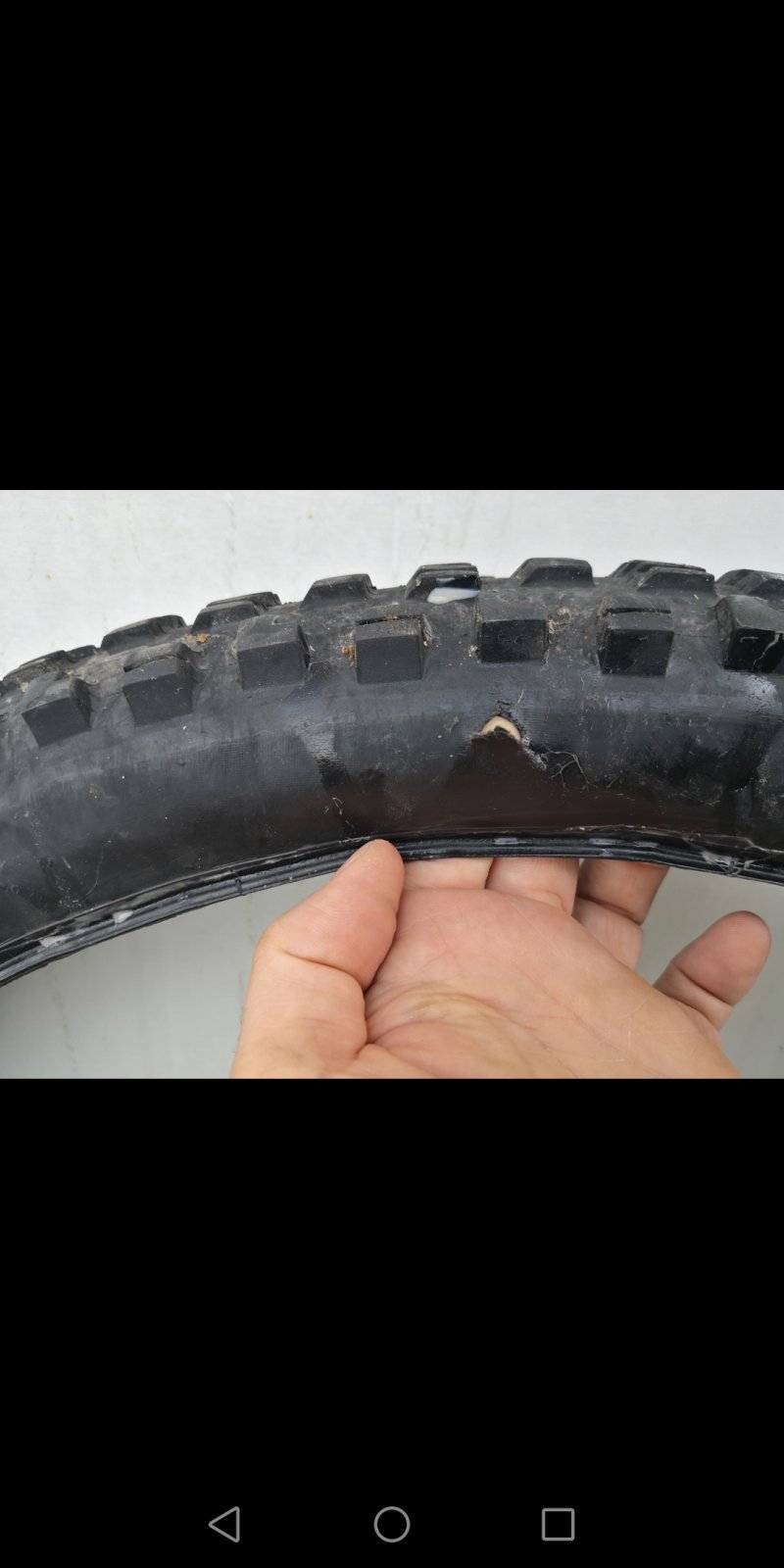

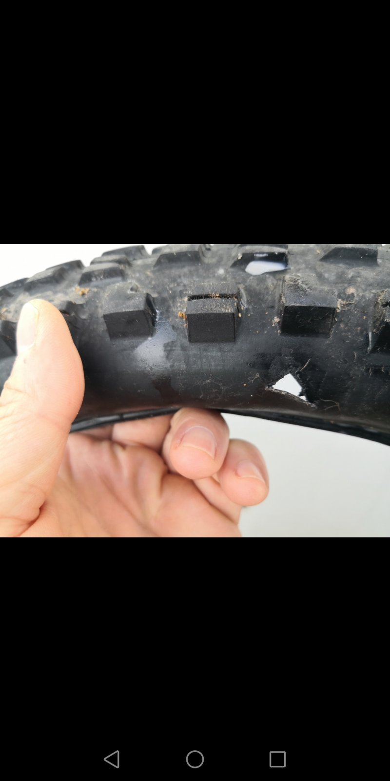

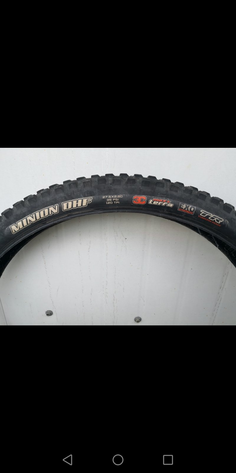

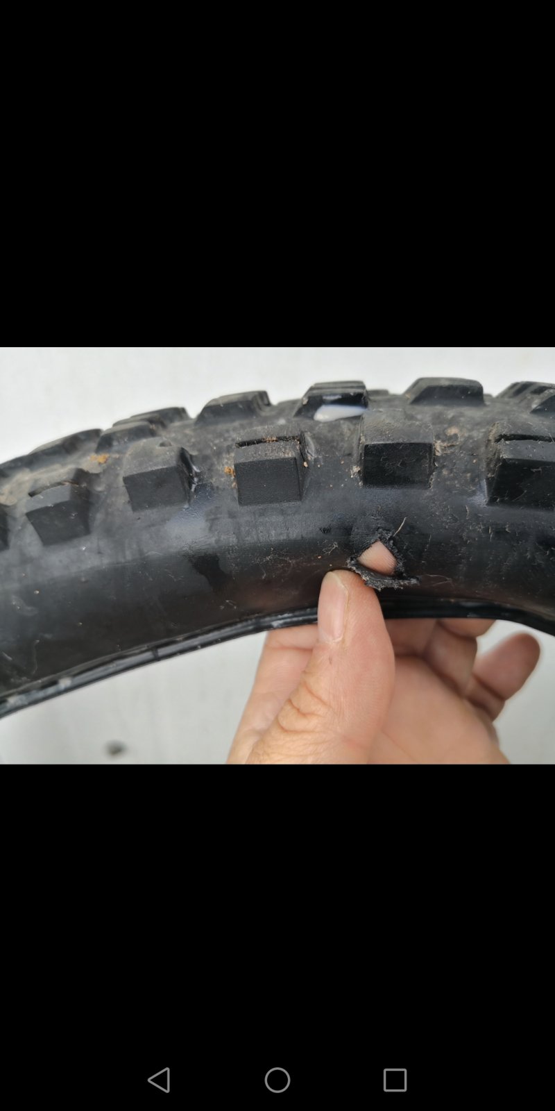

Is anyone else blowing the sidewall right at the bead on DHR's on their Kenevo? My last 3 blew right where the rim hooks to the bead before the tread was worn down. The first was a 2.8 on the stock 38mm internal roval rim, running about 25 psi. The second was a 2.6 on the stock 38mm internal roval rim, running about 25 psi. The third was a 2.6 on a 30mm internal raceface arc with an insert, running about 29psi. Only got 5 rides out of that tire. It was pretty much brand new. I'm feeling like I'm lighting money on fire every time I buy a tire now. I haven't bought a DD casing because the widest it goes is 2.5 to my knowledge, and I'm not even sure if the thick sidewall goes into the bead. Anyone have the same problem and figure it out? Thanks for any info.
I had always heard dhf/dhr's had weak sidewalls and we're subject to snakebites, but never had any on my analog bike, but ran high pressures on my old 2.3 tires..
Now on my kenevo, had a 2.8 dhf on the front for almost a year of hard rocky riding, on stock 38mm rival rims at about 17psi.(but with cushcore) when this! Happened! On a simple smooth strech
of trail.. from one tiny gravel sized rock.. that was just at the right angle i guess..sliced a nice triangle hole in the sidewall... And the tire still had plenty of tread! At list six more months of riding in it..
But still, you can't beat the grip and cornering! On this tire, so went out and got another one.?

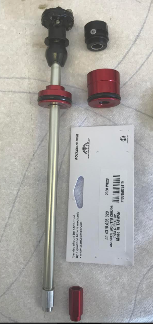

front fork service kit - for Debonair ?
Hi guys - I have now ordered 2 service-sets for the front fork - with number 004318-025-020, wich according to rockshox page is the correct parts - but what I got is shown on photo - and if I look around it seems that both the partnumber should consist of correct parts for the fork (serial no on fork checked on rockshox site giving this number for debonair) now what I received are parts shown on picture below - can I use these ?? normally I want it to be exact copy of what is inside - but looking forward to your reply guys :) rgds Allan
Hi guys - I have now ordered 2 service-sets for the front fork - with number 004318-025-020, wich according to rockshox page is the correct parts - but what I got is shown on photo - and if I look around it seems that both the partnumber should consist of correct parts for the fork (serial no on fork checked on rockshox site giving this number for debonair) now what I received are parts shown on picture below - can I use these ?? normally I want it to be exact copy of what is inside - but looking forward to your reply guys :) rgds Allan View attachment 41834
hmm - think I found out that this is actually the new NEW debonair ? :-)
hmm - think I found out that this is actually the new NEW debonair ? :)
Yes - it's the new debonair spring parts in the service kit. In your first post the Charger 2 damper sealhead was at the top of the picture, then the two anodised red parts are the Debonair C1 35mm Seal Head and the end nut for the air spring. I foolishly bought the separate upgrade kit only to discover that the upgraded parts are included with the new service kits!!!
The kit should also include dust seals, foam rings and various o rings as per the Rockshox parts catalogue:
LYRIK RCT3 (A1-C1)/RC (B1-C2)/RC2 (C1) (2016-2019)
200h 00.4318.025.020 200 HOUR/1 YEAR SERVICE KIT (INCLUDES DUST SEALS, FOAM RINGS, O-RING SEALS, CHARGER 2 SEALHEAD, ALUMINUM DEBONAIR SEALHEAD) - LYRIK RC2 C1 (2019+)
