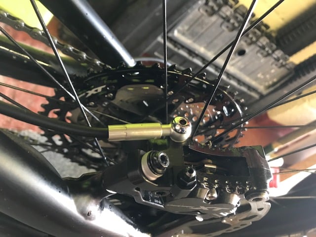

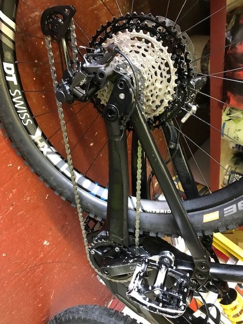

Got my bike back from the shop this weekend with new DT Swiss HX 1501 wheelset and XT 12 speed drivechain.
I have always preferred Shimano over Sram for no better reason than i grew up with Shimano in the 90s. XT has always been my go to group "Quality at a sensible price" but over the last couple of years i have had my head turned a little by Sram and its greater 1x % range. I tried the Sram Ebike drivetrain with the 8 speed 11-48T cassette, range was great maybe the steps were a little large but the main issue i had was the slightest knock, shifting was screwed and needed tuning then there is the price £300 for a cassette! I tried a couple over Sram setups same result great out of the shop or after tuning then poor with the slightest knock.
Went out for first ride on XT 12 speed this morning and very happy, the range is great and you can shift under load. I saw a video online, Shimano guy talking about shifting underload with the new 12 speed drivetrains he reckons they work better with ebikes than analogue simply because load is greater.
Shifting uphill underload is odd my head is saying NO you can’t do it, but it works, for ebikes this is ideal. If the long-term reliability if good I’d say this is a game changer for ebikes.
So far nothing bad to say about it if i had to niggle about anything it would be 12 gears is maybe to many 10 speed would be fine.

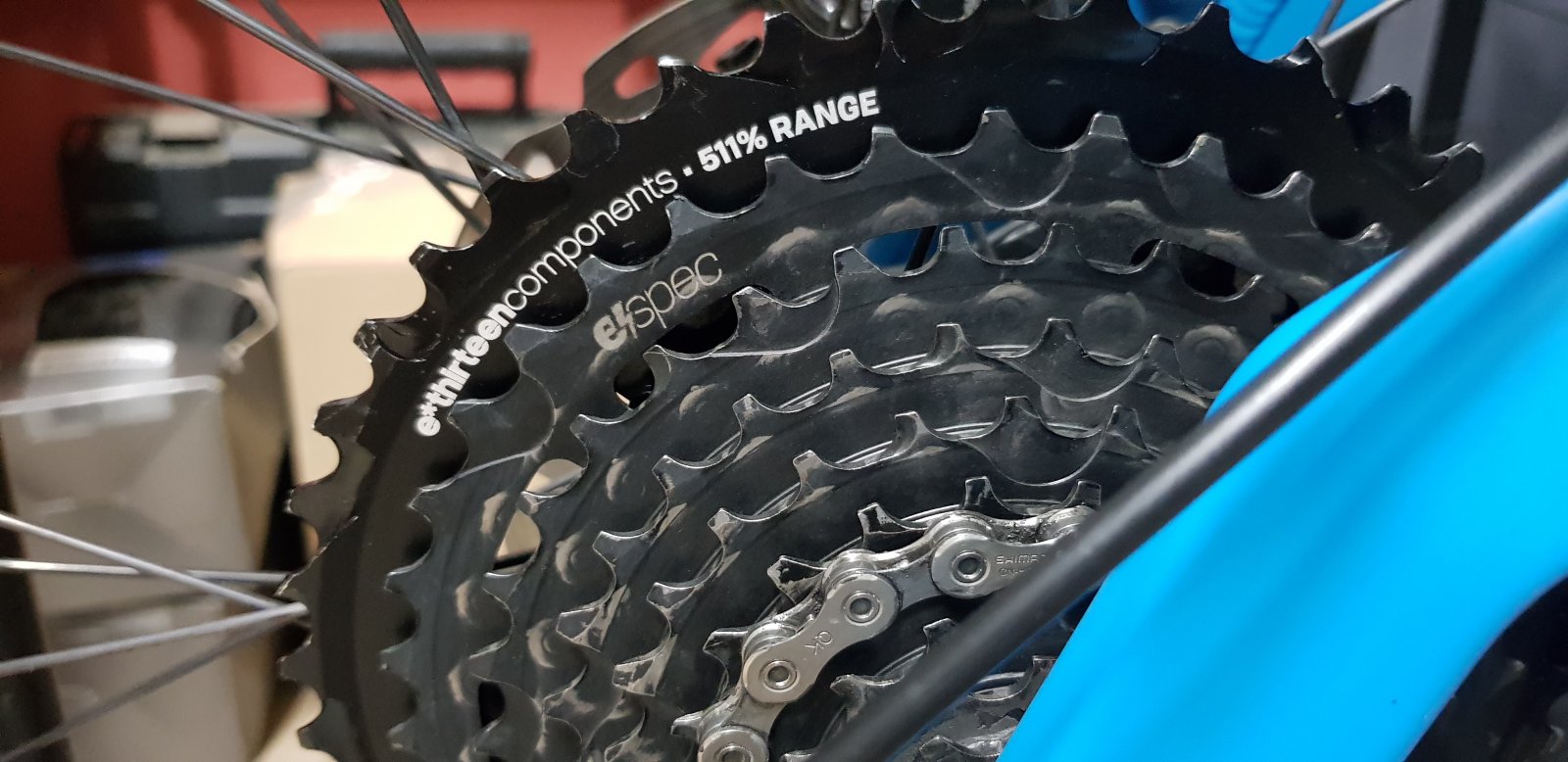

Sunrace makes a 12 speed Cassette compatable with the standard free hubs as well. I think I like the PG-1230 sram cassette for standard free hubs over the sunrace however, becuase it's all steel. The sunrace 12 speed for standard hubs, that I can find all have the aluminum larger cogs, and in my limited experience, the aluminum cogs are prone to snap teeth off.
Bottom line is, you can do 12 speeds with a standard free hub, my gaint Trance is just this setup, but the small cog will be an 11T not a 10T.

An update on how the new XT is performing a couple months down the road;
All good no bad news to report.
Wear on the cassette is less than the old XT kit which is good.
I did have some noise last month but it turned out to be the specialized chainring had worn and was holding the chain at the bottom and making an awful noise so i put a new one on and its all quiet again.
The 500% range is great particularly the 10t at the bottom given me just a little more speed going downhill without spinning out
