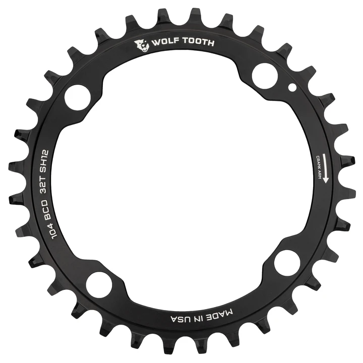

I've recently been thinking about switching to Shimano 12 speed on my Levo, but using the 10-45 cassette.
What chainrings are people running?
I've spotted a raceface SHI 12 ring but it's only 34t and aluminium
And the wolftooth HG compatible ring
which comes in different tooth options, but is still alu and costs twice the price of the raceface ring.
Are there any other options available?
Is there anything else I need to consider?
Would I need a new derailleur hanger or should the existing one work?

Hi Pyr0
As above i use a 12 speed shimano setup and had issues with the stock Specialized chainring so changed to a Wolftooth 104 BCD 32T Drop-Stop ST which is designed specifically for the purpose and works great. Its aluminium so may have a shorter life than steel ring but so fare no issues.
