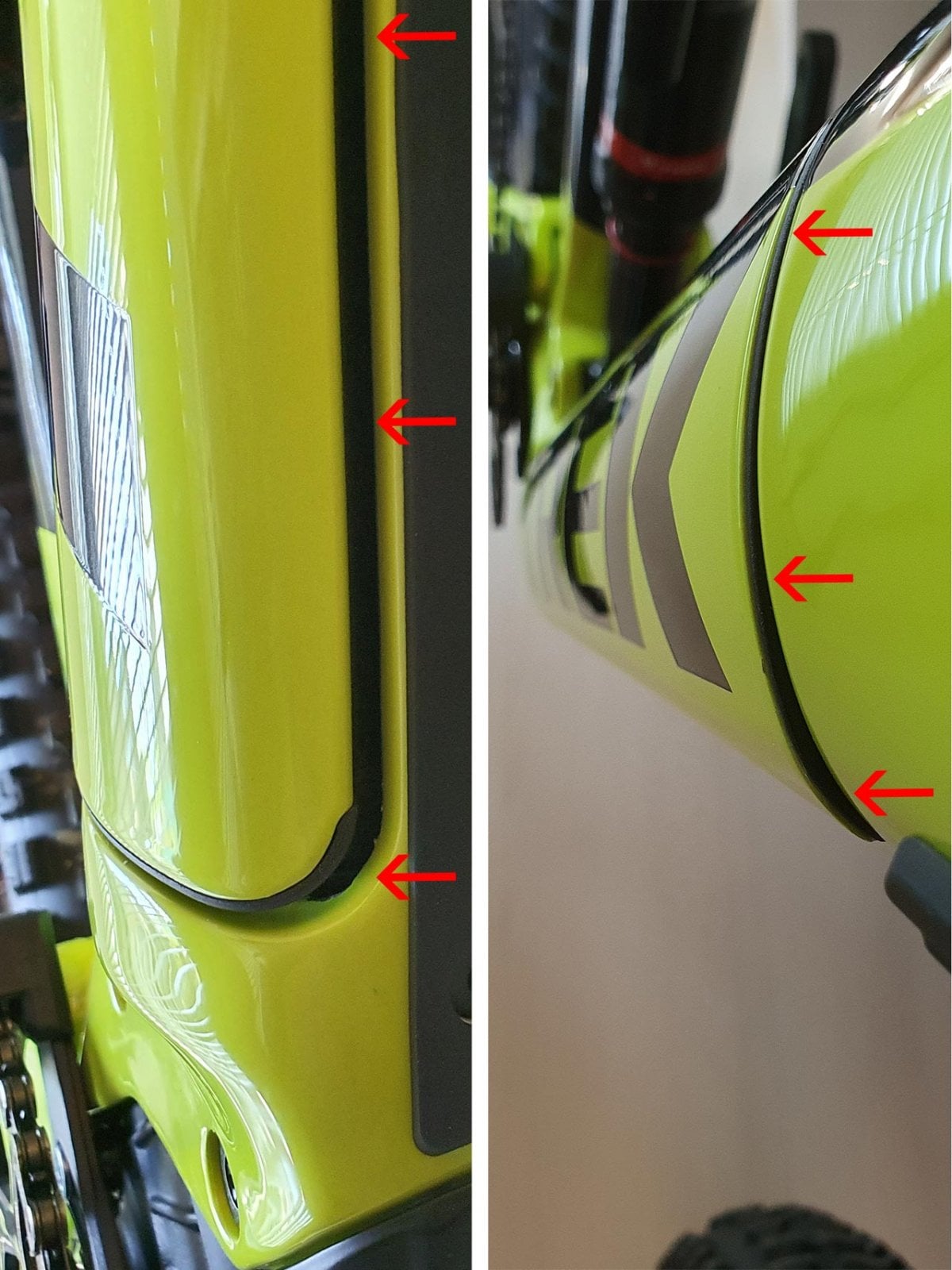

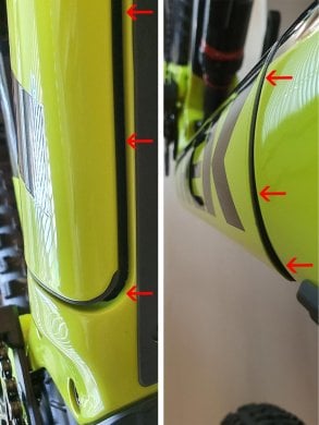

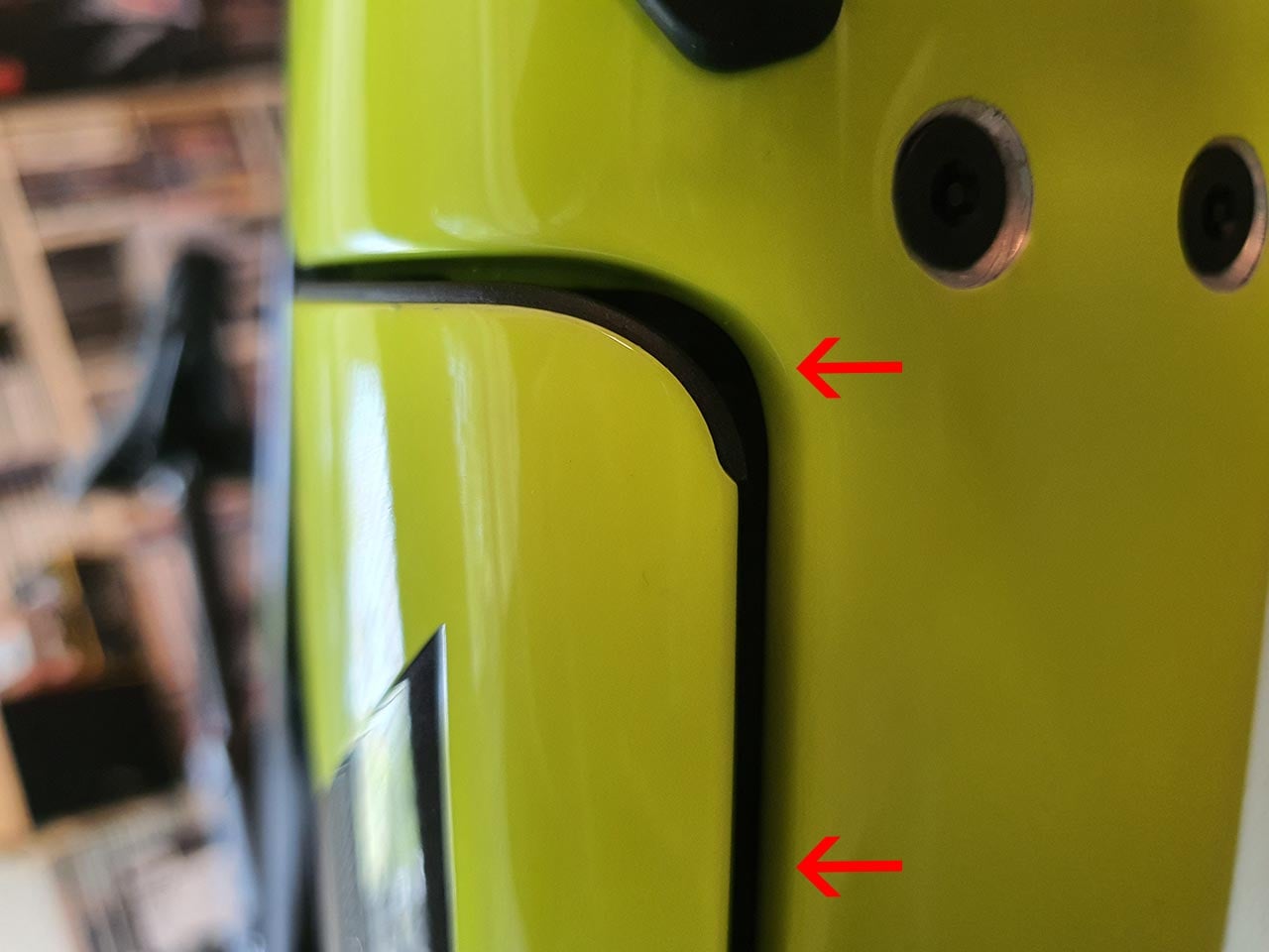

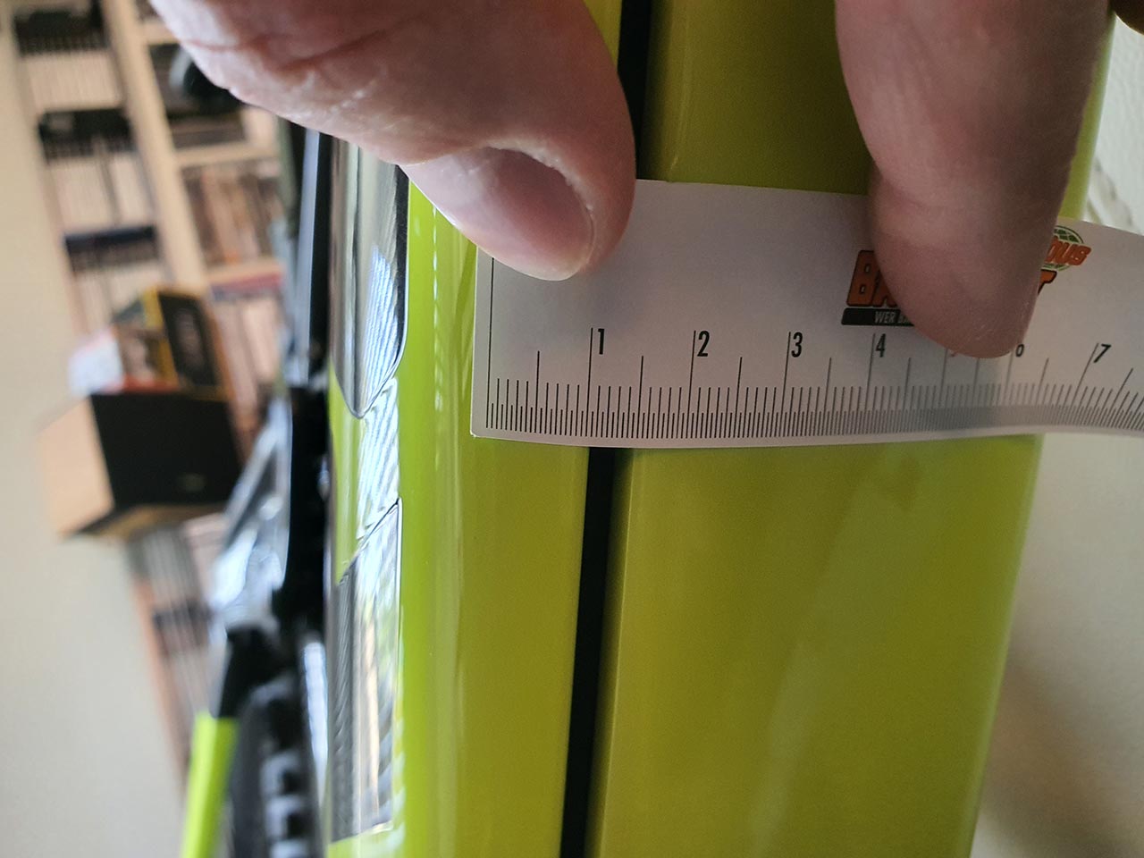

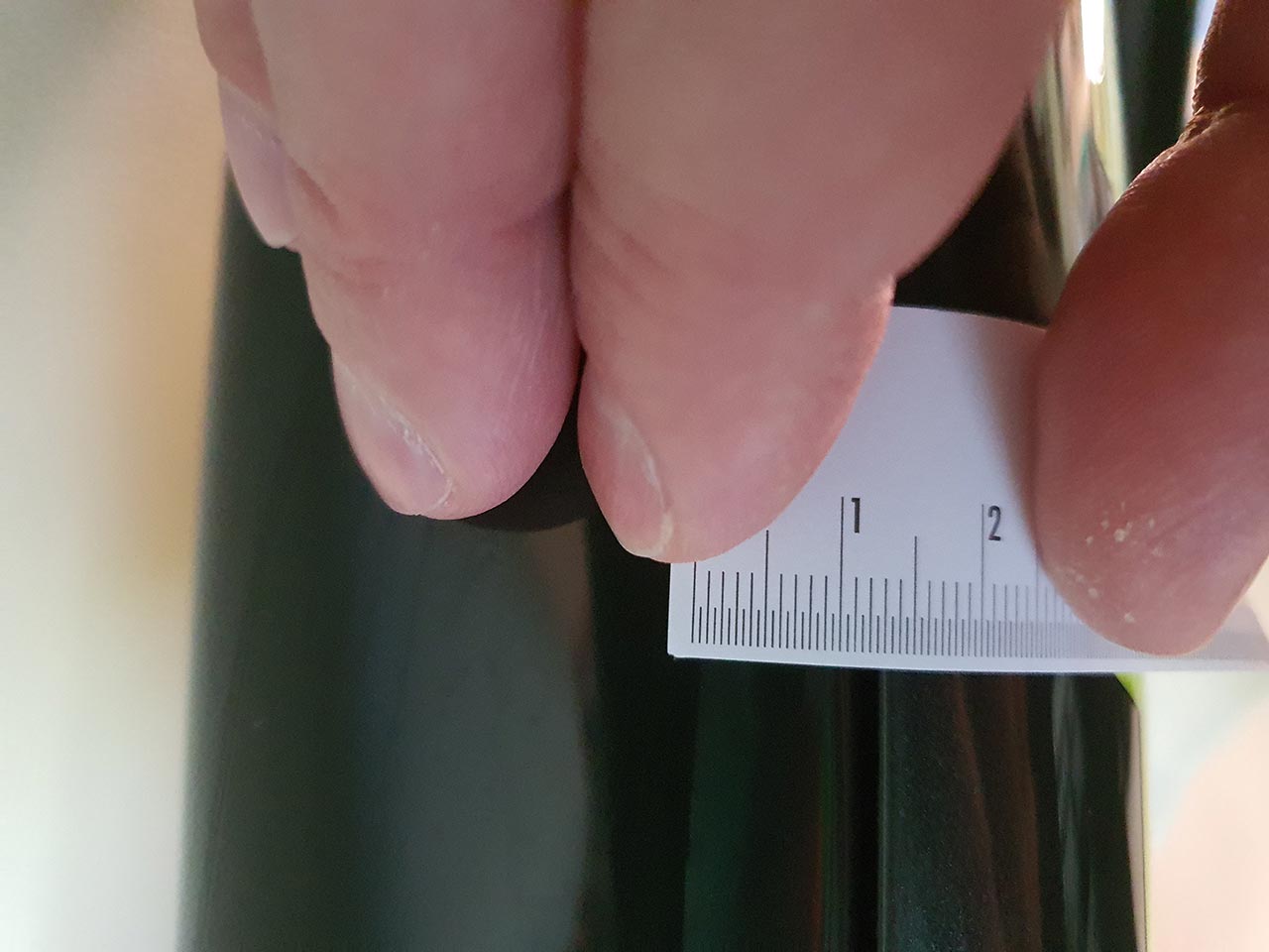

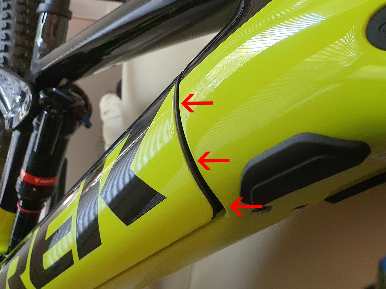

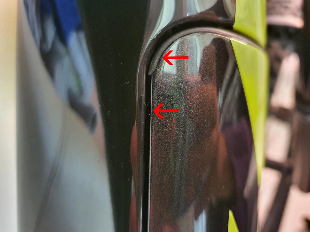

The main problem concerns the battery, it is not quite straight, so that it is not level with the frame in the lower part, but protrudes a bit further. Thereby, also the gap at the upper and lower edge between battery and frame is considerably different.

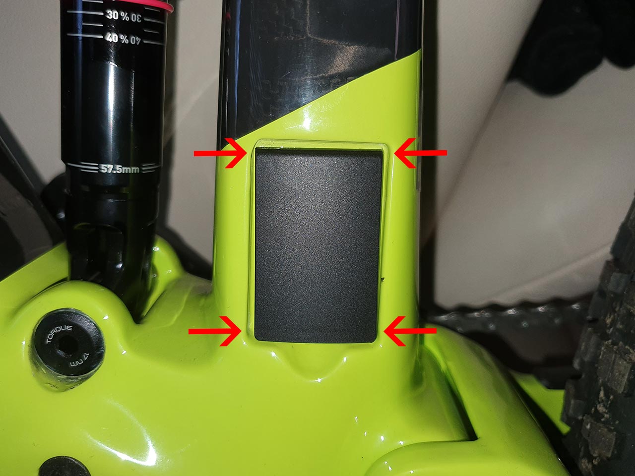

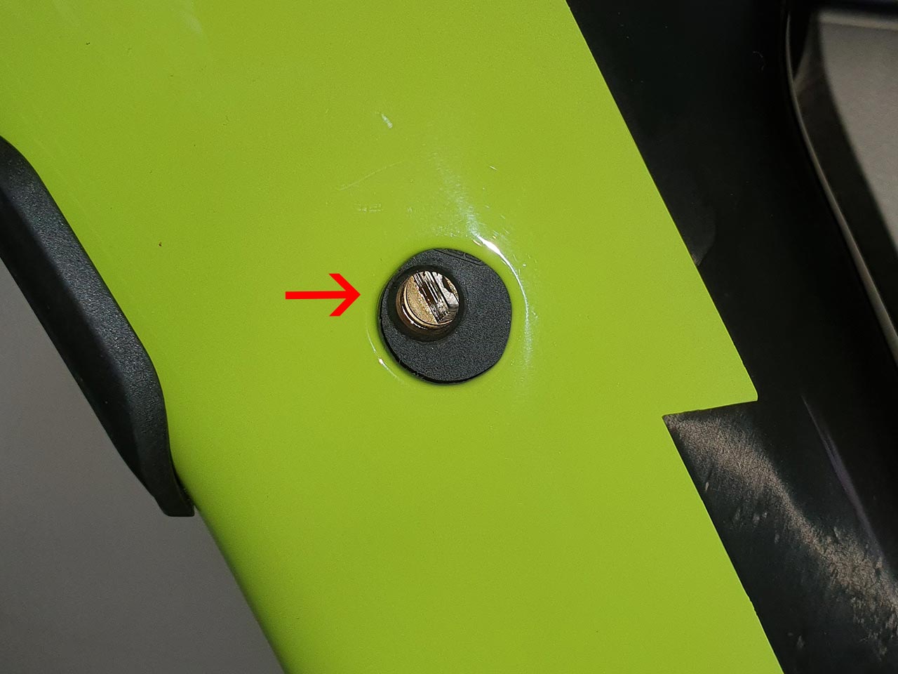

The lock on the other side of the frame is not at all in the middle of the round recess in the frame, which could provoke scratching of the paint when using the key.

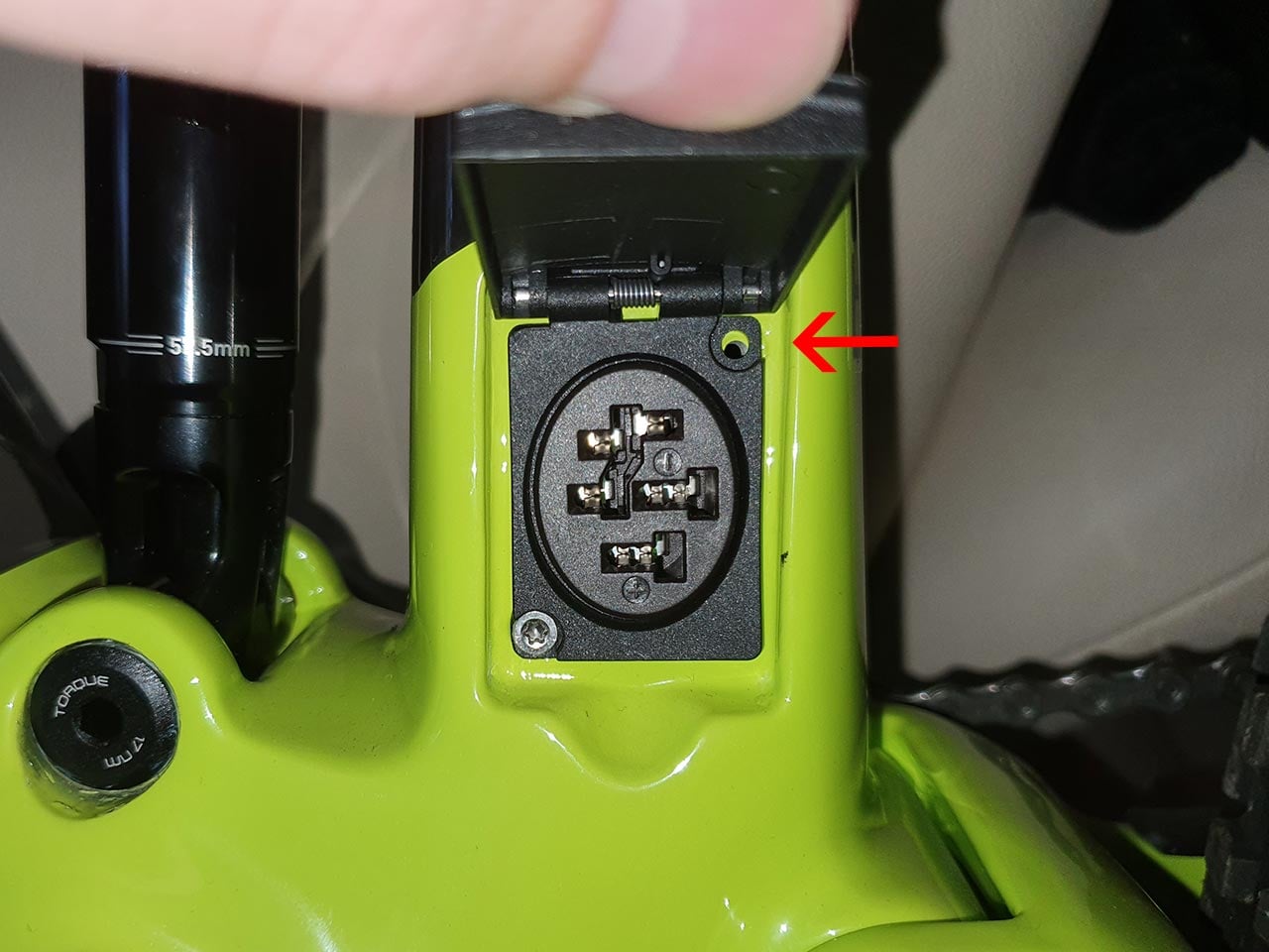

The charging socket is missing a screw and is not placed straight in the recess of the frame.

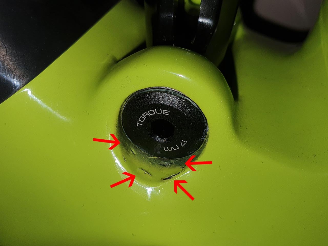

Finally - but this point was actually known to me before I bought the bike - the paint comes off at the lower shock mount. It looks as if the paint is lifting.
In your opinion, can the battery problem (it just bothers me optically) be corrected? Have you ever seen anything like this before? It looks like you can loosen the battery mounts inside the frame, but is there really enough room to adjust it? And if so, how do you align both sides exactly the same, so that no unnecessary tensions are created when inserting the battery?
The placement of the keyhole is also controlled by the upper mount. In order to correct this, the entire upper mount would have to be moved further down towards the bottom bracket. This does not seem possible to me.

Is the mount in the battery compartment adjustable? It is on most bikes so you can get the "grip" on the battery right, might be able to align it better.

Yes the battery can adjusted.
Mine is quite flush, but my mates sticks out about 5 mm.
The missing screw in the charge port can be added.
By the looks of it, I'd say the shock mounting isn't a paint issue but at some time the bike has had the shock removed and the bolt has scuffed the frame.

That paint damage could have been eventually a warranty claim at least on a non exhibition model. As it is not a crash damage or mishandled damage. For the others small concerns it can be easily fixed.

Mine stuck out like that as well when I went for ride the bike kept turning off when hitting bumps I adjusted the 2 bolts that hold the top part of battery see my post on here it's a common thing once adjusted it hasn't played up since and cover fits nice and close to frame

I had a look today and my battery lock is very off centre and there's damage to the paintwork. :cry:

I talked to my dealer today about this and he seriously wanted me to know that all the Rails they have would look like this and the battery would not hold properly if I'd adjust it to be perfectly aligned. :rolleyes:

I just moved the locking part 2 screws where the key goes into the lock it is not centre but I go careful with key locking and unlocking but I do have to press the battery in tight for the key to turn into the lock position I've done over 300 miles now with no problems at all

When I went to pick up my new Rail it had a big paint chip near the shock mount and a couple of smaller ones on the downtube.
