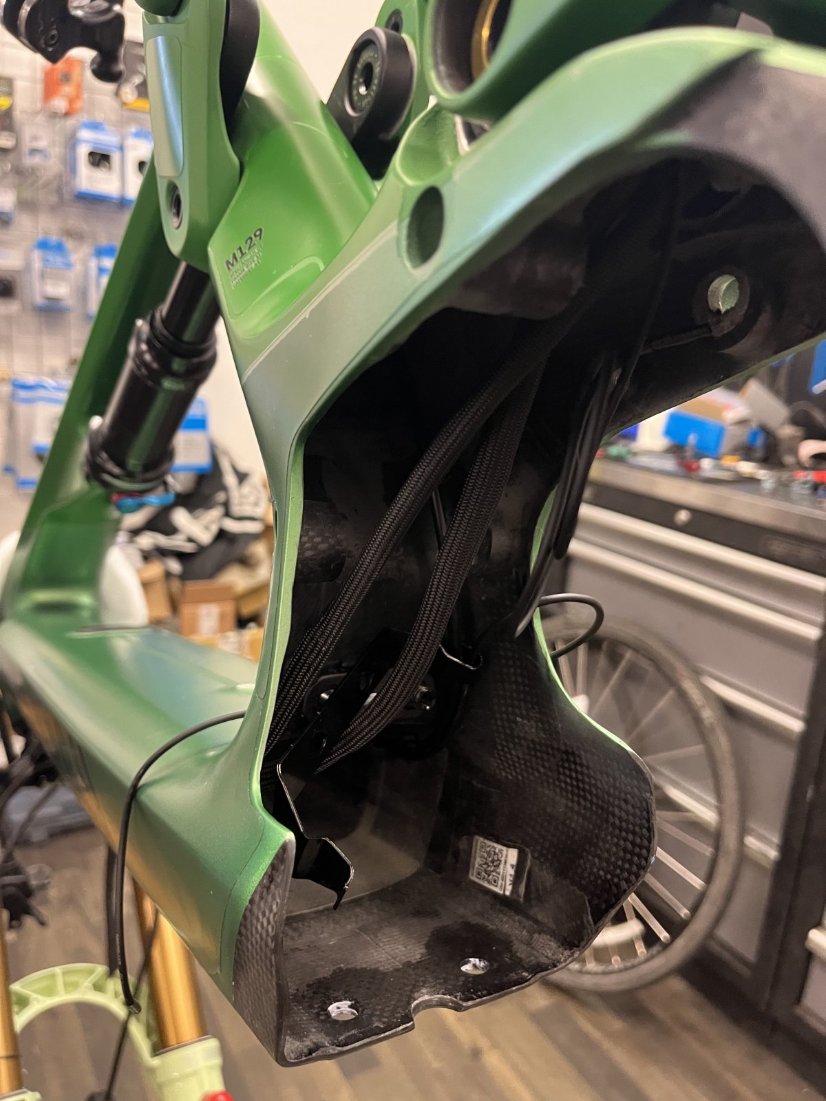

So in respect to the rear brake change over / it was a ball ache !! The motor had to be removed to allow the new brake cable to be threaded back into fixings. Two man job as it was tight and needed to be gently eased around the bends in order to not kink the hose. Won’t be changing that again ! Ha
Picture shows the interenal routing of cables. Pretty cool inside tbh. Only good thing was to actually see how the inside works, interesting.

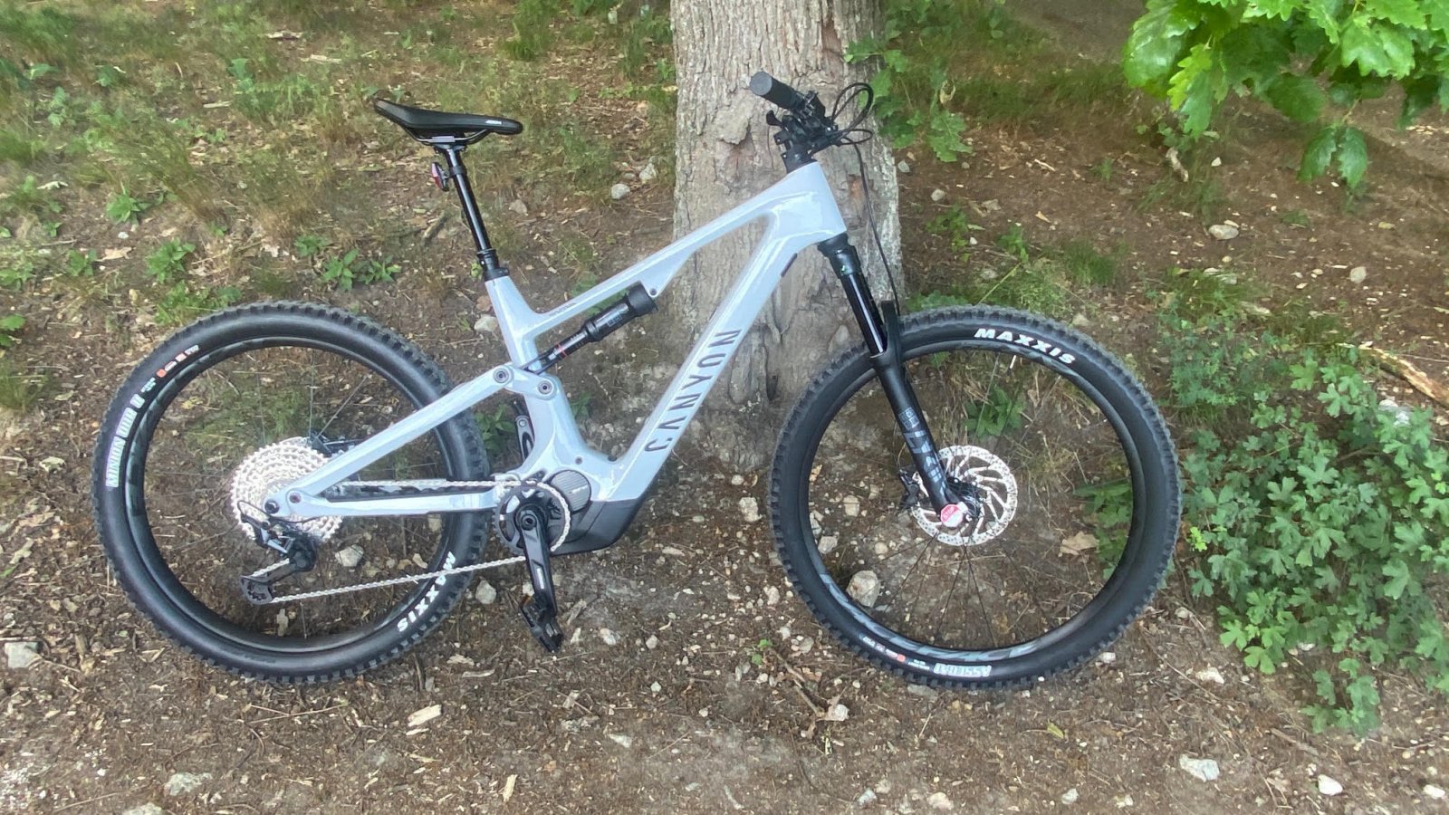

Hi, I bought month ago Canyon Spectral on 7 in white...
Hi Edge, any chance for more pictures of your bike, as you are here the only one who has spectral on in boundless grey? ;)
