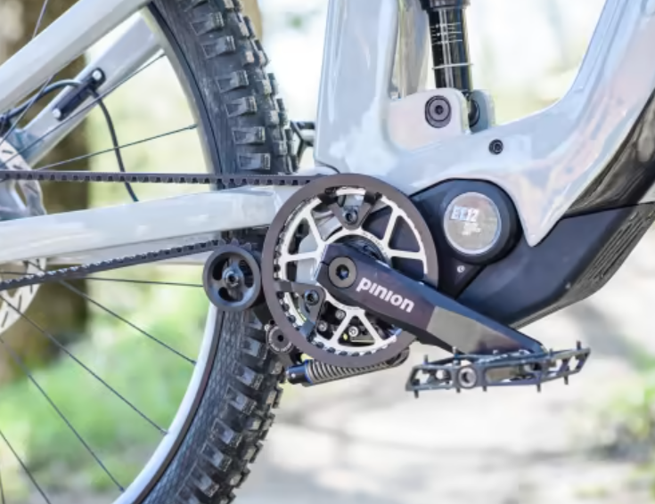

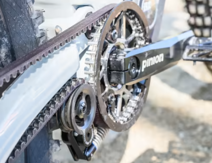

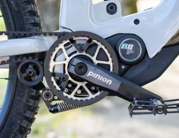

Any reason the tensioner can't be slid towards rear wheel down the chainstay?
Does it need to be so close to the chainring?
Even move back 3-4 inches would help greatly.
The tensioner can be moved. On the gearbox only bikes (Zerode etc) with a belt the tensioner is tucked well away. The MGU one looks like it is part of the motor unit which may suit some bike builders but no reason it cannot be moved.

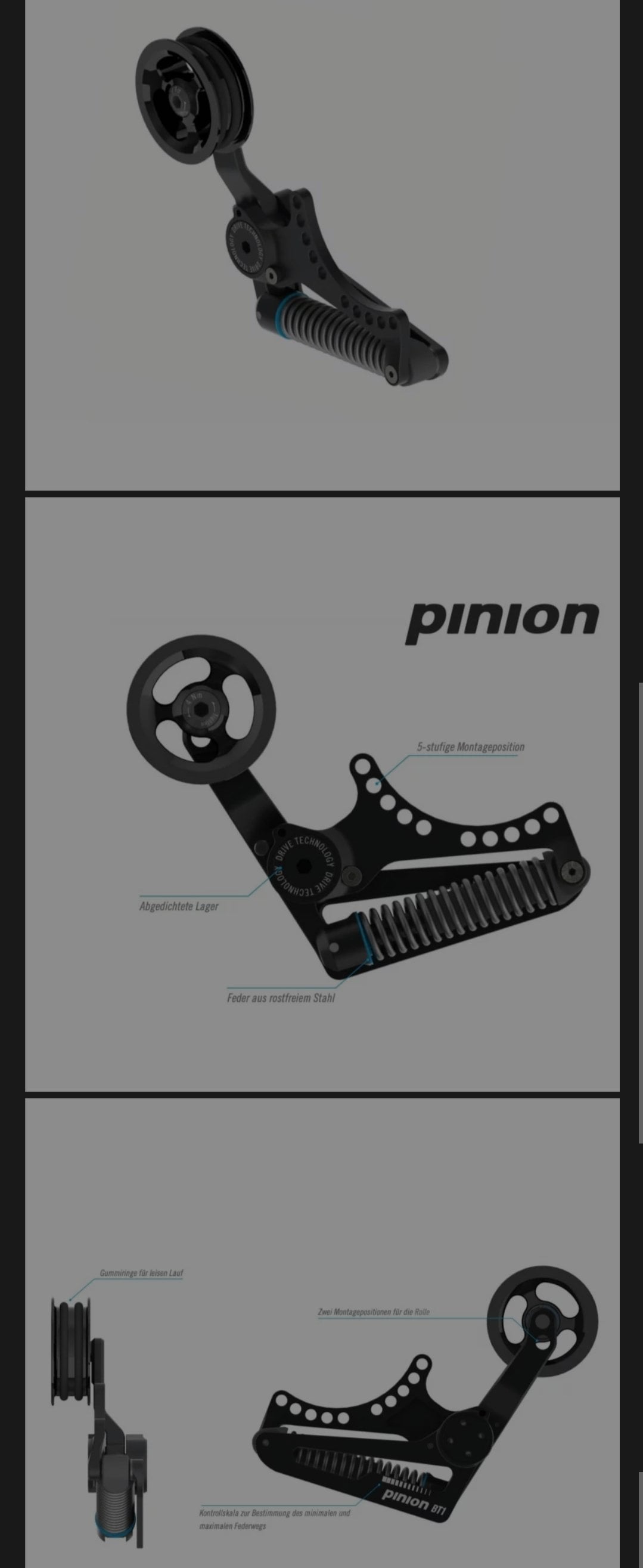

The standard Pinion tensioner has 5 different position settings and 2 positions for the belt roler...
At least when you see it like that, it looks less like a damping mechanism re-purposed from an office filing cabinet ...
It looks like it's about as far out of the way as they can get it really. There's not a lot of space and I don't think you could make one to mount it from above instead. An alternative design with a rotary damper/spring or torsion arm ? Might be better, but presumably wasn't practical/effective.
If you put the tensioner in the middle of the chainstay (for example) then it can't take up much slack.
Gates are very vocal in their warnings about tension and tensioners etc but I'm sure something could be done at the rear hub or elsewhere.
I wonder why they went with a compression spring? Surely a tension spring above the pivot would make more sense and would get it well out of the way?
Probably because this is a standard part that has been in their portfolio and fits several different types of bikes they equip with their gearboxes, belt, etc...or it's probably a generic Gates product just adjusted an renamed, don't know would need to do a little google research...
Yes you are correct, belt tension is crucial with these drives, as just one slip of/over the rings teeth can create irreparable damage to the belt, especially with the torque that is available on the emtb, so there is one plus for the chain drive(u use a chain link, or in case a chain slips, u know it's realy time to change it.
I am sure if this get going, they or other will create an emtb friendly tensioner. ✌️
