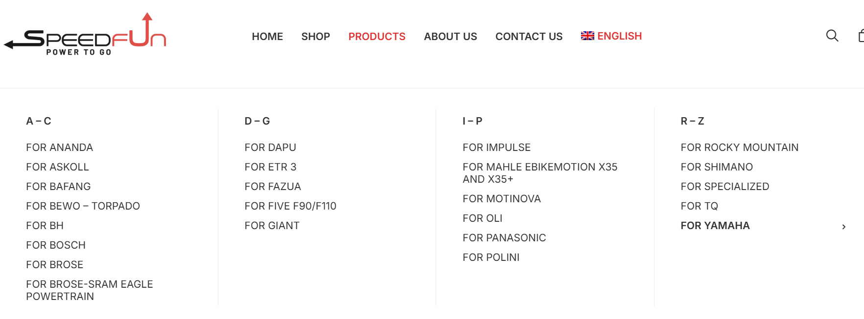

I only found this so far: Pinion MGU bikespeed-RS calculator
And someone here says it doesn't work any more: Pinion MGU Derestricting with Bikespeed
Doesn't look like Speedfun has one:
