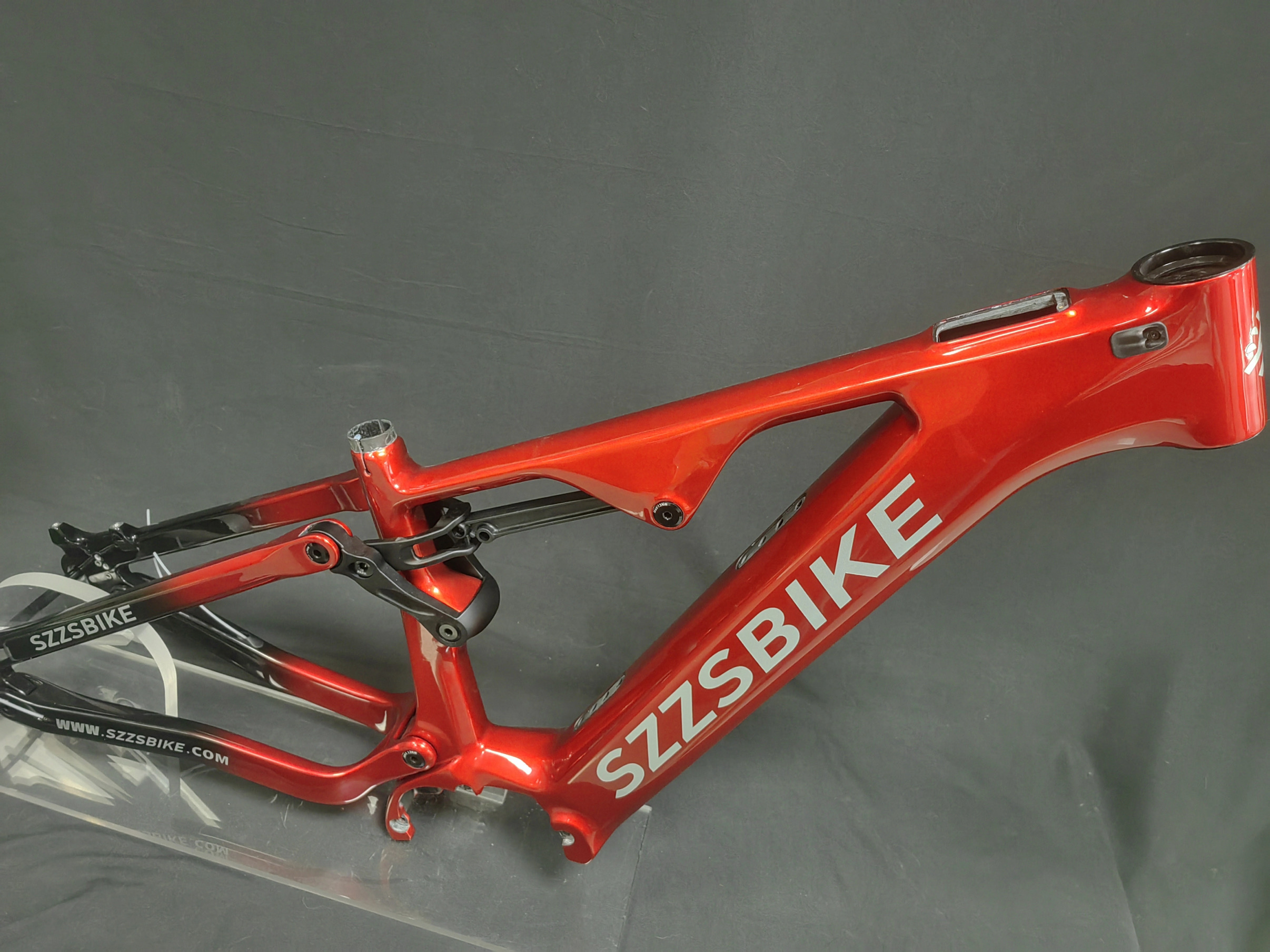

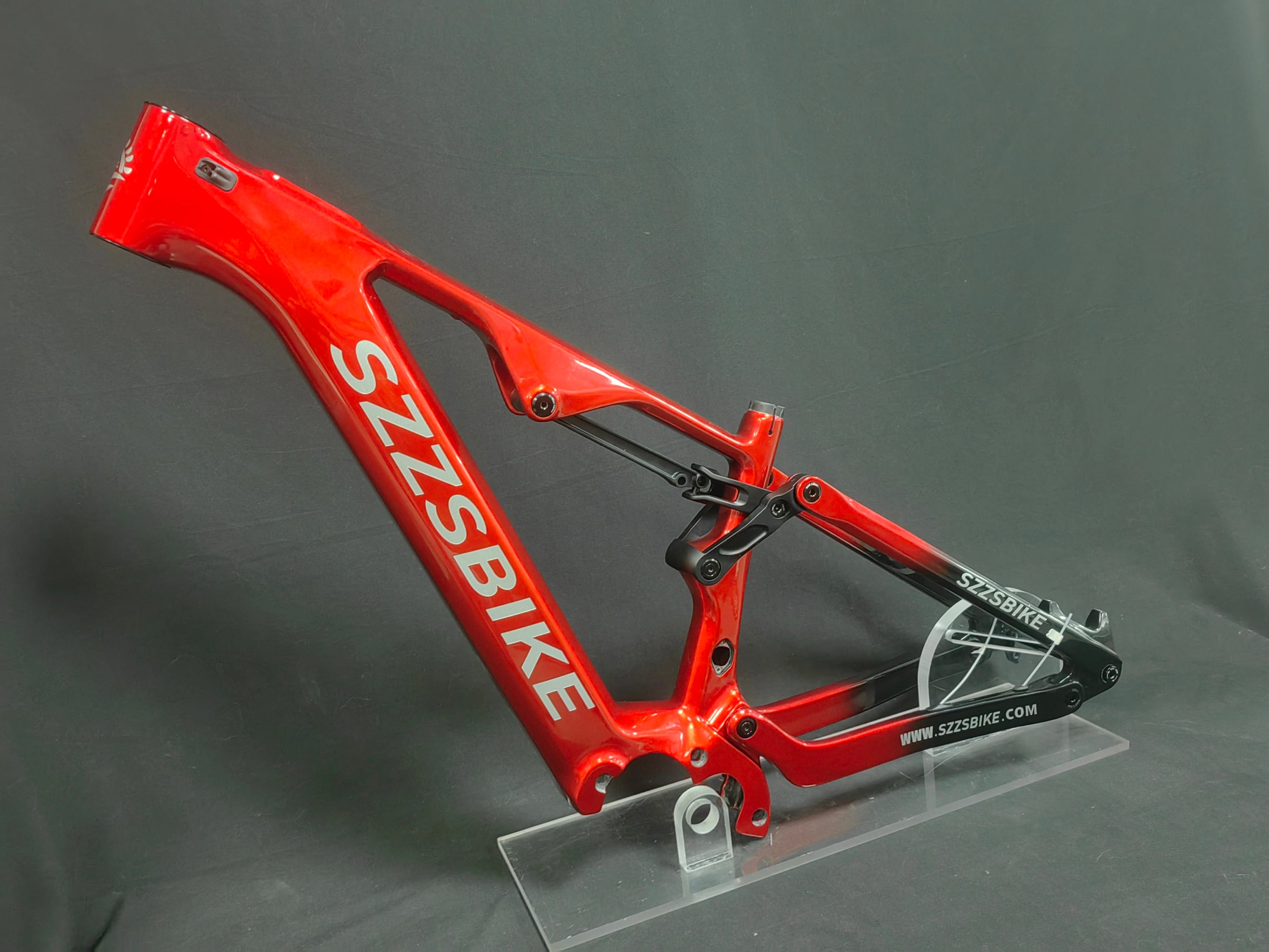

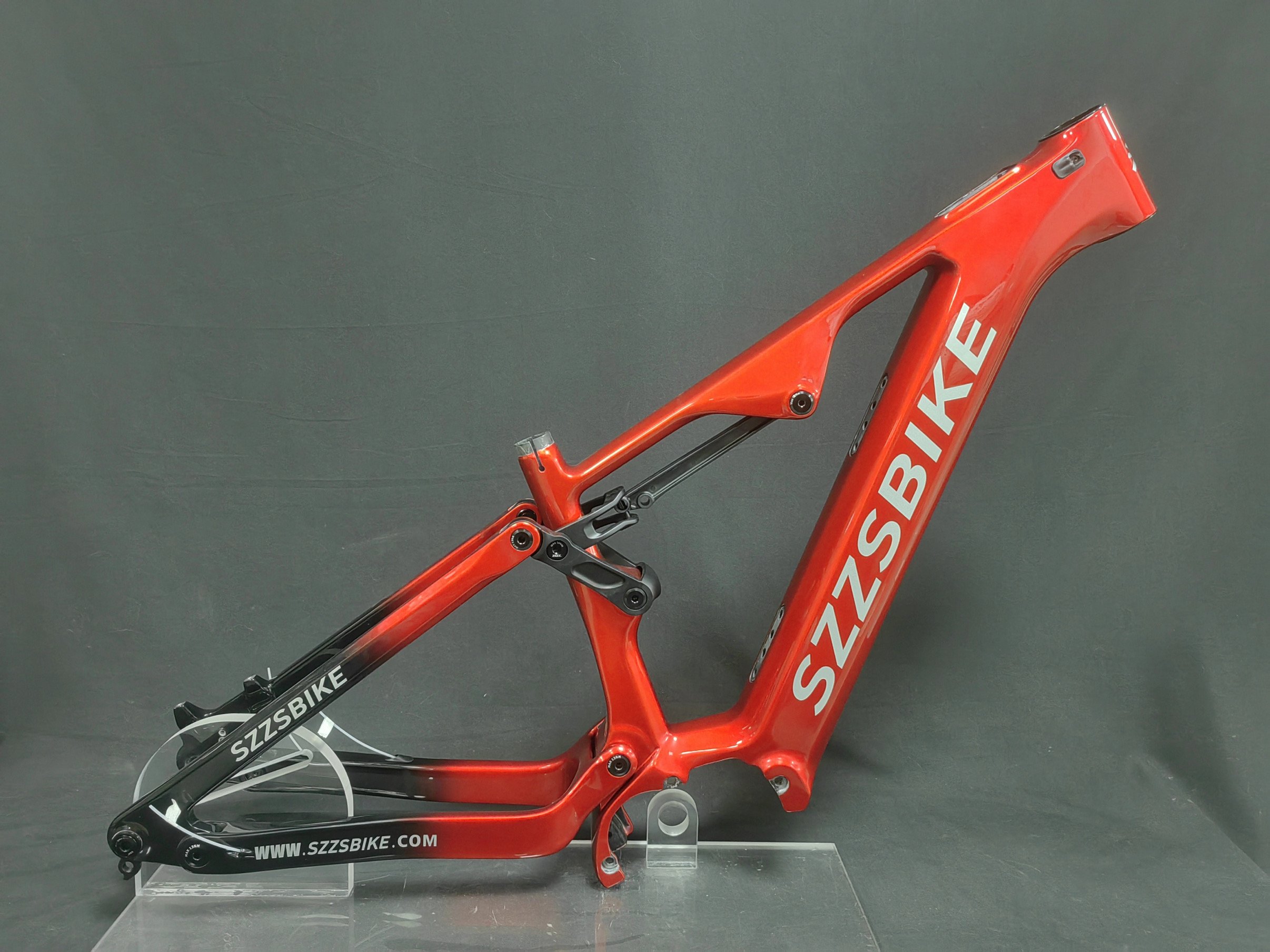

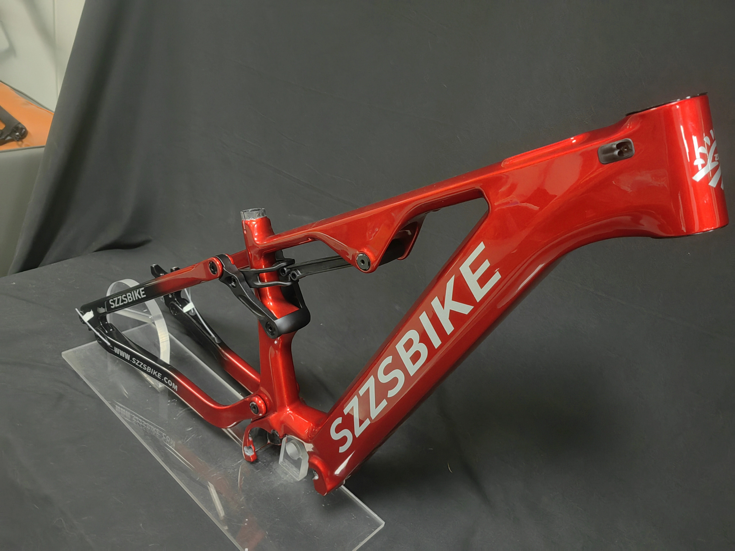

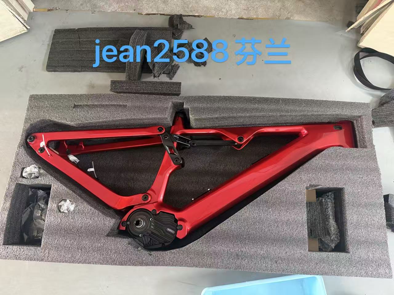

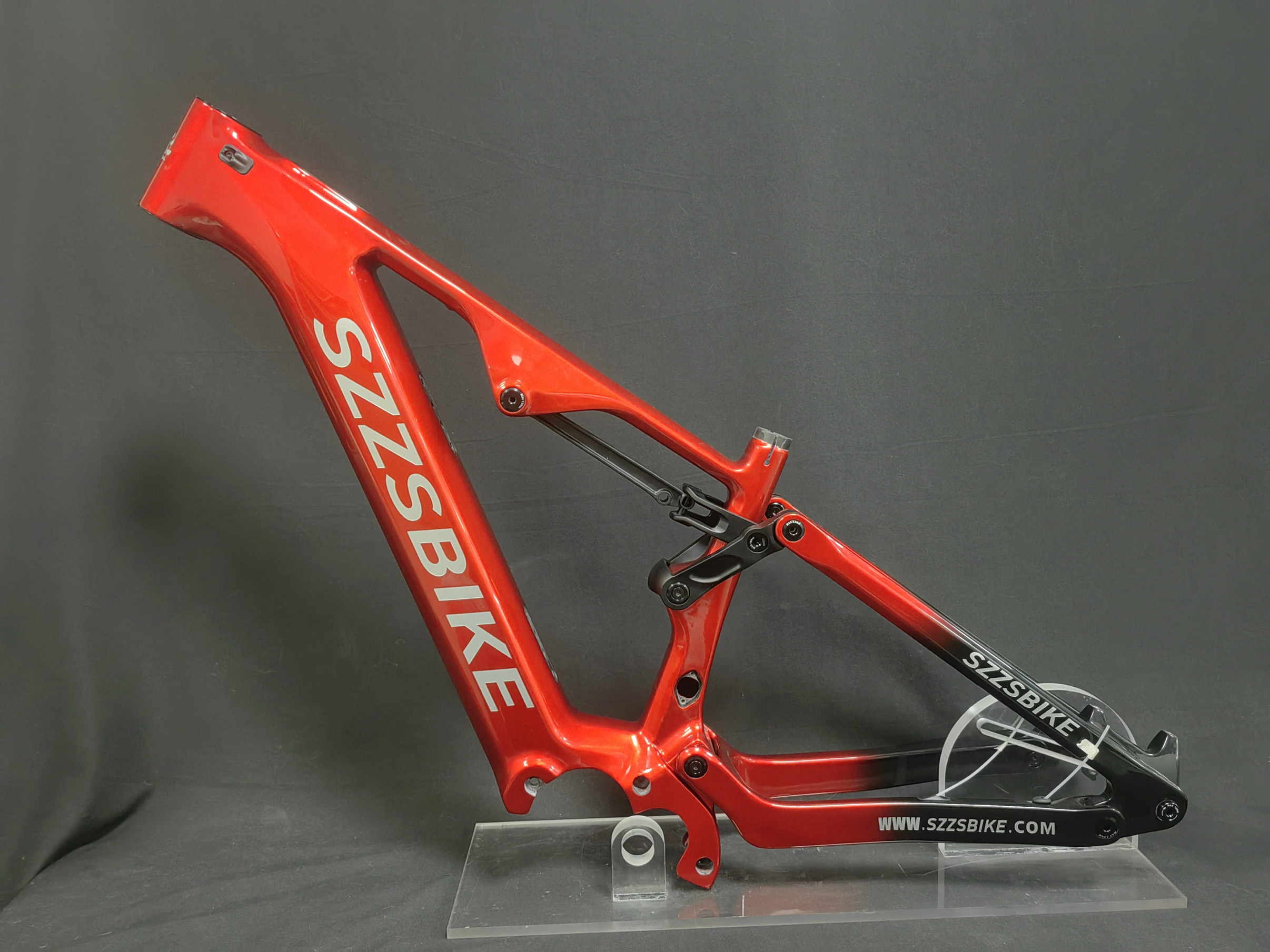

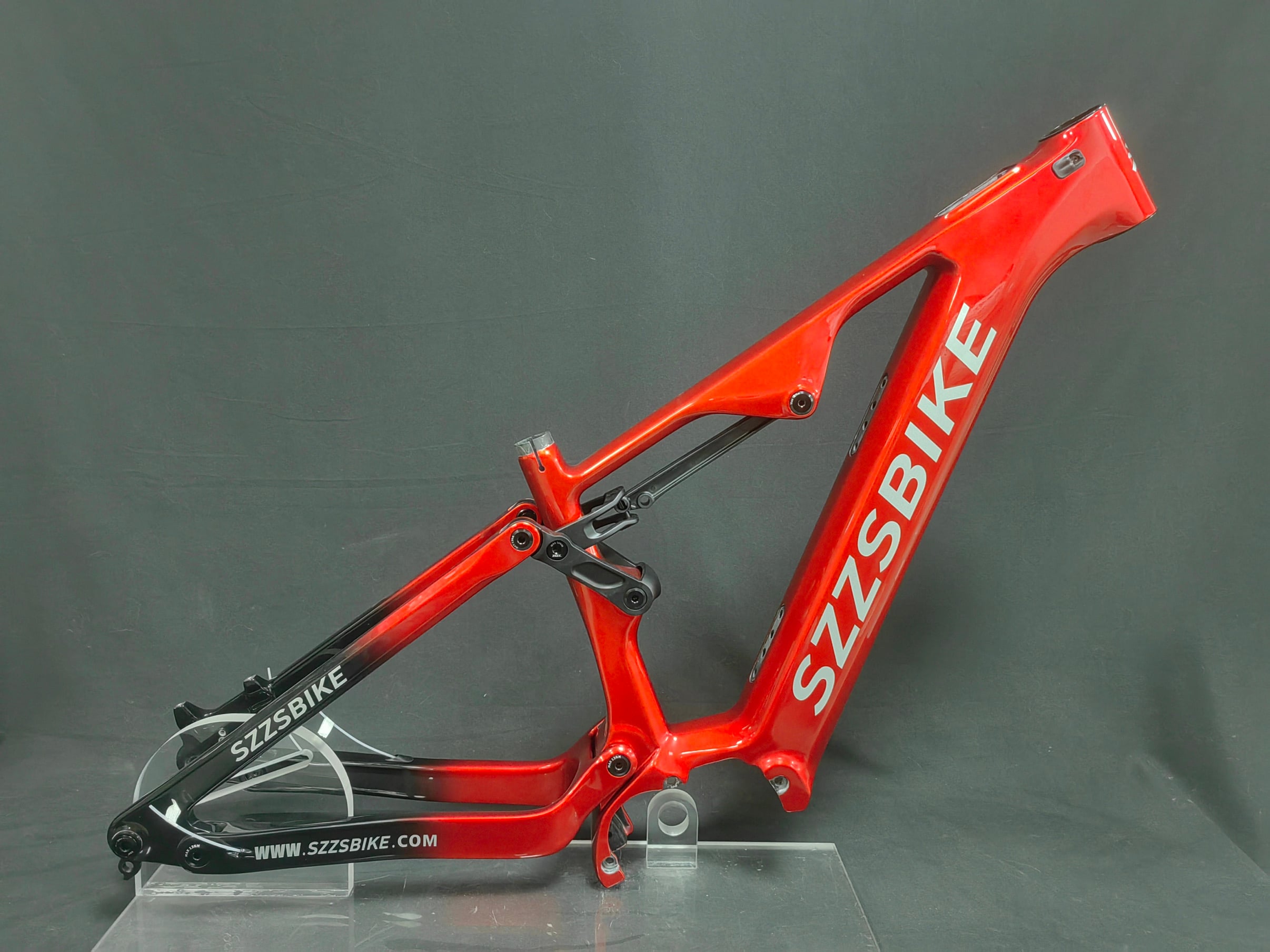

My frame is shipping soon too, will build it slowly over a couple months over winter checking for deals, already got some good stuff. Will post later once completed :)
Not bad, colour is quite nice. How much was it?
1900 USD for motor (m560) + 835wh carbon case battery + frame + all the miscellaneous stuff you need. 326 USD shipping to finland with duties so lets hope no additional cost there. So 2245 total, a lot of it is shipping.
In the end im hoping total bike build will be around 3.5k€ not going for super high end stuff unless i find some good deals. I didn't like the specs on prebuilt bikes in that pricerange, theres always some weird choices in those so i felt DIY was the choice for me.

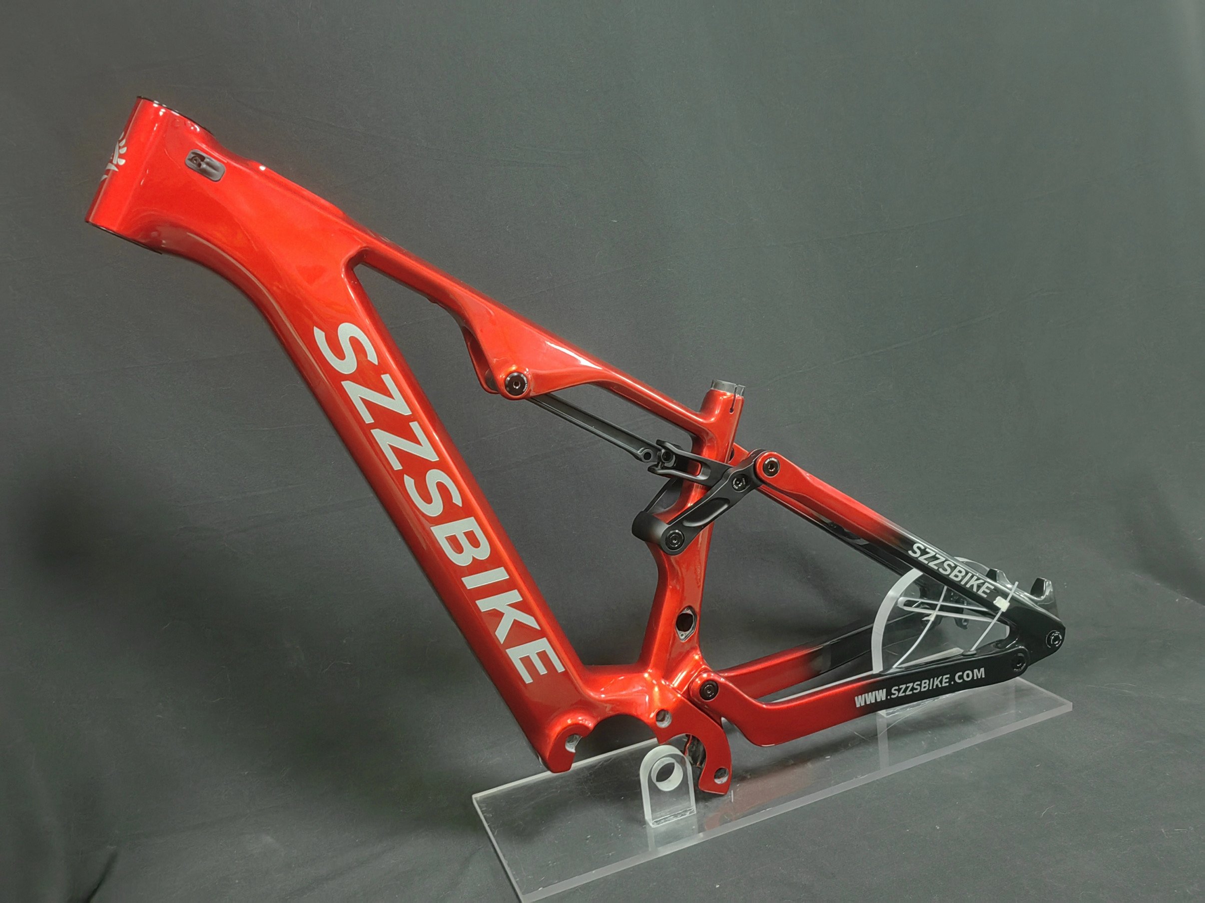

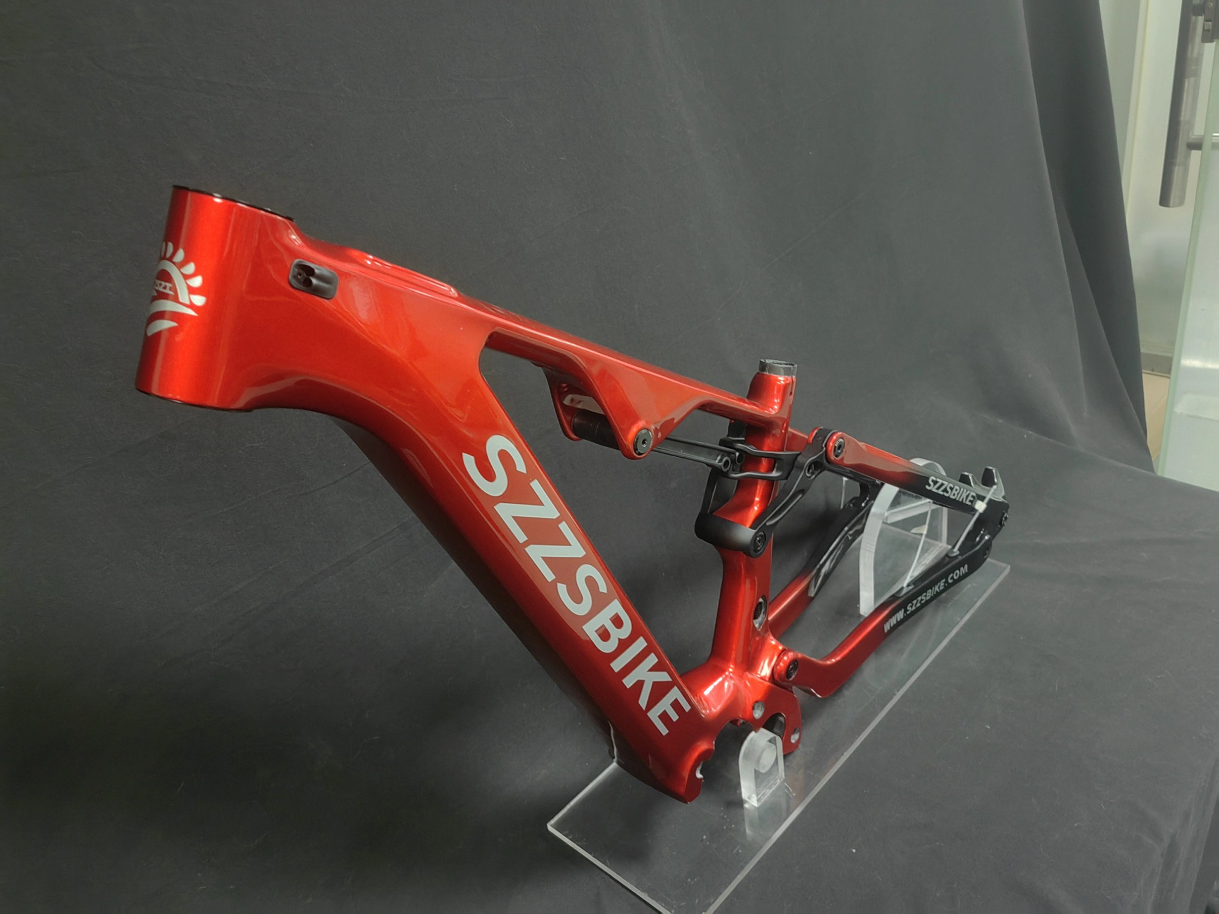

We have Cef69 test vehicles available for anyone who wants to try them in Seville, Spain – a truly spectacular sight with stunning colors.It will be fitted with an M510RS.

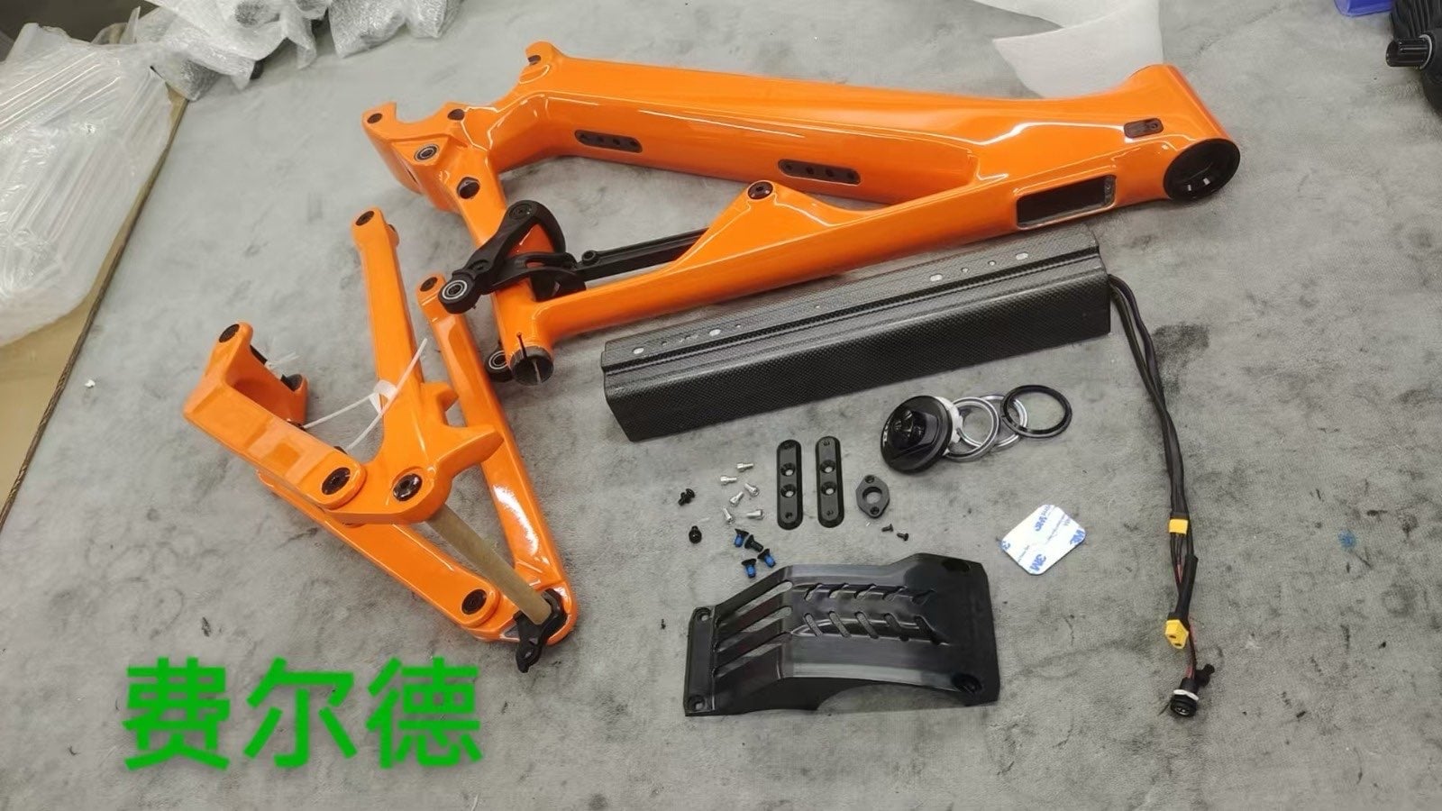

Mine hot off the presses. Thanks Chili for the great communication and service thus far through the process. Cant wait.

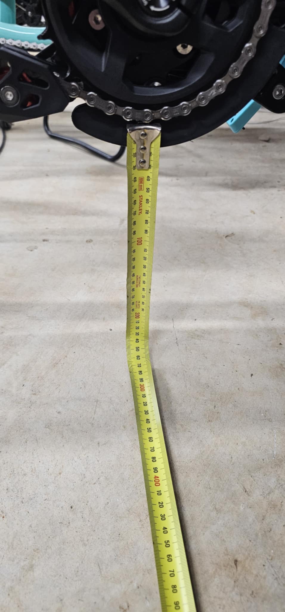

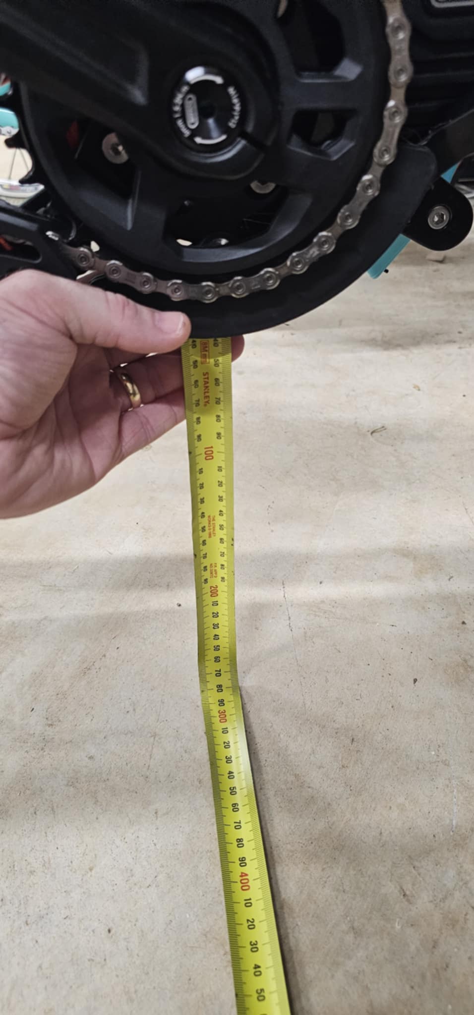

Guys i went through this, The BB is 20mm lower with a 205 x 65 Shock 27.5 Rear, the 2mm Bushing won't do much to help It might bring it forward or back 2mm. Engineers also from SSZbikes also mentioned that the 2mm bushing won't work, Told me if you dont want pedal strikes get smaller cranks or get 29inch wheel.
I'll get picture at luch of my bike and the heigh of BB

The distance from the ground to the bb with a mullet should only be about 8mm lower. The drop is a little different than the actual clearance. I agree the 2mm offset is minor but it helps. Is the bb really 20mm closer to the ground?

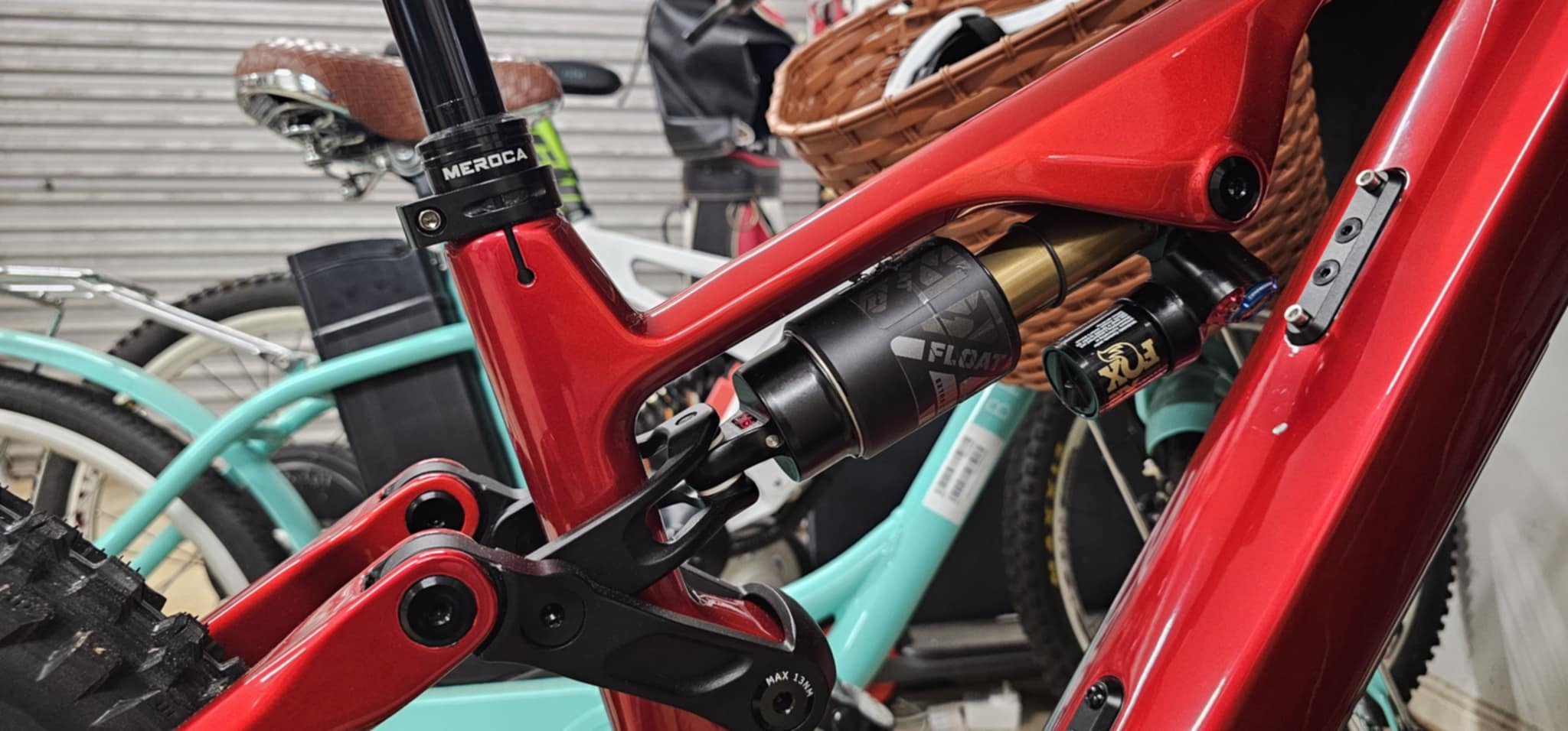

Here are some pics, One is where chain is and other where mount is under the bike, I have chain guard on bike, Attached is x2 which i will be changing as it hits top of the frame.
To Motor Cover To chain
X2 you can see i have already scrapped sticker off, you can see the mount 2 mm off set won't change much
Thx. Chances you have a 29r wheel to compare?
I do have 29inch wheel that needs to be laced, Reason i say 29" be better looking at the latest pic that showed the CEF69 that come second in the EMTB UCI championshhips, He was usina a OHLINS which when i mesaured them were about 1mm can size smaller then the X2. , Unless im wrong it looks like the TTX2.
My, very basic, maths says approximately 12mm. Difference in diameter is 1.5 inch so difference in radius is 0.75 inch, 19.5mm. If the BB is halfway between the 2 axles (it is more to the rear) that 19.5mm will be halved again. As it is more to the rear the drop will be more. So a educated thumbsuck is 12mm.
Feel free to correct me, my school days are long behind me.
