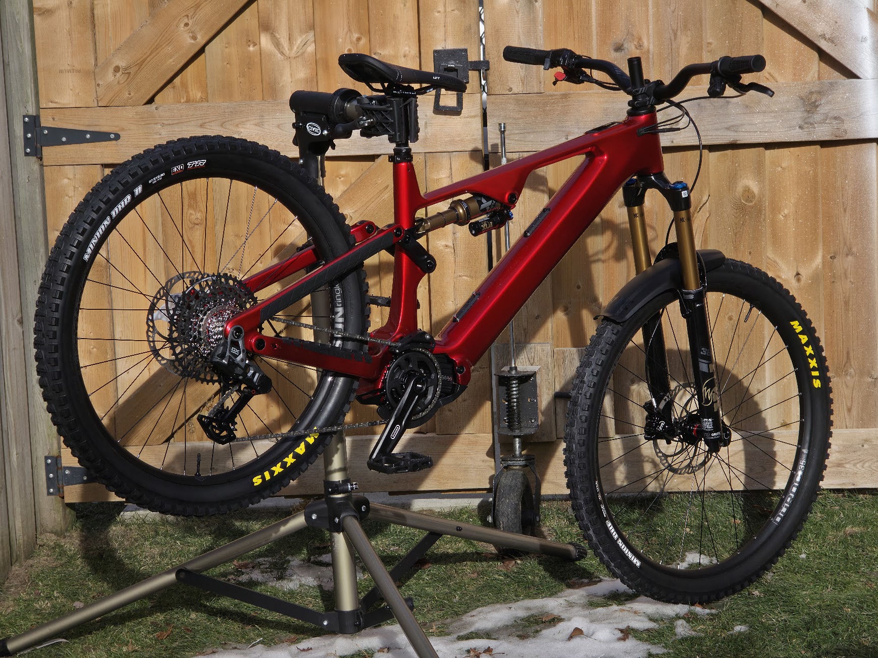

Yes 27.5 there is picture in this thread, It felt great no issue at all. should easliy get 80km out of battery, I havn't tried on trail yet, Only thing is the Banfag app doesnt work with Strava says the app has reached its user limit, not SSZ issue though.

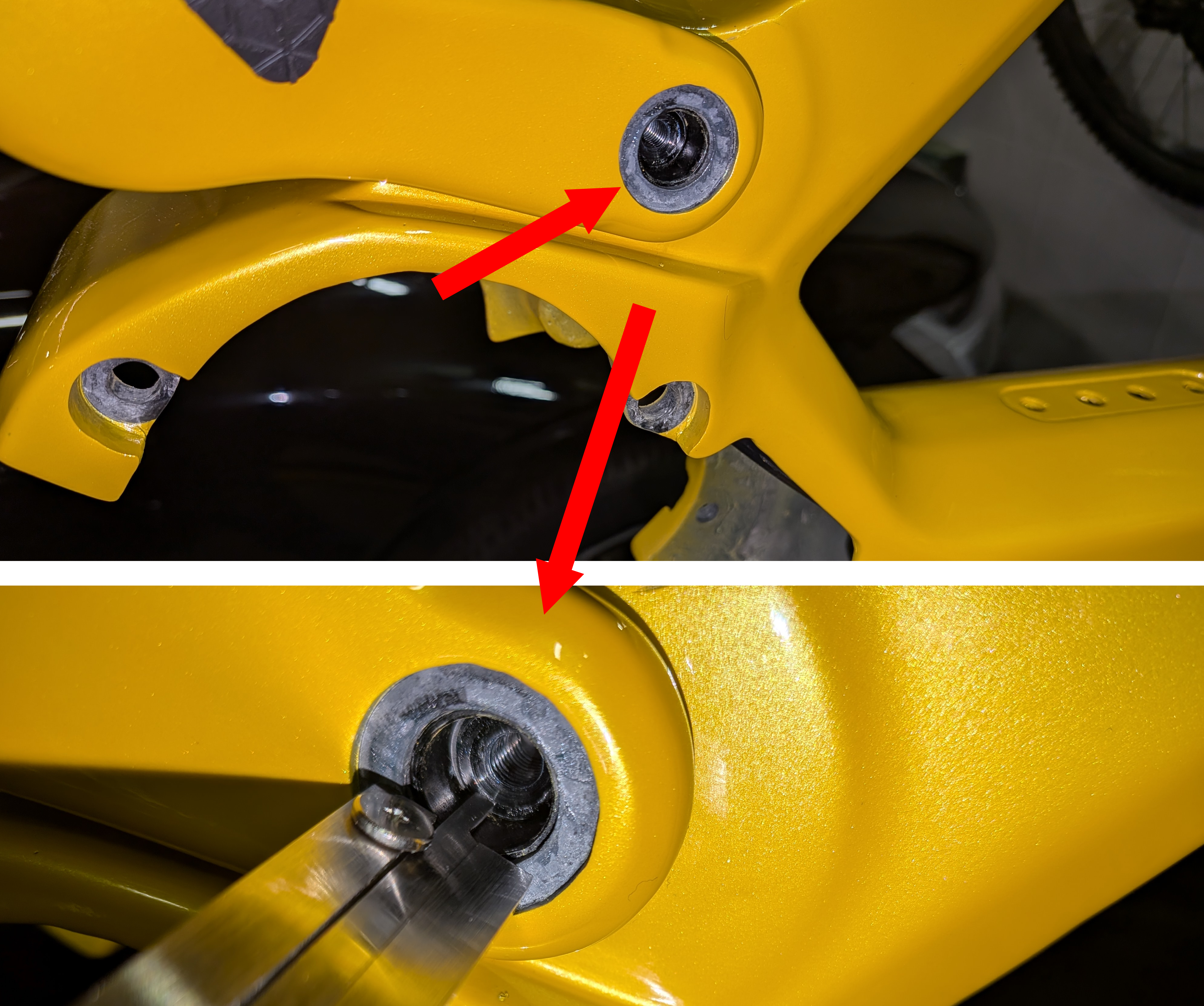

I have a request for you: please unscrew the lower rear triangle pivot bolt (just from one side) and measure the depth with a caliper (as shown in the photo). Why? I’ll tell you — the bolt I received is too short, and because of that, it lacks support on one side. I hope this is just a one-off case.

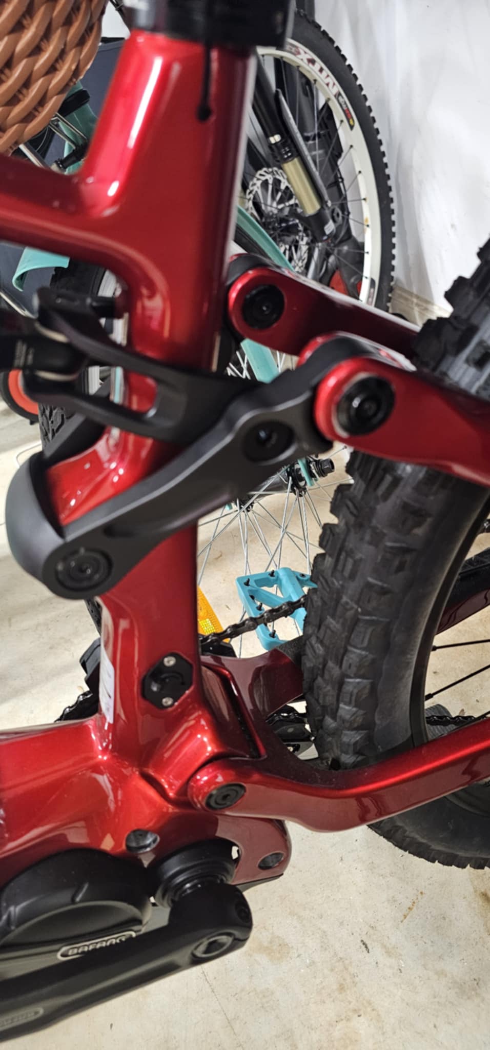

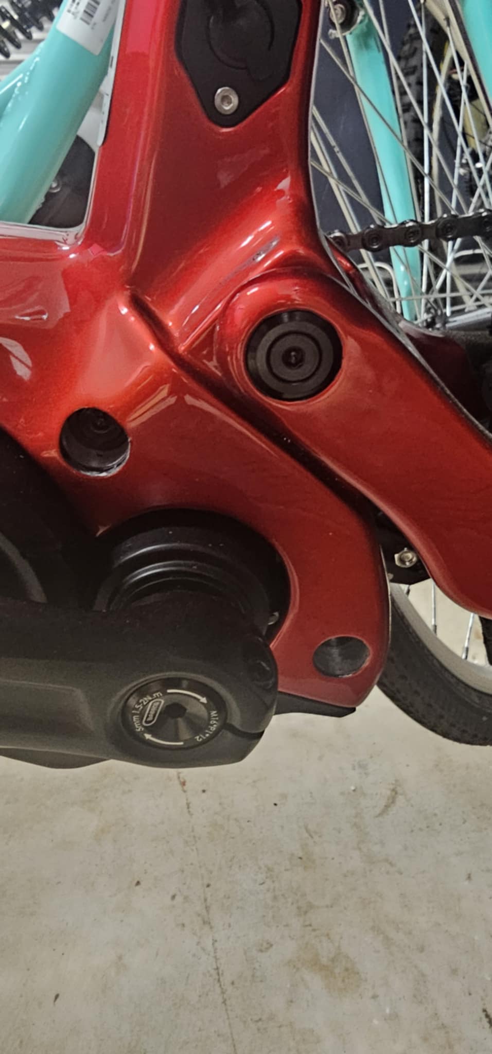

I have been playing around with the bolt sizes also. They are not all the same nor are the washers. I too had to use the short one on the photo you took. If you don’t you will have play on the others.
Guys also if you buy off Jean, Since im in Australia he would usually respond wth in 1hr on Alibaba, I was messaging him most days building and would always respond.
Bolts do recess on Motor, Here are some pics of Pivit point, And if its a 10mm Bolt use 10NM unless says on bolt.
Hope this helps

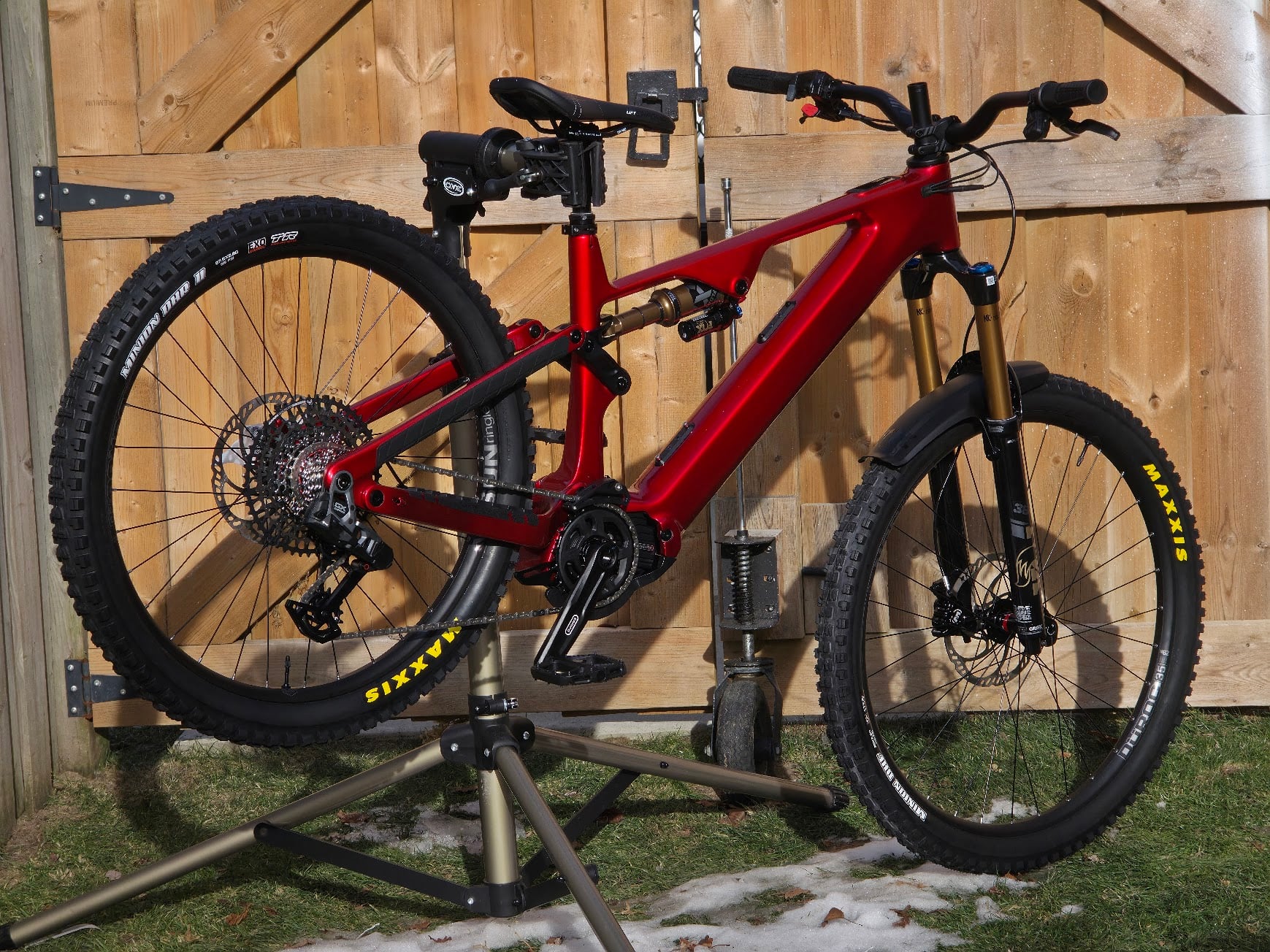

So far everything has gone together great. I have ordered a set of 152mm cranks for the bike, as well as some final touches. The bike looks amazing, and ready to ride when this ice stops flying here !
It was approximately 4 months from the time I sent the money to the time I received my bike in Ontario Canada. The dates they had suggested were correct, and everything was there. I ordered the wheelset with the bike too, they arrived in another package, but in the same shipment. The UPS tracking number they had given me, and what we used were two different one. I kept checking and the UPS tracking stating it was waiting for the package, not even 15 minutes after checking UPS was at the door dropping the bike off.

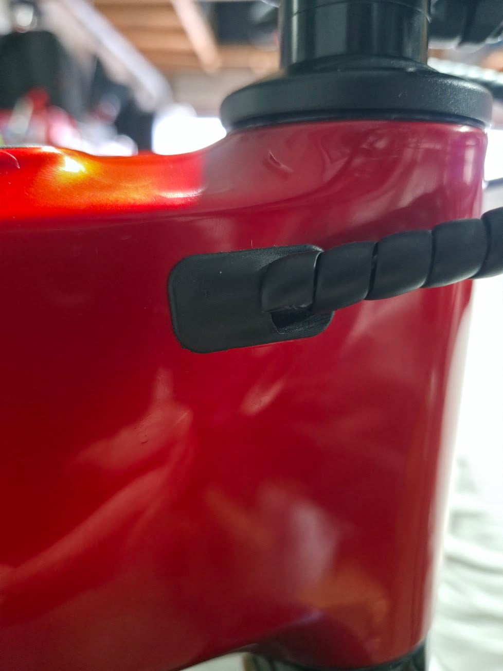

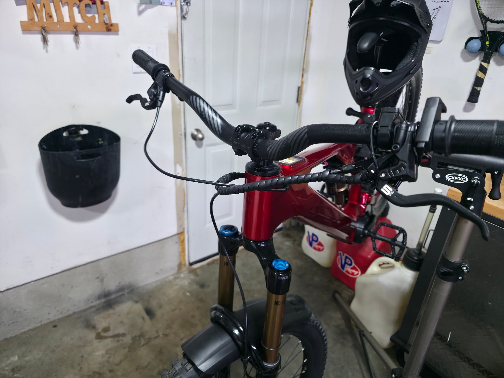

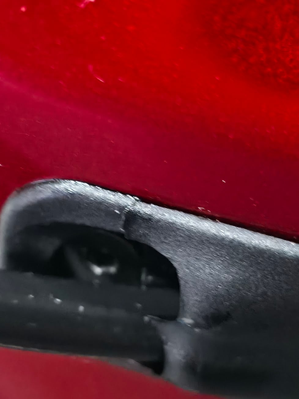

Nice build..how did you route the throttle and control cable to the frame? Did you drilled the holes bigger?
Where did you order 152mm cranks from, what material?
Yes ...... but one side has a slit in the side of it to slide a large head through it.... little did I know. But Drilling is possible.
I have wrapped side with the controls / throttle on the side. I have also made it that I can remove the throttle for parks that I intend on riding that insist on no throttles. Which is no big deal to me, so I have left the connector on the outside of the bike, plus the throttle cable is unfortunately just too short to put all connectors inside the frame from what I have received. I wish the throttle cable was 4 inches longer.
Other than that, it looks much cleaner than my FREY AM1000V6 Wiring.

I just checked the weight of that frey bike and thats a tank, 33kg lol. Is your build like 10kg lighter? xD
Its 21lbs lighter, being said I had a absolute blast on my Frey; over 4000km; and with 170NM but 70lbs... yikes. I am very excited to ride this and see how much faster it will be with only 150NM and 49lbs.
Ill still use it for towing the dog trailer, and around town! My wife will also start riding it.
