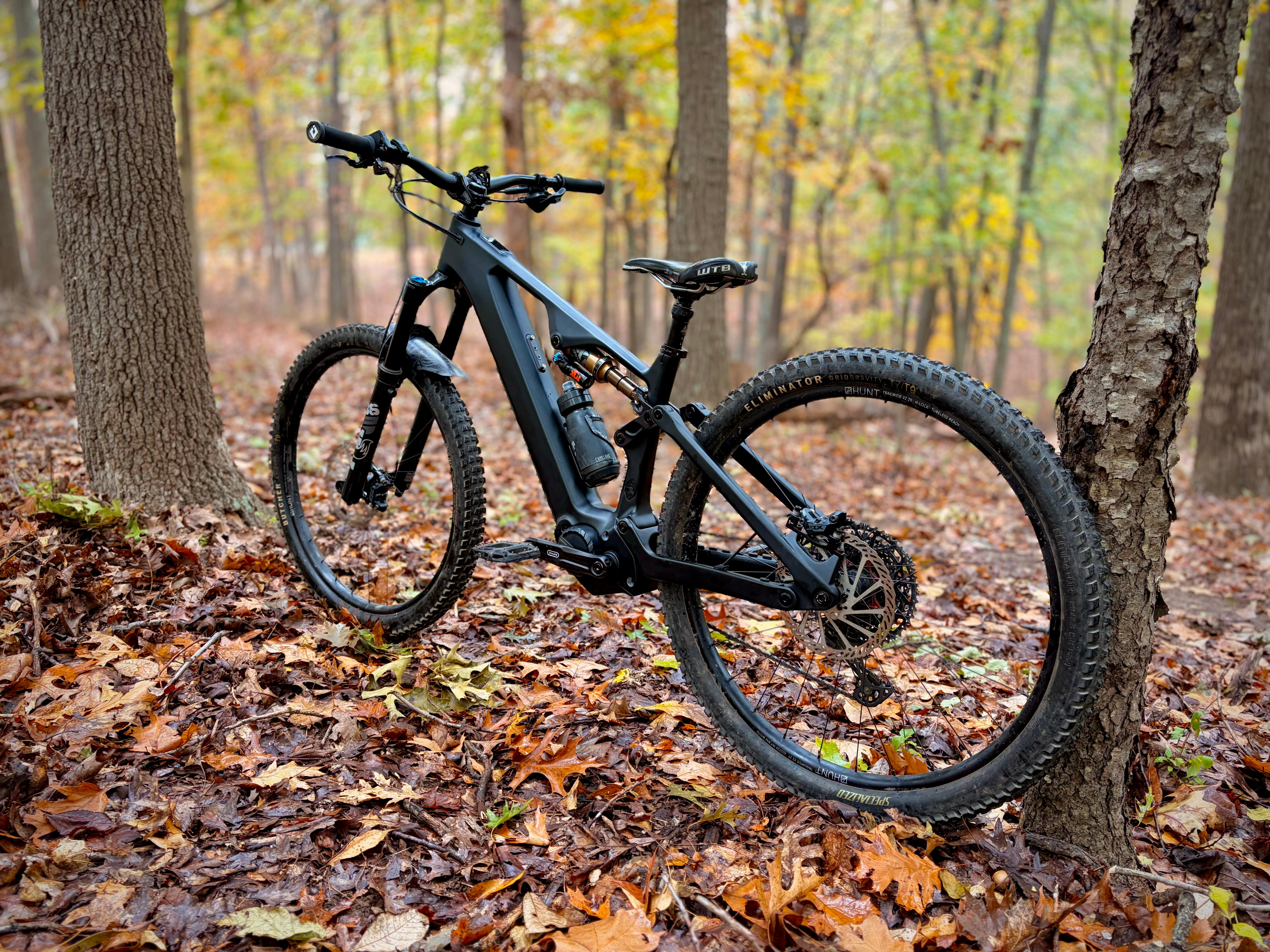

Shakedown ride went well. Suspension feels good. Needed to go back through applying grease, carbon paste, then retorque everything. The carbon creaking was loud. Sure you can definitely hear the m560 but it didn’t bother me or my friends I was riding with. Overall very happy with it. 53% battery left after 2k ft elevation and 14 miles of riding in mostly sport+.View attachment 170538View attachment 170539View attachment 170540
160mm 36 performance, 205x60 float x factory, hunt wheels, slx brakes and shifter, pnw dropper.

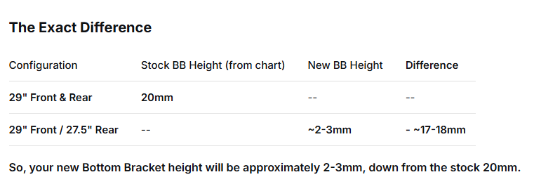

Very cool. There is no information about the geo settings online if you go mullet except that the frame "can take a 27.5". I'm worried about how jacked the geometry will be. Basically we are running the same ratio. 160/150 is the same as 170/160. The 27.5 will lower the BB by 12-14 or so mm. That is a ton. The ST and HT angles will also get messed with so at what point does the 27.5 benefits get scrubbed because you slowed down the handling of the bike by raking it out even more.

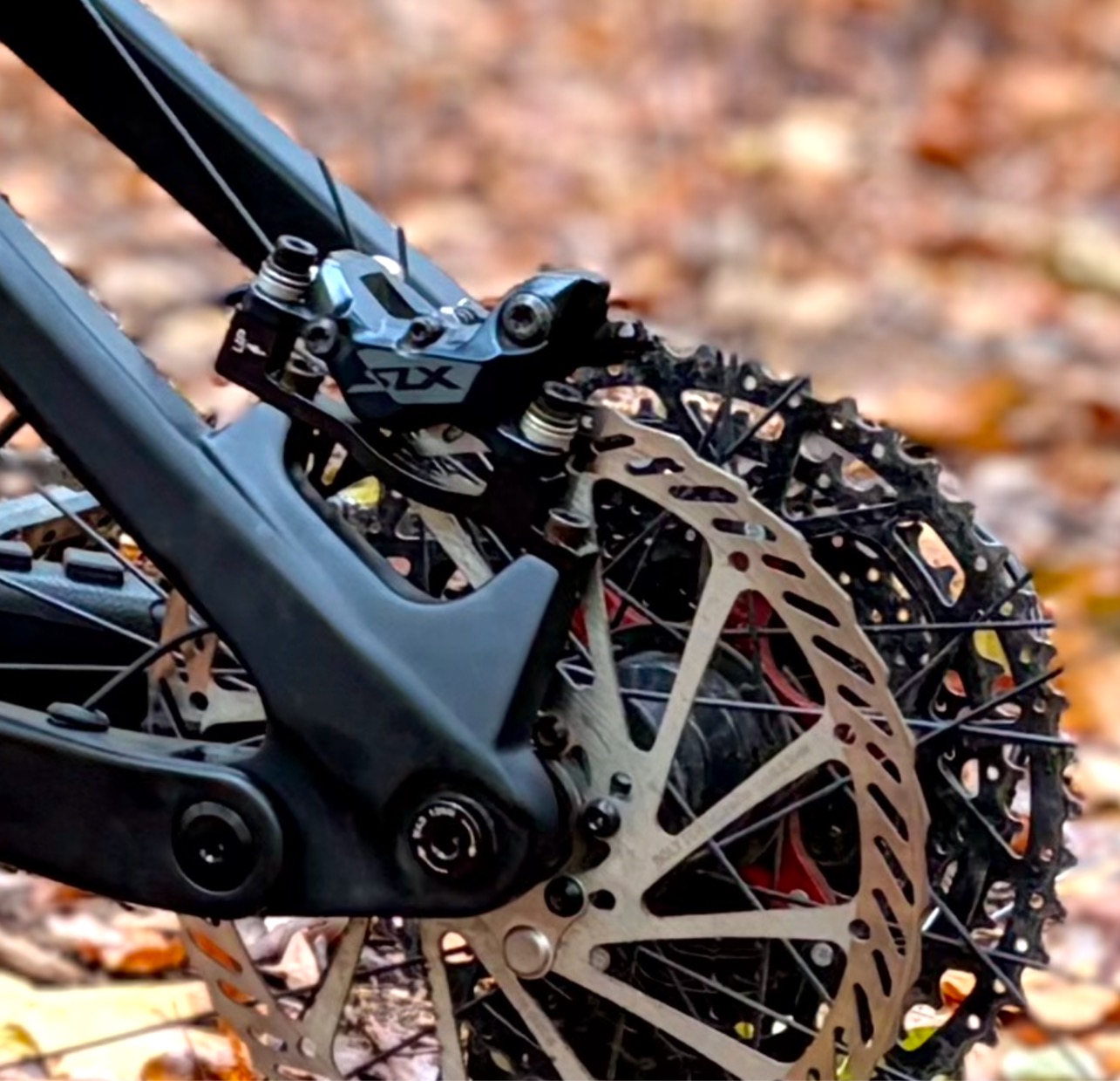

Looks great! You should check that rear brake alignment though, your adapter is not correct size.

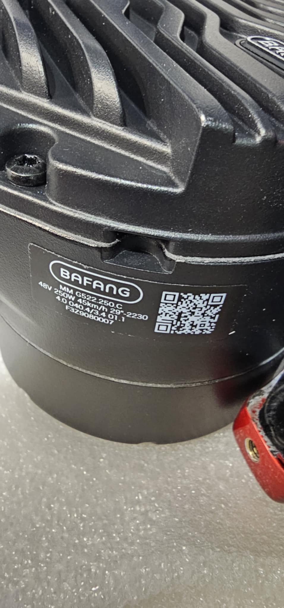

Hi Wonderfull people

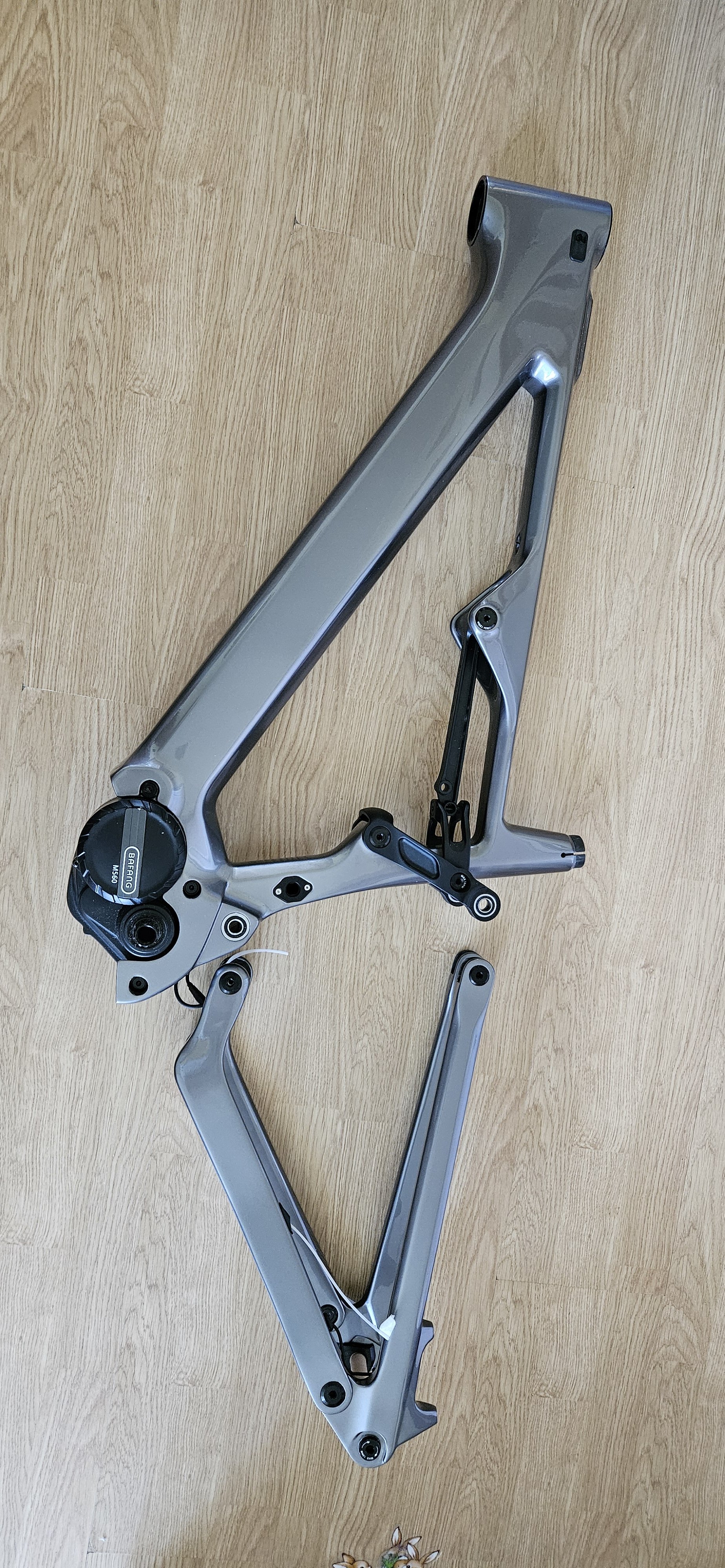

My Bike arrived today but wont be posting pics till it builds but i did take photo of motor if anyone interesed as its version 4.0
Yeah I know I didn’t have long enough m6 bolts so I put this together where only half the pad was touching. The correct 180-203 adapter is installed now.

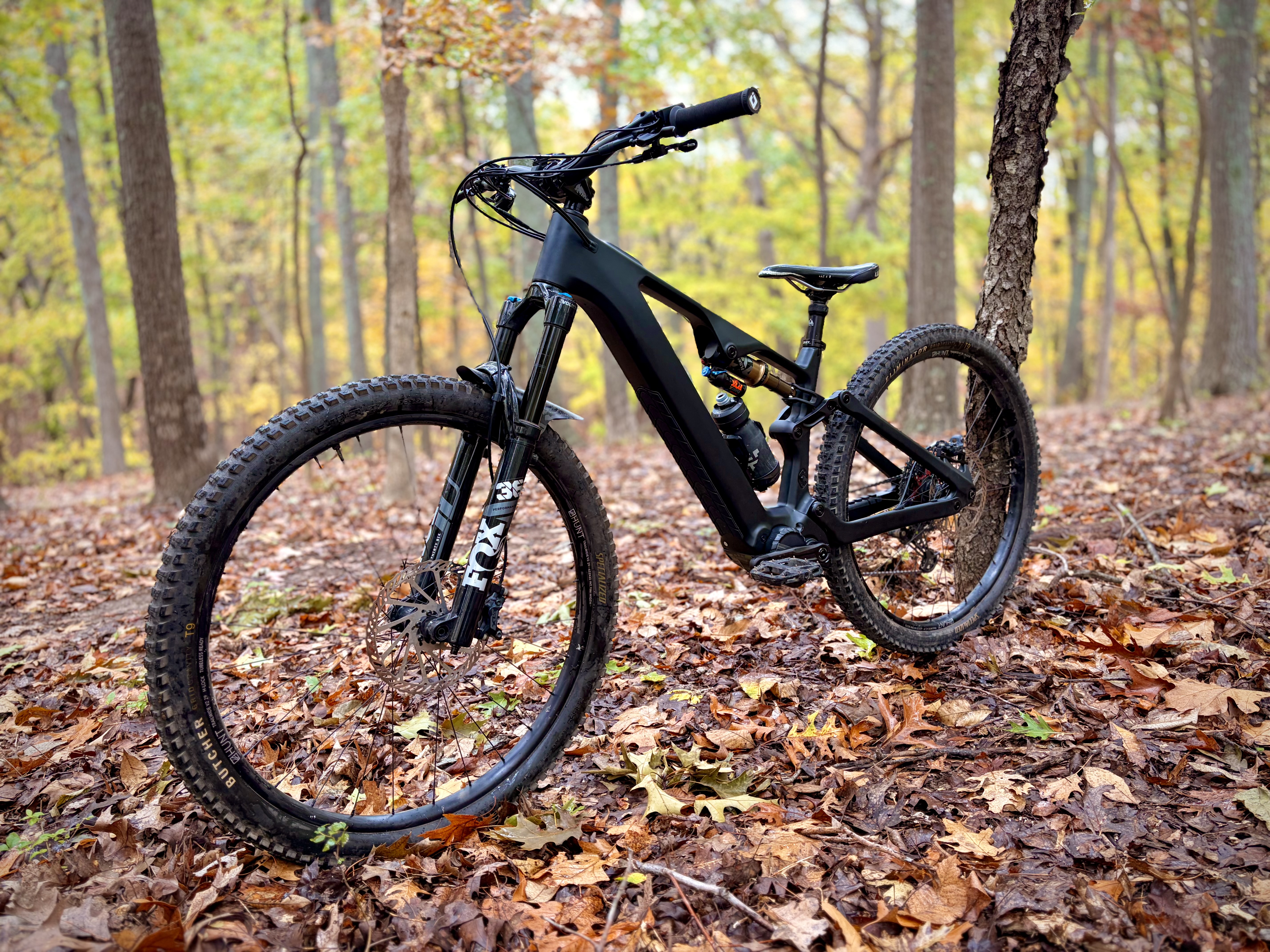

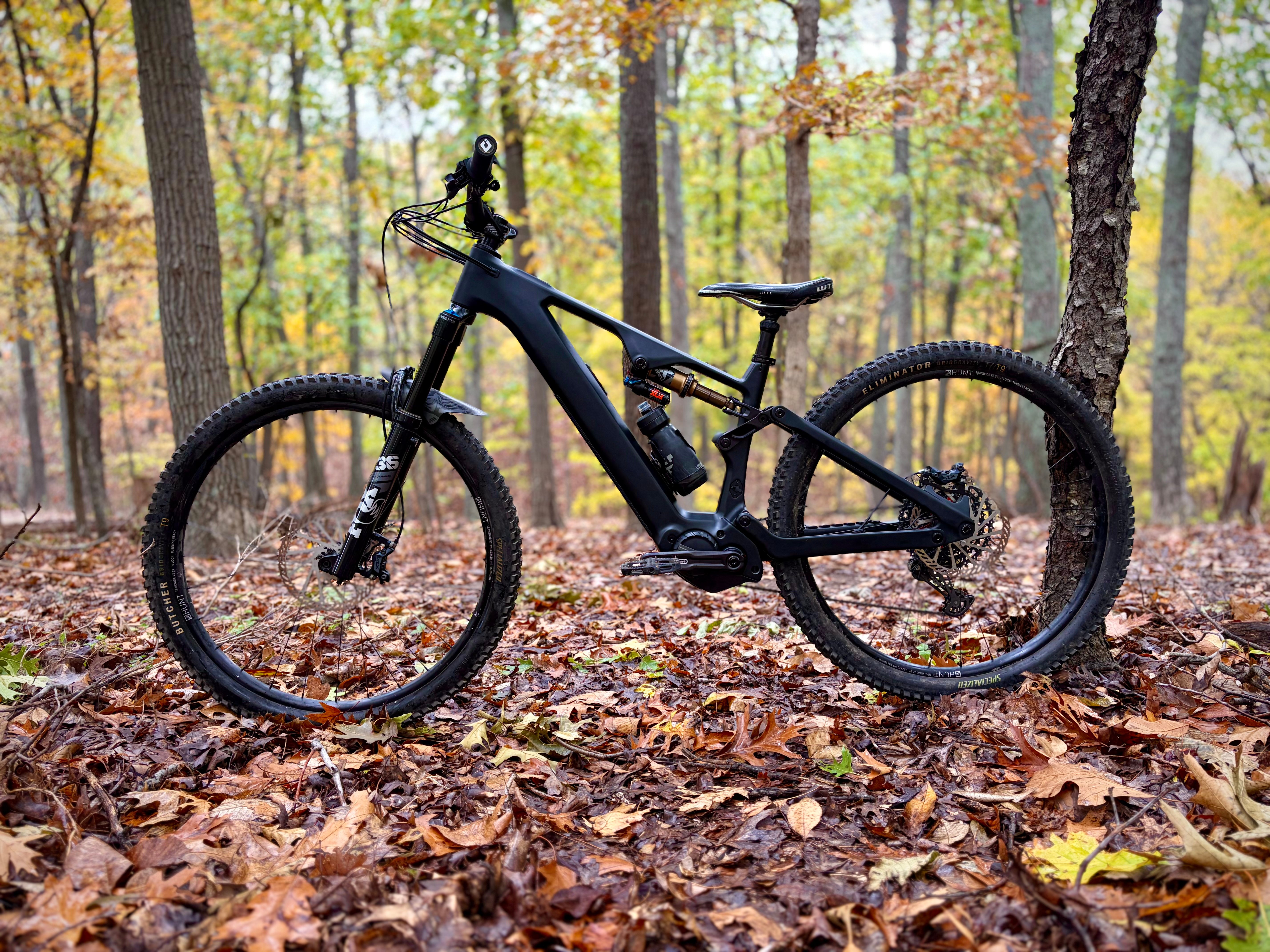

Looks amazing. I just ordered mine and plan to put on a 170mm zeb fork I have from another bike. Would you be able to measure the head angle with your 160mm? I'm seeing 64.5 degrees in the chart but it looks slacker based on measuring from the photos I can find
I am running a 2mm offset bushing on the shock to lower and slacken it just a bit. I used a phone app and measured the HTA at 64 degrees
I was also wondering about this because I thinking of doing something similar and mulleting and there is no kinematic information. I think you need to jack the eye to eye up to about 6 mm to get a mullet back to stock geo, but that's not possible with a trunnion unless you can machine a custom yoke.
You could maybe fit in a 210x55 shock with a trunnion adapter, but I calced the wheel travel to be about ~147 mm at most. However, I would think increasing the eye to eye of the bottom of the 205 shock with a 2mm offset bushing, and the static geo wouldn't be affected as much. Roughly, (-6mm reach , +5 mm stack, -8mm bb height, -0.6 deg HT/ST Angle). If you can make something like what GuitsBoy in the "new cef55 frame" thread did with a custom 3mm offset bushing, even better. Roughly, (-5mm reach , +3 mm stack, -6mm bb height, -0.45 deg HT/ST Angle).

If you going off my photos with the fall leaves, I want to reiterate that I am using a 160 fork and a 2mm offset bushing in the shorter eye to eye direction. I’d be careful about extending the eye to eye which could cause the yoke to contact the seat tube.
If you going off my photos with the fall leaves, I want it reiterated that I am using a 160 fork and a 2mm offset bushing in the shorter eye to eye direction. I’d be careful about extending the eye to eye which could cause the yoke to contact the seat tube.
True doesn't seem to be a whole lot of space, would have to remove material from the yoke. Seems like best case to run a mullet is just to take the geo hit, which doesn't seem to be that bad.
Chat GPT This on 170mm Fork 205 x 65mm Shock (also said dont recommend using bushing of 2mm wouldnt be worth damaging shock, So i guess ill ride it see how bad it is (this isnt taking into account the sag you set i guess too)
Does anyone know what rev. 4.0 is for the M510 engine? Rev. 3.0 hasn't gotten old yet... I want to order a CEF69 with the M510, and if the changes are significant, I'll insist on the latest version.
