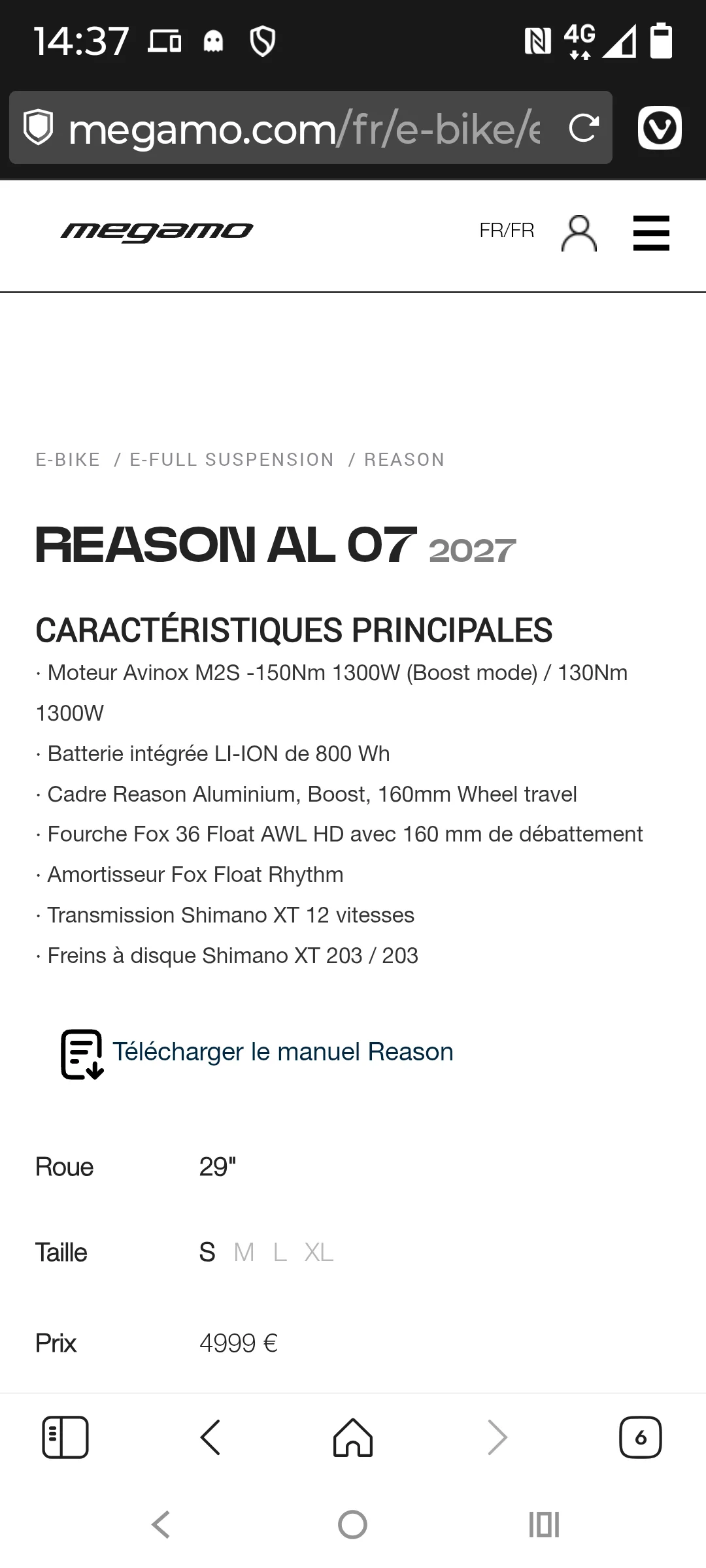

I think the lower end megamo with the M2S and 800 will be the cheapest if you want the skinny down tube. Not sure if it's listed yet, but you're looking at about 1k more.
Yeah the PR may not be Haibike of yore level, but it sure is thick and ugly compared to last year PL model, let alone the beautifully slim PX model.
The megamo.

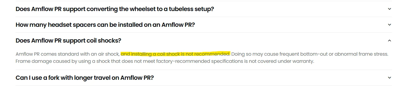

Not sure if it's already been covered on here, but I see on the FAQ on their site that they don't recommend using a coil rear shock on the new bikes.

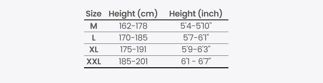

Would an XL size fit best for 1,83m/6ft? I read with previous models this bikes run a bit short in size.
Nothing beats throwing a leg over one. I am 176cm and my LBS had just got a Med and Large in stock and on the floor, went down and got on them both. Was hoping the Med fitted but the geo was pointing to a Large... Med was spot on and I pushed it out of the shop 15mins later.
Depends on body make up too, if you have shorter torso or longer torso for body proportion.
Dont go on the Amflow sizing chart, its a massive variable. 176cm has me in M, L & XL.
It will be smaller, akin to Bosch REX etc etc. stay tuned.
Thanks. No more questions about weight or wh but is there more to the runout that it can be used as a „power bank“ for the battery as if you just clip it in when you’re about to have 10% for example or if it has to be plugged in all the time? I must say I don’t remember how the Bosch one works..
I'm 183cm and will most definitely go size L if I get one. I've had longer and shorter bikes over the years, 475mm reach with decent stack is spot on.
Do you think body weight matters as well for deciding between bike sizes? I'm at 85kg and i'm at the high end of L recommendation.
Also how much difference is there in bike's weight between sizes L and XL? 1kg or so?

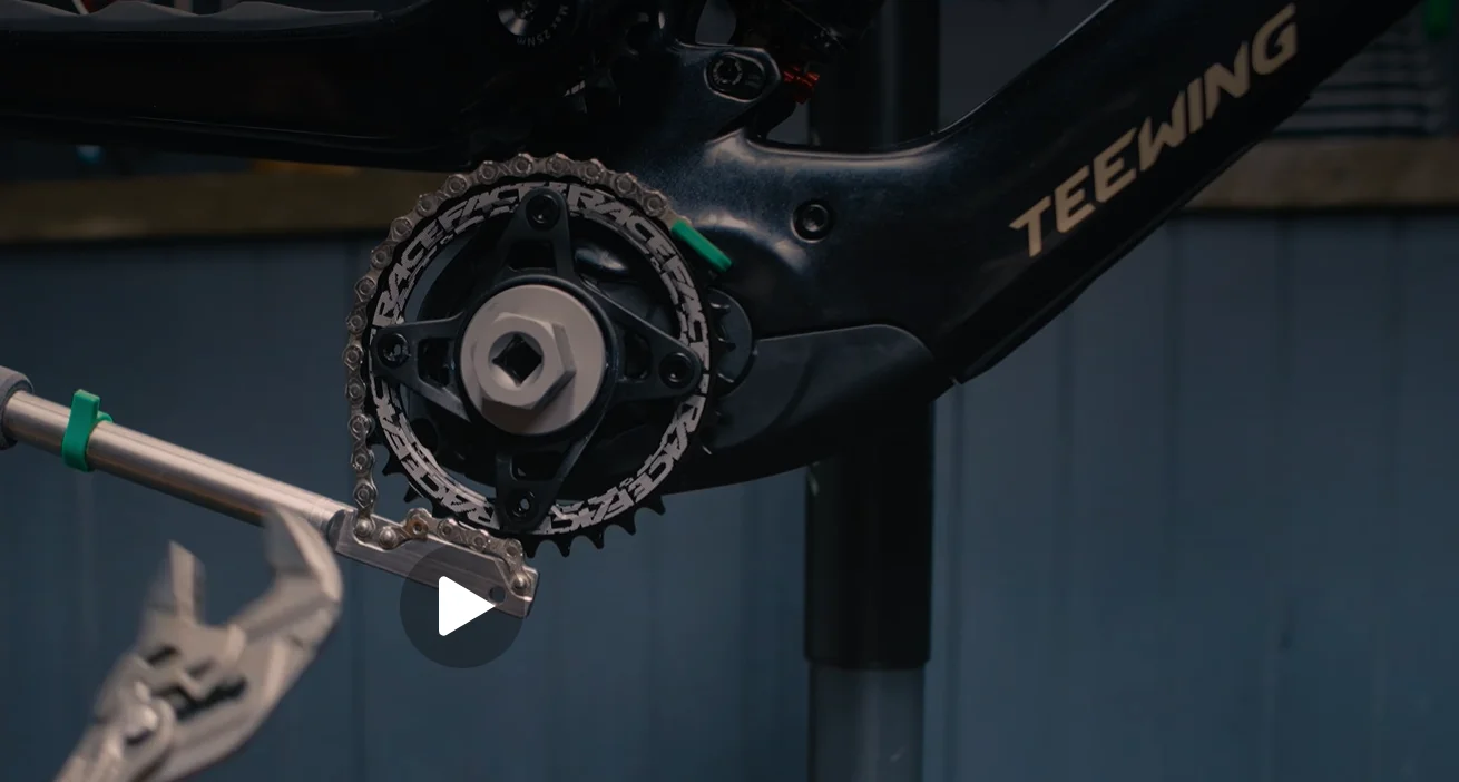

Can anybody confirm if an M1 chainring locking tool also fits the M2/S please?
I've asked Amflow support for the tool and waiting for them to check and quote, but wondering if I can just buy one elsewhere, quicker.
I've never considered body weight when sizing a bike, I'm around that weight too if it helps.
The dream build video does appear to show the same lockring and tool as what I have for my Amflow M1.
