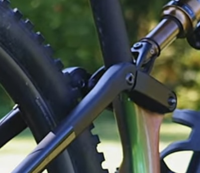

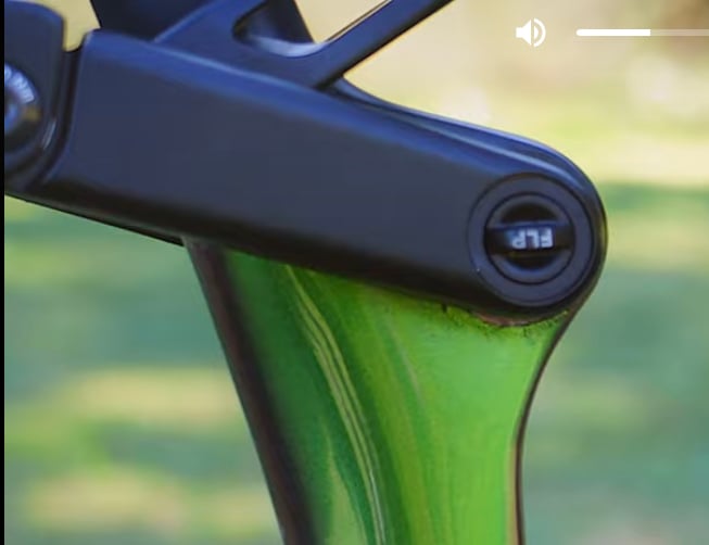

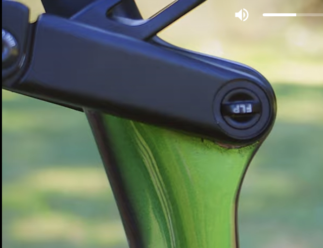

Check out rear triangle. If photos are accurate there is no space between seatstay's end and link so you won't be abble to mullet it. As an owner of 2021 rise I hope for a retrofit of new 360 battery :)

Checked in Rob's videos. I was wrong. Should be ok :)

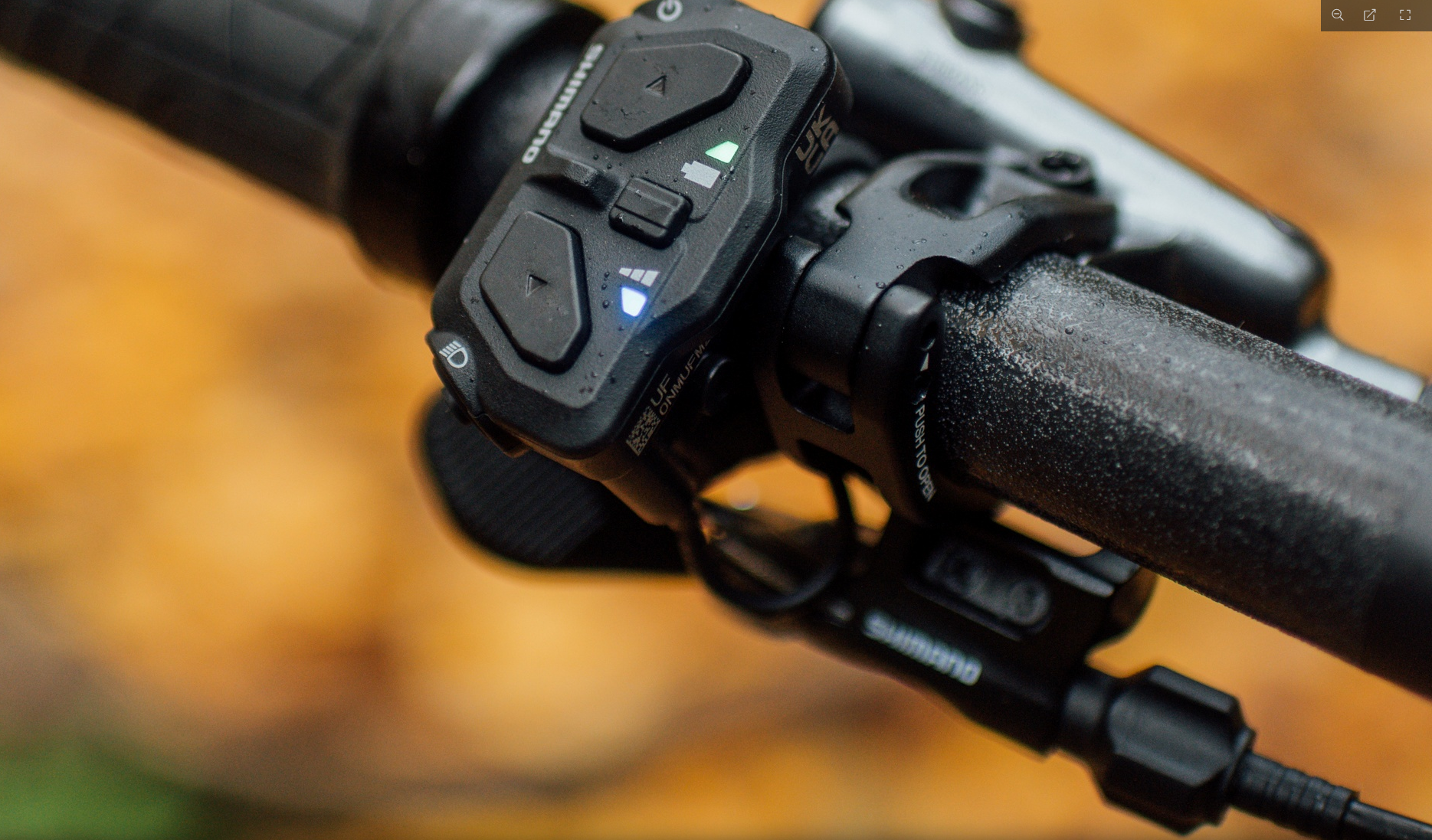

The new motor includes the EN600 wireless control, which has allowed the Orbea engineering team to remove the old LED reader, which was situated on the brake hose. This remote contains the power button, allowing Orbea to remove it from the frame and thereby improve seat post insertion. As usual, the Rise platform continues to enjoy the RS Garmin IQ app, developed by Orbea. This app allows riders to display typical e-bike data, such as battery or assistance mode, on a Garmin device without the need for a specific display.
Think I got my answer.... the new motor has the en600 wiresless control...

  • Carbon frame has new linkage, 2 connections instead of 3, stiffer and lighter with the option to fit some orbea multi tool gimmick.

  • Carbon versions no longer come with the led dongle thing on the cable, they now have a shimano EN600-L
  • Aluminium versions no longer comes with a SC-E7000 display by default ( EN600 screen can be added, but it's an extra), and the E7000 control unit has been replaced with the EN600-L.

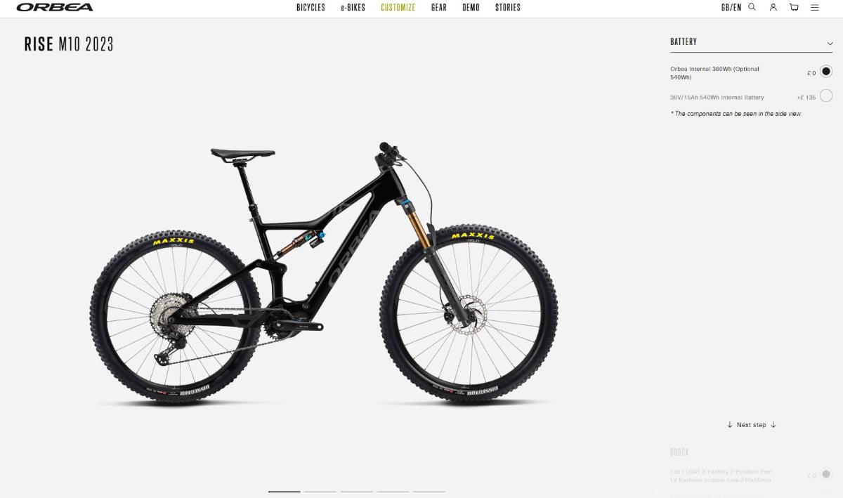

I've been to Orbea's website and it appears that it is only the M-LTD that has the 540 as an option. The M-team and M20 (no M10 now) only have the 360 as an option. With the bigger battery it's knocking on $12k, so maybe it's not so bad after all. Ha.
edit: I have been corrected on this, I was looking at 2022.
At first I thought that was the case too. But scroll down the list of Rise models and you will see the 2023 models. The first models in the list are 2022 with the 2023 (and the optional battery) following. They are all there.
Rise M10 still exists into 2023 line up and 504whr battery is an option...
If you're looking at the US site, I don't think they've updated the pages for the M20 and M-Team yet, they are still showing the 2022 models (they both still have power buttons on the seat tubes).
The US site shows all the 2022 and 2023 models along with the larger battery option. As of today anyway, 12/01.

The SW-EN600 is supposed to be wireless? I don't trust that info, looks like there is at least option for cable on the 3d render from shimano.
It would be nice to know how many of the new stuff can be fitted on the older carbon versions. Especially a stiffer rear and would be nice, but also if the new 504wh battery can be fitted to 2021 frame. I doubt it, but it would be super nice.
The cable connects to the screen if it is present. Although yeah a quick search and I didn't find information on how it is powered, if it's by some rechargeable battery, or by actual batteries like the Bosch older stuff.
I'm thinking the wireless bit talked about is the bluetooth and ant connectivity features maybe, and not wireless connect to the bike (?)
Everything I saw indicates that it is wirelessly connected to the bike, haven't seen a cable coming out of it, and all the talk about it replacing the power button seems to indicate that as well, could be wrong but for example here I can't see a cable coming out of it.
Maybe it is really WL, but I think it's odd considering it's supposed to power on the bike. That means the motor has to be constantly connected and listening to for an on command. The Shimano own website doesn't have proper documentation for the unit (although I could have missed it since it's always hard to find anything on that mess of a website). I was looking for information about how to pair it with the motor, since there must be a process if it actually is wireless.

Edit: I think the reason we don't see the wire is because it goes inside the bar.

As a mechanical engineer I can not see any constructive reasons, why the new linkage should make a reasonable change in stiffness. In my opinion, for this it would have been necessary to have a bridge between the both upper chain stays. It will be interesting to see the blue paper which bearing size they have used. Cheers
