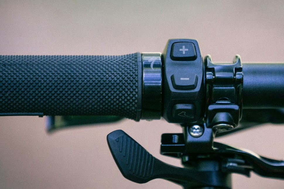

However, with Purion, it means you cannot customise any modes, right? which is a big bummer - and that's the 'brain' - if you smash it, you'll push your bike home...
(it's not new bosch system which adds some customisation options)

True but it is just a mode switch...not a controller and it is the controller that is the "brain" of a CAN. Any new Bosch motored bike will now be Bosch Smart Sytem so the Purion is no more.....having said that...true to form...Bosch have labelled the new LED Remote with integral Kiox like display, the Purion 200!! (I say true to form because Bosch also used the branding "Kiox" for 2 completely different display units adding only a"300" suffix to the Smart Sytem version to differentiate them. Kiox is a controller/display....Kiox 300 is simple display unit working as a slave screen for the LED Remote controller)

I rode Trek Rail for a month, older Bosch gen4 without customisations - that was one of the main reasons I got rid of it.
All modes are just stupid, they give you full power or Eco which gives you almost no power (not designed for MTB)
