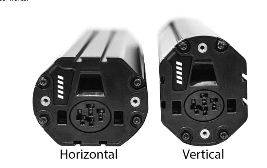

That's a really good deal for the bike! Do you know if it's a horizontal or vertical battery?
Ideally I need to buy one with a warranty though, knowing how fast I seem to go through them...
Not sure if it’s horizontal or vertical as I’ve only seen the one type, but it clips into the bike by pushing the width of the battery into the frame, if that helps. I was being tongue in cheek when I suggested you buy it for a spare motor, no idea how much 2nd hand Bosch motors go for!
I thought you were haha. The only difference is the end plates, I have horizontal in mine:
You could just sell me the battery and motor. You could still have a great bike with storage for baguettes and wine :D
Yeah it’s the horizontal battery
