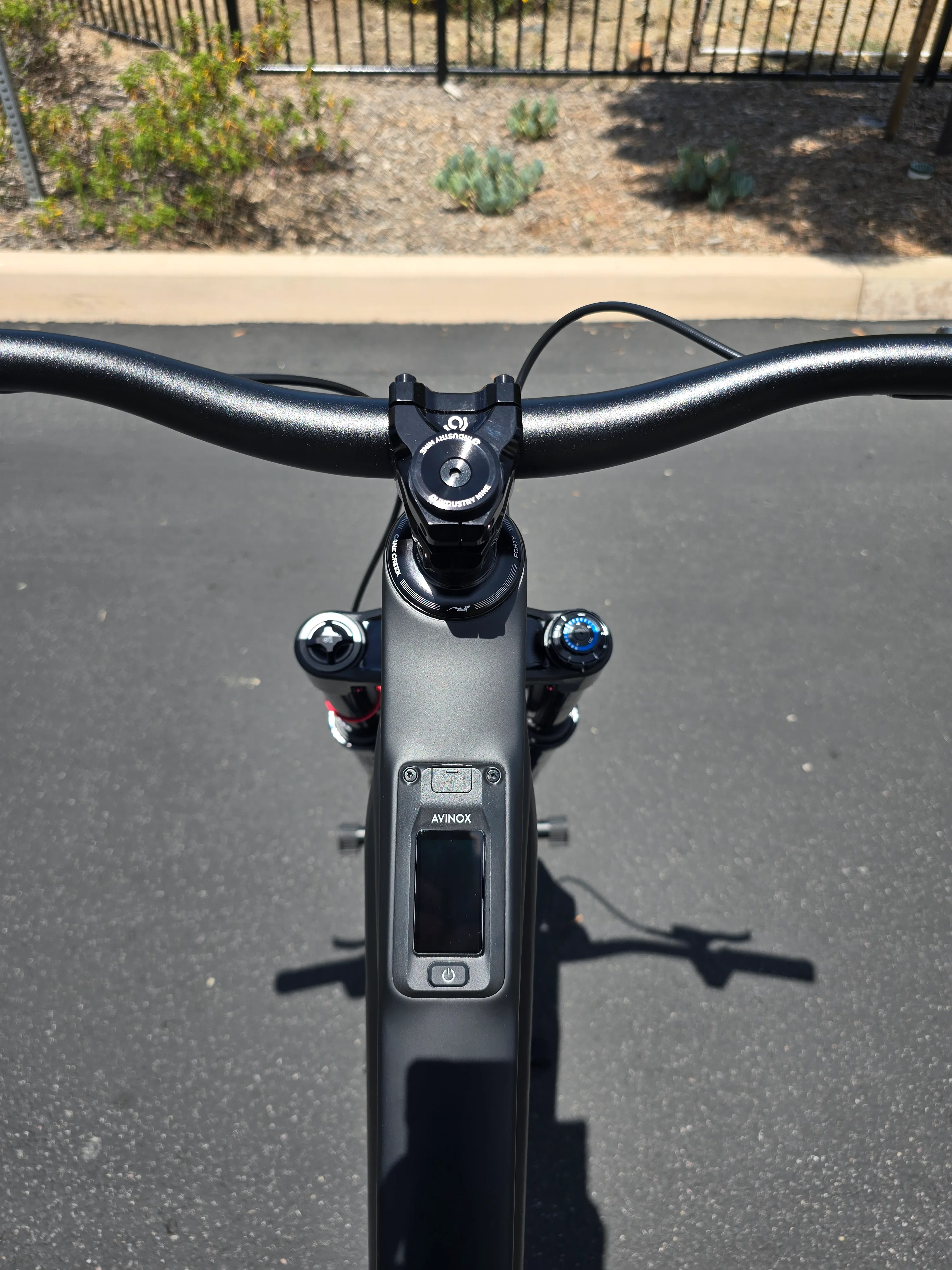

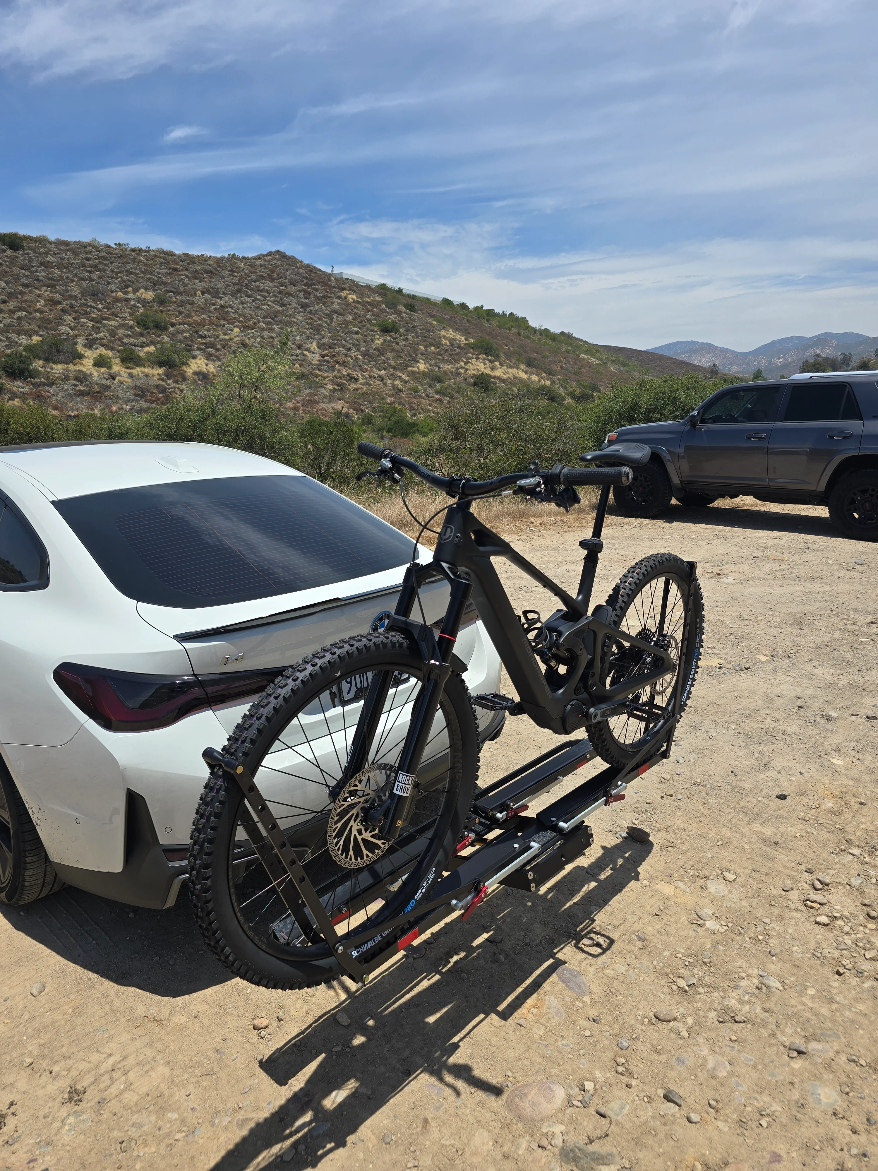

Here's a few things I came across that may be of value:
-If you're going with AXS dropper or need to remove/replace dropper cable, you need to loosen the 2 water bottle bolts on the downtube because cable housing is held in place by a clamp.
Will also need to loosen the little Allen bolt where the cable enters the front of the frame.
Amazon sells plugs you can use for the opening on the frame ports to prevent water/debree from getting in.
-If you want to run traditional round stem spacers/aftermarket stem you'll be better off changing out the top headset as well.
Theoretically you could leave the triangular topcap of the headset but it won't look good. I went with a Canecreek 40 headset and upgraded the bearing to the 110 model.
You can mix and match cups, topcaps and bearings from all 3 Canecreek models (40/70/110). You will need the transducer that comes with the 40 series since the Zendit takes ZS56 top headset cup/cover.

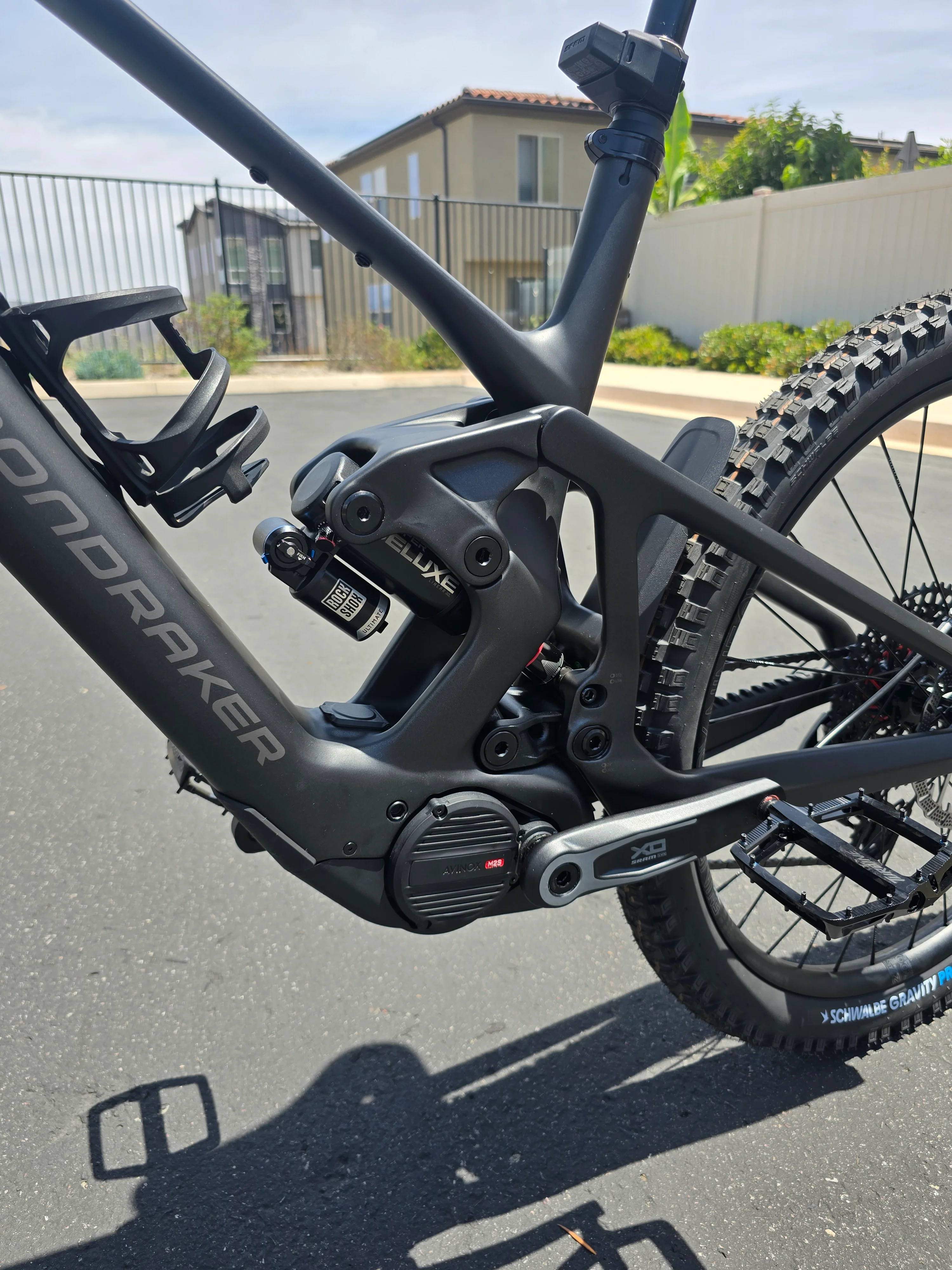

-If you change out the shock or need to remove, be VERY careful when you remove it. Know this is captain obvious stuff, but frame compresses very easy and you’ll damage the frame if you don't use work stand to hold frame, keep from falling. Wanna use rags too. Will make it much easy to reinstall new shock as well.
I upgraded to a RockShox Super Deluxe Ultimate and bought new mounting hardware. Has to lightly sand OEM SRAM mounting hardware that goes into eyelet because it was slightly too wide. You will not be able to use Fox mounting hardware if you with SRAM shock.
-If you decide to switch out the brakes, you can keep stock Maven cable and would just have to flush line depending on the brake fluid/hose diameter of the model you are installing.
I went with Hope EVO GR4 's and decided to run a new brake line. Used the old cable as a guide and attached to a barb Sram sells to connect 2 brake cables together.
You'll need to remove shock, lower splash guard in rear of bike and there's a locking guide in the rear triangle that you'll need to loosen so the brake cable can be installed.
Have seen some exchanges regarding frame size and will share my thoughts with the caveat that I am not telling you what frame size to buy, only how the frame I bought fits me.
I am 6ft even, 32" inseam and think the M/L size is perfect for my intentions. I want a bike that's more on the nimble side and set up for all-mountain. Don't feel cramped at all, but wouldn't want the effective reach to be any smaller.
Went with the same size lenght stem as Mondraker recommends (Industry Nine 30mm stem). My saddle is almost dead center regarding the fore/aft position and have leeway to move it forward or backward if need be.
I could definitely see why someone my height would go with a large size frame depending on their intention of their set up. I have an RH3 size Crestline RS181.2 coming soon and it's gonna be my dh beast, so I opted for the M/L Zendit and believe I made the right call.

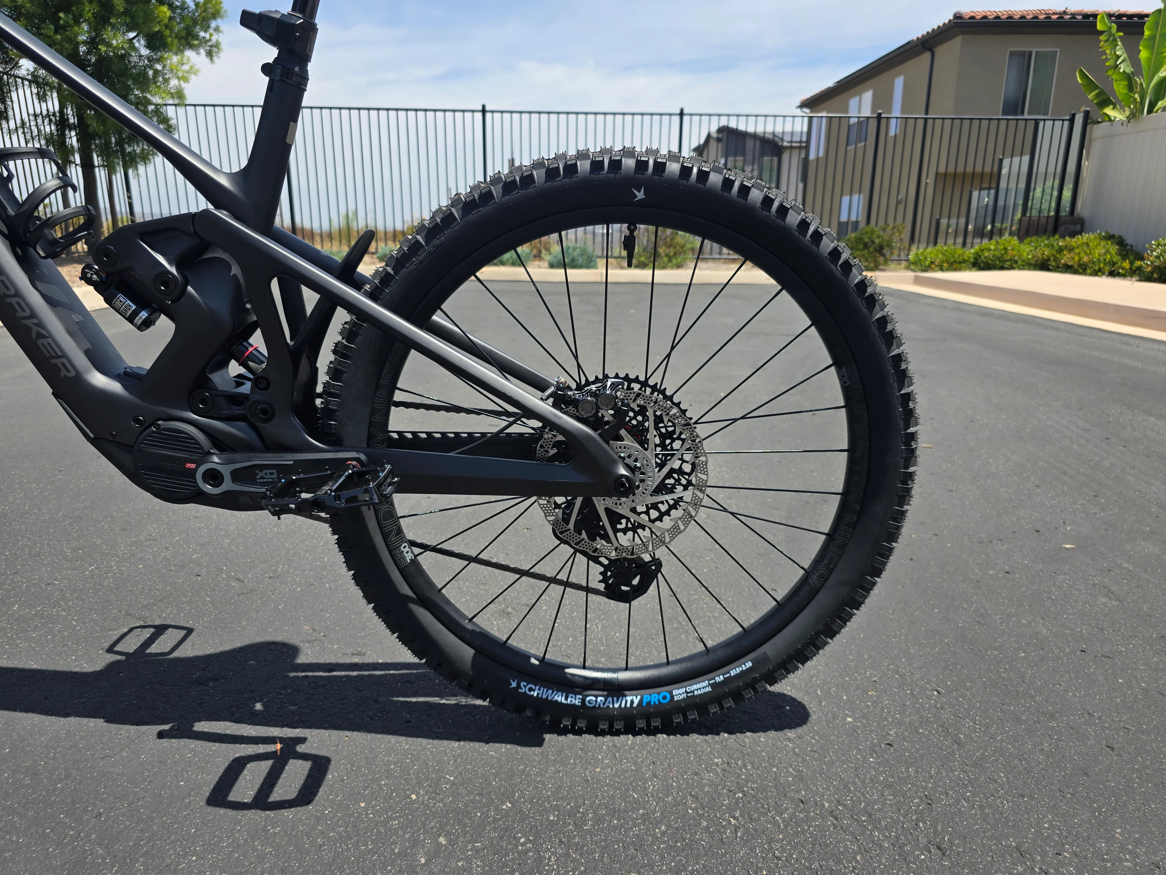

I also swapped out the ethirteen lower model Crankset for SRAM XO's. The Q factor is a couple mm wider than e13's but not really noticeable. Be careful not to over torque them, they don't have built in stopper like e13's.
To fit a SRAM X0 crankset on your DJI Avinox M2S motor, you need the SRAM X0 Eagle E-MTB Crank Assembly (model FC-X0-PA-D1). The motor uses an ISIS spline interface (which is also shared with many Bosch/Brose e-bikes), making standard SRAM DUB spindle cranks incompatible.Torque Setting Crank Arm Bolt Torque: 48 Nm to 54 Nm. Be sure to use sufficient amount of grease.

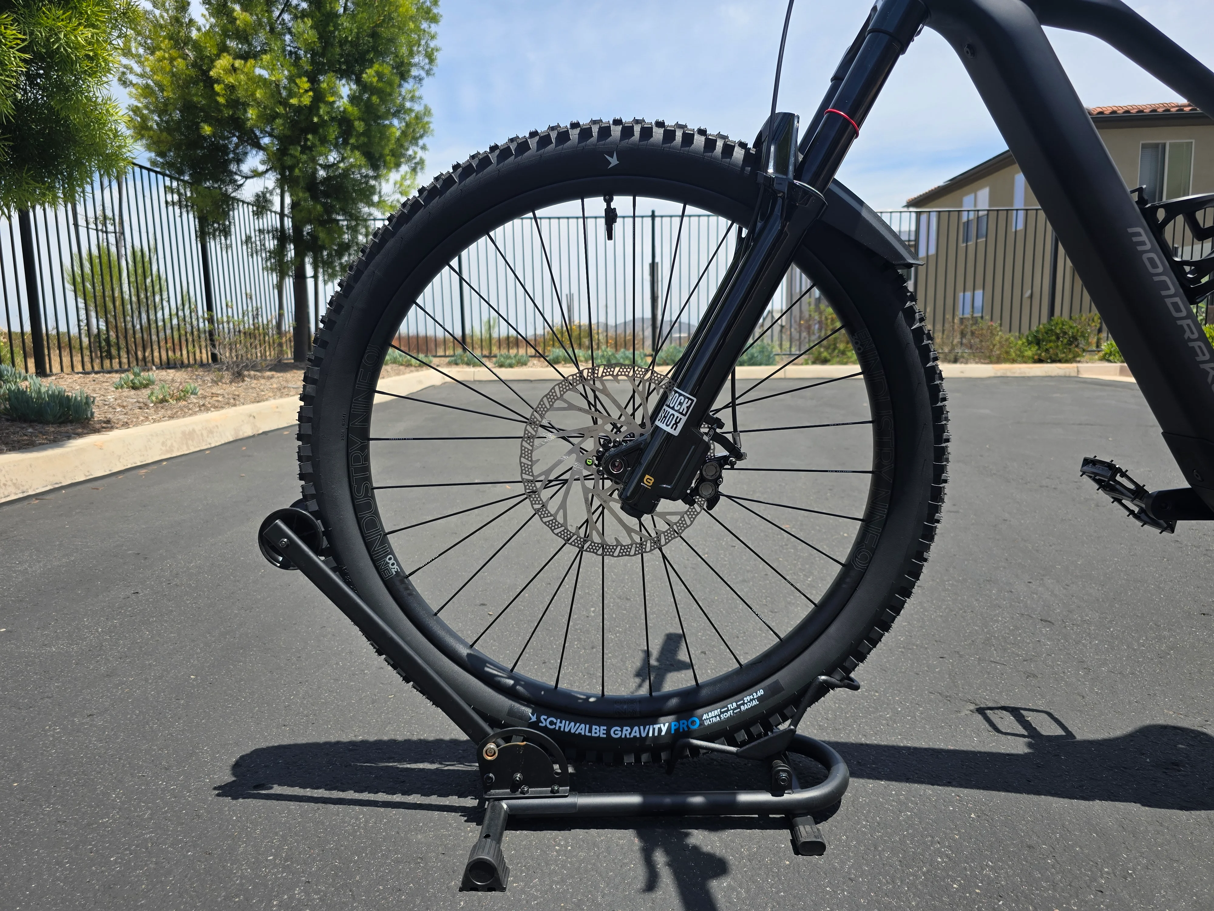

I went with Industry Nine Hydra 2 hubs/Enduro 300 rims and mounted 2.5 Schwalbe Eddy Current on rear wheel and have plenty of frame clearance.
Brake Post Mount on frame is set up for 200mm rotors, so you’ll only need an adapter if you go with bigger rotors.
That's all I can think of now. If anyone has any specific questions, feel free to reach out.

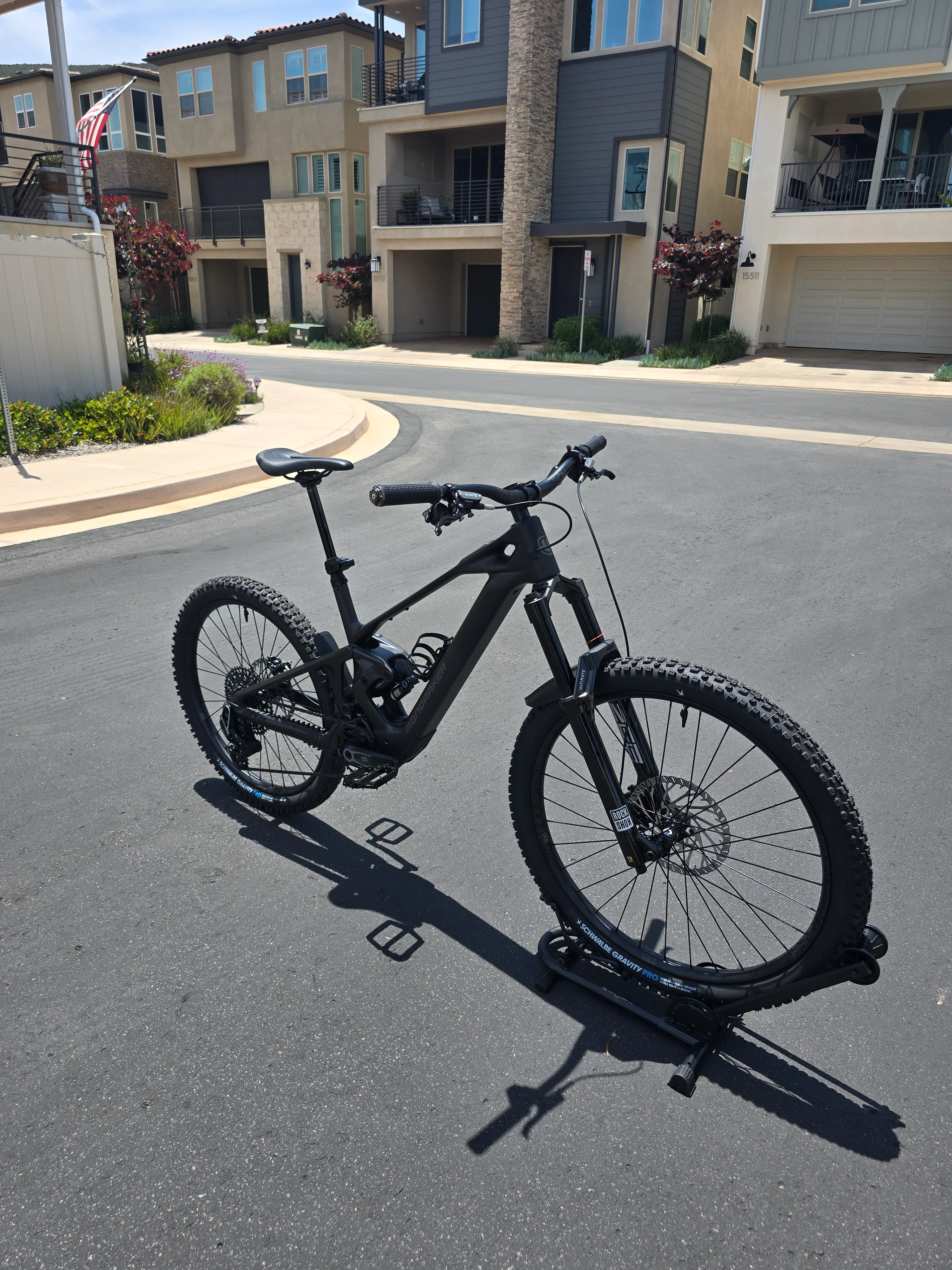

So today's ride was only 13 miles and primary goal was to get suspension dialed in for tomorrow's 25 mile ride at Daley Ranch that I do on a regular basis.
Its a great ride with lots of technical climbing, some fireroads, flowy singletrack and mixed with some chunk and techy downhill.
Had a lot to take into consideration today because after 5+ years of riding, I switched from a coil shock to an air, changed from a Shirgura brakes set up (Shimano Saint Levers with Magura MT7 Calipers/MDR-P Rotors) to the newish Hope EVO GR4 brakes with Galfer rotors and for S&G I installed radial tires for the first time!
To address the elephant in the room, the Avinox M2S motor is a beast! Not just the power (which is insane) but how intuitive it feels and performs.
Think about the sh*t ass grin you had the 1st time you rode an emtb and that's what I felt like on today's inaugural ride.
I've read all the articles, watch the videos just like most of you and it all comes down to personal preferences, but I'm glad I made the plunge and to each their own. For me, it was the right decision.
Made a few adjusts with tire psi, dropper post height and compression settings mainly on the fork during the ride and have have some more minor tweeks I'm making for tomorrow beta test. I dialed down the power settings in Trail and Boost and only used Turbo 2 times. Man, the power is insane and needs to be used with caution till you get used to it.
Oh yeah, this baby is thirsty! She likes to drink more power then my Bosch Gen 5 motor, but also seems pretty efficient in Auto Mode. Being able to ride at 28mph on the fire roads was pretty cool.
In regard to how the Mondraker frame/suspension performed, all the hype is real! It feels really smooth and agile for being a full fat emtb with a decent size wheel base. I was really impressed with the rear suspension, how it performed on technical climbing and of course the downhill.
I wasn't sure how the bike would feel with a 30mm stem. Thought it might be a little twitchy, but that was not the case at all. It felt very stable, yet agile.
Have read a lot of comments about the sizing on this thread and a couple reviews from content providers. I felt right at home on the bike from the get go, just like I did the 1st time I rode my 2025 Wild. The Zendit reminded me in one way that was very similar to my previous Yeti e160, the faster you rode it, the better it performed!
It was hard to decipher all the characteristics of the bike attributed to the frame design because so many of the components I was using were new to me.
Being honest in regard to the con's, not be able to run a 200mm dropper is disappointing. I also think Mondraker went the cheapo route on the stock dropper, wheelset, stem & bars and not including the fast charger on the RR model.
I can honestly attest that the Mondraker’s Zero Suspension System is an awesome design. The rear end stayed very stable while climbing and super smooth on the downhills. Its kind of hard to articulate, but it just felt natural.
Obviously this was only a short ride to see how it rode and to dial in the suspension, but I'm super excited about tomorrow's ride!
Been fortunate to have some pretty fun bikes over the years and the Zendit feels fun to ride already.
Will circle back with some additional feedback after tomorrow and am interested to see how the Zendit does on one of my favorite rides.

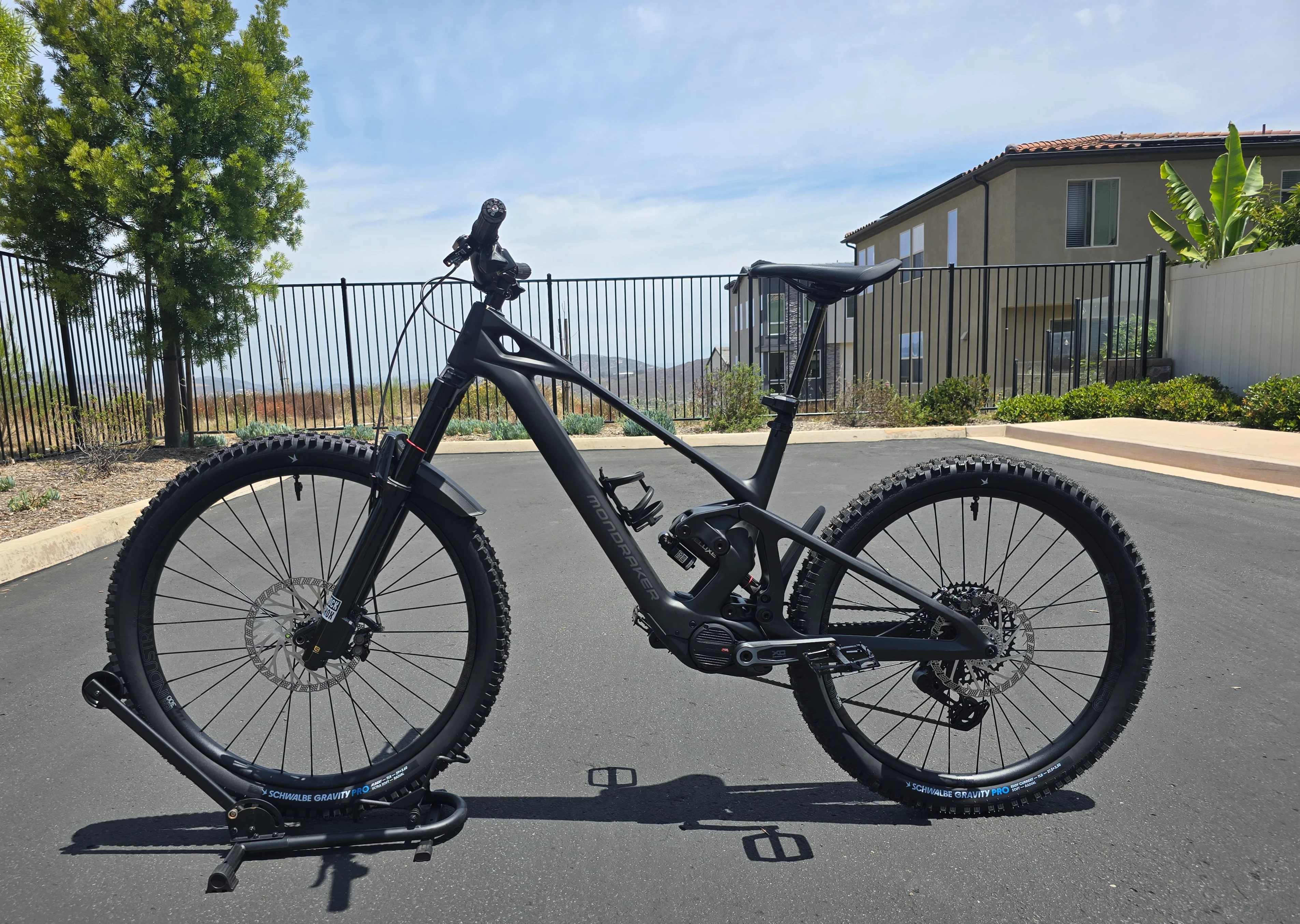

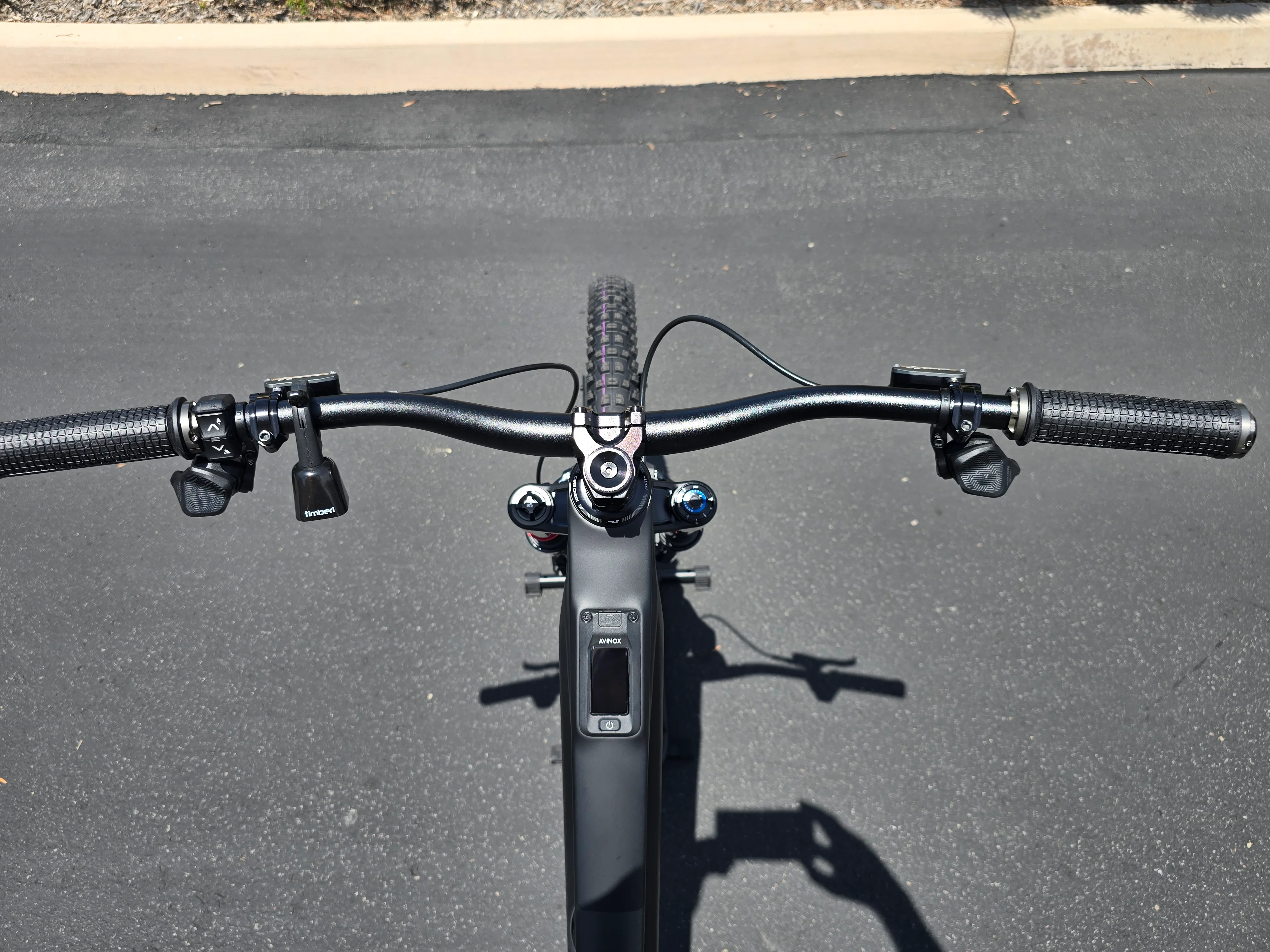

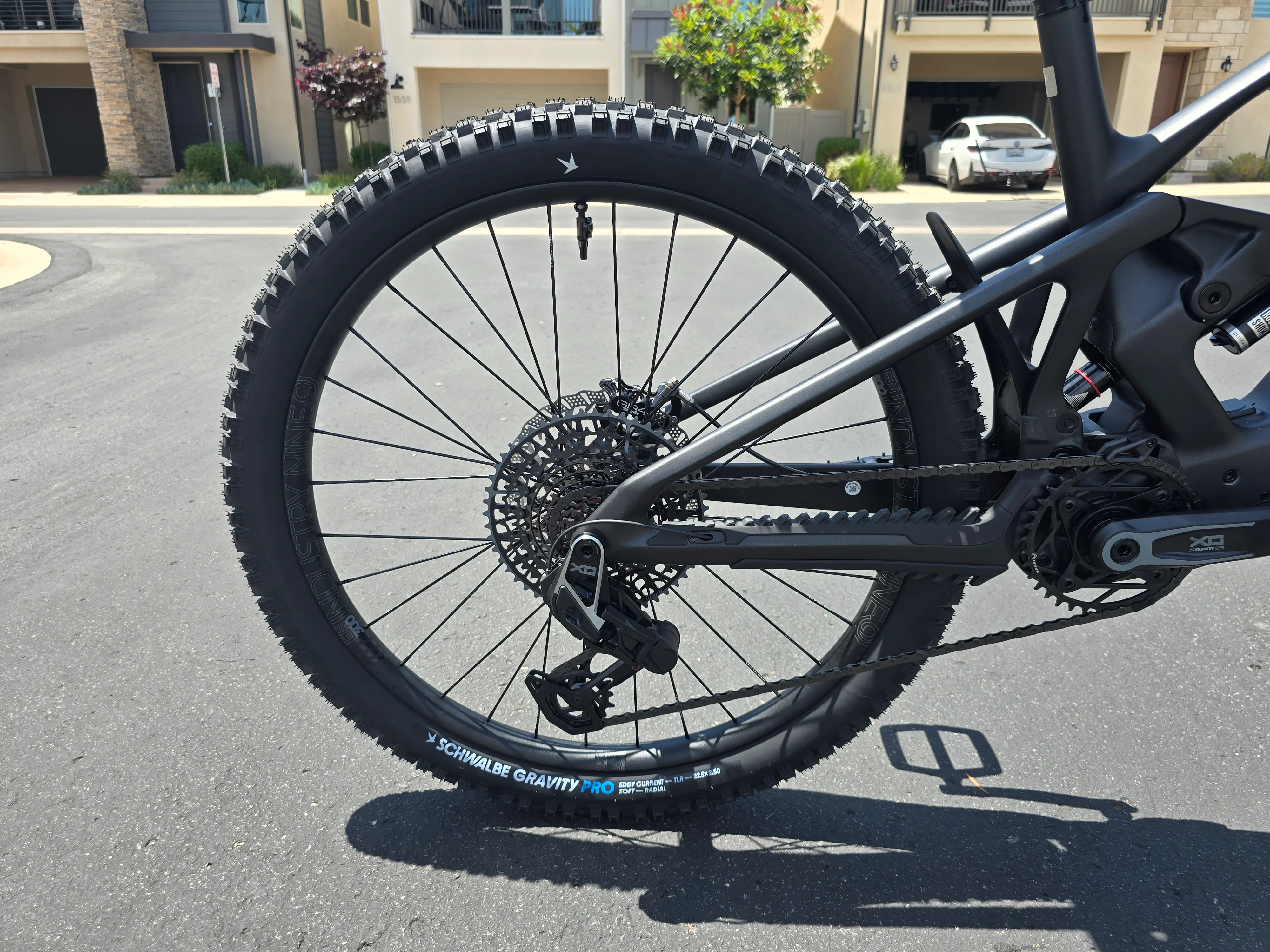

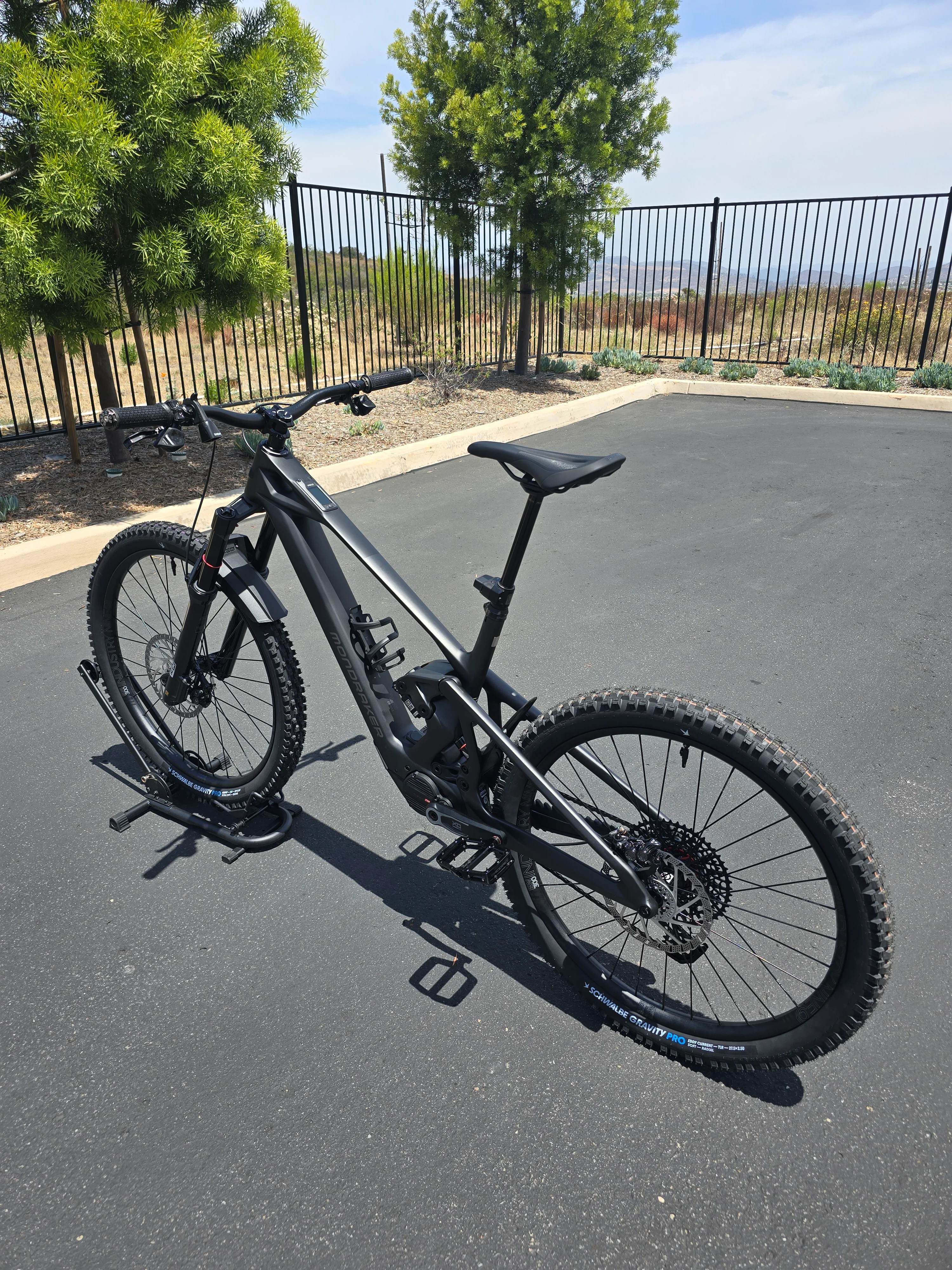

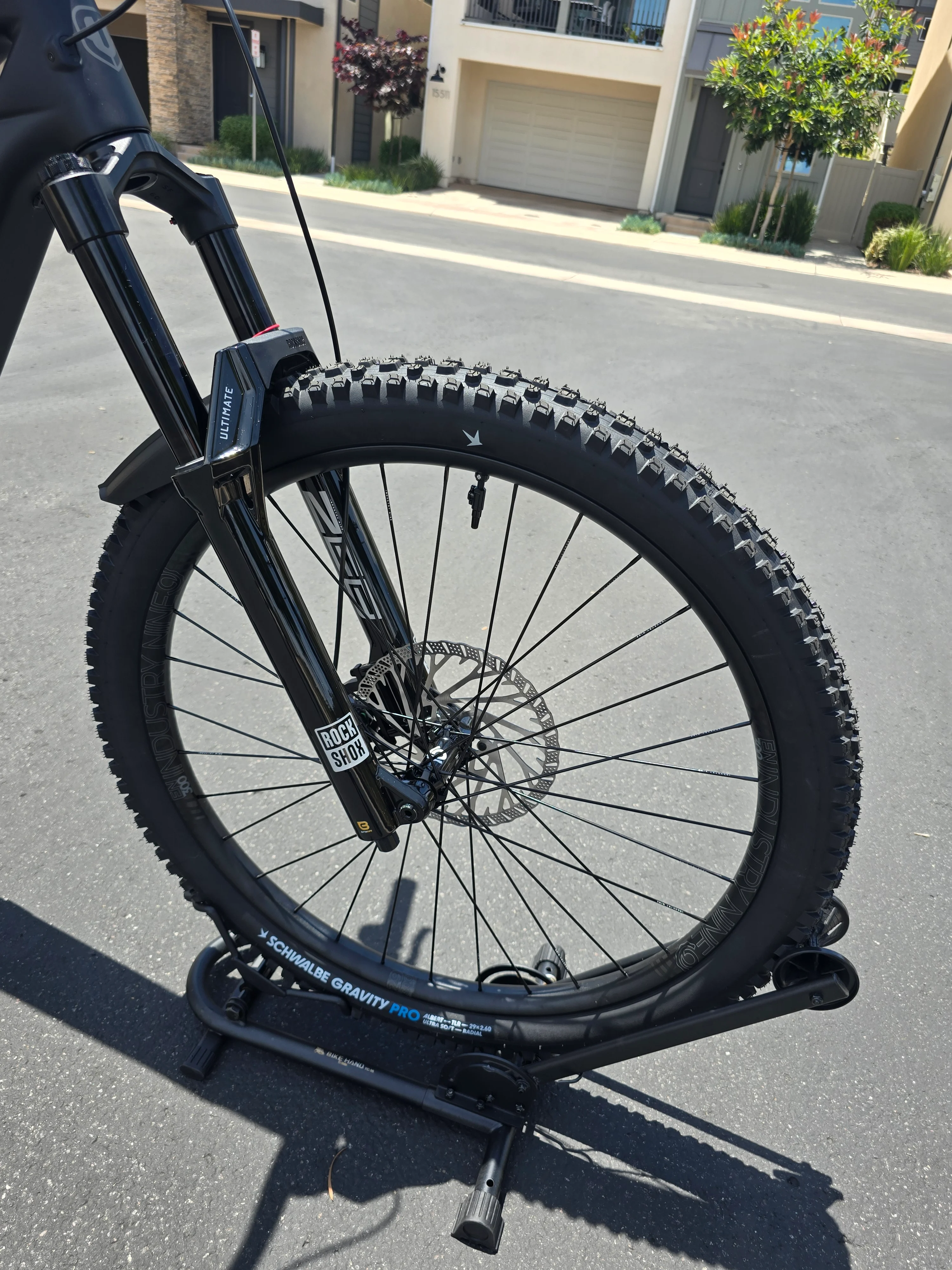

Think I listed my specs before, but I was dm'ed about it so here it is again:
Frame
Mondraker Zendit Size Medium/Large
Drive Unit
Avinox M2S 800Wh
Fork
RockShox Zeb Ultimate 29", 44mm offset, 170mm
Shock
RockShox Super Deluxe Ultimate 205x65
Rear Derailleur
Sram X0 Eagle AXS T-Type 12 Speed
Cassette
Sram XS 1275, 10-52T, T-Type, 12s 10-52t
Crankset
SRAM X0 Eagle T-Type 155mm ISIS Direct Mount
Chain
Sram XO Eagle T-Type, 12s Flattop, w/Powerlock
Controller
SRAM Pod Ultimate AXS Rocker Paddle
Brakeset
Hope EVO GR4
Front-Green Pads
Rear-Purple Pads
Rotors
Galfer Shark 223/203mm
Stem
Industry Nine 318 30mm Stem
Handlebar
SQLAB 30 x 12° 31.8 x 780mm
Grips
Rev Grips Pro Series XL
Headset
Canecreek 40 ZS56/ZS56
Seatpost
Rockshox Reverb AXS 31.6x175mm
Saddle
Ergon SM E Mountain Pro Size M/L
Wheels
Industry Nine Hydra 2 Hub/Enduro 300 Rims 15x110 F/12x148R
Tires
Front - Schwalbe Albert Radial 29 x 2.6 Gravity Pro/Ulta Soft
Rear - Schwalbe Eddy Current 27.5 x 2.5 Gravity Pro/Soft
Pedals
Raceface Turbine

As I stated previously, I tried some new components on this bike versus what I spec'ed on my previous bikes. The Hope EVO GR4 brakes with the Galfer rotors are awesome! The braking power and modulation is incredible!
I am enjoying the Schwalbe radials as well. Lowered the psi and made some changes to the psi and compression on the new Zeb and it's dialed it. On the surface it performs like the previous model and I would say its a little more plush, yet supportive.

Thought I would add to my previous post before I take wifey out for a nice dinner since she's been very understanding to all the time I spent on this project.
Had an awesome 25 mile ride today on a trail that I really enjoy riding and was able to get a much better understanding of how the Zendit performs.
