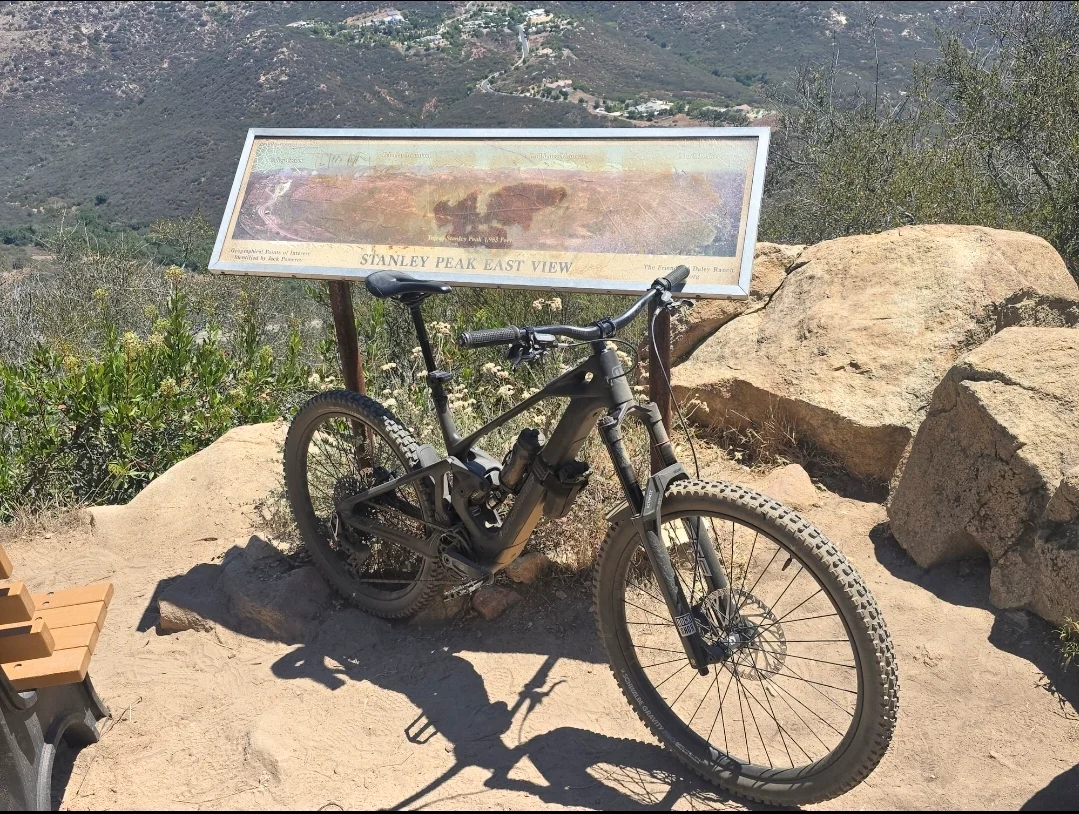

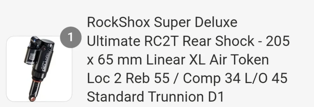

I went with a RockShox Super Deluxe Ultimate rear shock specially tuned for the suspension kinematics of the Zendit and RockShox 2027 Zeb Ultimate for the fork (based on previous ride experience on my Crestline S180 and 2025 Orbea Wild).
As stated previously, I changed out every stock component on this bike to suit my personal preference and set it up as an all-mountain, climbing machine.

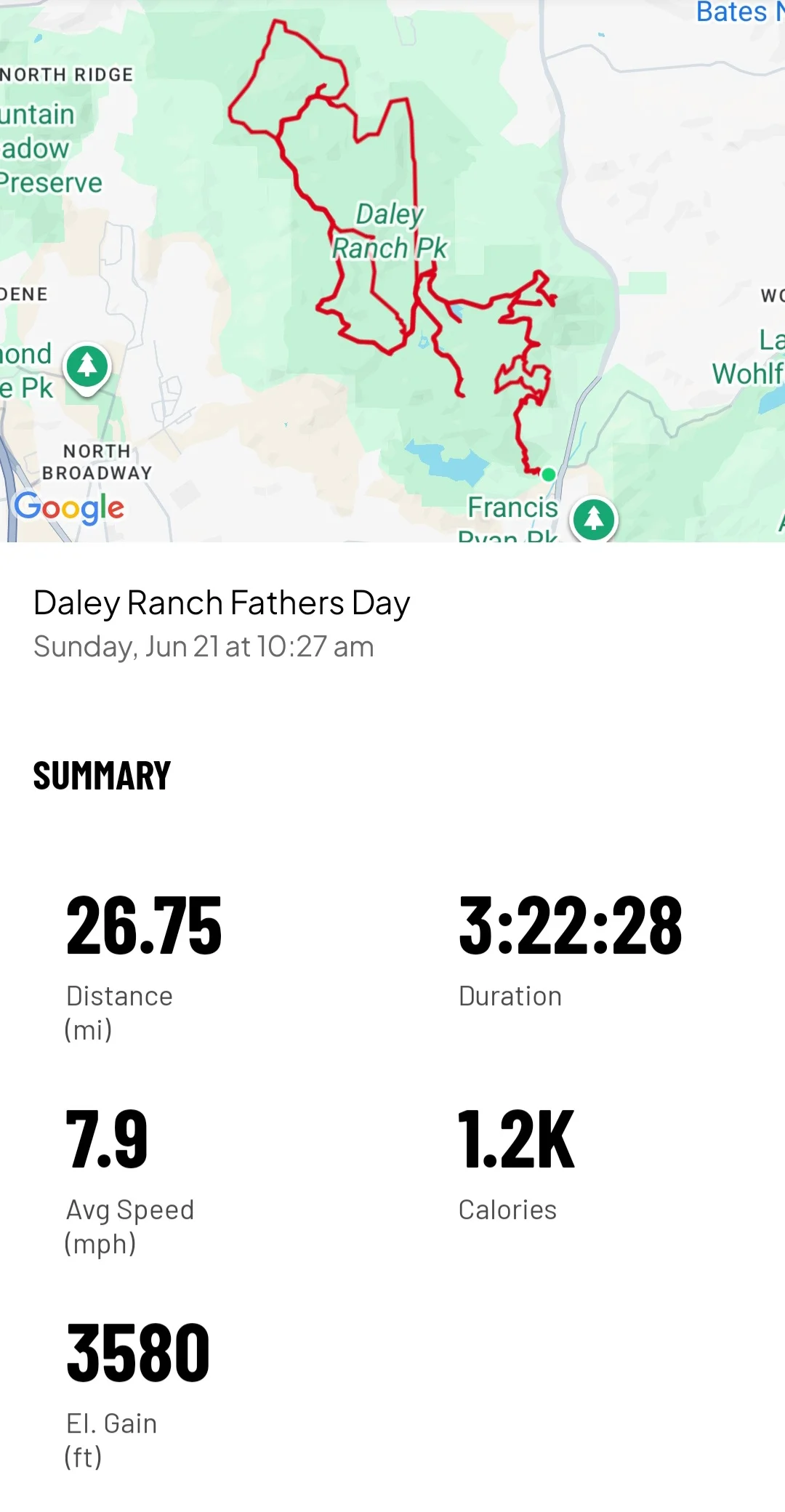

I just completed a 22 mile ride today on one of my favorite rides I have done many times over the last 5 years on 7 other emtb's. My custom Zendit performed better today than my other bikes. Ride had lots of technical climbing, tight switchbacks flowy singletrack and some rocky descents mainly on loose over hard teail conditions.
It took a few rides to dial in my suspension and psi tire settings. I created a couple custom power profiles in the Avinox app and made a couple edits on the trail today.
I rode primarily in the 2 custom settings I created for technical climbing and tight singletracks. Never thought I would say this, but I had to actually dial the power down. Only rode in Boost once and Turbo once on a long uphill fireroad for a brief time.

After a few ‘harrowing’ rides on the Float X, I swapped it with the E-Storia off my Arrival.
Not even tuned for the Zendit, and it was a huge improvement.
I found the Float X got overwhelmed easi

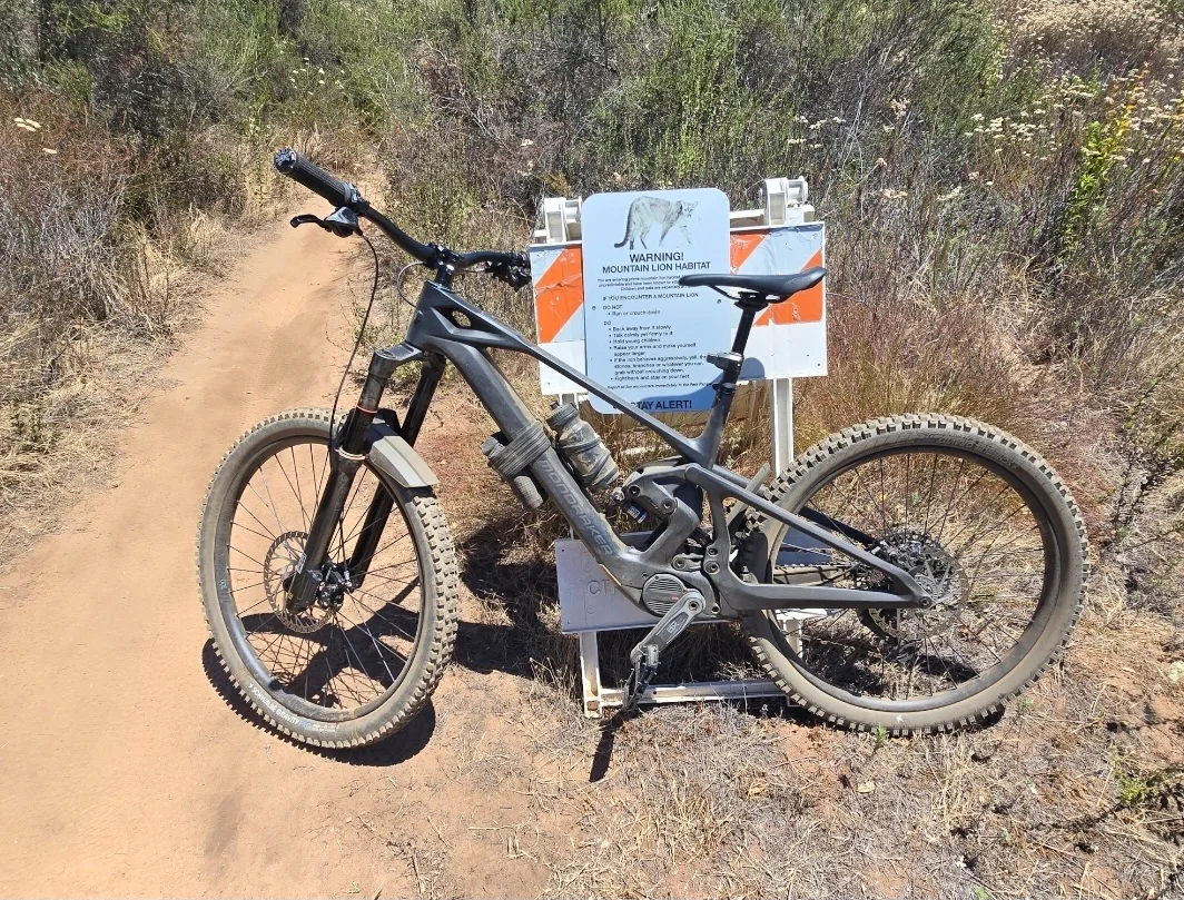

Had a great ride today, more focused on technical climbing. The Avinox motor obviously climbs exceptionally well, but has many other features that really shine as well. The kinematics and suspension on the Zendit is world class!

For the rear shock, I did some research based upon the kinematics of the Zendit's suspension and how I wanted the bike to ride as well as conferring with Rockshox and ordered a custom tuned Super Deluxe Ultimate.
