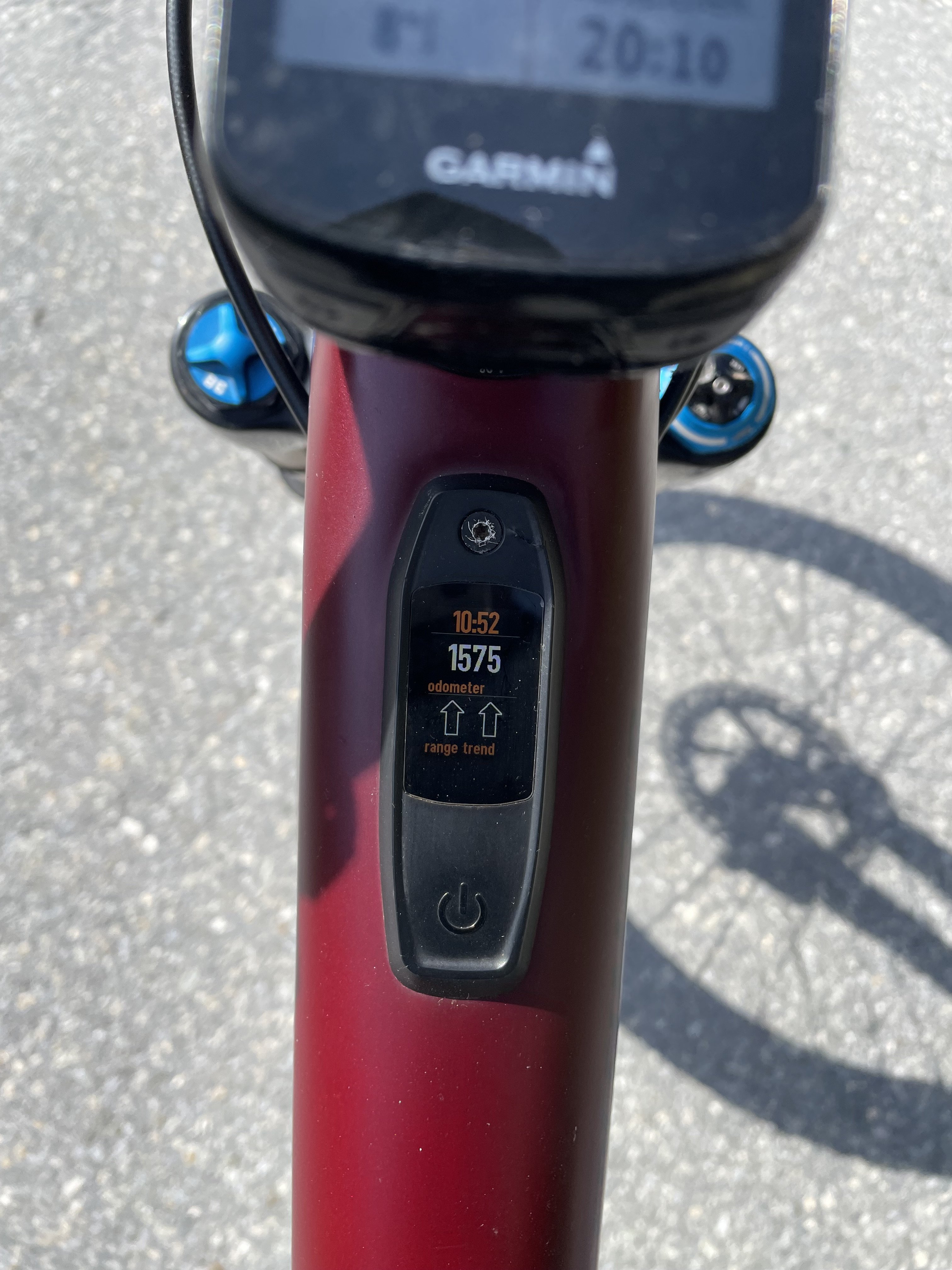

I connected the Mastermind TCU and it already worked. With the old TCU you had to enter a code with the new Mastermind TCU you just have to hold your smartphone near the TCU to pair it. But I‘ve the Levo 20…
BTW: Does anyone know if the TCU really changes the driving characteristics, because I have the serial number of a Kenevo SL.
Even my specialized dealer could not tell me that
what is this range since??
