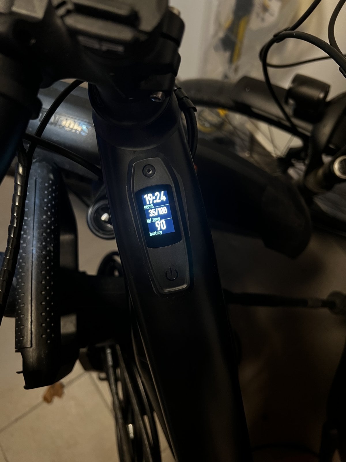

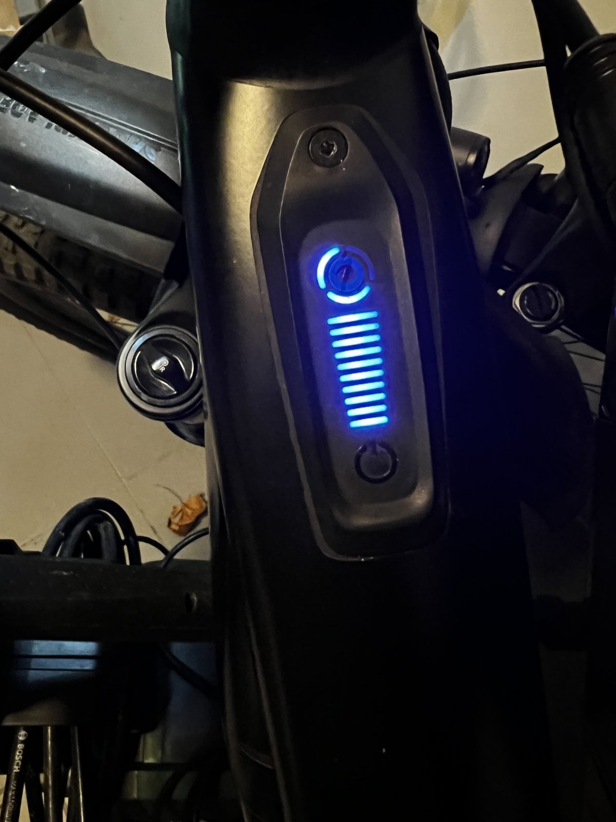

I‘ve a Turbo Levo Comp 20 with Mastermind n luv it:)
Before
Now
I have installed the Mastermind in my Turbo Levo comp 20 and it works without problems! Has anyone been able to try the latest firmware update?
