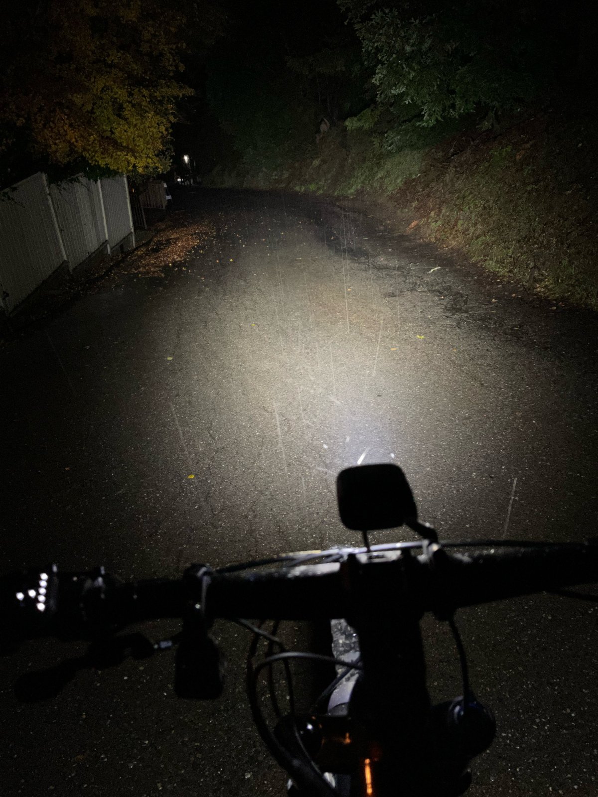

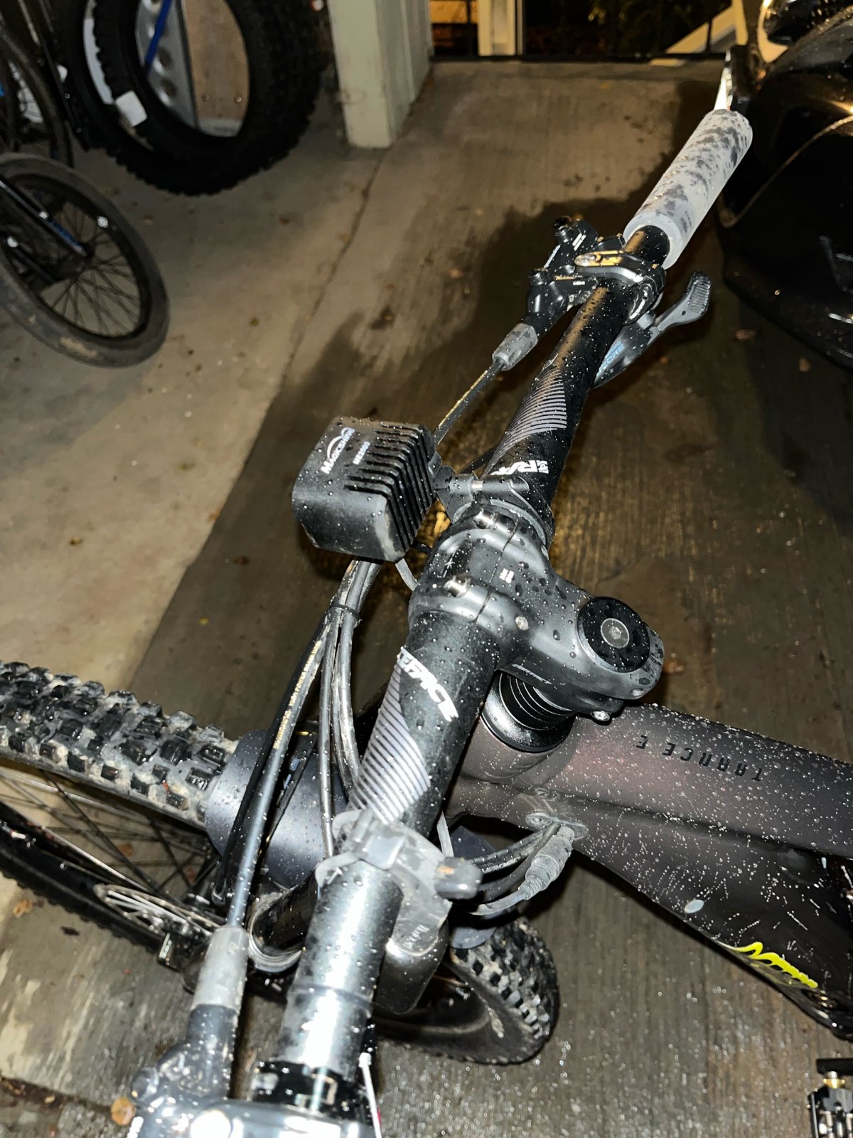

Just wanted to share a couple pics from my Magicshine ME 2000 install tonight, I'll post in the Product Reviews forum once I've had some time riding with it.
I’m on a 2021 Trance X e+ 3 so it has the small display-less ergo controller on the left bar. Since there’s a headlight on/off button on the controller I felt compelled to hardwire into the Giant supplied connector.
Overall it went well, I didn’t follow any instructions aside from learning about the headlight connector in the headset.
The ME 2000 came with a generously long cable and correct connector already installed, truly plug & play, here were the general steps:
  1. Removed battery and unscrewed the battery mount mechanism at the top. Be aware those two torx screws are “security” screws that require a hollow torx wrench. That mechanism is unusually robust & heavy, Giant could certainly save some weight here!
  2. Fished out the headlight connector from the headset and ran the new cable through the existing stock frame outlet. I had to enlarge the opening in the plastic grommet a bit, used a drill but you could use a Dremel tool.
  3. Mounted everything, adjusted the battery mount, then simply attached the lamp to the bars.
The light seems to perform well, especially for its small size. The beam pattern seems a nice combo of spot and flood. It’s probably sufficient for moderate riding, but I’m going to combine it with a helmet mounted light for any extended night adventures.
Sorry bout the rainy photos, since many of you are in the UK I suppose it’s normal but out here in California we’re getting properly soaked this month! Pics show the highest setting.
Overall recommended, especially for the price: $79.99 shipped (ordered from magicshine.com).

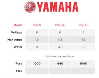

Sorry for resurrecting this old thread, but thanks OP for the write-up. I want some new lights for my Trance now, as my 10+ year old Magicshine bar light is showing its age.
Have you noticed any drop in cycling range for the bike when you're using the light on full power?
Also, do you know how much power the Giant system allows a headlight to draw? I've read that Shimano systems might limit lights to 12W. Presumably Yamaha do the same, so there's a point at which there's no benefit picking a higher-output light unit. I can't find any info about this online for Yamaha.
Edit: I found a table on the Exposure website that answers my own question about the power outputs of various e-bike systems: https://www.exposure-use.com/Brands/Exposure-Lights/Product-Support/E-Light-Hub
My '21 Trance E+ uses the Yamaha PW-X2 motor so I'm limited to 1000 lumens.
This seems to be a hugely limiting factor for using these kinds of lights as the main source for off-road night riding :-(

I've got a 2021 trance X and I'm a little confused regarding fitting. I'm assuming the standard Giant light connector is in the headstock above the battery mount.
Do I need to remove the battery mount as well as the side cable grommet to get to it?
I take it the magicshine yamaha connection cable just plugs straight into it?
Apologies if these seem stupid but there are various youtube videos with people plugging lights into the connectors at the motor, cutting connectors and soldering wires straight together and routing cables all over the place. I just want to confirm that the magicshine lights are just plug and play.
1. Unless you're a surgeon you'll most likely need to remove the battery mount to get to the stock connector, it takes the "hollow" torx wrenches (security screw). Likewise for the side grommet, that needs to come out. I needed to enlarge the grommet a little with a drill to accommodate the new cable.
2. If you get the Magicshine Yamaha e-bike wiring then it will plug straight into the unused connector on the stock wiring harness. No splicing required. Some older Giants had the connector down near the bottom bracket, but mine was up near the headset.
Tis the season for lights and fenders!
I don't notice any drop in range with the light on, even at full brightness for longer durations. LEDs these days are very efficient.
The max lumens is probably just a generalization, I think it has more to do with the efficiency of the light itself and bulb selection/configuration. But I'm no expert.
Cheers for that. I was a bit confused as the Magicshine US site lists a Giant cable and a Yamaha cable.
I'll have a crack at doing it without removing the battery mount first and see how it goes 😁
