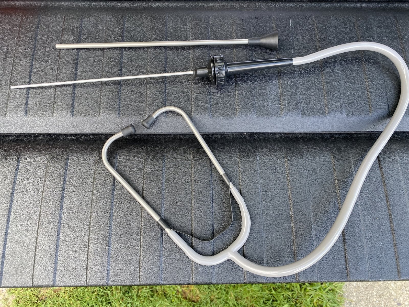

A shortcut would be to get a short length of copper or plastic pipe to use as a stethoscope. Get someone else to compress and release the bike whilst you position the stethoscope first on the shock and then near each pivot bearing. You may be a ble to hear a marked difference in volume of the noise.

I'll have my son pin point where the noise might be emanating from with this auto stethoscope. In my case, I'm under warranty, so I'll leave it at a Trek store at the end of my biking season if it something I can't tighten or replace myself. . . . vid of noise in link below:
Update: Ya , my son figured it out tonight. It was two loose screws under the back of the seat that hold it tight to the rails. I never knew they were under there! When these bikes come into the stores they are partially unassembled and they probably have kids putting them together. No more clicking noises now 👍🏻

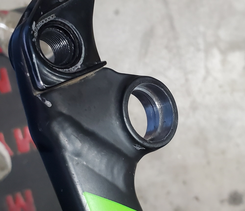

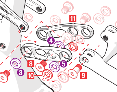

Removing the rear seat stay bearings was a right bugger! There are two bearings at each pivot point, pressed in from opposite sides. The two bearings are separated by a ridge. This means you can't use a bearing press to push them out the easy way. There is also a washer between the pair of bearings that sits inside the ridge and fills the gap between the inner races. That makes it very hard to use a punch to push on the inner race. Hard, but not impossible.
My seat stay is alumin(i)um, so I held it using soft jaws in my bench vice. I don't know how you'd get the bearings out of a carbon seat stay. I'd be pretty nervous about clamping a carbon tube in a vice. Maybe they use a different bearing arrangement?
Use a slide hammer to extract the bearings. The bearings are probably too damaged to use afterwards, but if you intend to replace them anyway, that's no big deal.

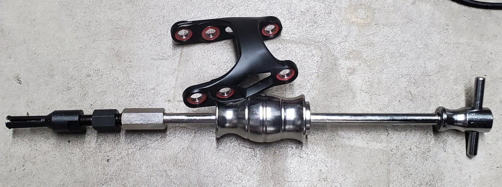

I tried my slide hammer, but I could not get it to grab the inner race. The spacer they put between the inner races means that there is no lip for the expanding bit to grab on to. If you've had success with a slide hammer, I'd like to see a picture of it.

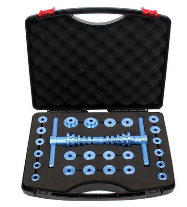

If the slide hammer fails, there seems to be a special custom tool available as well:
That custom tool looks like it has a chance. There will be a lot of contact area between the tool and the inner race. Maybe that will generate enough friction to prevent the tool from sliding out of the bearing.
I hope the tool itself isn't made of chocolate! The bearing press I bought seems to be. I recommend against it!
So I finally received the bearings (the one I initially ordered was sold out, so I got the Enduro bearings instead).
The bearings on the seat stay are indeed a true PITA, but I was still able to remove them with my bearing puller / slide hammer.
You have to generate enough expanding force so that it can find grip on the inner ring of the bearing, much like the dedicated tool I linked to above would. You cannot go through all the way and grab the bearing at its end, due to the spacer you mentioned. I used two wrenches to really screw down the expanding bit of the slide hammer to achieve this amount of expanding force (the more you screw it down, the more it expands, for those who haven't worked with a slide hammer yet).
There's a chance that you will slightly damage/scratch the spacer between the two bearings this way, but as far as I could tell this spacer is only there to fill up the empty space and has no real functional meaning.
No photos though, sorry. You wouldn't be able to see much there anyway.
